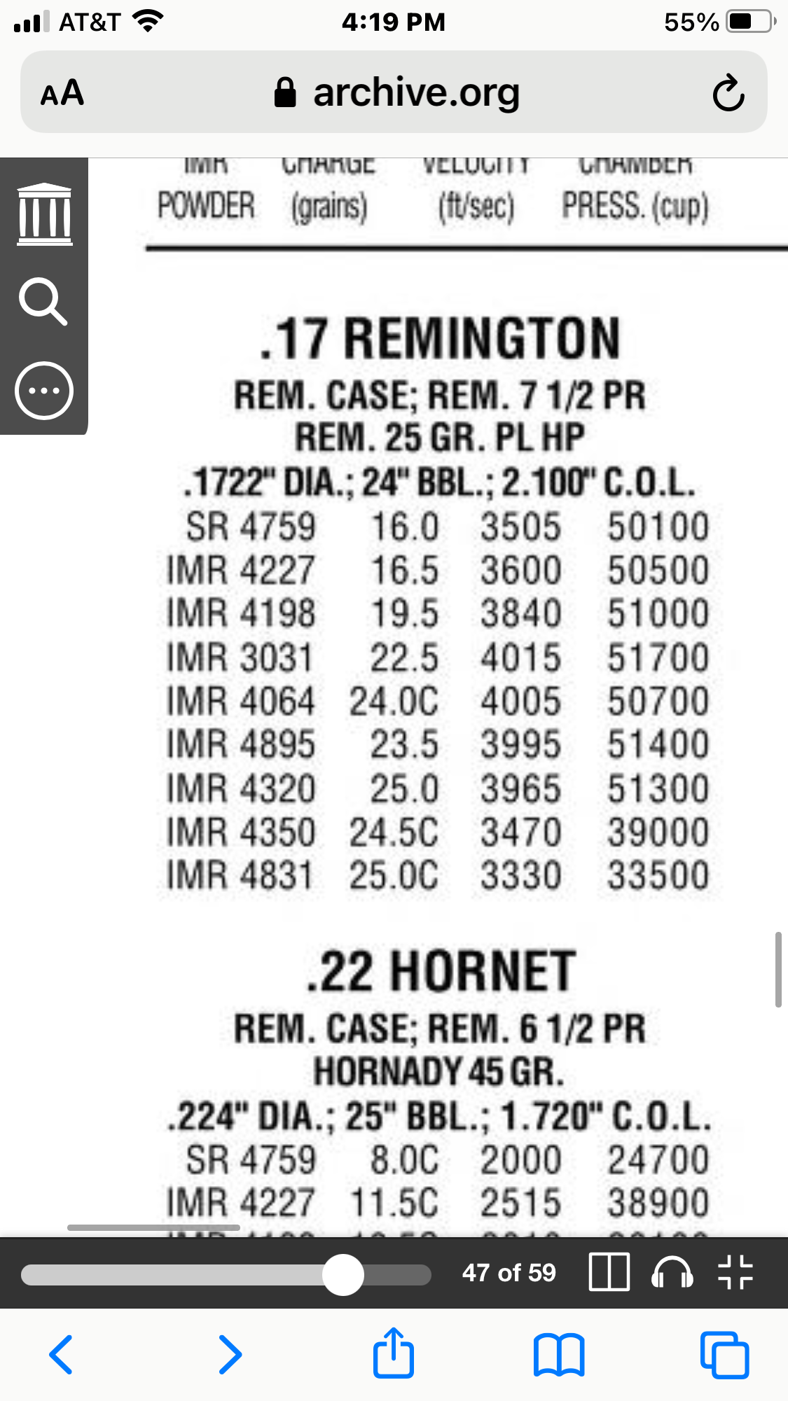

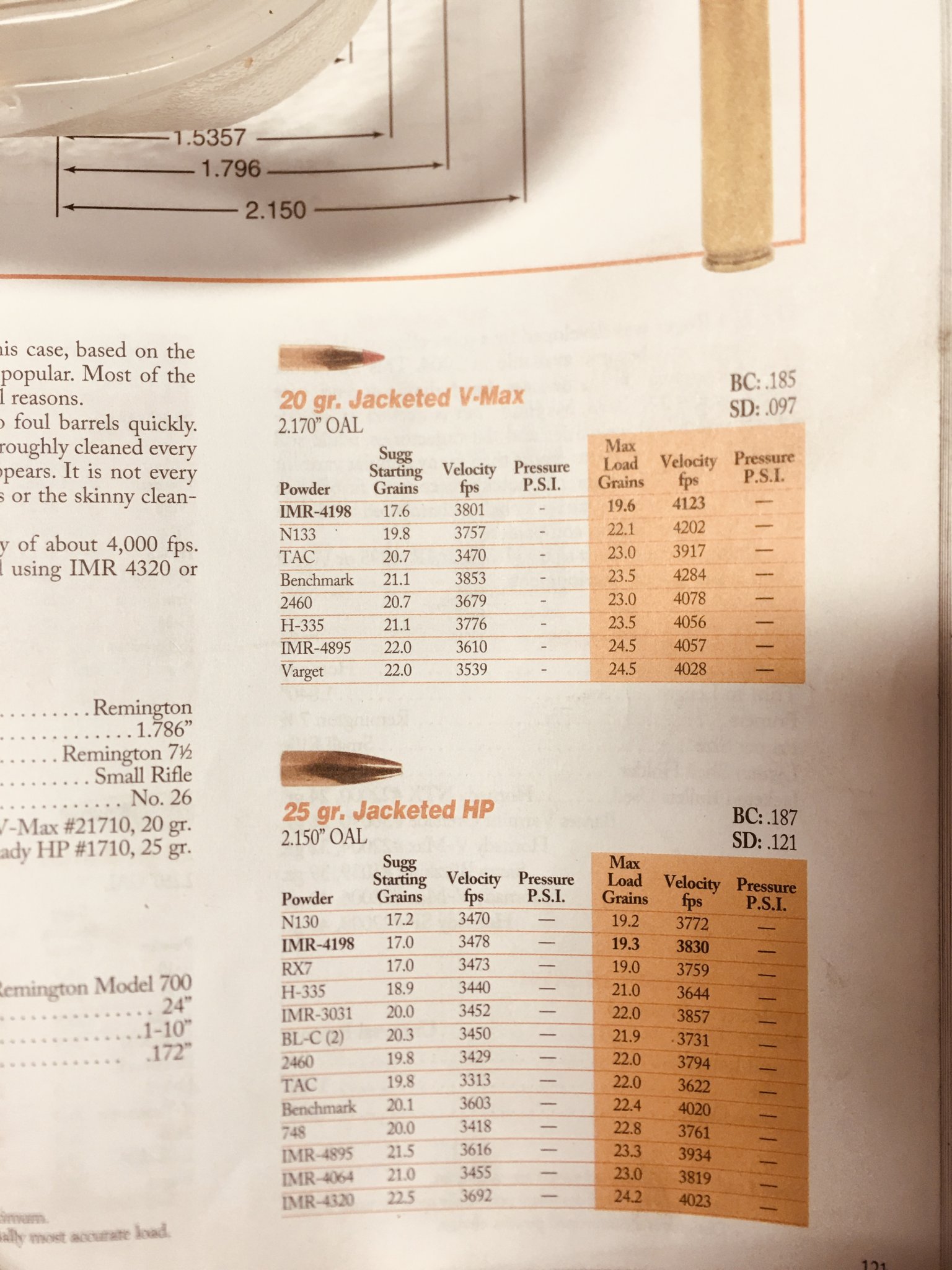

    Despite my Lymans manual showing IMR 4198 powder as “best groups in BOTH 25 &20 grain bullets, is only mentioned once by one member as his choice of powder. But this member also has had somewheres of 10 17Remington guns for the last 30 years plus and I take it with high regard. Funny, Hodgdon online reloaded does not even include it, but they also do NOT show H4350 or IMR 4350 being used in the 22CREEDMOOR either so take it with a grain of S””.
    Today I’m going to be shooting 4198 with 20 and 25 grain Vmax, and HP hornady and some open nose 20gr Nosler cfe223 with 20’s

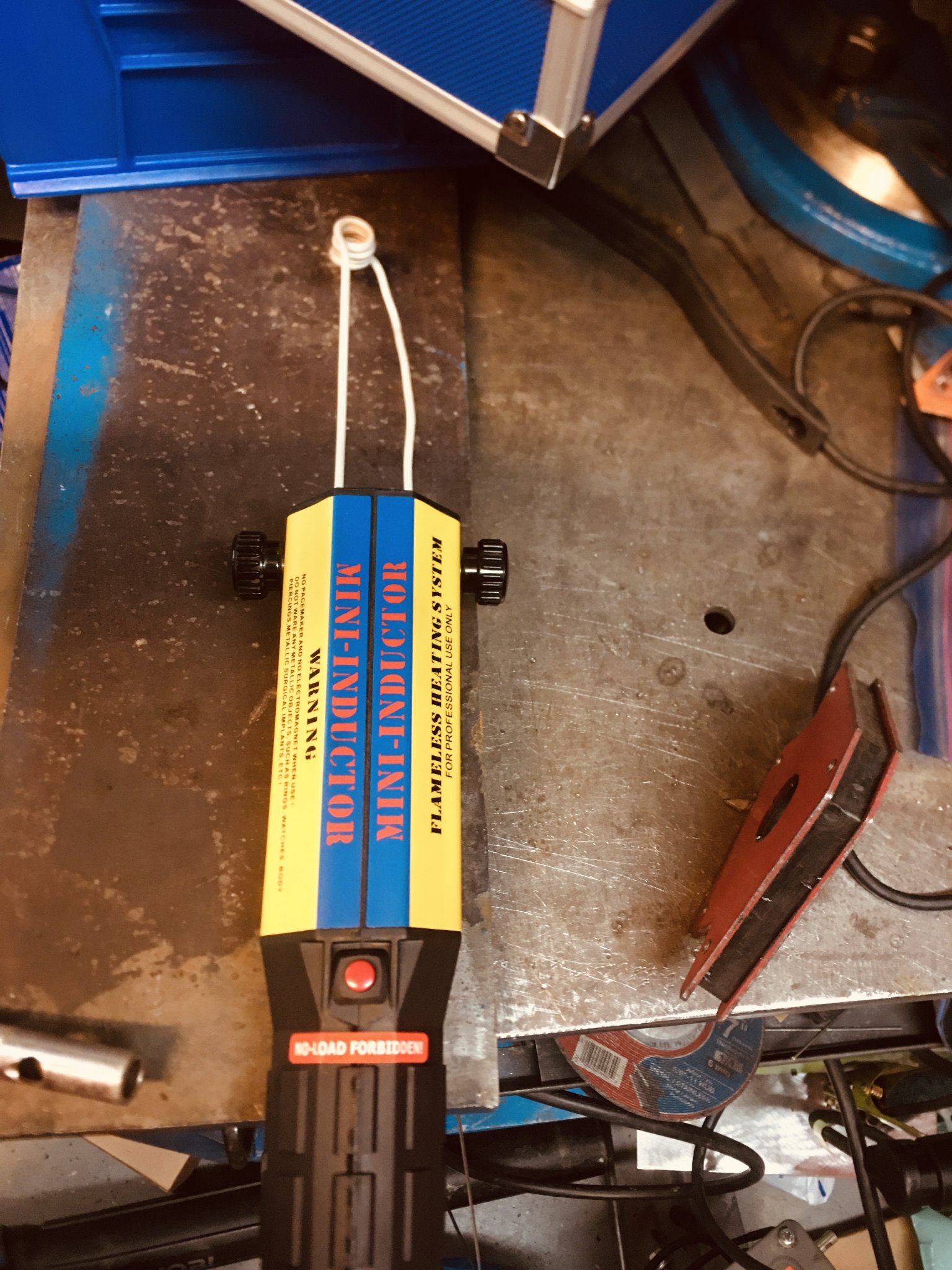

    Brass spring back was causing chamber issues I know this is a tight chamber cut the brass was too hard after being formed in the die, and using a torch was not working too well. used a DIY induction system fantastic not too soft perfect amount of heat. simple easy to use wish I would’ve picked up one of these a long time ago
    Now the brass goes in and cycles to the chamber= no issues

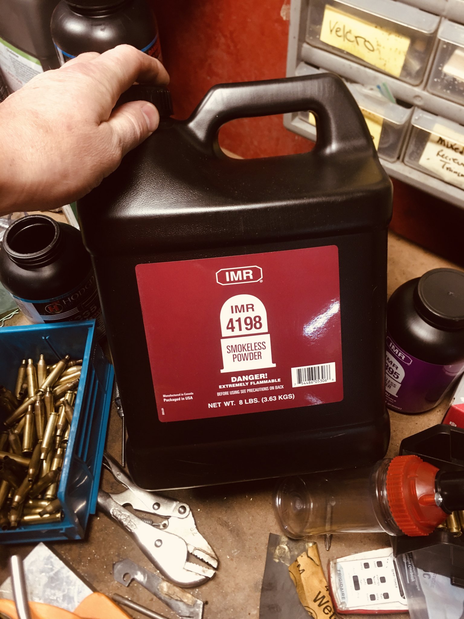

    Over 2,800 rounds can be loaded out of this 8pound jug! I just hope that it will have enough gas to run the AR. I do have an adjustable gas block on it we’ll see.
    Well three or 400 rounds later just a note using the powder does not have enough gas to cycle the action without
    Doing the following:
    1-Cut coils off a standard spring
    2- you can use a lighter BCG and you’ll have to use in adjustable gas block
    And you could have function issues over time because the spring will become more compressed unless you take it out of the gun and leave it out maybe I don’t know but you just have to know that it’s a little bit finicky if you do that.
    For now I just switched back to a common AR 15 powder works great no function issues and gives plenty of velocity and accuracy.
