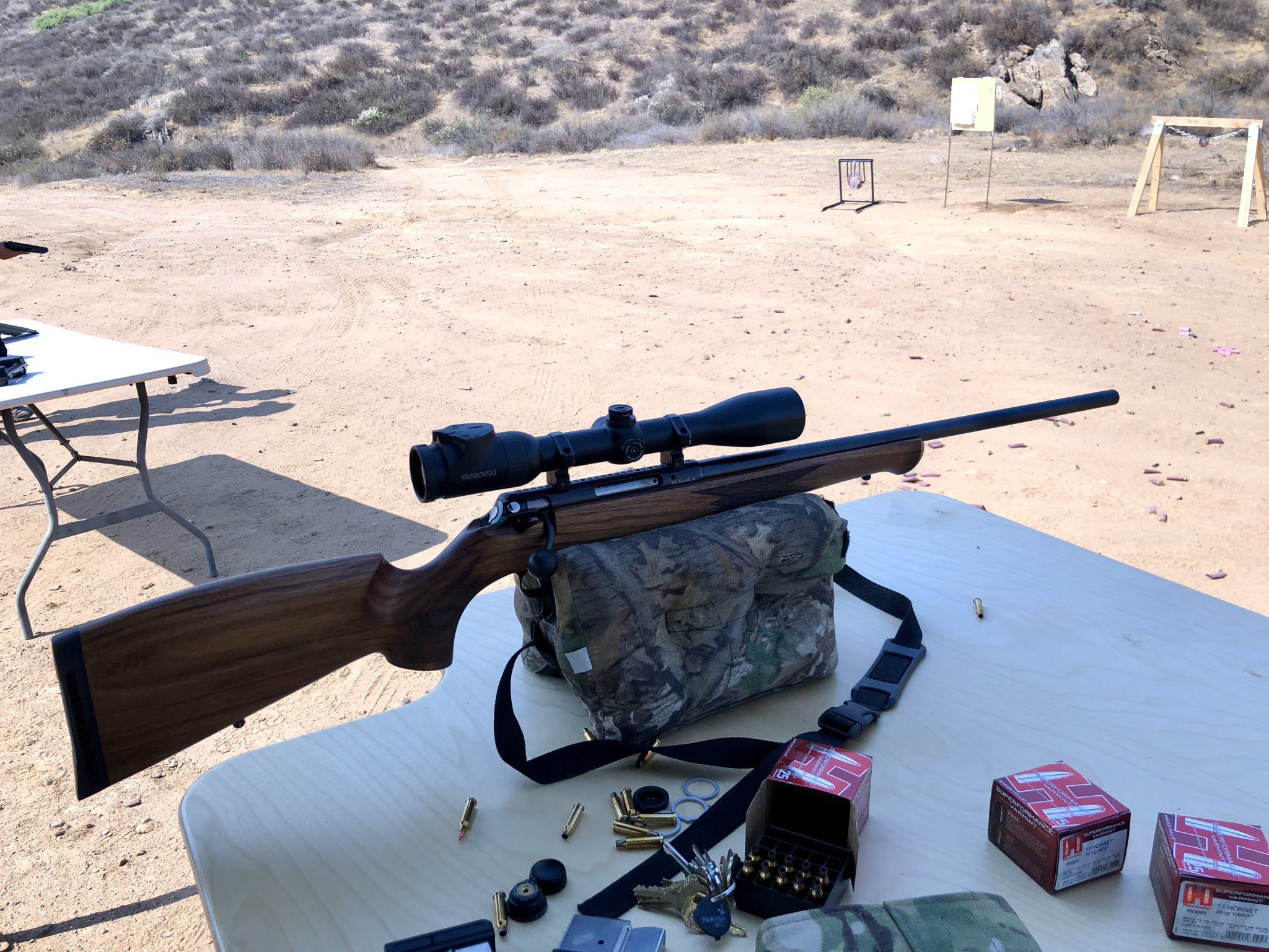

My safe was full too but I had to make room for this Anschutz beauty in 17 Hornet
