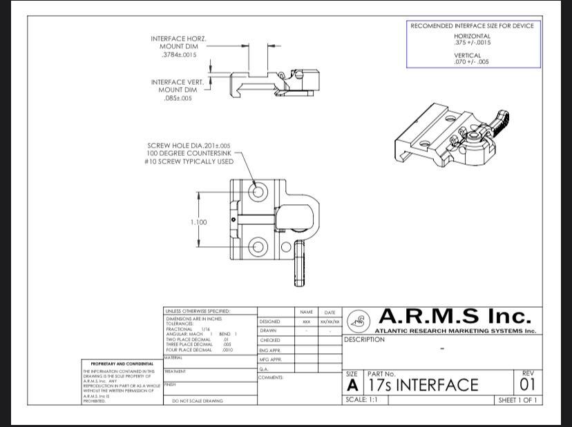

Edit: Seems like my information was wrong, please disregard. See below for correct info.

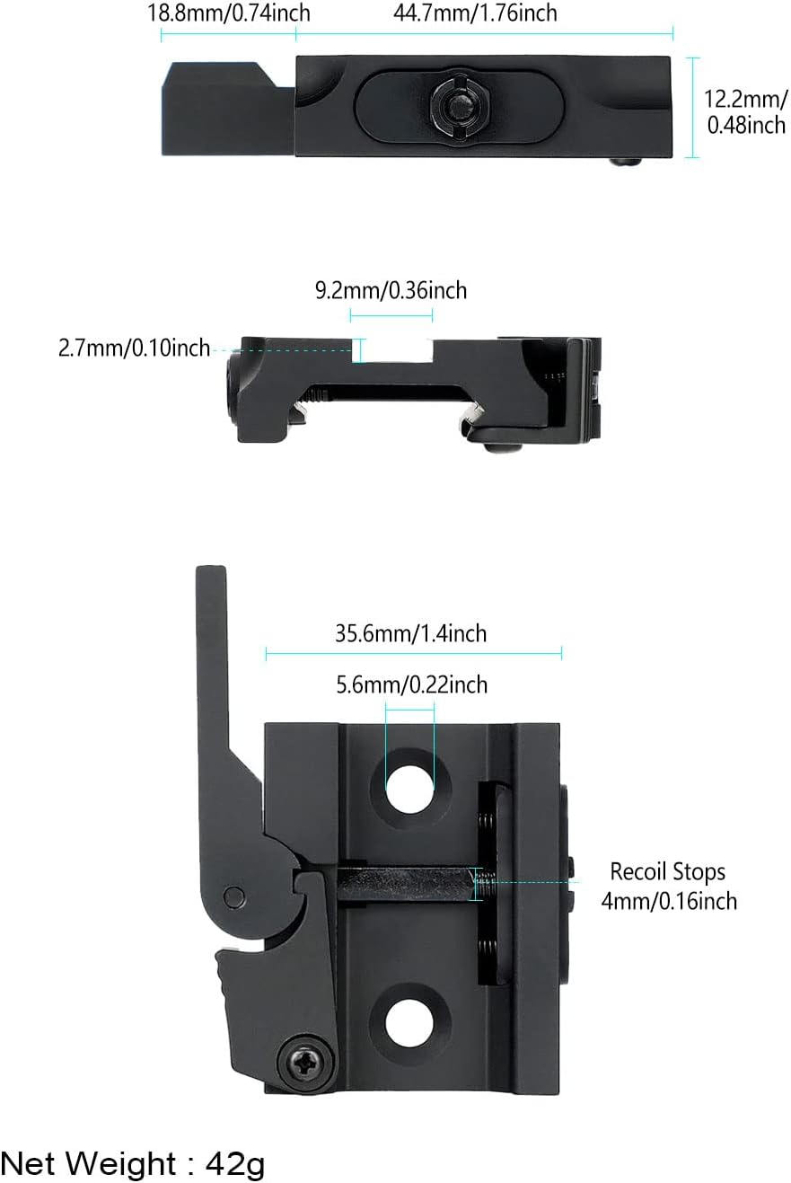

This is an old thread but I think this is correct. Wouldn't bet my life on it. Maybe someone else could verify.
9.2mm/0.36" wide
2.7mm/0.10" deep
2 inch spacing between holes
5.6mm/0.22 inch hole diameter or sometimes 3/8 inch, usually supports #10/32 screws
