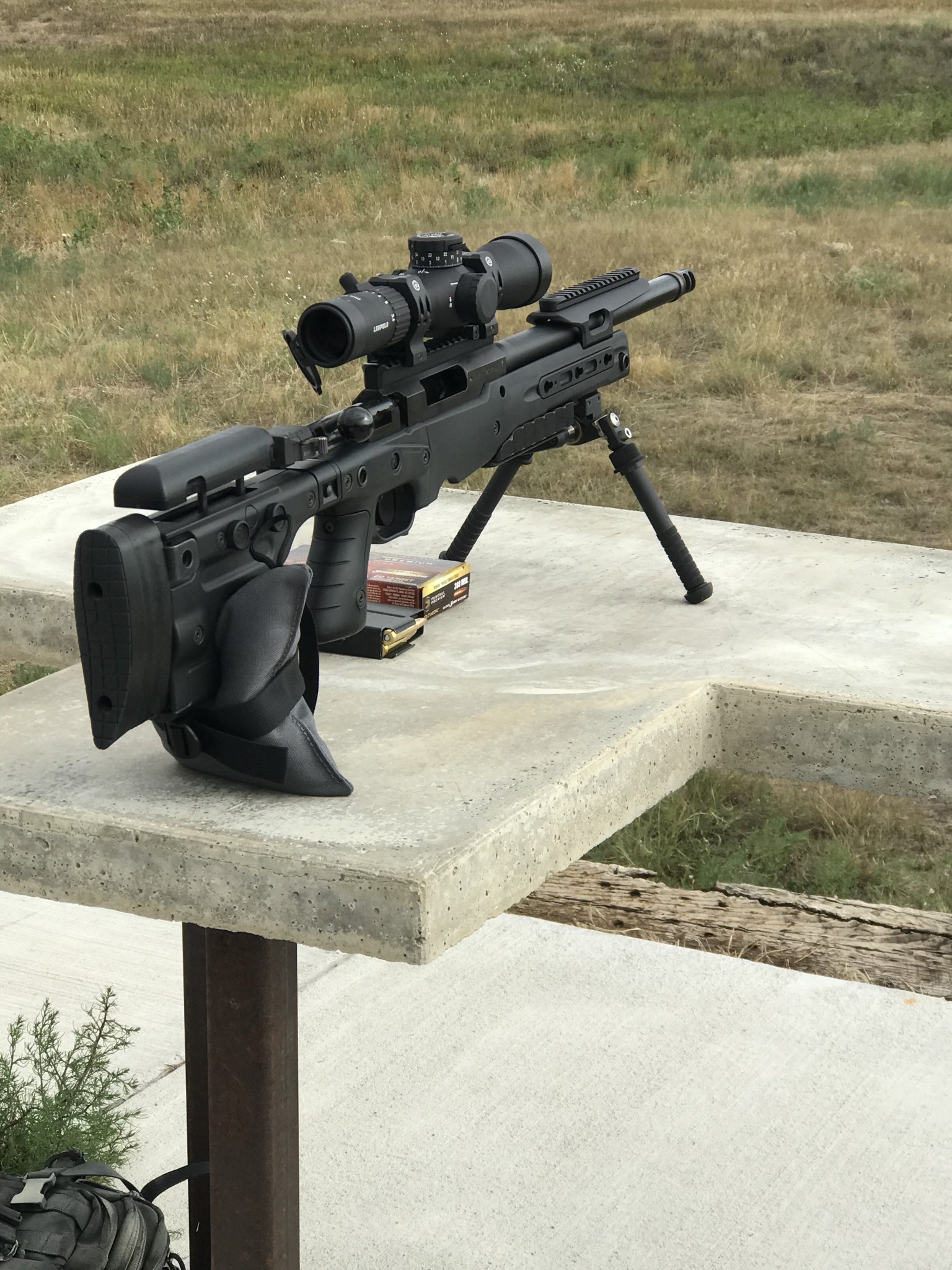

I can tell you with 100% certainty that the Federal GMM 185 Berger Juggernauts will get you there in an 18” gun. I do it very regularly with my SR-25 16” ACC, as well as my A.I. 20” .308.
The 175SMK are very spotty to 1K from a 16” gun, but the 185’s are quite predictable.
That’s from a factory load, handloads open up an ENTIRELY new world of possibilities.
