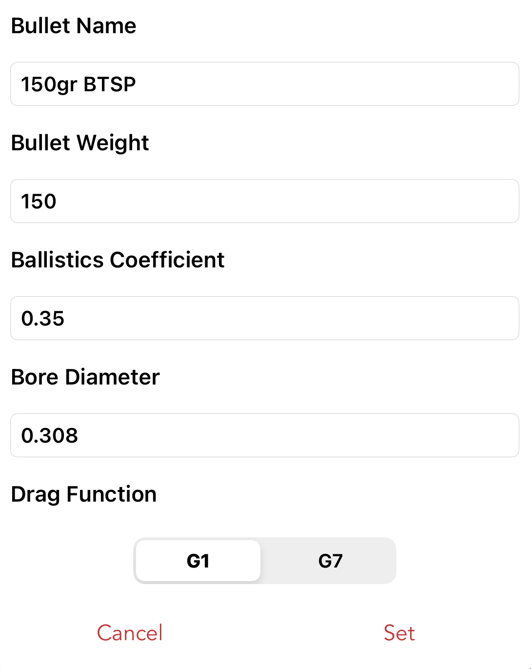

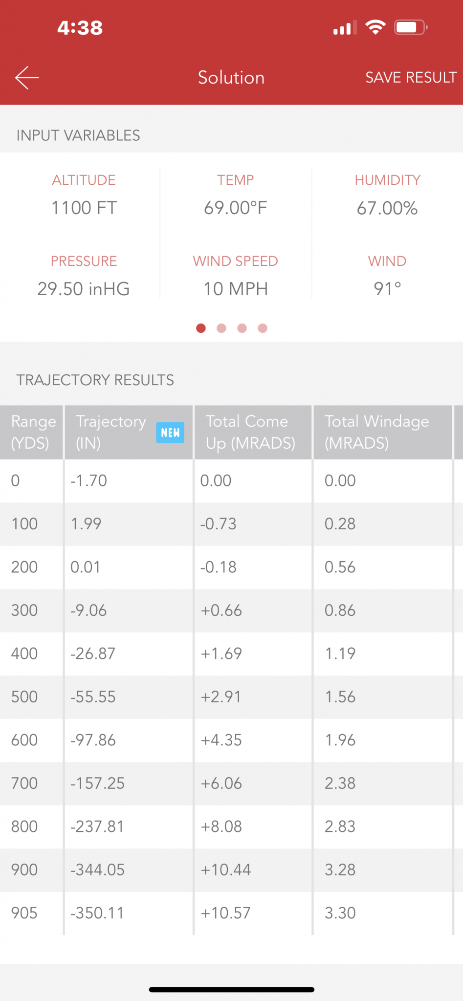

I'm willing to bet you are cruising 2700fps with an 18" 308 bolt barrel. Hornady calculator with generic but common numbers:
The box trajectory is actually pretty spot on for a 2” high 100 and zero 200. You would have to run an incredibly low velocity or BC for this round to be that bad of a drop at 200yds. 4” is absurd.
