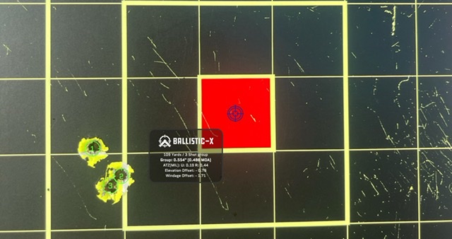

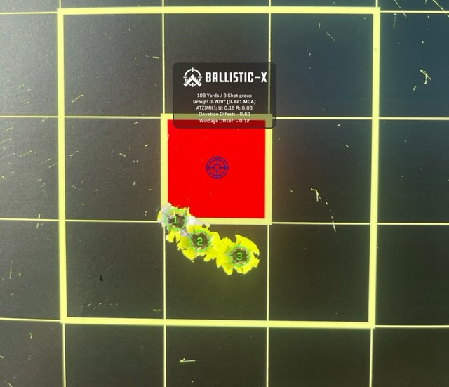

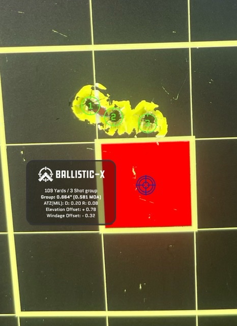

I would take a look at White Oak Armament barrels as well. Chambered in 223 wylde and available in 18” or 20” lengths. I have several hundred rounds through mine and it shoots consistently with little load work up. And at their price i think they are hard to beat. And as stated earlier green loc tite it in the upper if its not already a thermal fit upper.
