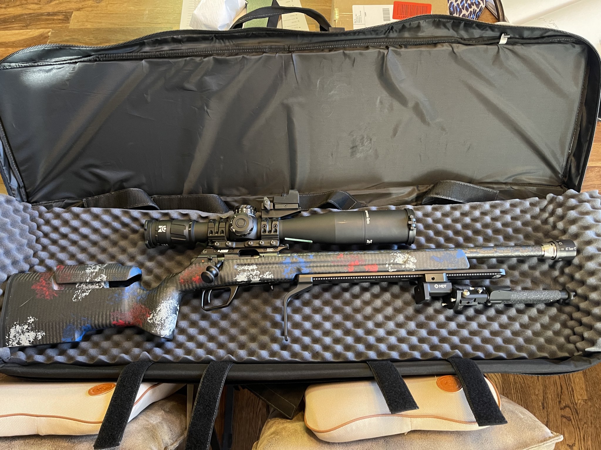

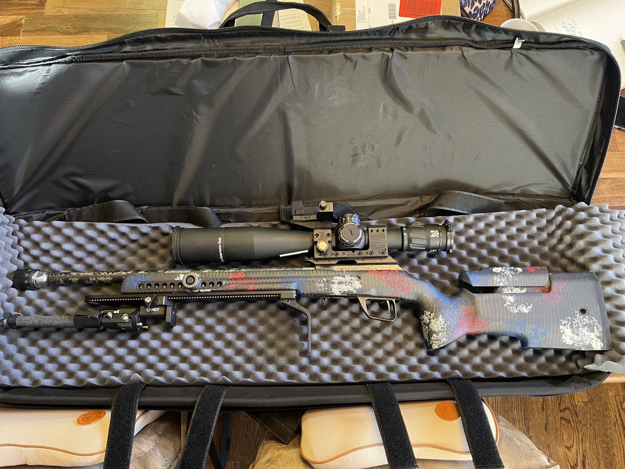

    Here is my current PRS Setup.....with the 20"
