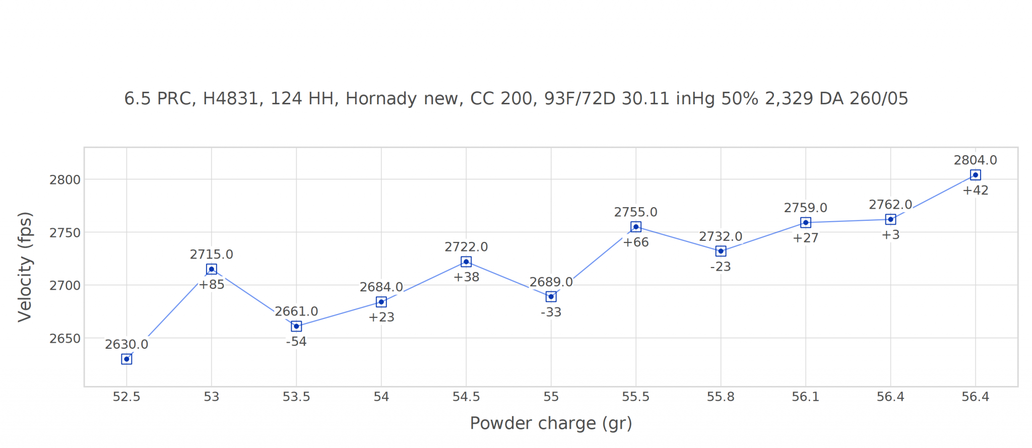

Well, I've had a chance to shoot my 16.5" PRC on Friday for the first time. I don't have any factory ammo to compare it to, but here is what I have so far. I've started on the safe side:
52.0gr H4831, Nosler 123gr CC, new Hornady brass, CCI 200 - 2,452 to sight in and try out my new Magnetospeed
I got to 55.5 @ 2,661 - was pretty accurate combo, will go higher
Now I've switched to 124gr Hammer Hunter bullets for ladder test in the tables below. These are solid core bullets and I've used Lee crimp die (light crimp)
I'm going to increase the charge weight of H4831 as it didn't show any pressure signs and hopefully get better velocity and accuracy.

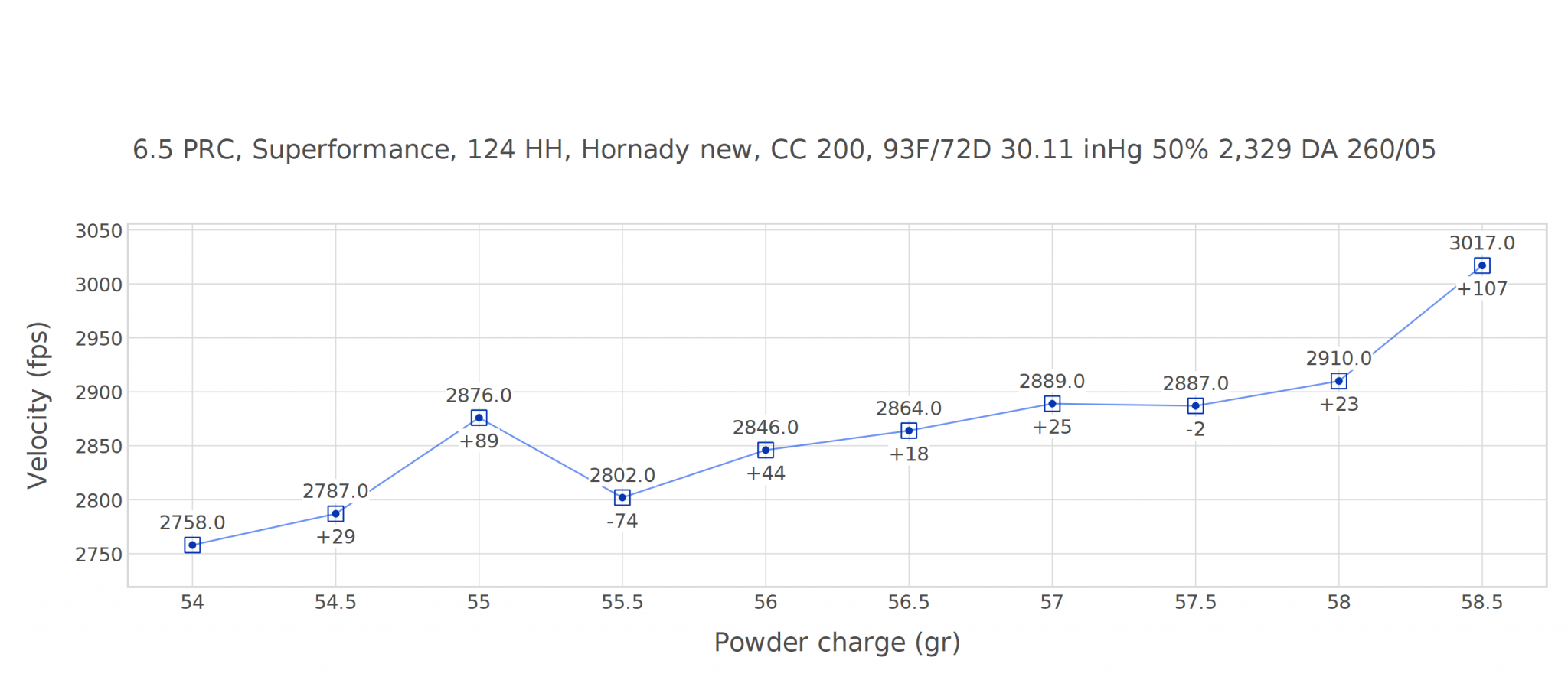

Superformace was lot faster but started getting heavier bolt lift at 57.0 and I've stopped at 58.0, but looks like a nice node around 57.5gr
H1000 was disappointingly slow even at 59.5gr (compressed) at 2,689 - that was a waste of time and components :)
Looks like 124 HH is about 94' faster with H4831 compared to Nosler 123 CC
I should be able to get close to 2,800" safely with H4831 or load down Superformance even though its not temp stable, but should be safe as I've tested it at 93 deg F.
I'm going to try H4350 and Leverution next, according to QuicLoad it should work as well or hopefully better than H4831 (don't have other powders on hand to try)

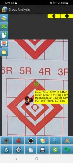

Did some more testing and got some numbers for SD and ES. Let's just say that RL 23 so far is terrible in this rifle for SD and ES. I had 6 round SD of 26.4. So that is unacceptable. I couldn't duplicate my accuracy from previous day either. I loaded many different charge weights and tried seating depths and couldn't get it to a good range. Tried Magnum primers and that seemed to help slightly but still not where I would be comfortable with it.
Ended up just grabbing some 156 gr berger rounds that I loaded up for another rifle. Had 2790 FPS average with a 5.0 SD. 55.3gr of RL26. 18" 8twist. Shot some groups with those and they were pretty dang good. .3 ish moa groups consistently. Then I tried 54.9 and ended up single hole and low single digit SD. Went to 550 yards at 2.9 mils and thing was super consistent. I need to try a different powder with the 127lrx. I'll be trying h4350 and varget. If I can't get those SDs down and find an accurate load, I'll be sticking to the Bergers.

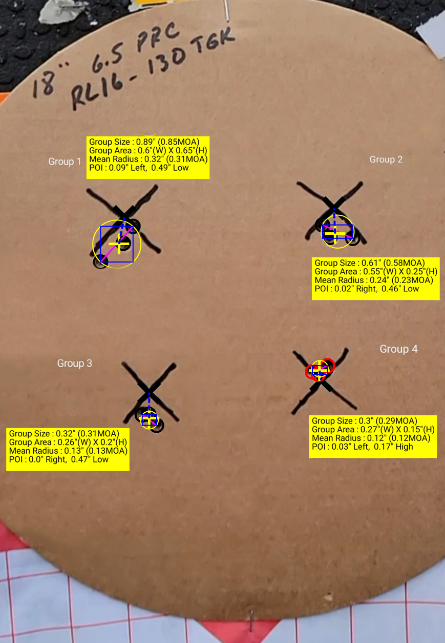

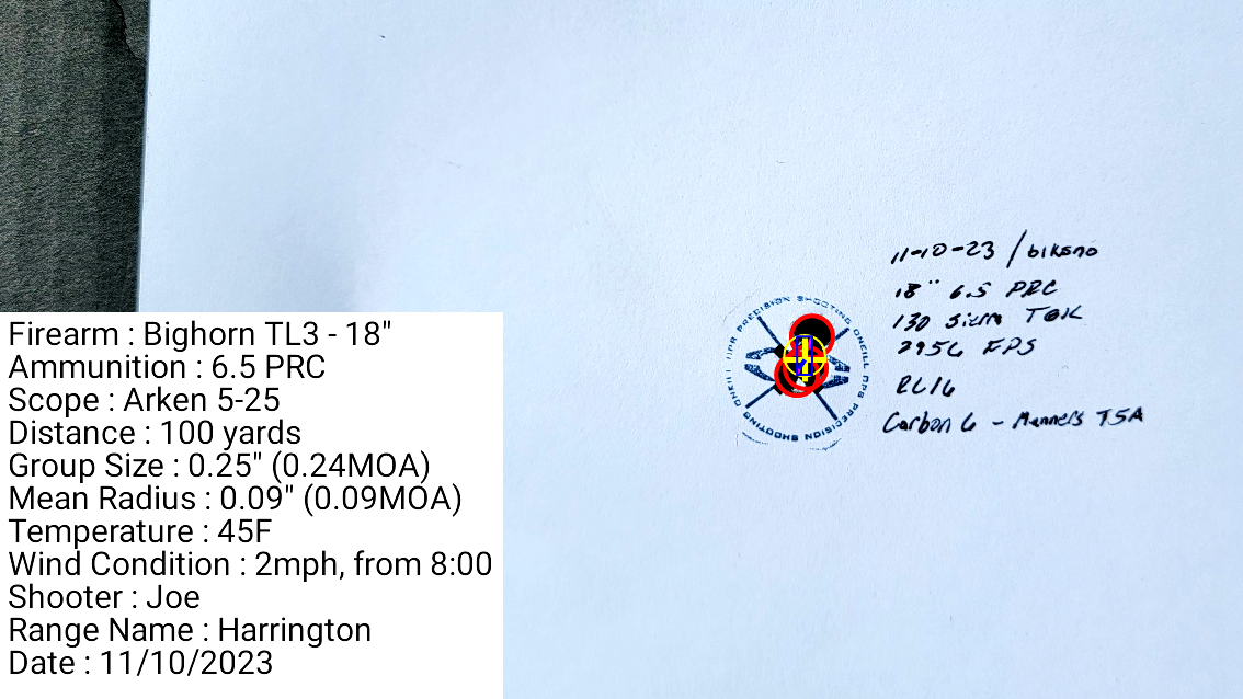

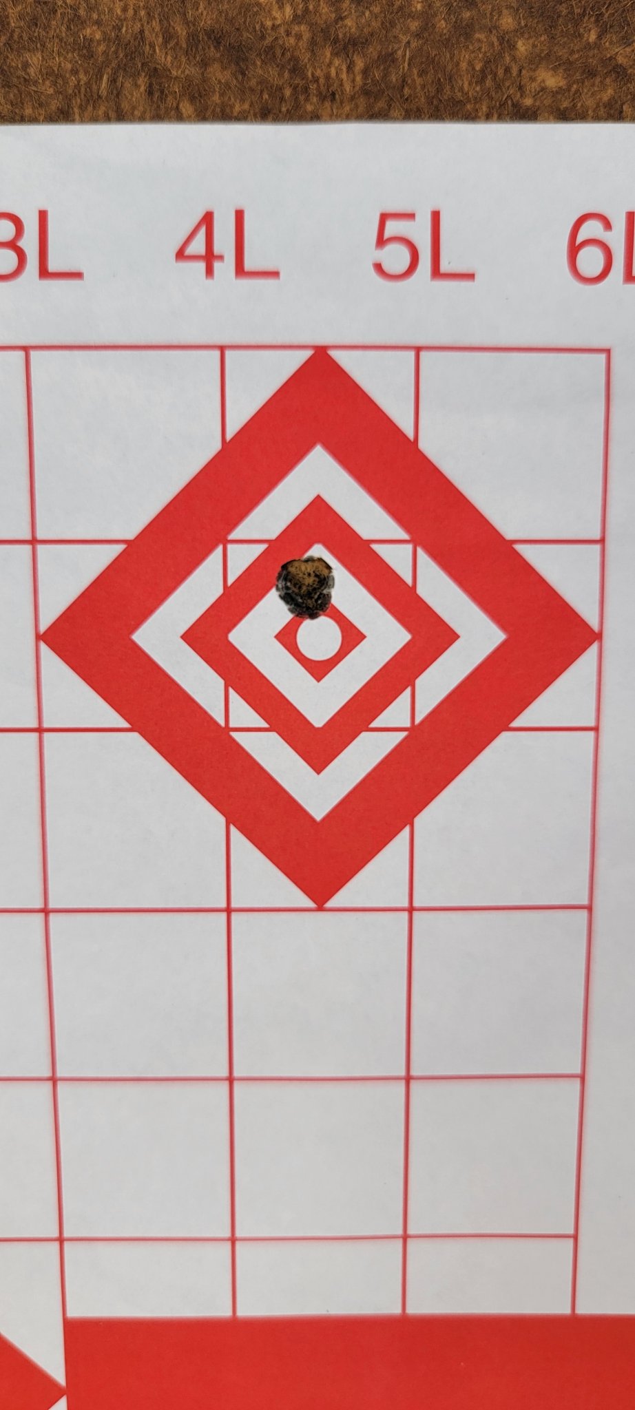

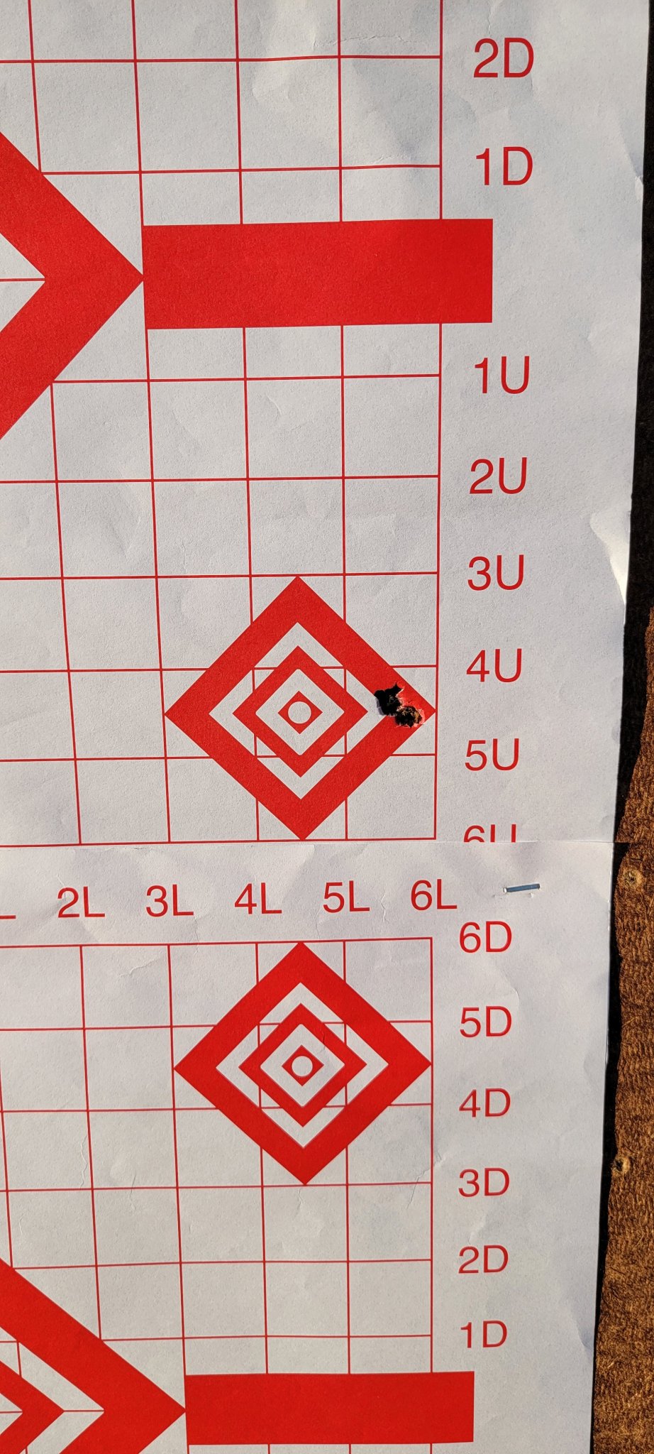

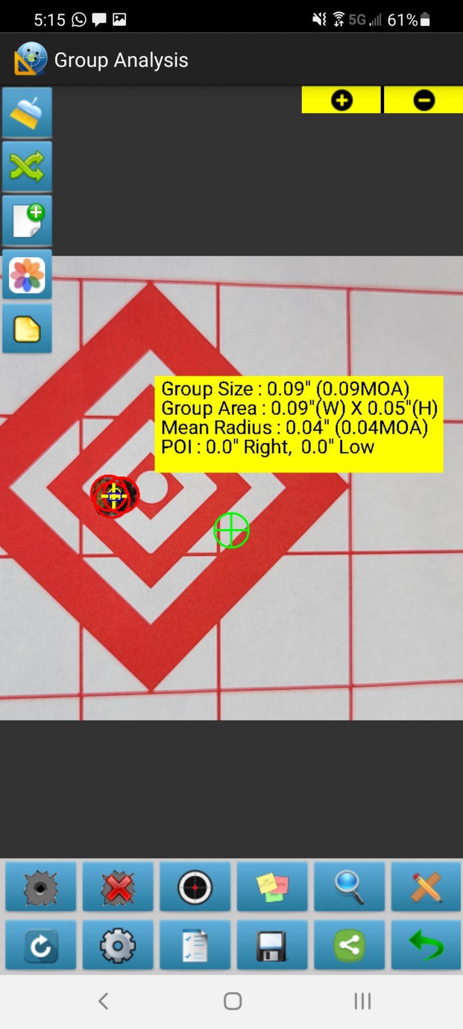

i know it's an old thread, but with hunting season upon us, I had been looking for data of my own and stumbled on this. My load for 150 SMKs and 145 Match Burners in the 26" Proof barrel wasn't going to be ideal in my new 18" carbon fiber hunting barrel, so I figured I'd work up something new with 130 TGKs.
Tried RL26 and was in the low to mid 2900s but accuracy and spreads weren't all that great. Less than 1 MOA but nothing to write home about with extreme spreads of 35-40 fps for hunting doesn't work for me.
Decided to test RL16 based on SkyScrapin post up toward the top. (Like a dumb ass...I started WAY TO HOT)
I think with a 130gr bullet, starting at around 49gr of RL16 and working up is probably pretty safe. I'm likely running a little warmer than necessary, but this is where the numbers looked the best and with a hunting set up...It'll probably never be shot in temps warmer than 50-60.
The last volly...group 4 was adjusted .1 mil up and I think I'm just gonna gas up 20 or so, and head out for a hunt.
18" 6.5 PRC - RL16 - 130gr TGKGroup sizeVelocity
Group 1.85 MOA2896 fps
Group 2.58 MOA2922 fps
Group 3.31 MOA2946 fps
Group 4.29 MOA2962 fps

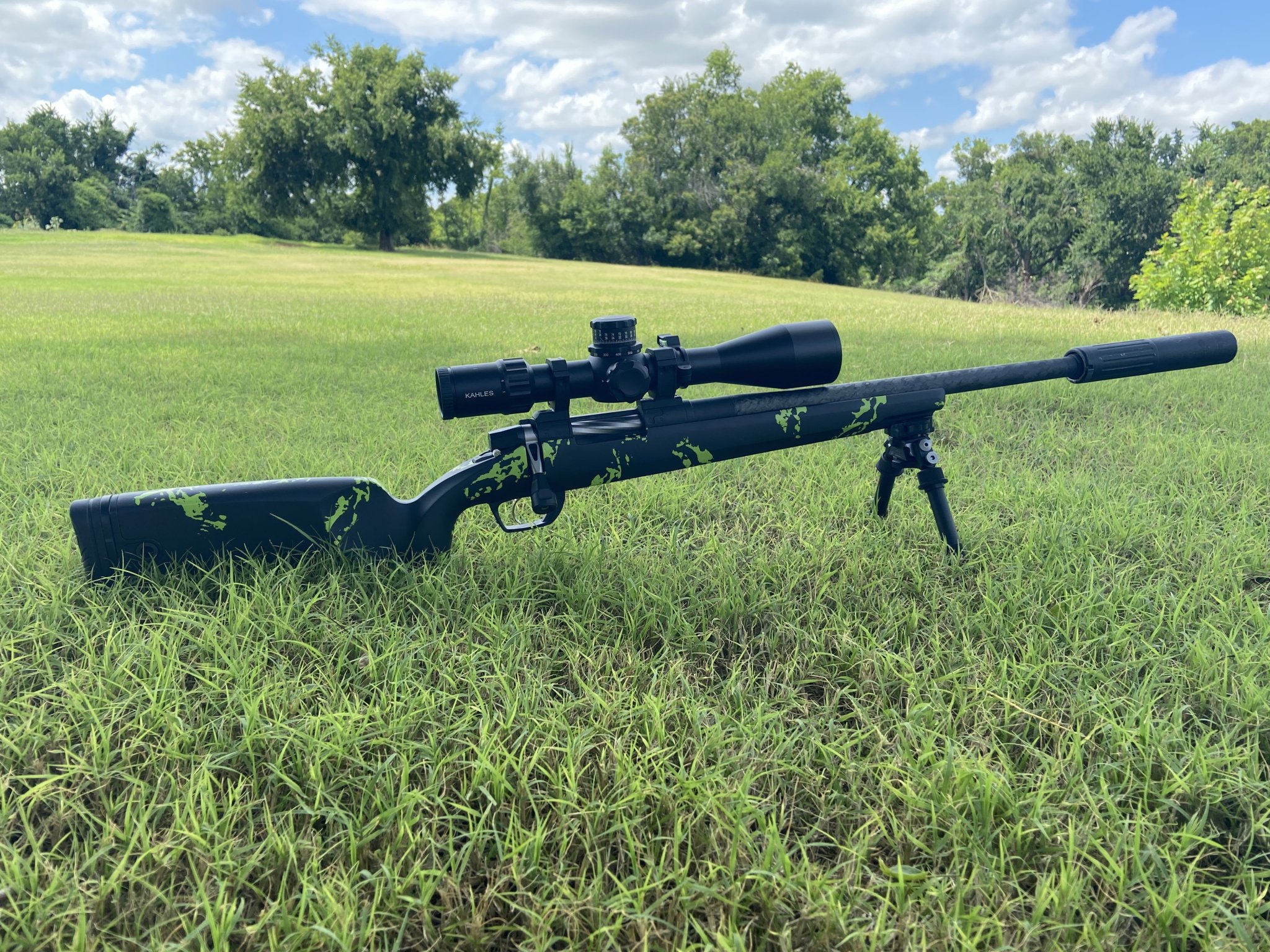

took it out deer hunting this weekend and made a little optic adjustment to correct the eye relief, re-zeroed and to no surpriseView attachment 8272851...it's still stacking them.
