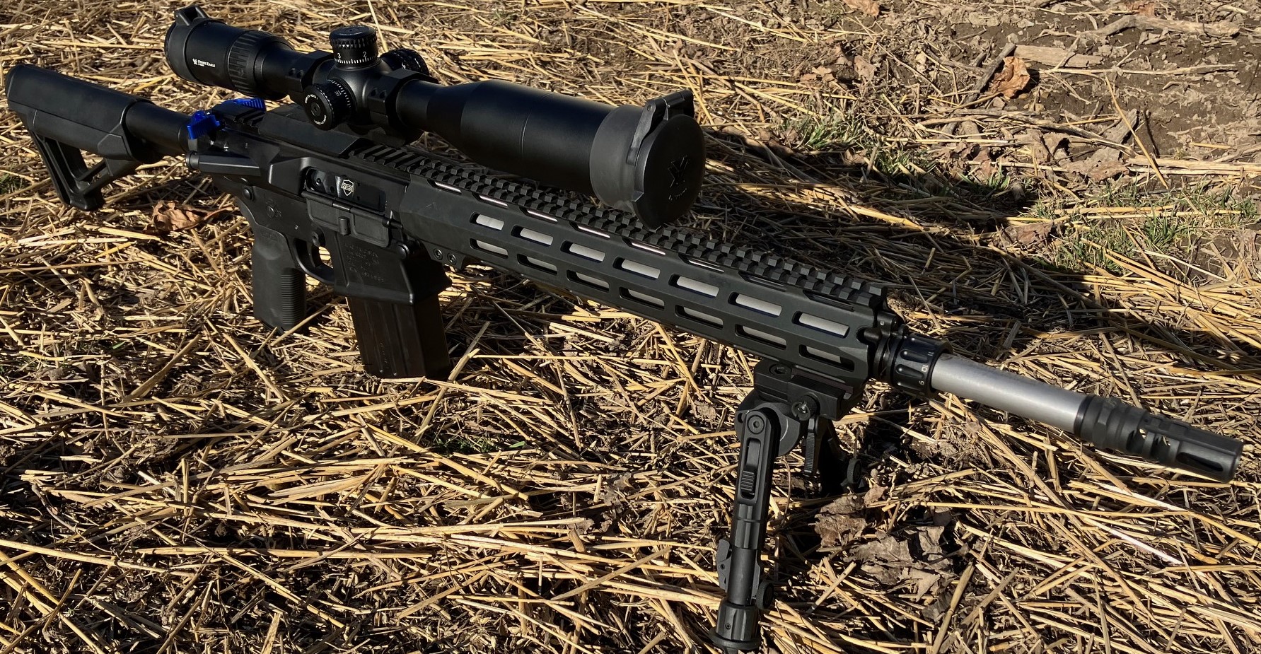

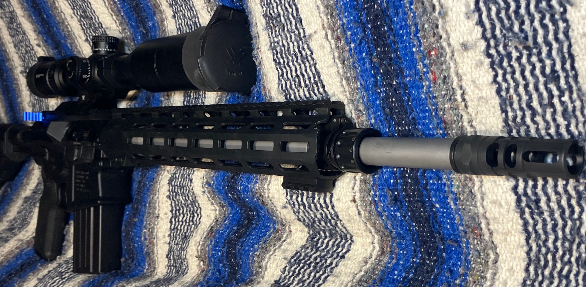

I have a Savage MSR15 2.0 with a carbon fiber wrapped 18" Proof Research barrel.
The adjustable gas block sits at around 14".
The current hand guard, which I want to upgrade, is 13.5" long.
So I´m thinking of the length the new hand guard should have.
Are there advantages or disadvantages of a 13"ish hand guard against a 16"ish one?

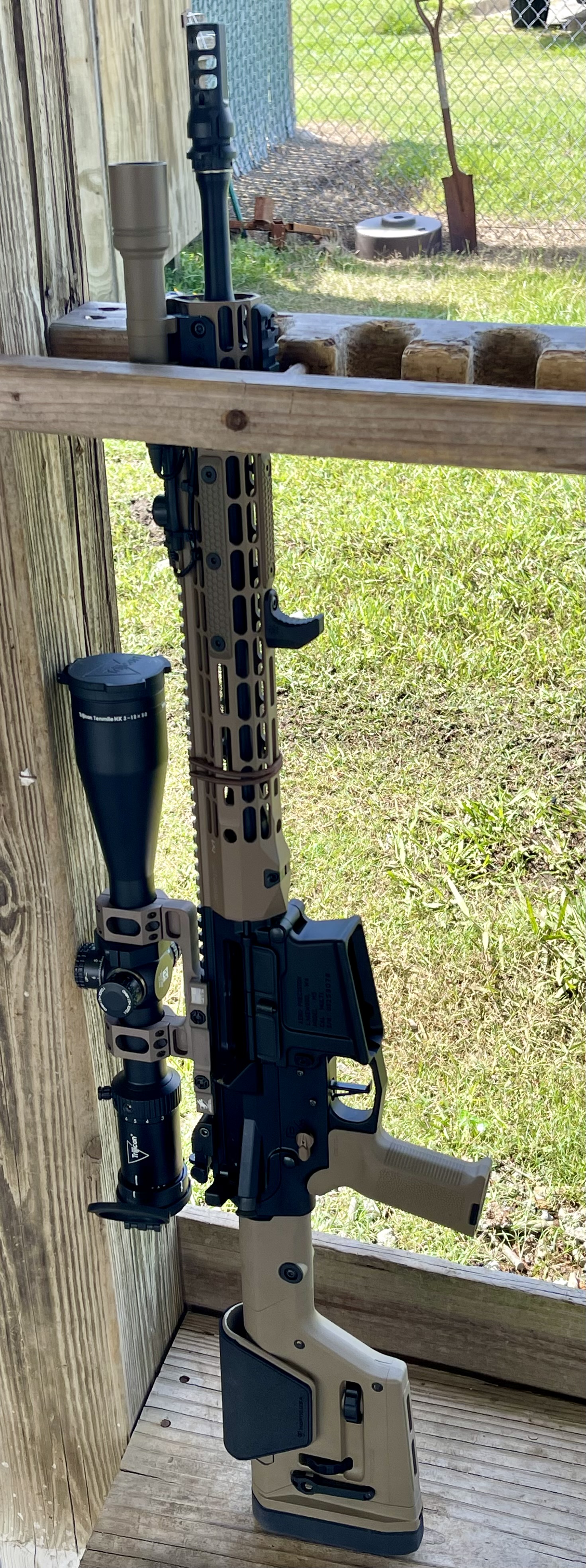

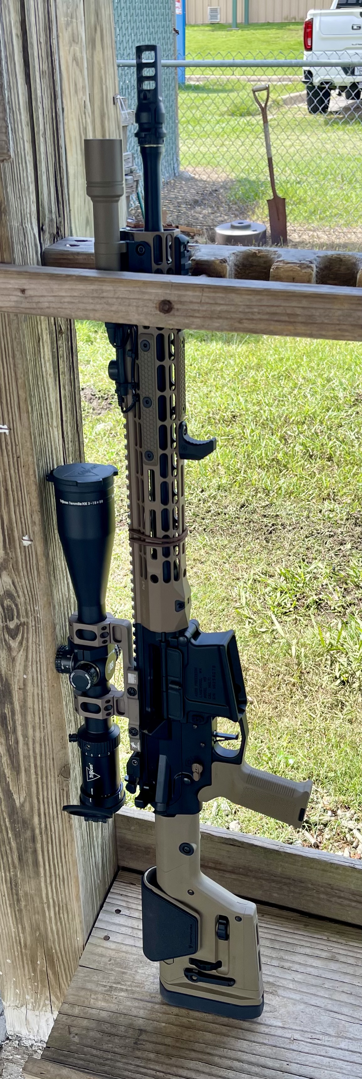

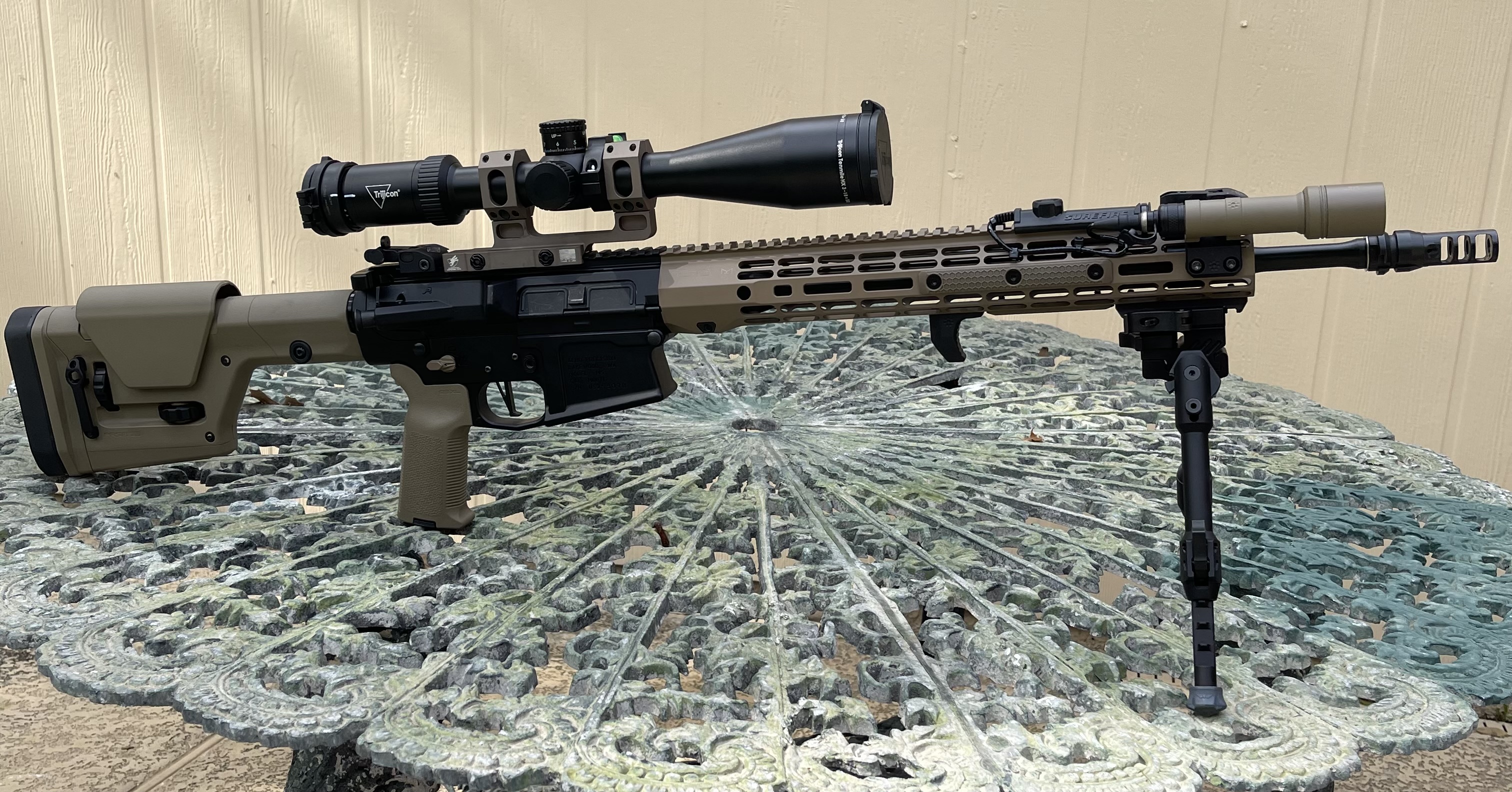

I’m not sure if this helps, but here’s an 18” barrel (308) with a 16” Aero rail. The gas system is rifle length. The Aero agb is about 2” inside the end of the rail. It sits right behind where the wood from the rack crosses over the rail.
If you look at the horizontal pictures of the gun sitting on the table, you can zoom in to the end of the rail and see the gas block just inside the end of the rail in line with the flashlight tail cap.

Same with mine. The gun I posted is a 13-14lb pig (unloaded). I’m really impressed with the quality of the Aero rail, but they’re not known for tier 1 rigidity. There’s zero flex with the full weight of the loaded gun up on the bipod that’s way out on the end of it.
