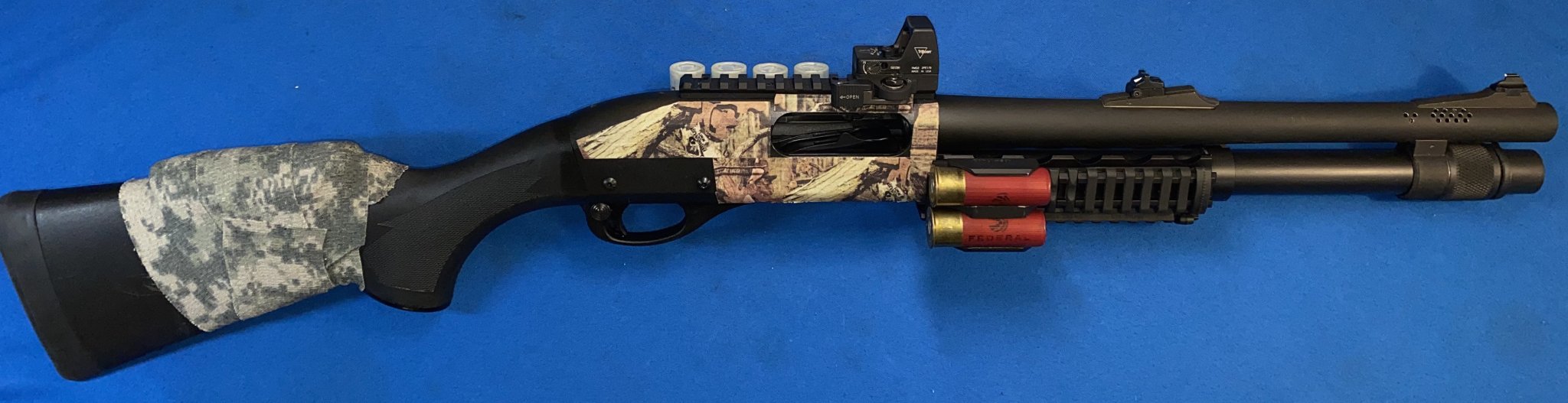

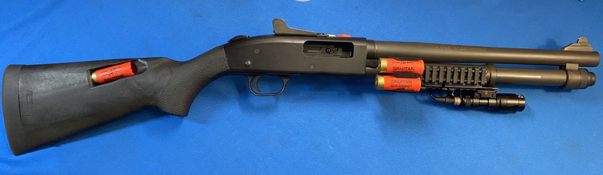

I have the Mossberg 590A1 in 14" with heavy wall open cylinder barrel and the Rem 870 14" Vang Comp ported, so no choke system in either..

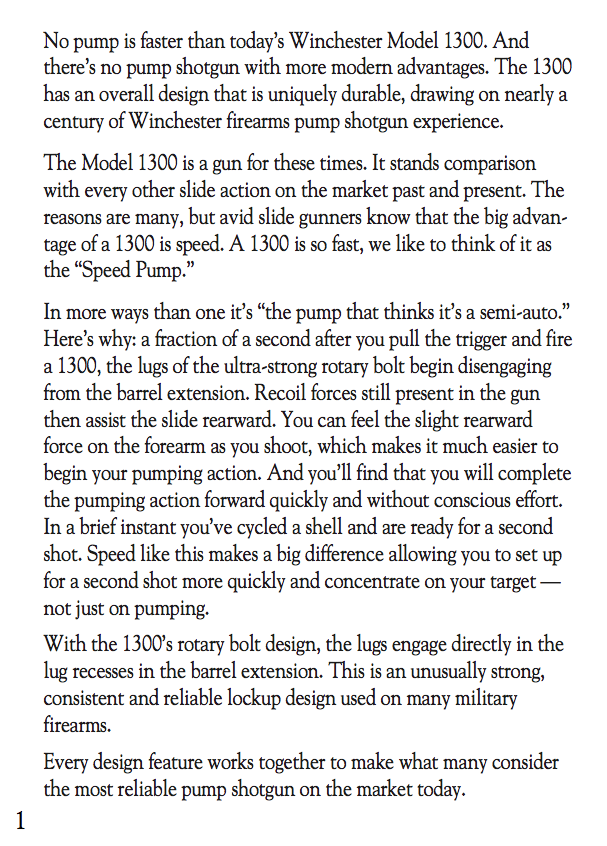

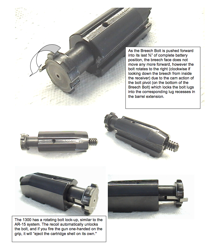

Look at the FN Herstal Police model; 18" barrel with threaded chokes. It is the shotgun the elite Rogers Shooting School uses for their advanced combat shotgun course; IF you can run the pump fast, it's easier to run an auto faster.

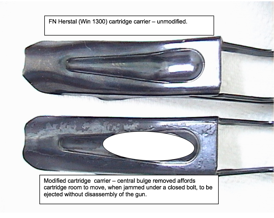

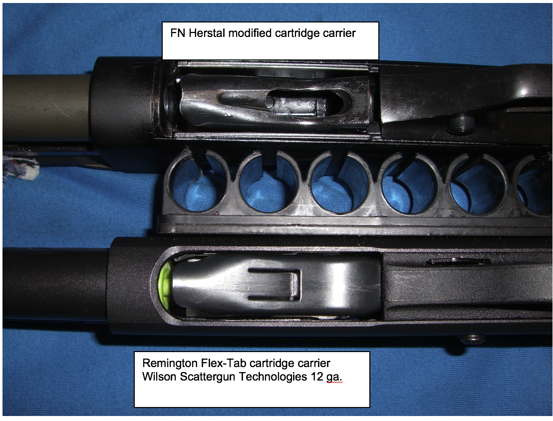

The design is the same as the Winchester 1300, "world's fastest pump shotgun" that uses a rotary bolt
system that will literally eject the fired round when shooting one handed. I modified the carrier to remove the "hump" so it could never lock up the action if you short stroke the pumping......for the same reasons Remington introduced the "flex-tab" carrier.

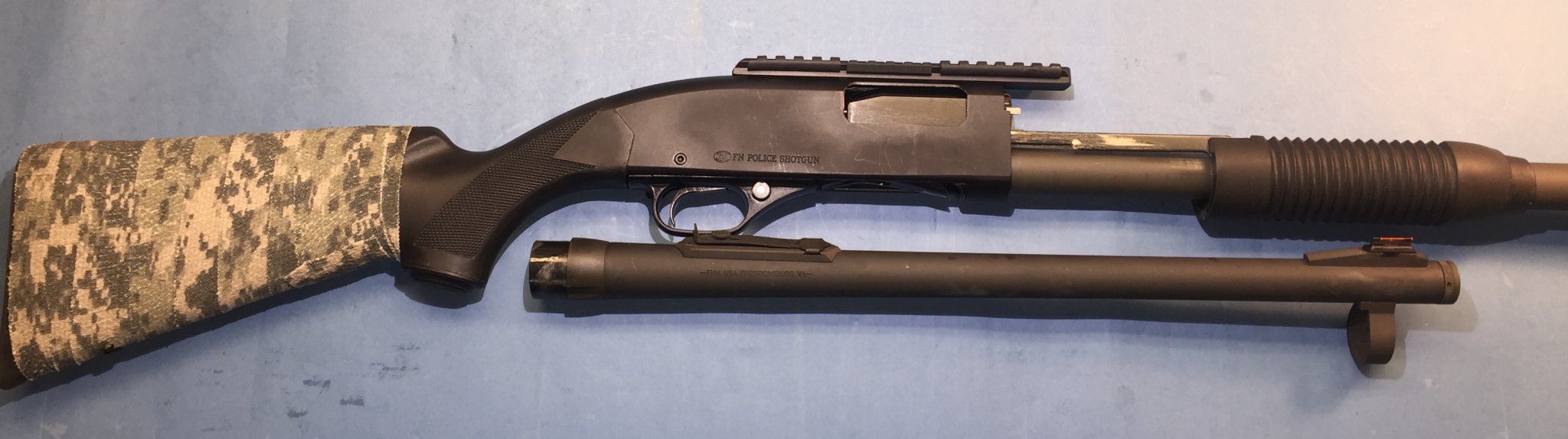

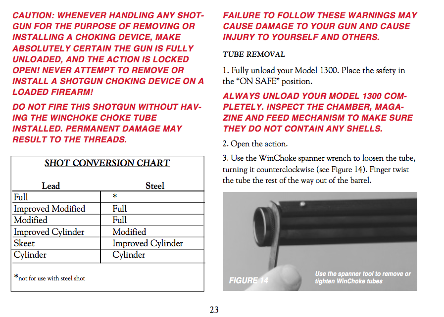

Here's mine.
