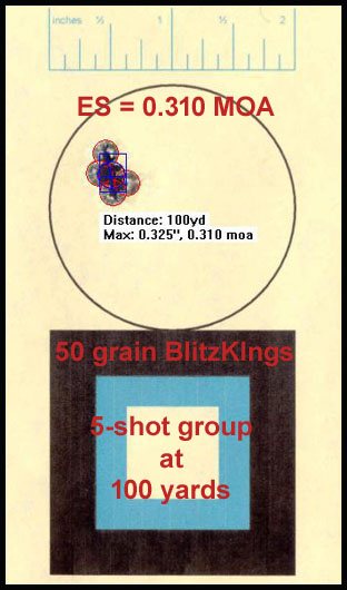

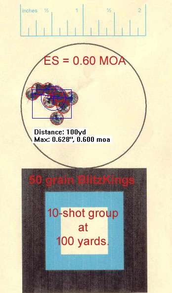

I mean I was a little surprised I just figured a 1:7 wouldnt like a factory 50gr the best out of a ton of different factory loads.
Contrary to what the Internet Commandos say, quality light-weight bullets can produce excellent precision at shorter distances when fired from semi-automatic AR-15s with faster twist barrels. The groups pictured below were fired from one of my Krieger barreled AR-15s using 50 grain Sierra BlitzKings.
I had no doubt that lighter bullets can be extremely accurate. I suppose the fact that it was very hard to get a bolt gun with a twist faster than 1:9 for many years made me skeptical as to how well lighter bullets would do in a 1:7. It seems the industry has just been behind in this respect. I am definitly glad I gave the 50 grainers a shot. I dont see the point in getting a .223 with anything other than a 1:8 or 1:7 unless your doing something weird like only shooting 40gr varmint bullets at max speed.

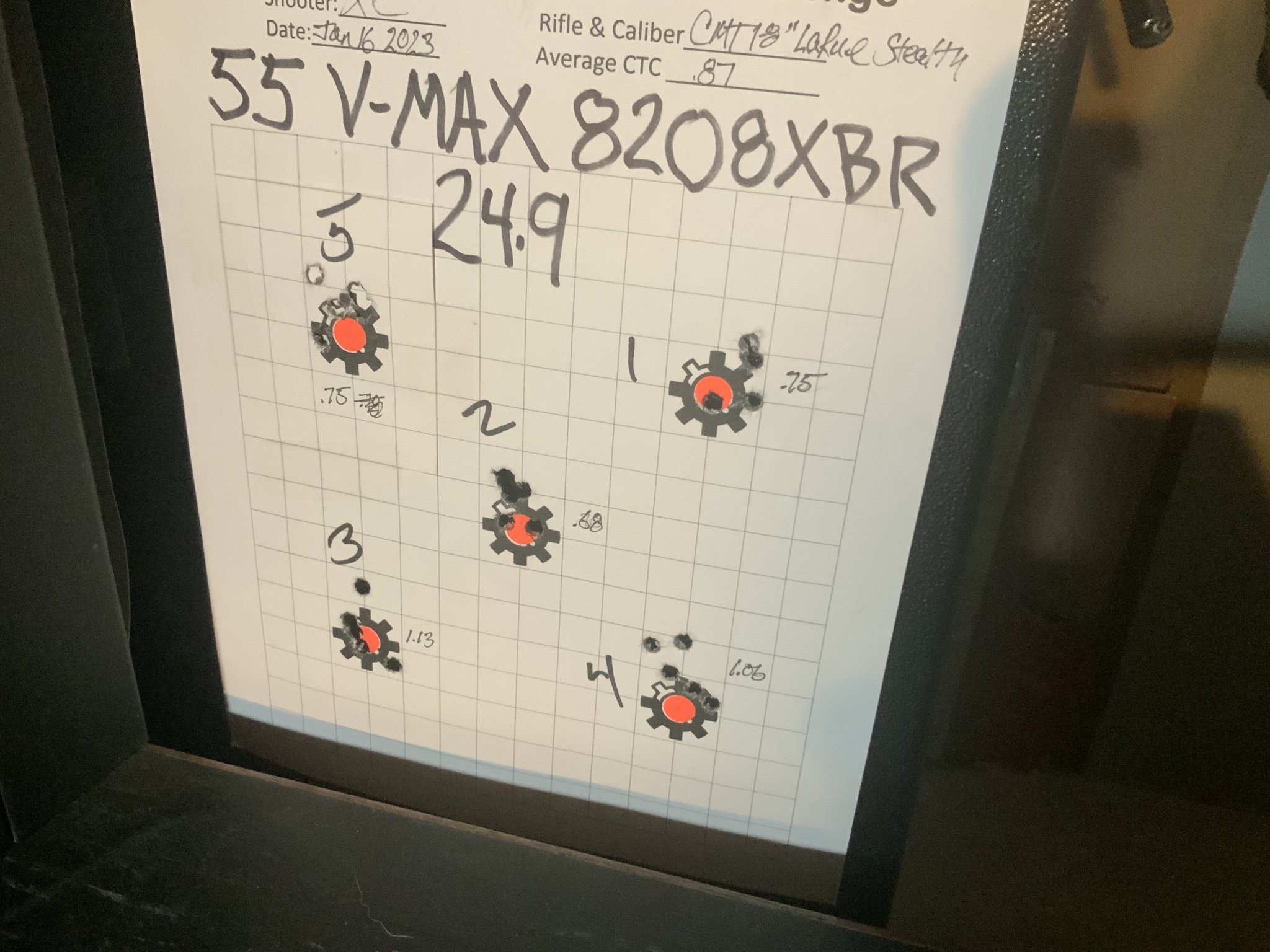

I have a 18” SPR I build a couple of years ago. I’m using a LaRue Stealth barrel. It shoots 69 and 77 gr SMKs well enough, without checking my records I believe it’s around .6 MOA. I was following YouTuber “Johnny’s reloading bench“ and started experimenting with other bullets. The 55 gr V-Max did surprisingly great. Way cheaper then SMKs.
