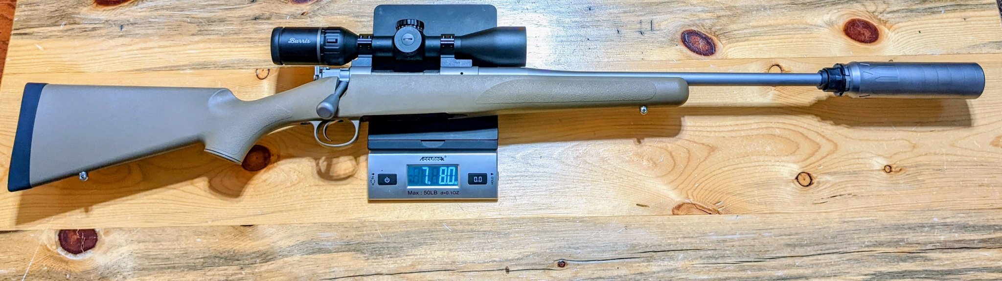

Don't know if the OP for this thread cut his, but this one was cut a couple years earlier to 18.5".
Peak pressure on a rifle cartridge is in the first few inches of bullet travel, the myth of just shooting unburned powder out the end of an 18" barrel is silly. It works fine, shot this elk at 320 yds with the 180gr Accubond load mentioned above. Personally, I practice 500yd hunting shots and below, and haven't had to take one on meat over 375. If you're planning on shooting way further out, '06 might be running out of steam, don't know, thats not been a problem for any hunt I've been on.
I'm getting a 300 WSM to cut down to 18", play with a while then get a 19"-20" 7mm PRC prefit, but those are just because I want to. My '06 isn't going anywhere though, and the total lack of WSM brass, and rare ammo has been eye opening so I don't know that I'd recommend that route.

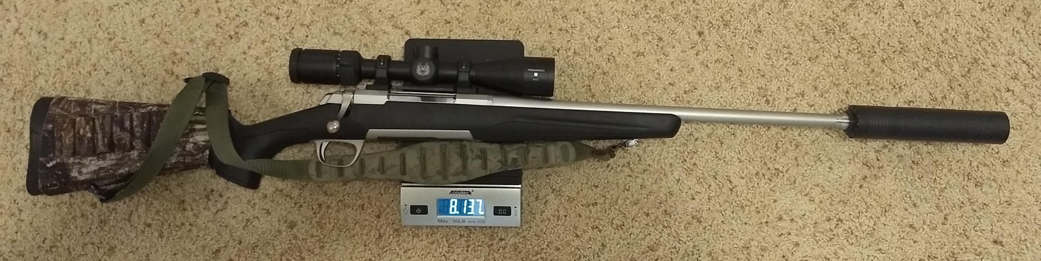

Edit: Here's a closer pic of my '06 as well as a 17" .280AI I had that also worked very well, in spite of all the folks that would proclaim that you really need 26" for a .280ai.
Reactions: Superjet
Does that carry well muzzle up with the sling? My biggest bitch is mine is always trying to pull back off my shoulder. I basically have to keep a stiff hold on the sling always. If I carry it muzzle down it catches shit because its so long. Losing 4 inches seems like it could solve the problem. Most of my shots are close but I do occasionally have to reach out. Shot a cow at 480 this year. 600 in perfect conditions is about as far as I'll shoot at a critter. After dumping 2 elk now with an anemic 6.5 Grendel, Im confident an 06 will dump them at 600 if need be.

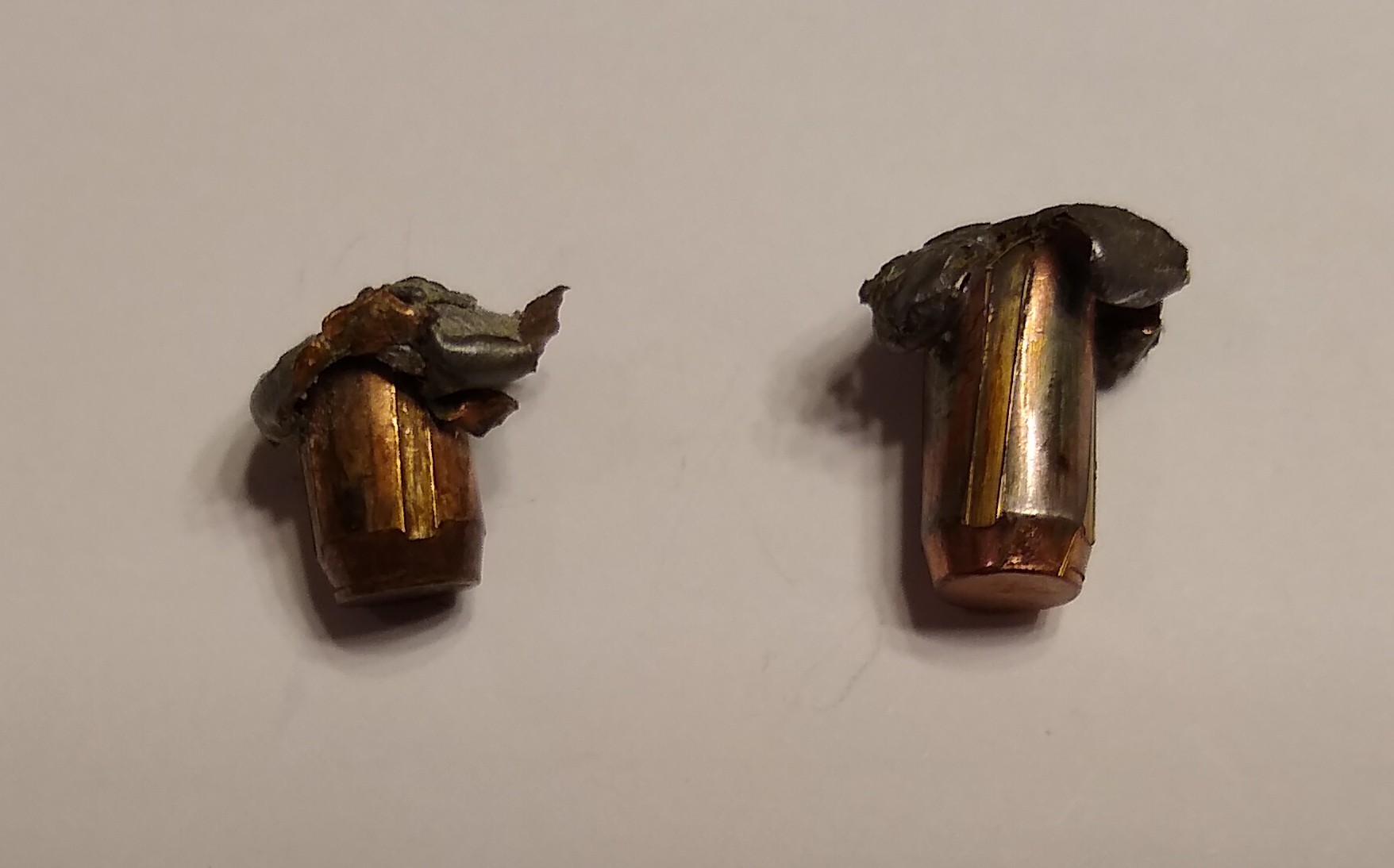

I actually caught both of the 180gr ABs I fired into that cow. Both made nice wide wounds, about 5 inches apart, busted some bone and I found one under the skin on the far side of the chest, and the other (more worn down) in a tenderloin after cooking it a year later. Lol.
