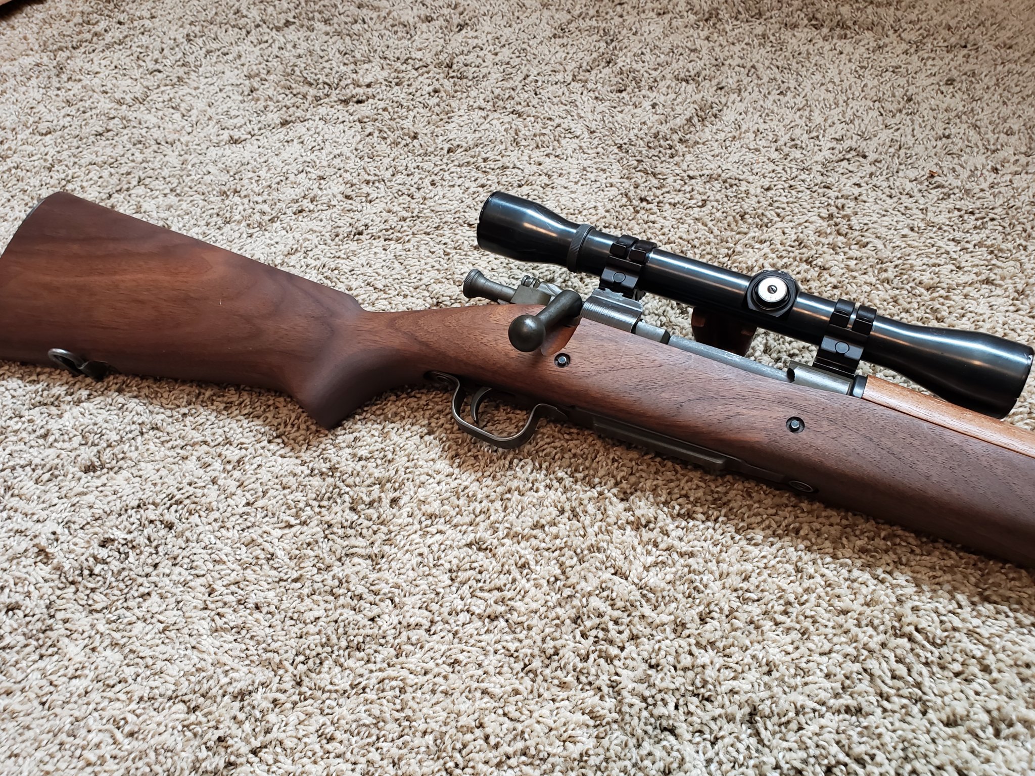

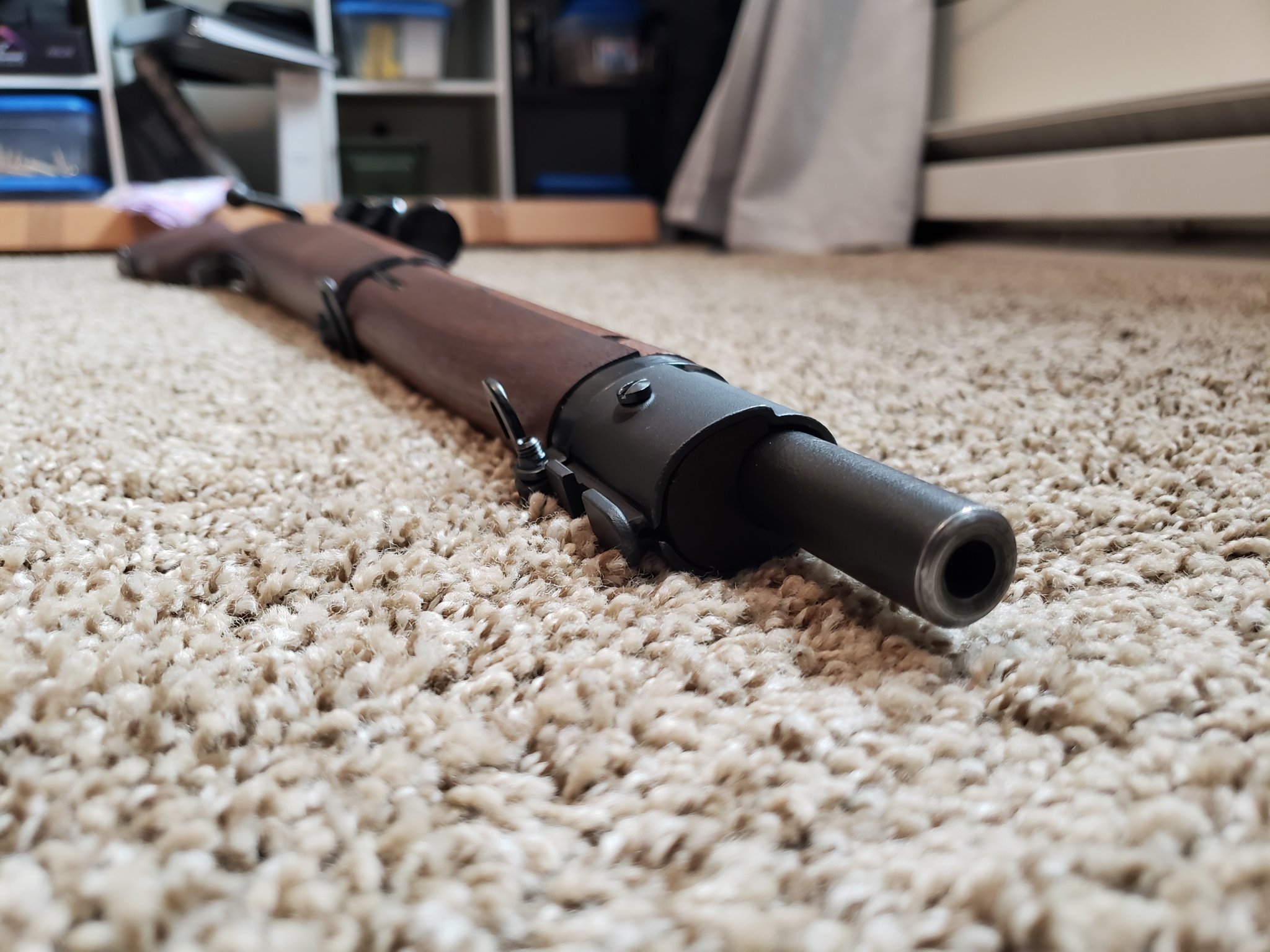

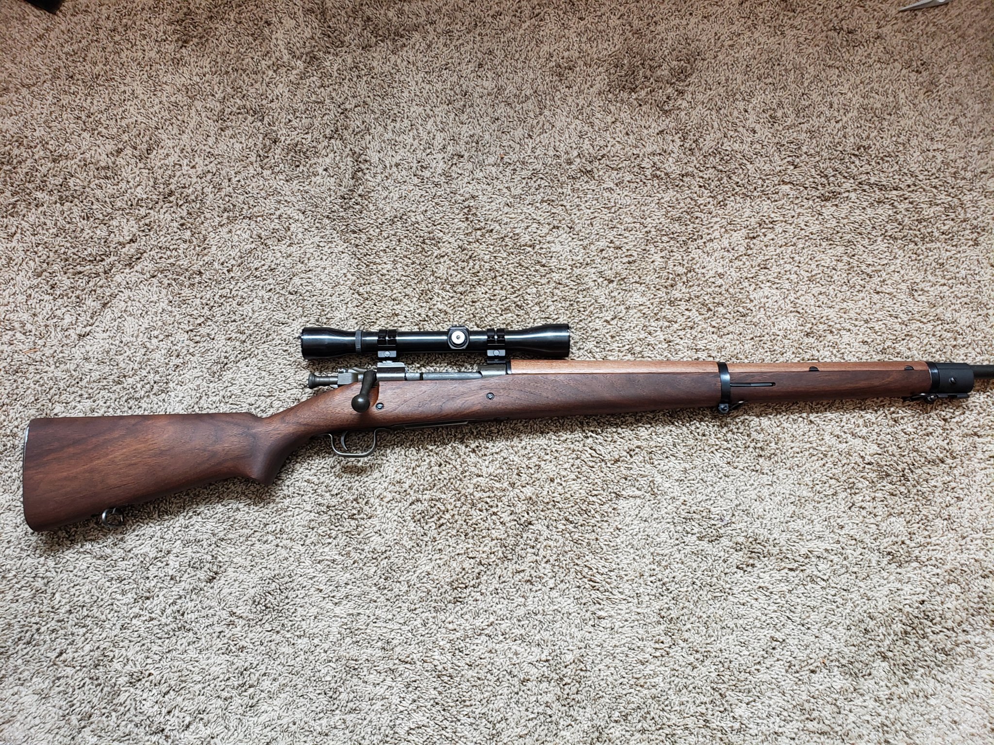

And if nothing else here is a pic of my rifle I am currently working on. Remington 1903a3 sporter that I restocked, waiting on metal bands to throw it all together. Ordered the new stock from the CMP and it came with the 03 hand guard. Have an 03a3 handguard on order that should have clearance. The barrel on it is stamped RA 2-43. 4 groove that seems to be in decent shape. Allegedly it has a 1:10 twist from what I've read online but I'm not versed super well on all the history of the 03s and their variants.
Reactions: sandwarrior
Also if anyone is curious on everything and cost. I found the rifle at a pawn shop for $200. It was a shitty sporter job. They hacked up an old scant stock and literally had pieces of tape holding parts on. Took the barreled action out and cleaned everything out. Ordered a 1903 c stock from the CMP estore for $173. I ordered a stock band kit for approximately $65, had the upper lower and stacking swivel bands, handguard retaining ring and lower band spring. There is another stock band kit thst comes with a buttplate for like $50 on sarco. I ordered from numrich. I also have a complete replacement bolt and a 03a3 handguard on order. Bolt was $68 and hand guard was $40. And depending on how the barrel performs I may order a new criterion barrel for the $250 or $300 or however much it costs.

That is how she sits now, I need to stain the handguard as it is a lighter piece of walnut compared to the rest of the stock. Future upgrades are probably a timney trigger, possibly a new barrel depending on how this one shoots, and some new glass. Bought a shitty sporter from a pawn shop for $216. Bought a new c stock from the CMP for $174 that required minor in letting that I did with a dremel and a sanding wheel. Worked super nice. Bought a 1903a3 handguard to replace the standard 03 handguard the CMP stock came with for $40. Regardless the cmp stock and an additional handguard was minimum $50 cheaper than any other c stocks on the market. Bought some replacement parts for the bolt, like a bolt sleeve assembly and firing pin rod which cost me another $40 or so total. and all the required bands/metal hardware to assemble the stock which was another $50. So all in I spent $520 give or take. Receiver was already drilled and tapped. Debating if I should have bought one that wasnt and had a gunsmith do it. I mounted my luepold mk4 on top for shits and giggles, and Damn near had to max out windage to get a rough bore sight. Which makes me thing the bases or the drill and tap job wasnt concentric to the bore. However with the weaver k4 scope mounted the scope is fairly close to mechanical zero from what I can tell with a rough bore sight so who knows. Maybe my leupold rings are fucked up.
