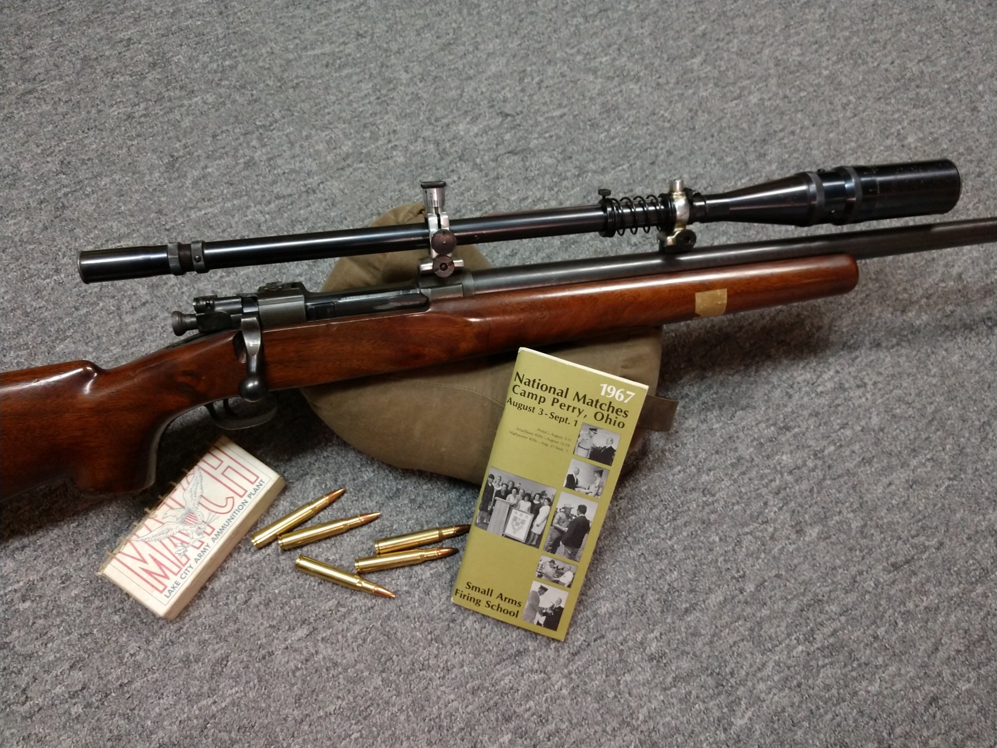

    As a former Jarhead who's obsessed with WWI Marine Corps history, I've been wanting a 1903 for along time, one in an original stock. It doesn't have to be a real original stock, but similar. Anyway, I own a couple of these rifles that I've mentioned on this site in the past. I was talked out by several knowledgeable folks, of turning these back to original form.
    I own all the original metal but never found the original wood. My wife's granddad used these at Camp Perry in the 50's and 60's. They're historical on their own merit for that era. He passed in 2000 before I got to meet him unfortunately.
    Quick recap for those that didn't see my other post about these, but granddad saved every single item from his days at Camp Perry. I have all his match books etc from the 50's to late 60's...even the one Carlos Hathcock won. I wish I could put this stuff in a museum and I even took it all to Camp Perry and showed it all to them, but they don't have a museum yet.
    Back to my original request....where can I get a 1903 Springfield? Preferably one with mounts for my Unertl scope, with the original style stock?
    I did take this 'beaut to the range recently and got her on steel at 300-yds.

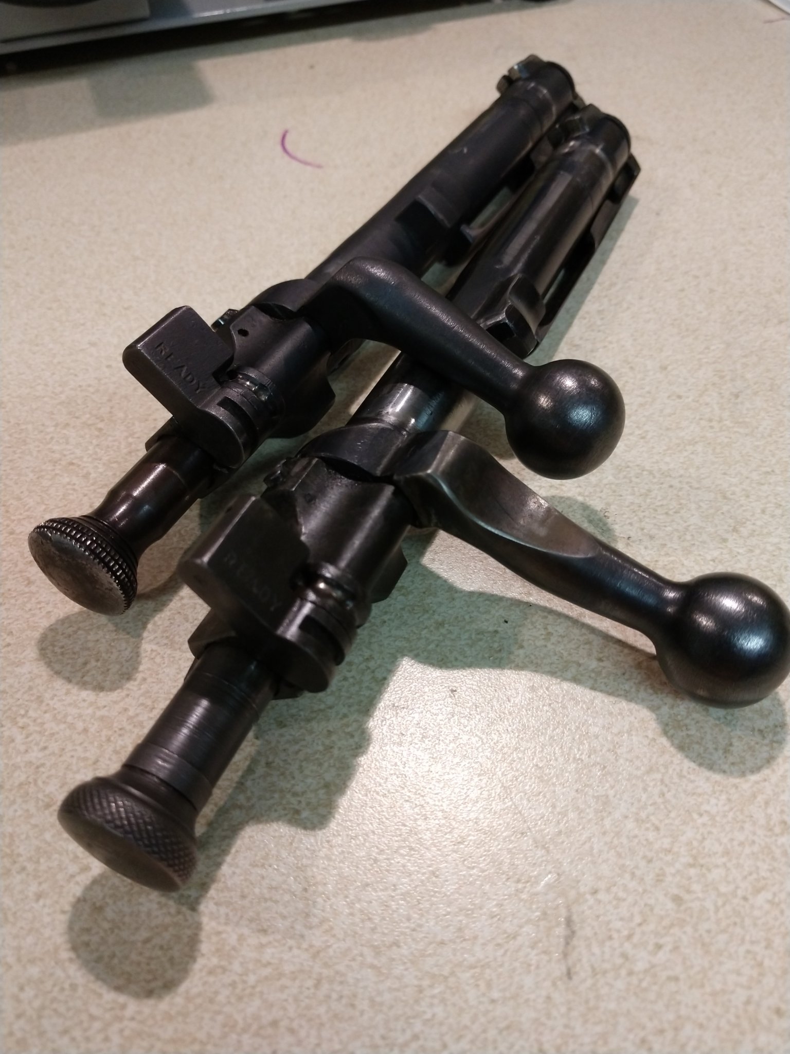

    Thanks for all the info so far, fellas....much appreciated! Quick question....the bolt handles between the two rifles I have a slightly different. Can anyone shed light on what I have here?
    The one on top, with the more straight-ish handle is off the rifle with open Lyman(?) sights and a star-marked barrel. The one with the curved/beveled handle is off the one pictured above with the Unertl.
    If the second one is a true A4 bolt it is worth some cash. Possibly a straight handle though so more likely scalloped outside the mil.

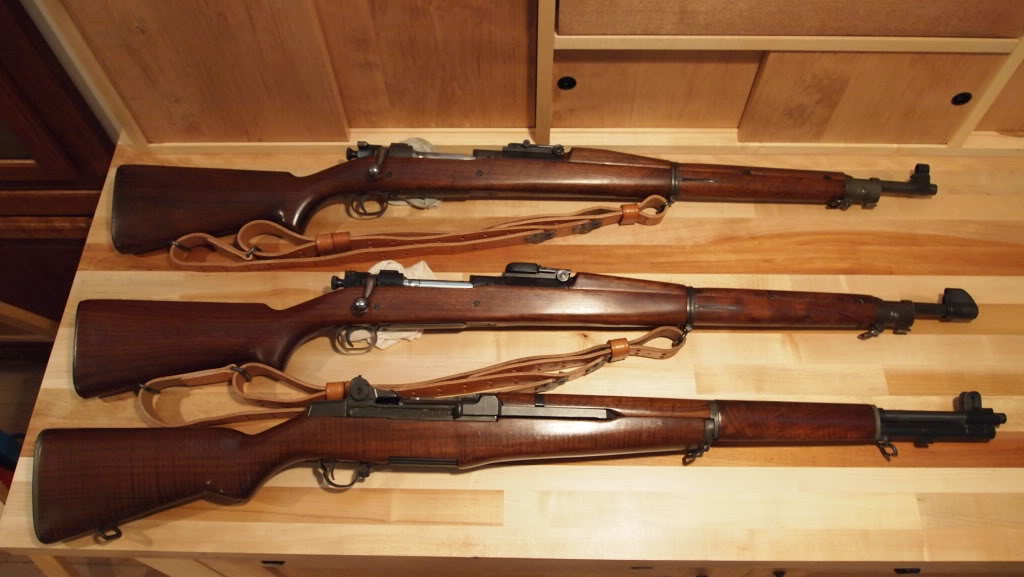

    Marines were less enamored of the "C" stock though both mine have them as they are a bit more shooter friendly. Old Breed Marines were not pussies like me.
    My girly man 03s and their fat younger brother.

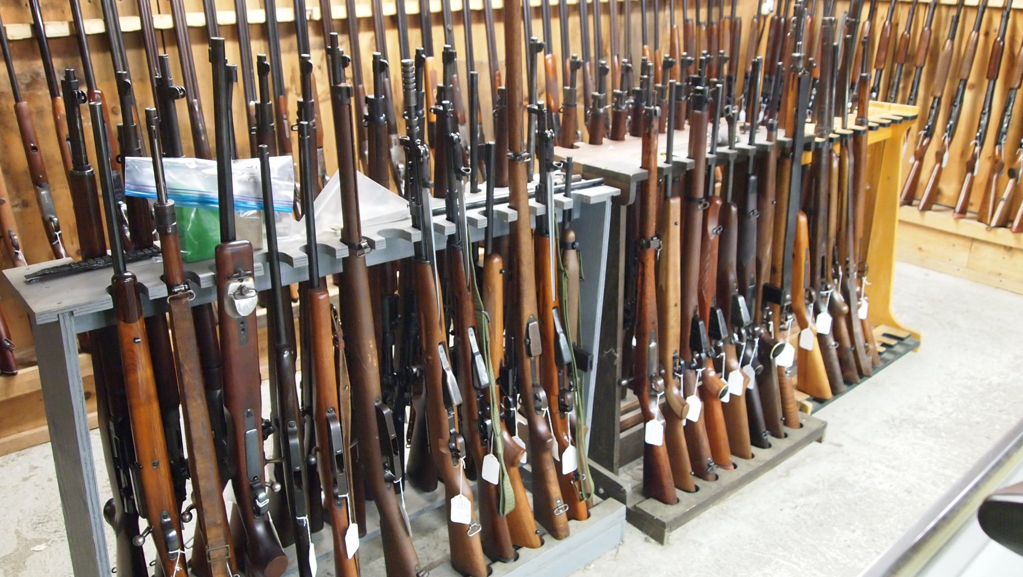

    I know a place.....
    Looks like a whole rack of 03s on the opposite side of this rack....
    Wow @pmclaine ! Where's that?
    *edit to add: I have a whole drawer full of original '03 hardware/parts. Like I've mentioned before, these rifles were bought by granddad after The War for around $15 (I have his receipts) and were "sporterized" for competition at Camp Perry. The only thing missing is the original wood. Since I've been talked out of reverting these back, and if I buy a complete rifle, what should I do with the old parts?
    Or should I maybe buy an incomplete rifle and build it with the parts I have? I'm leaning on just finding the wood and putting the '03 I have (the one with just open Lyman sights in a left-hand stock) back to it's original form. Would rather not sell off all the original hardware. Decision, decisions....

    That shop I sent a picture of has lots of 03s.
