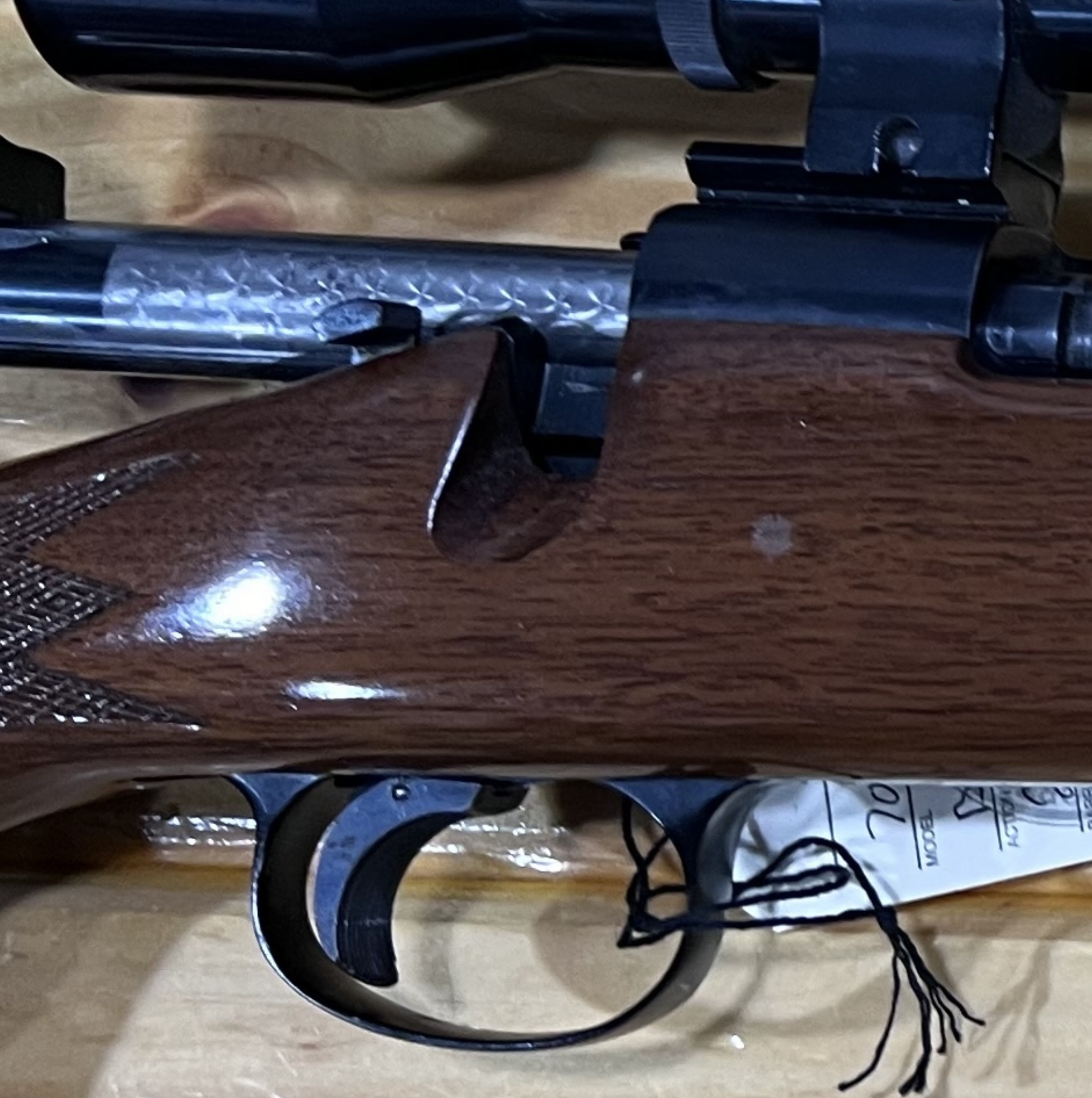

I don’t expect positive ID or 100% affirmation. I’d just like to get a sense of the features on this customized, 1980’s Remington 700 I’m considering. I’m just working off sellers pictures and description.
My questions are:

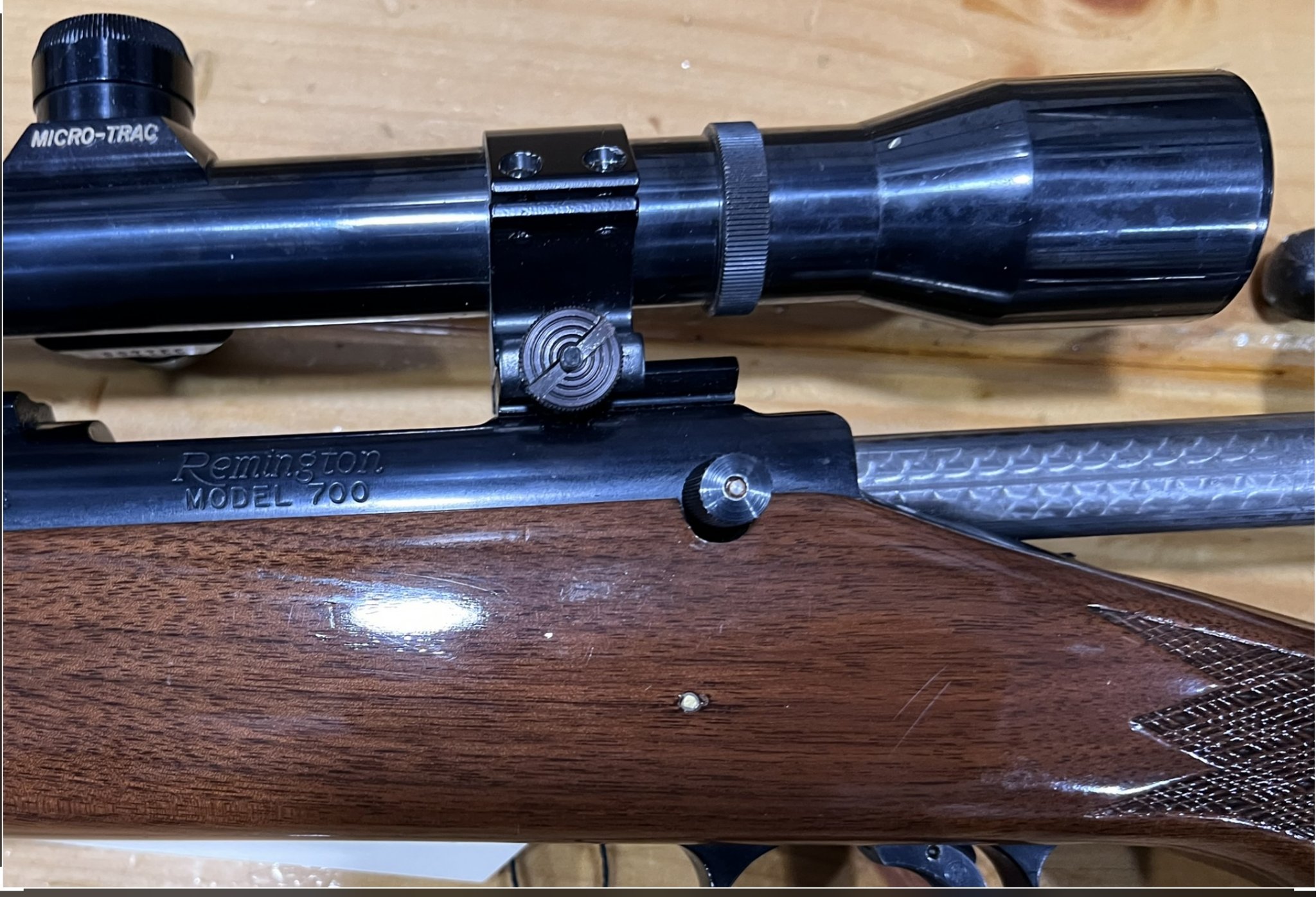

Is the side bolt release shown likely a premium install, or was that something from Brownell’s that could be DIY with a Craftsman drill at the kitchen table?

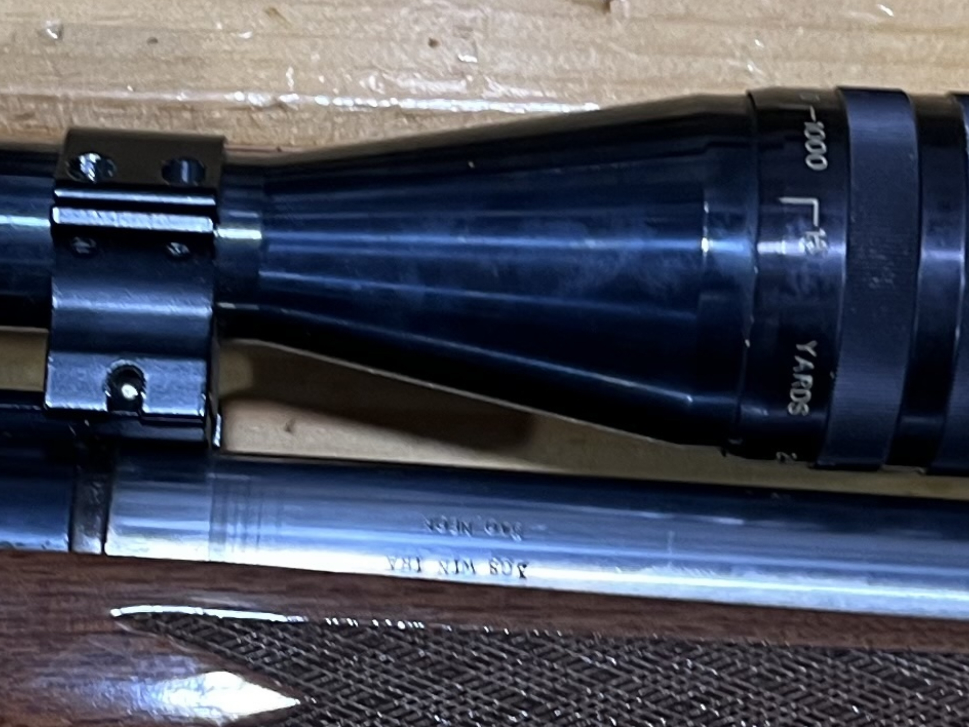

Do these barrel markings spark any thoughts? 30(?)NEON or NECK maybe? I’m guessing the other stamp is the barrel installer’s. The seller said it’s a Hart Stainless in 308.
It’s got a period Weaver Micro Trak, so I’m guessing it was someone’s Varmint rifle or maybe for some competition. He thought enough of it to install a premium barrel and scope. The rest of the rifle looks like standard BDL except for a trigger shoe. The price is reasonable if the barrel isn’t shot out. Any input is appreciated. My gut says buy it, but I could without it, as well. Am I missing any red flags?

Side release would be a negative for me. I have never been able to figure what’s wrong with the factory save I could see it being a weak point if you tend to run your bolt hard to the stops aft and fore. I like I messed with receivers save they are clip slotted, setup for a lugged scope base and cut per USMC spec at the ejection port.
If price is rightlooks like fun Gun.

That bolt stop is a benchrest artifact. Was very common with sleeved and glued in actions.
Better pics of the barrel stamp would help id what it reads.

$850, asking price. That’s why it caught my attention. As you say, “Looks like a fun gun” It will just never be a M40 donor for me because it’s got the B prefix. I hadn’t thought about the side release as used for hard stops. Maybe this rifles seen a lot of rounds in rapid fire. I not familiar with the competitions from those days.
Artifact says it all. Thanks for the insight. I never heard of “sleeved and glued in actions” but I guess it was a bedding technique the BR guys used. That’s the best zoom I could get of the barrel stamp. It located over on the right side, so reads upside down if viewed from the bolt side of the rifle. That makes me think it could have been rechambered and set back. Or whatever they do to freshen up or reuse a barrel.C9E1CCAD-A49E-4849-91F6-856D4413D171.jpeg65D8E540-A419-44DF-AADA-49972791AC61.jpeg
Artifact says it all. Thanks for the insight. I never heard of “sleeved and glued in actions” but I guess it was a bedding technique the BR guys used. That’s the best zoom I could get of the barrel stamp. It located over on the right side, so reads upside down if viewed from the bolt side of the rifle. That makes me think it could have been rechambered and set back. Or whatever they do to freshen up or reuse a barrel.View attachment 8310580View attachment 8310584
Id agree its likely been set back. Even slipped in the barrel vice it appears. Id pass on it. Just doesn't seem like a good value to me.

Custom side bolt release’s were pretty standard on XP-100’s, which had no external release (took a small screwdriver slipped between the bolt and the action to release the bolt). So, the technology was a pretty standard type modification during that time period. On a 700, it would be a more convenient way to release the bolt. Not a serious issue.
Jeweling on the bolt looks pretty good. Seems like the jeweling is worn/heavily worn on most guns I run into from that era (lots of cycling/no lube). Doesn't look to have been used and abused. May have went straight to a rebarrel not long after it was bought. Depends, if your into vintage stuff I'd think pretty heavily about picking it up. Looks well kept, and not abused. I like vintage 700's.
