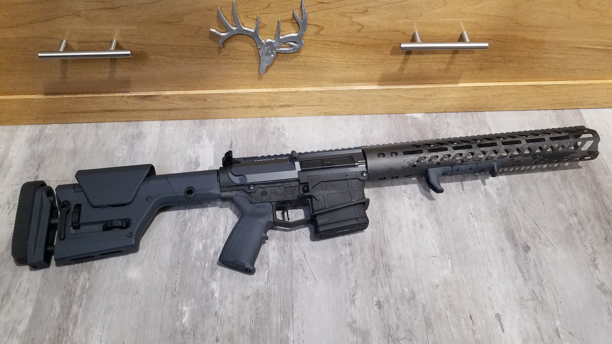

Hello,
I have sloooowly been getting components,which most were ordered last May thru June. Hoping to put together this LR308 in 308win real soon. Once barrel arrives in next couple of days i'll be able to mount up for a picture.
JMT carbon50 lower reciever
Juggernaut Grey upper reciever
Juggernaut charging handle
Magpul PRS Stock Grey
AR Stoner h-duty rifle length buffer tube
CMMG "custom lpk"
Triggertech AR10 comp 3.5# trigger
JP Enterprise:
* Supermatched 20in barrel &
headspaced enhanced bolt.
*Adjustable 2peice gas block
*LMOS bolt carrier
*Silent Capture Gen2 H2 buffer
Magpul grip in Grey
Smoke carbon 15" handgaurd(w/ rail)
Strike Ind. Comp King brake/flash hide
Thinking hard on NV scope like Pulsar digiscope an replace brake for a suppressor. Was told the new e-file for suppressors should speed up purchasing to 30days. Hope that can happen.
So with 125g sst for coyote and larger longer bullets for paper is my goal here day or night.
Thanks for any thoughts.

30 days? Be lucky if it’s 90 days.
You didn't really ask any questions, so is this just asking people to roast your parts crate? Looks fine I guess?
I haven't heard anyone claim the efile will be 30 days. I heard more like "optimistically" several months, down from 9 months to a year.
Even though it may all say "DPMS", mixing lower and upper manufacturers is a gamble, especially with a 80%. Same with LPKs.
Be aware of the difference between DPMS "high" and "low". I don't know if your upper and handguard are compatible or if it's applicable.
That barrel has a 0.936 gas journal. That 2 piece AGB won't fit under all rails, no idea about the Smoke.
Some ambi charging handles will hit the cheek riser on a PRS Gen 3 (and Lite) stock. Don't know if the Juggernaut is one of them.
That JP Silent Capture might be an issue, it will probably need a custom spacer or cut down the supplied one. I would contact JP for advice.
Low mass actions can be a pain to tune, especially when using a large range of bullet weights. Good luck with the build.
Reactions: Runnineh
My dad built an AR10 from various manufacturers without researching much first and that had all sort of issues. I finally got it unfucked over Xmas. Personally, I'm glad I bought my LMT as my first 308 AR instead of building. I don't think some people understand that ar10s are not standardized like ar15s and they just dive in.

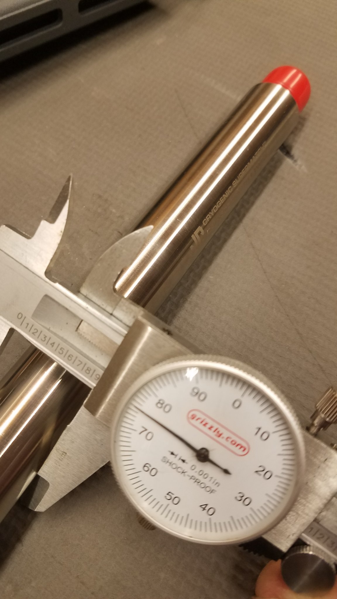

So I gave up on USPS an asked the site I ordered from for options. They sent a second barrel by good old UPS an had it in 3 days since they have some instock. I thought awesome, but come to find the barrel machining at the journal is smaller than advertised. What the hell. Now waiting to hear from JP.
Maybe i'm not understanding some thing with this dimension. I just want to find out is this difference intended or oopsed and does it affect this 20" super match 308win barrel. Advertising shows spec for .936" for what I thought blocks like JPGS-8 would be designed for which I bought last May for this project. Except this newer 11twist barrel is milled down to a .875" spec. Nearly flattened to the forward contour.
You think it really matters since thier shorter thinner barrels are at .75". So annoying. Any advice on this would be great. And I have a feeling i'll have a new in box JPGS-8 to sell maybe.
Thanks
Thanks
What part is wrong?

So got confirmation the 2022 20" Suppermatch 308 barrel's gas journal specs were dropped to .875" due to parts consolidation. They haven't updated the website yet. So I ordered a new gas block. The quality better out way the b.s. so far.

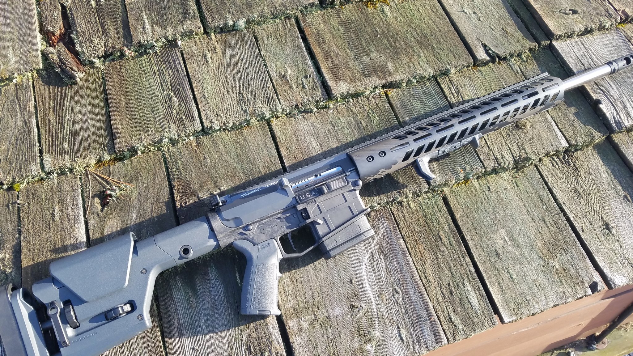

This first rifle project is so slowly coming together. Monday the new scope an BCG pins are supposed to be on my doorstep. Crossing my fingers.
Also thanks for the advice on the MI rod. Felt very secure and proper getting everything torqued.
