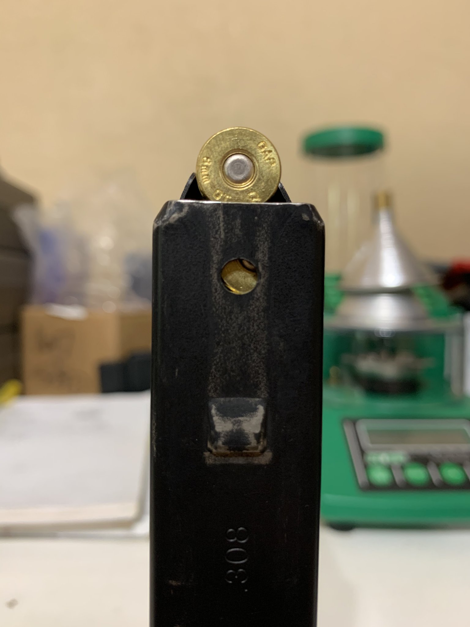

Thx for all the info. I did as a guy recommended and sand them both down. I have I mdt and one aics. Here is a pic with a round in each. The left is mdt right aics. Is this the correct height for the bullet to sit?

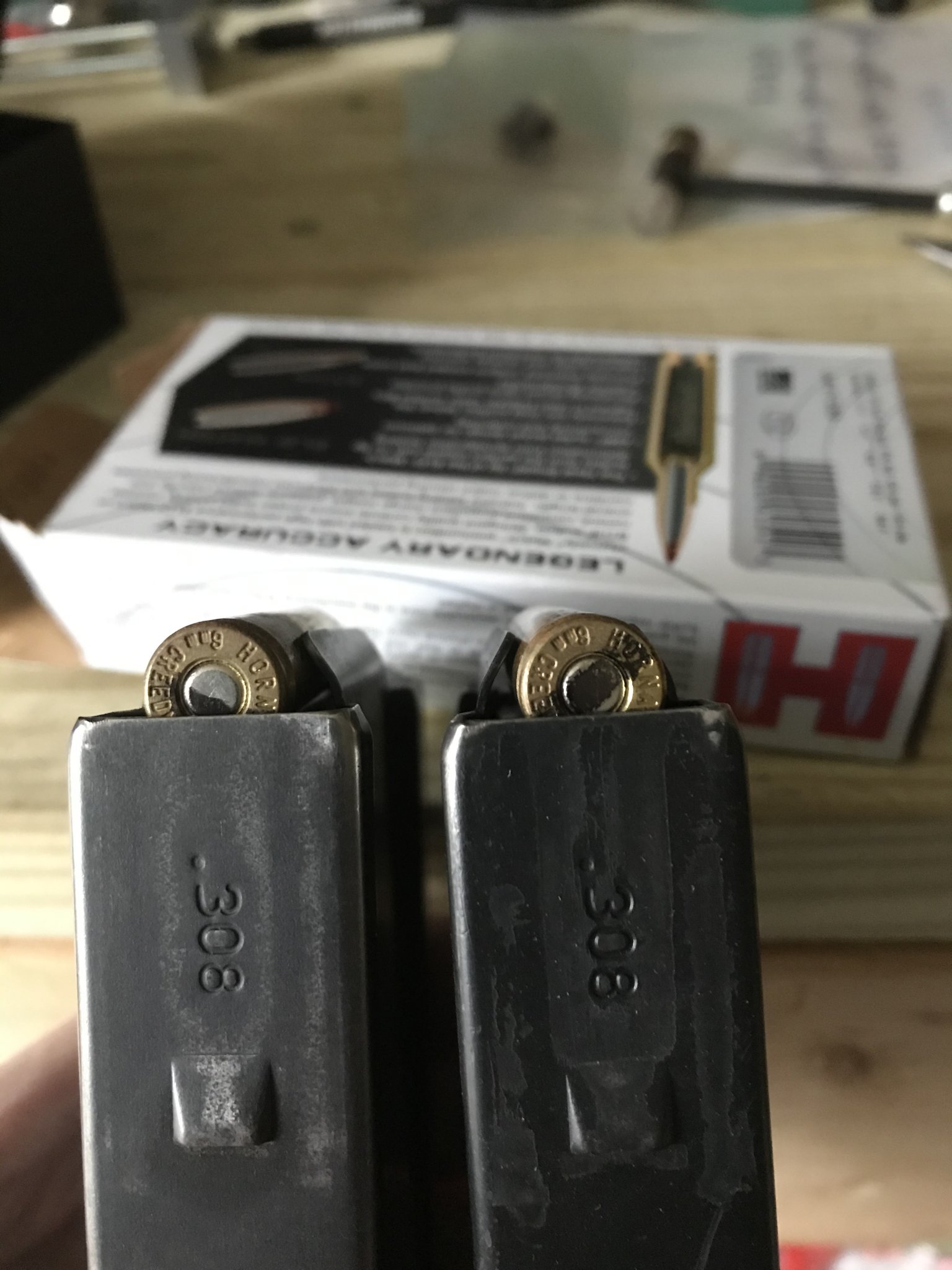

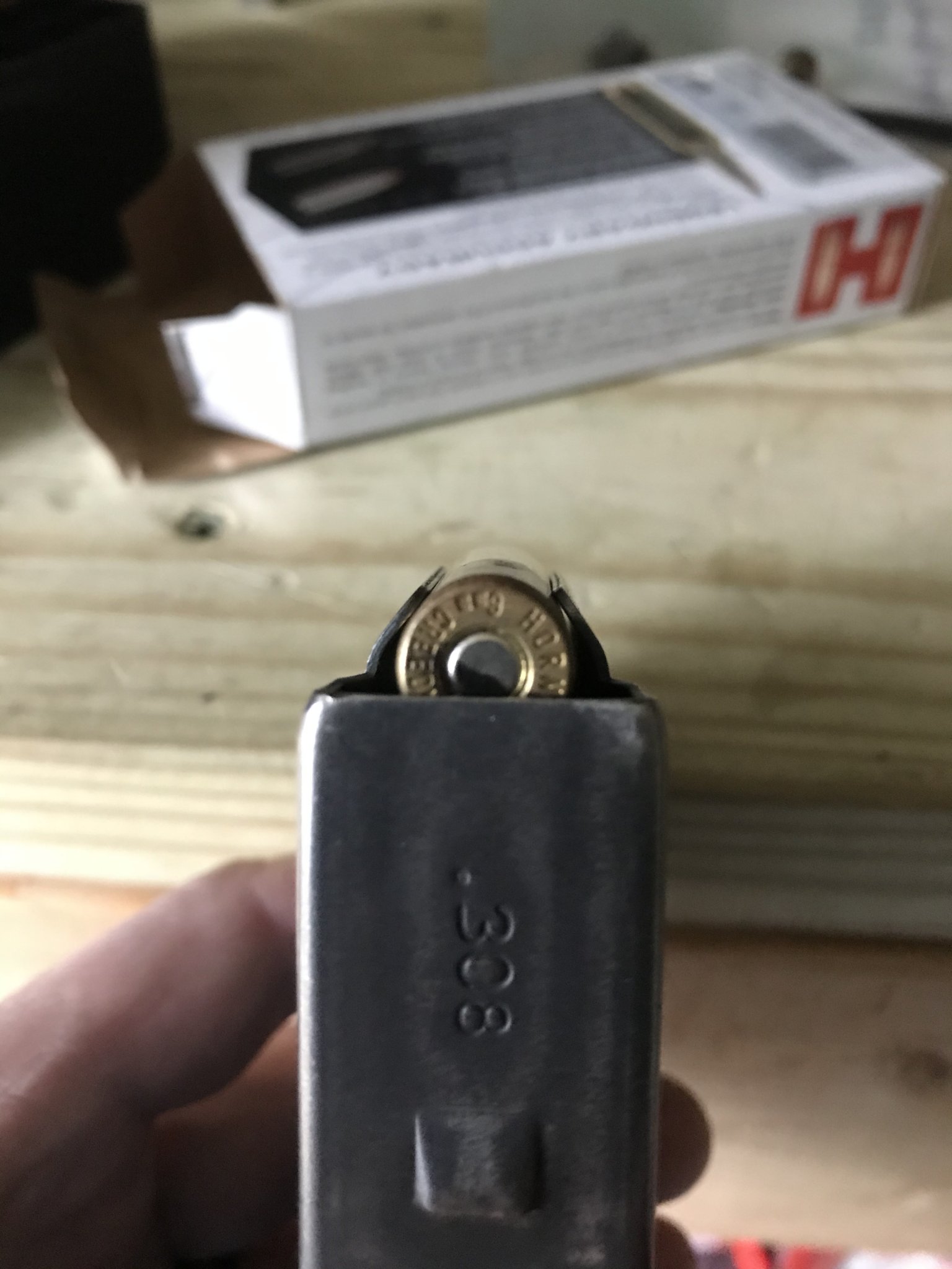

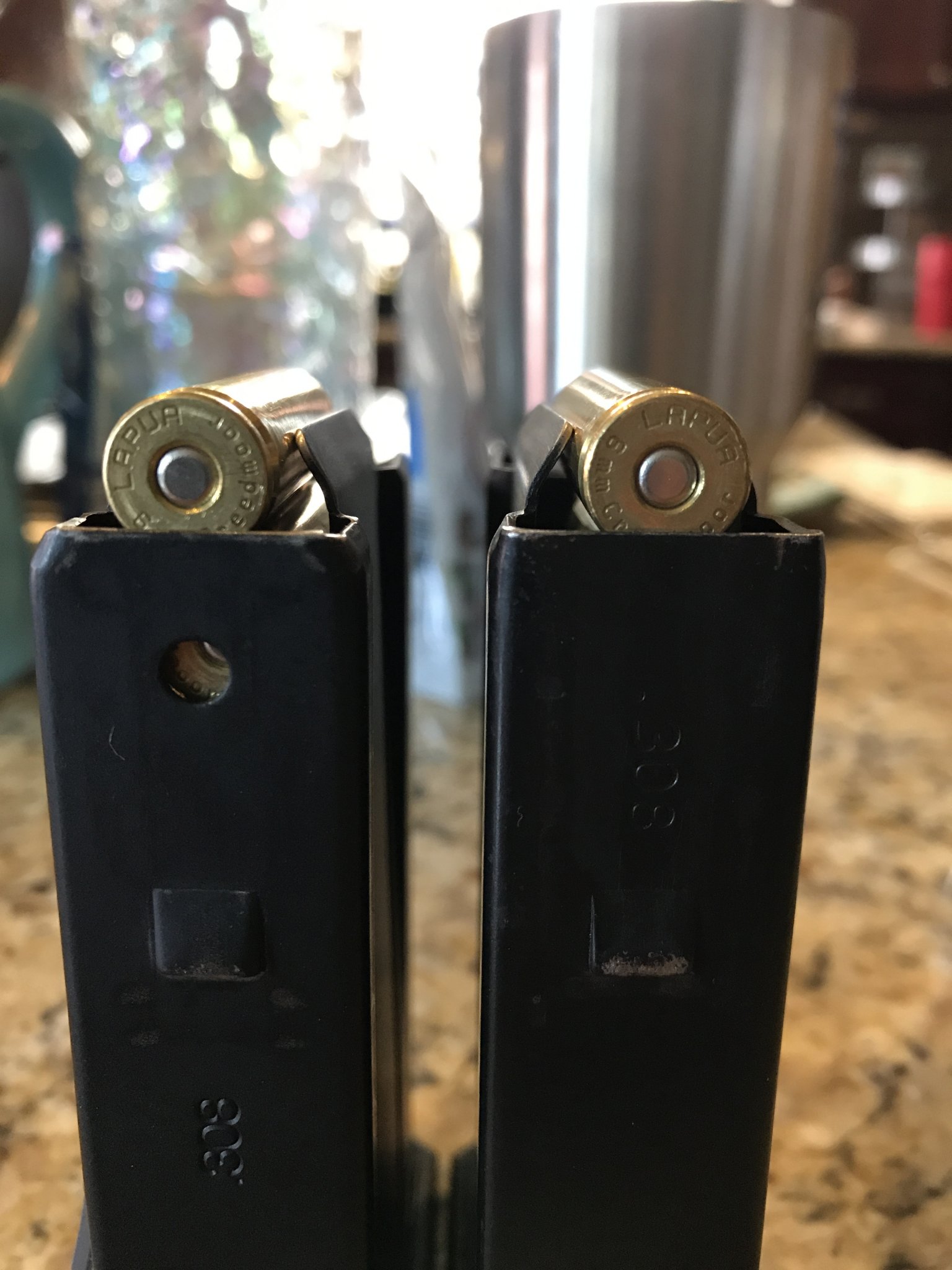

So in the video Phil has his sitting a little higher or so it seems. He didnt really say where the right height was. He just said to get it to sit higher do this. @Rob01 shows his sitting down with some of the primer below the back of the mag. Is that that the correct position or is different for each gun/action/chassis/stock. Phil also talks about them being the same front to back and not flaring the front out a few thousandths.
On my Impact 6.5cm I just about line up the bottom edge of the primer to the top edge on the back of the magazine, with properly spaced and even feed lips. I've had zero issues feeding, and runs really slick. For reference, I put this rifle together myself with a barreled action from Altus into an MPA chassis.
It depends on the particular stock thats holding the particular bottom metal thats holding the particular mag thats holding the particular ammo.
I wonder if we were to remove the bolt and look through the receiver to visualize a loaded mag to judge how high a cartridge is supposed to be? My Rem 700 I see the top edge of the (LR) primer pocket. It runs fine, but is that the optimum height?
LRI likes to have the primer and the chamber look like a figure 8 with the bottom half being the primer circle and the top half being the chamber circle when viewed through the action from the rear.

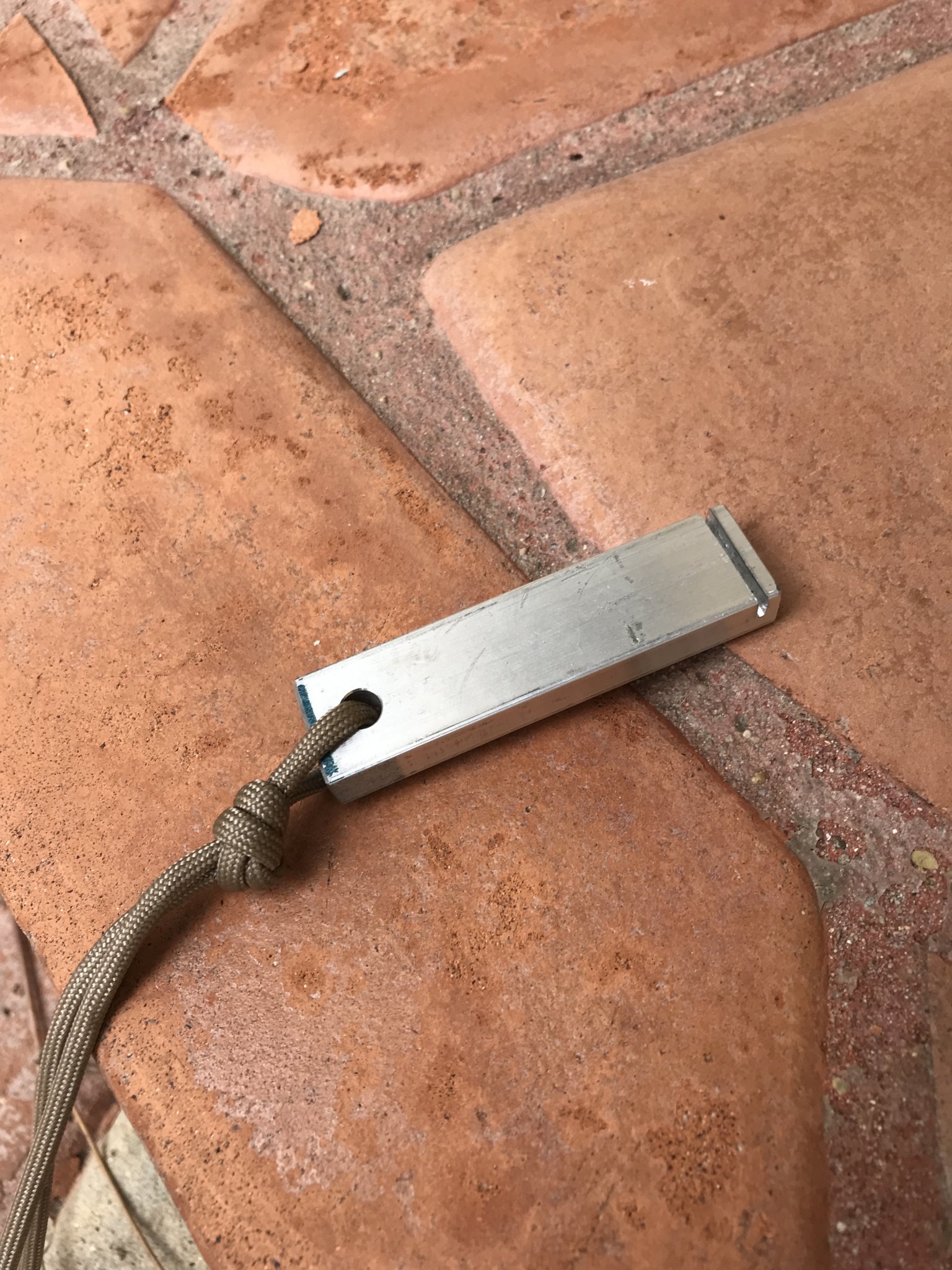

Update. I got my MPA mag tool in. Made a few tweaks on it to get the round a little further down. Did some sanding on the lips (smooth as a babies butt now) and made 10 dummy rounds to check the function. Much much better. Feed great now and much easier/more slick even with the mag stuffed with 10 rounds.
Anyone have a tool they don’t need? I am looking for one to get and pass around my shooting group. My crescent wrench is too big lol
Just pick up some 1/2”x3/4” bar stock and make a slit with a hacksaw about .300” deep, about .300” from the end of the bar stock. Boom. You’ve got a feed lip tool for a couple bucks.
That being said, you shouldn’t have to tweak the magazine if the chassis is inlet correctly, or the stock is bedded correctly (bottom metal as well as action). Only time you should have to tweak mags is if the case dimensions are different (smaller/bigger), like a Valkyrie or SPC.
