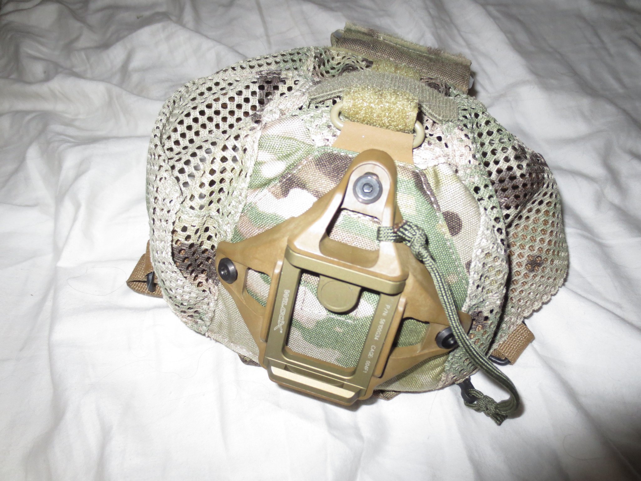

Crye soft cover with Wilcox lightweight shroud (wanna say it's like $60?). Note the 550 tie down and clip on the end. I use the Ops Core aluminum shroud on the helmet, but if I had that to do over, I'd probably have gone with one of those more expensive large shrouds that cover half the front of the helmet.
7037156

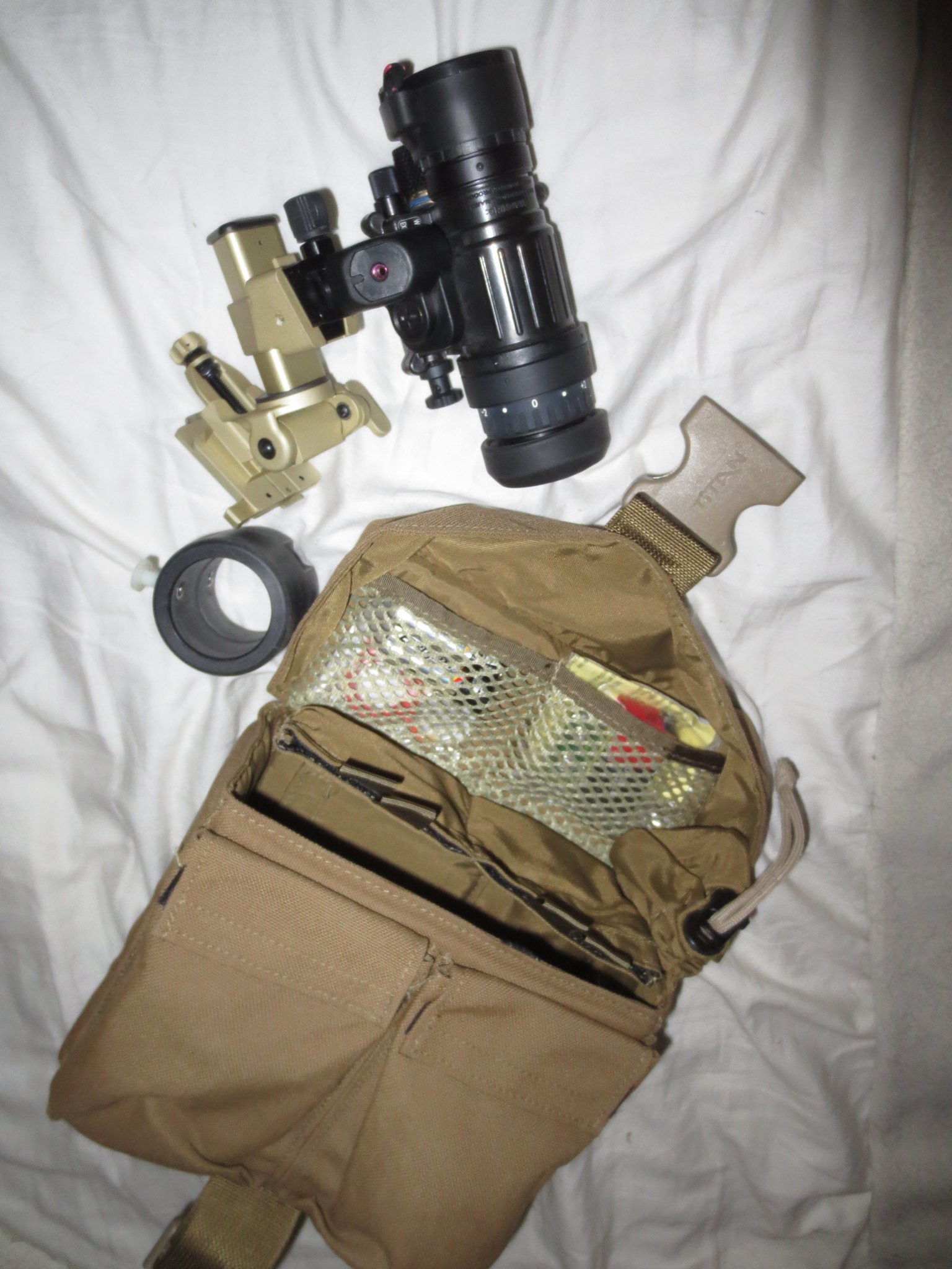

Here is the soft case I'm talking about, it's really nice to have, the INVG mount and my 14 with the Butler Creek cap and amber filter. The black ring with the nylon screw is a coupler a guy on here made for me so I could connect it to a spotting scope, which is nice. Note the dual dovetail mount, it's between the NOD and mount and has a red screw hole in the middle --that's where the second dovetail would go if I left it on there. It allows you to switch left or right eye but I never need to do that.
7037157

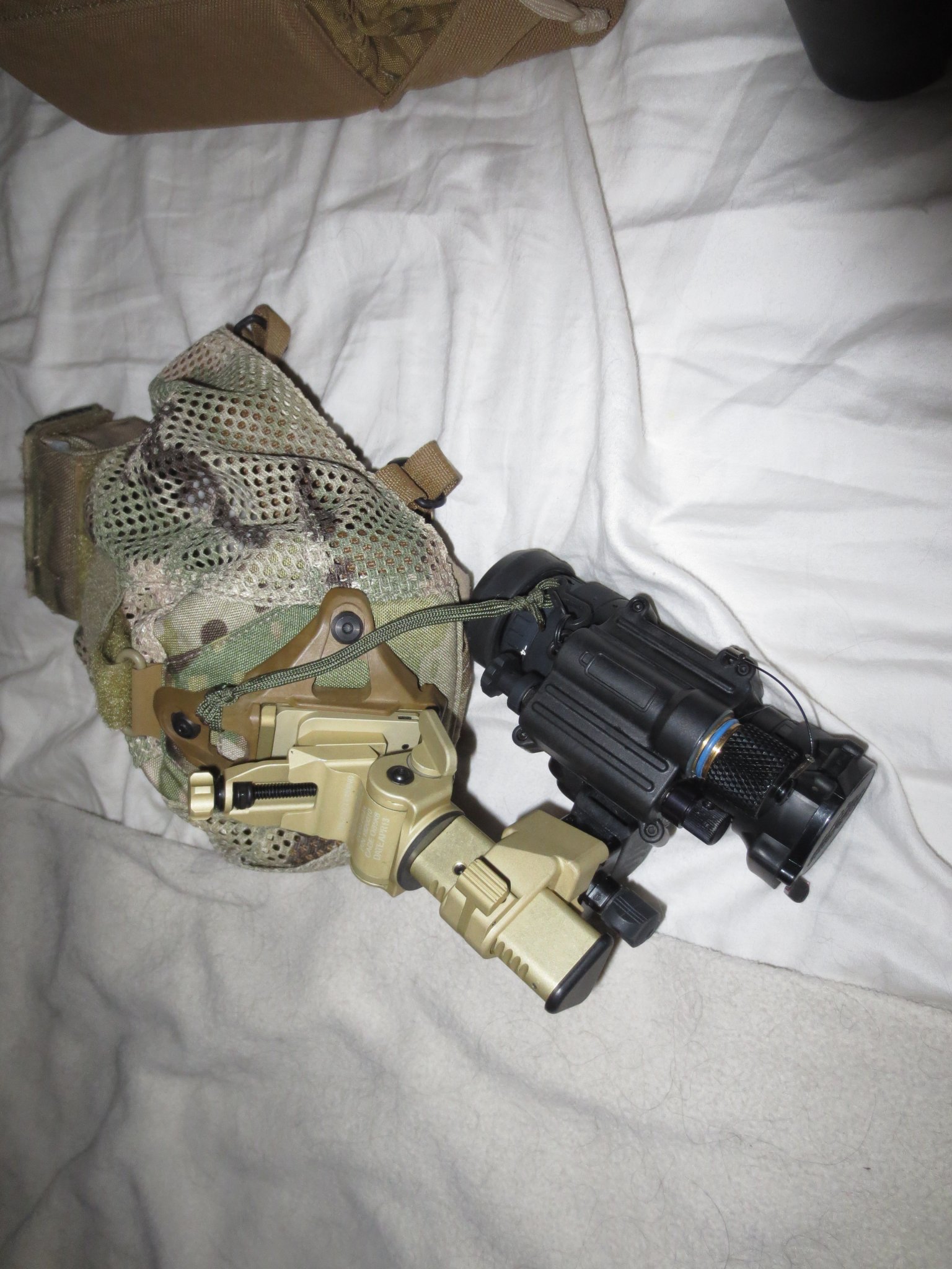

Here it is mounted and tied down. Note the size of the INVG. It's nice, and it's not AS heavy as it looks being Ti, solid as hell, but it is bulky. Whenever I do get another set, I'm gonna use this for dual tubes and get something smaller and more compact for the 14. But I don't really have any complaints about it and love the INVG. It's just that there are more, newer and lighter/compact models available.
7037159
