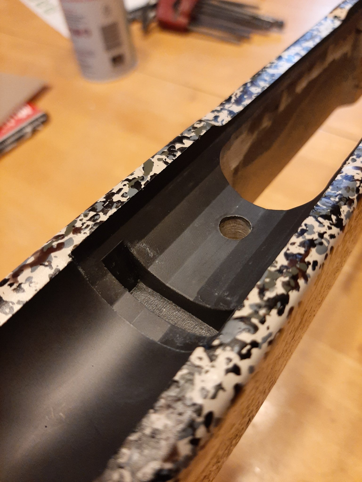

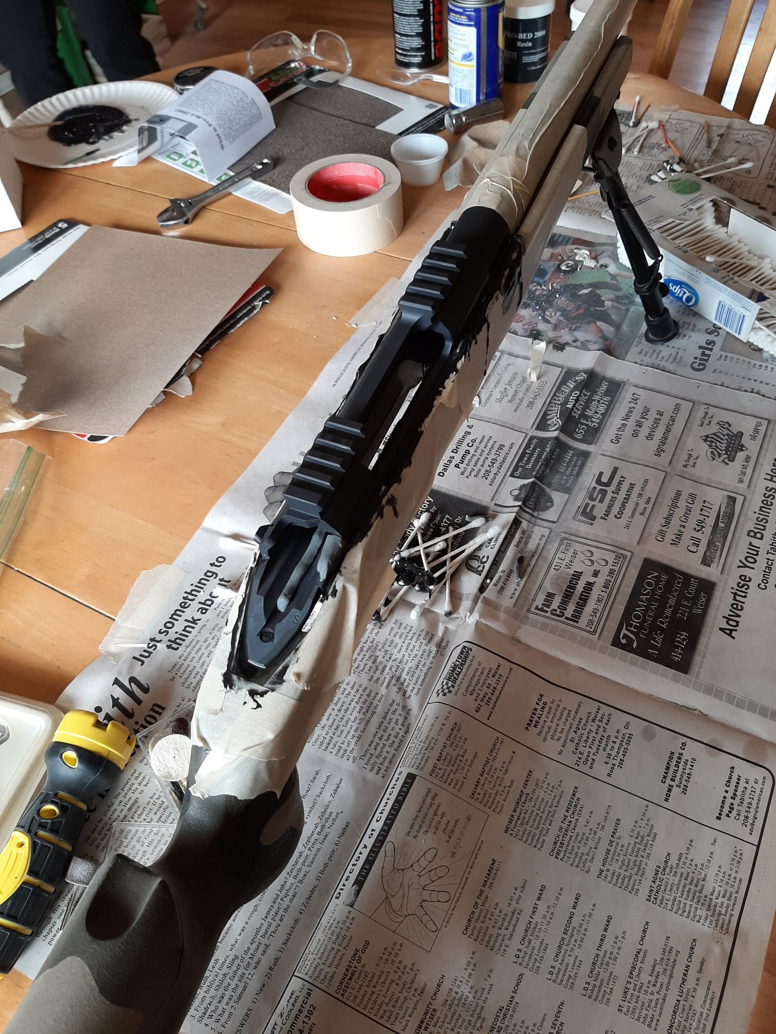

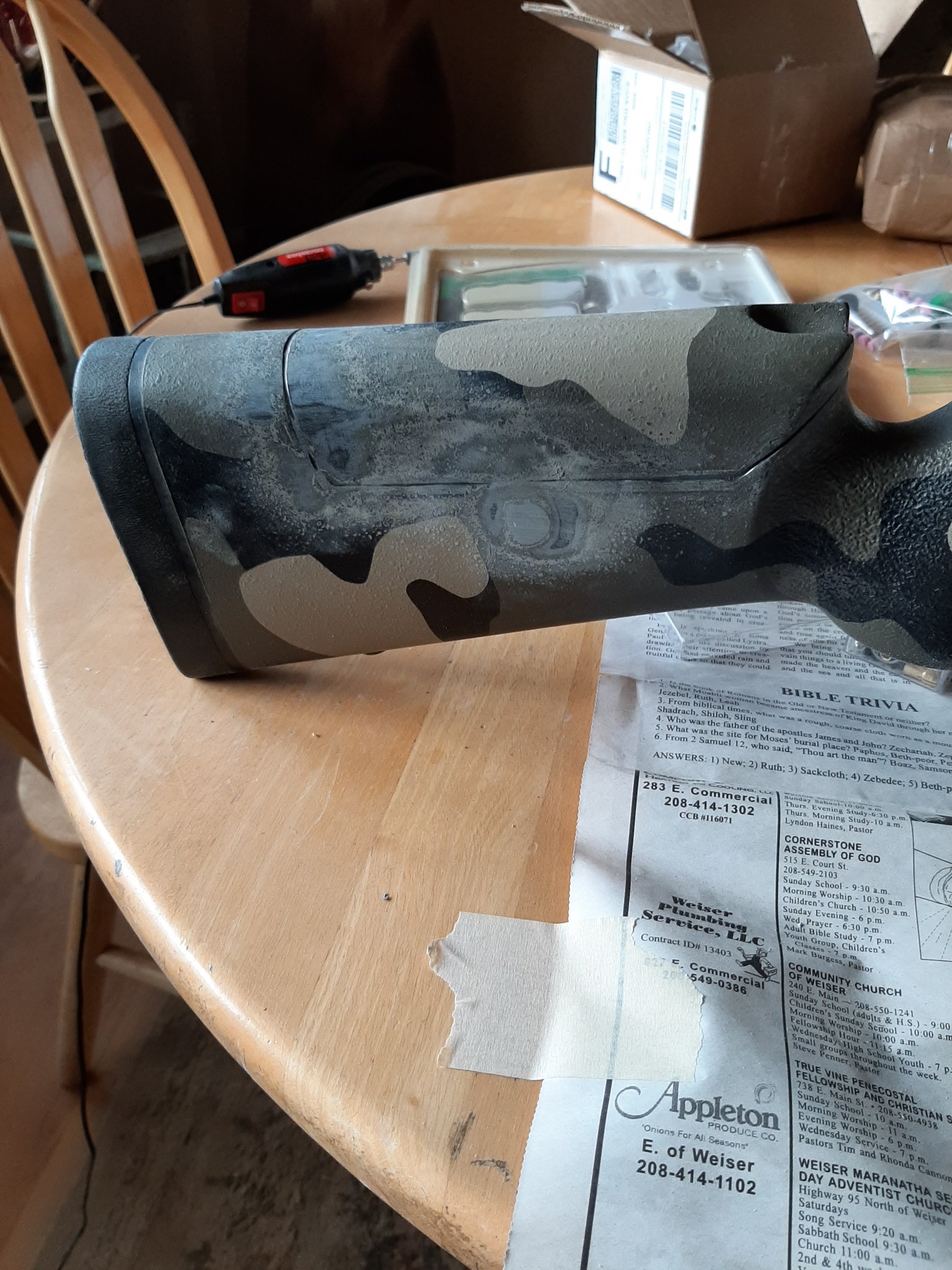

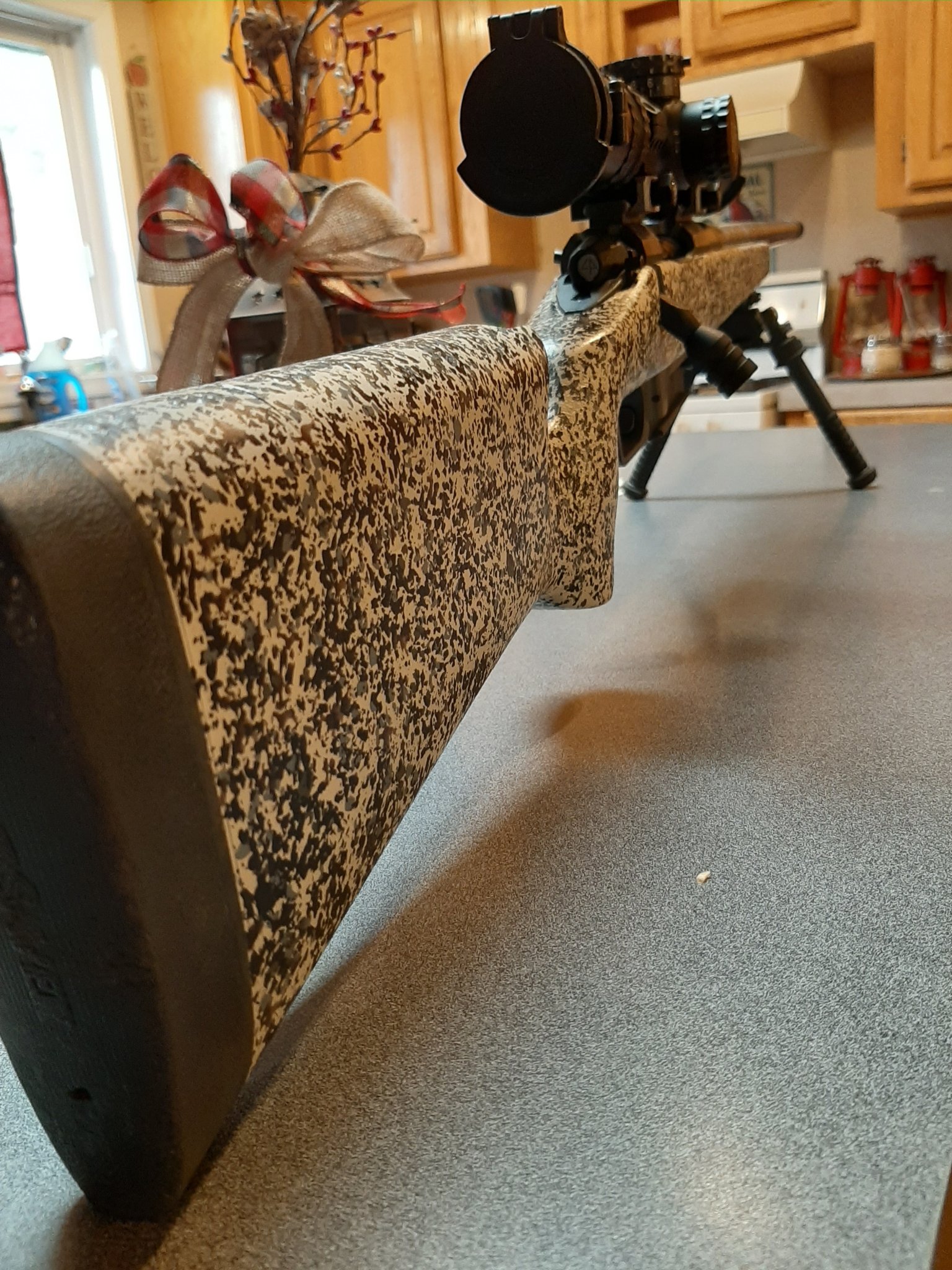

    After my other stock failed I grabbed a beater A3 out of the PX to get me by for a while. It was pretty fucked up, the adjustable cheek piece was basically broken and the stock was cracked through the front action hole.
    I ripped the KMW hardware out of the cheek piece and epoxied the piece in place, no longer adjustable. Triad stock pack will be used. I cross bolted the stock to hopefully hold the recoil lug/front action screw area together.
    Bedded it today with ProBed 2000 , stuff is awesome. It's super thick and doesn't run all over the place, its about the consistency of toothpaste. I also used a can of LRI's release agent, tomorrow I'll pop it apart and have a final verdict .

    It came out. Several good whacks on the rail with a dead blow did the trick. I've got it all cleaned up now and it's definitely the best bedding job I've ever done. I'm sold on the Probed 2000 and LRI's release agent, will be using both exclusively in the future.

    Yeah its a real craftsmanship the nice square clean edge at the end of the barrel bed stub.
    Wonder if that blue tape of a specified thickness used to center the barrel in the channel is part of the magic.
    or
    Maybe a little clean up on a mill.
    DIY fuckery complete.
    This stock was inletted for something certainly not the size of a Proof Sendero, about an hour with different size impact sockets and sandpaper netted me ample clearance.
    My no longer adjustable cheek piece actually came out pretty clean considering how jank it could have been .
    Note to self , next time just call Chad @LongRifles Inc.
