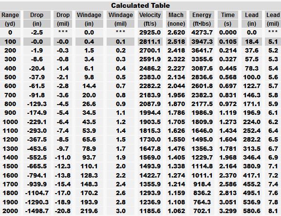

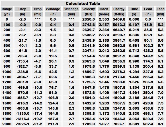

225 ELDM @ 2925fps (PRC
225 ELDM @ 3000fps (Norma)
33fps different at 2000.
This is assuming the same barrel length. A 30" PRC and a 26" Norma are practically identical with 10 grains less powder. I don't like the idea of running Lapua bolt faces on 1.350" receivers (Mausingfield included), but people do it so more power to ya. If you're going to go bigger than 'standard' and get a wider receiver, IMO you're better off going 375 or 416 of some flavor.
YMMV. Run the numbers and do what makes you happy.

338 Lapua, 300 berger @ 2850fps
Not really significantly any better than the other two.
