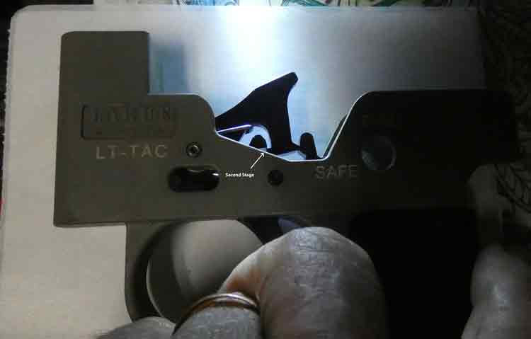

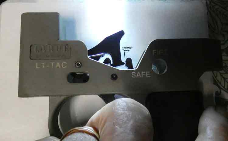

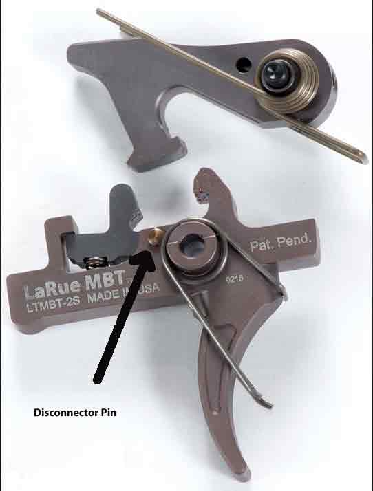

I also like the MBT-2 for the price (save when you buy 3 or 5), but I will toss a SCHMID INSIDE two stage into the mix.
It's the one with the little "S" on it.
Midway has it on sale from time to time.

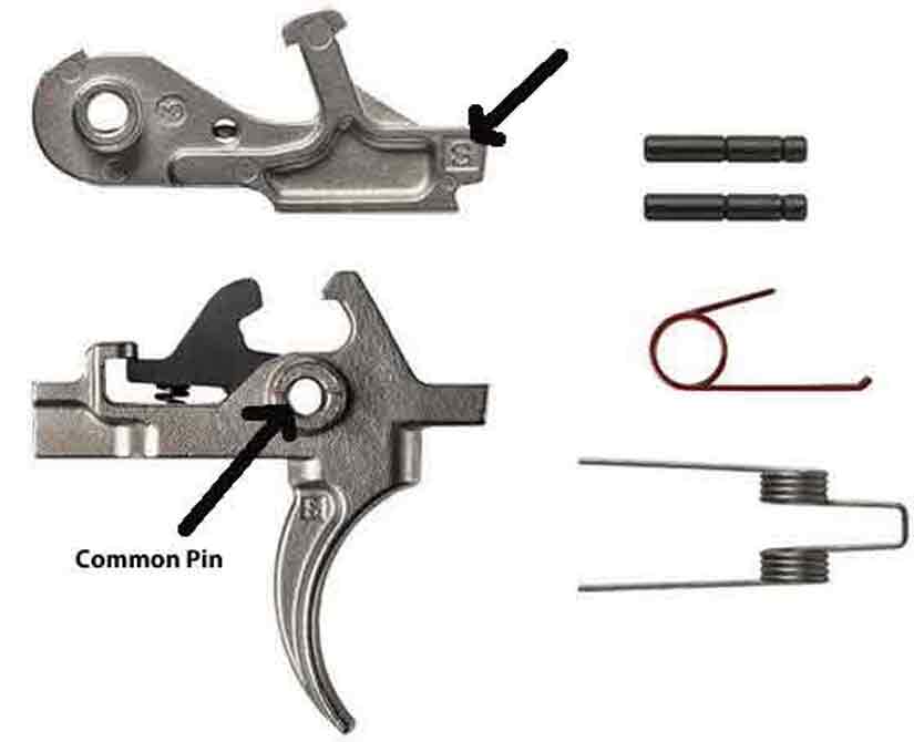

OP want's a 3.5 to 4.5 lbs pull but for those that like a lighter pull the Schmid is easier to modify.
Swapping out the disconnector spring with a standard mil-spec type spring or trimming the spring is easier with the Schmid.
The MBT-2 uses a peened in pin for the disconnector that is a little harder to remove and replace.
Easy to get either to less than 2.5 lbs.
Floor shims can be used with either to reduce 1st stage take up.
Reduced power TRIGGER spring and get real close to 2 lbs but KEEP the standard hammer spring.

Keep first stage to at least 1 pound. Less and reset is soft.
Second stage compresses the disconnector spring.
Second stage, with modified disconnector and JP trigger spring adds another pound or pound and a half for a 2 to 2.5 pound total.
With the MBT-2S or the Schmid the hammer spring contributes very little to trigger pull.
I suggest keeping the standard hammer spring.

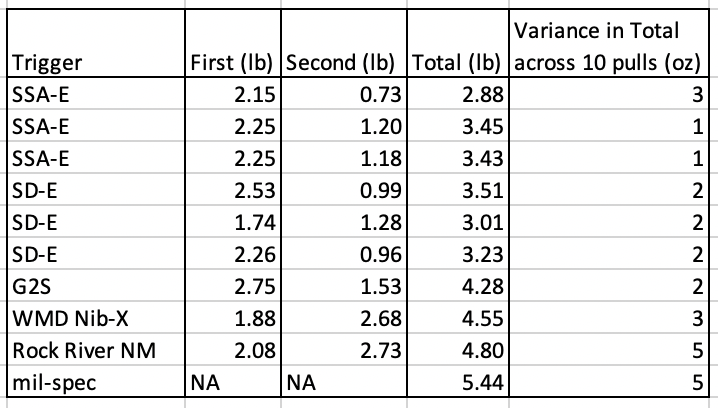

And as per this trigger pull test (Dvorak TriggerScan system) ... the Centurion version is smoother then the less expensive versions of the Schmid 2-stage elsewhere.
https://www.ar15.com/forums/ar-15/Robotic-Testing-AR15-Triggers-Updated-5-1-2023/12-779525/
I like the pull on the LaRue ( also in the above test link ) ... but honestly I don't like the trigger face profile, YMMV.

So the JP trigger spring is worth it for Larues?
I will say that I received a Gisele G2S that needed a very slight mod to the hammer. When you started to release the trigger after a shot, you could feel the disconnector slide down the back of the hammer, engage some lump on it, then engage with the hook. I ground down the back of the hammer, very slightly, so that the disconnector only engages the hook on the back of the hammer.
With an observations of N=1, it appears that the additional QC that the SSA and SSA-E triggers go through important.
That said, post mod, the only sure way to tell the difference between the G2S and SSA-E triggers that I own is with a trigger pull gauge.
I think so, the first stage take up and reset is rather gritty for my liking and I've never had one actually break at the advised 4.5lbs out of the box, with time they clean up a little.
I've ran the reduced power trigger spring kit (Gold Hammer/Gold Trigger) and have never had an issue will MIL ammo.
They are only $8.00 so I always keep a bunch on hand, mostly the enhanced reliability (Red Hammer/Gold Trigger and install them in all my Geissele and Kac triggers as well.
