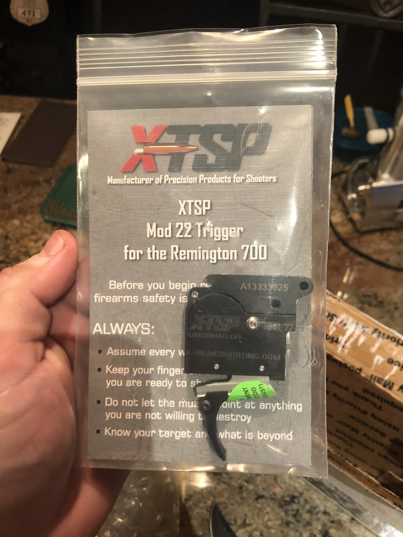

    Can you post some pics when you receive it?
    Thanks
    I just ordered an XTSP Trigger and called prior to ordering. The dovetail is something newer to them because they did it for the AI triggers they are producing. That’s direct from them.
    When I asked if I could get their new style on a Rem700 Trigger, I was told yes but they aren’t on the site. This was my experience with them.

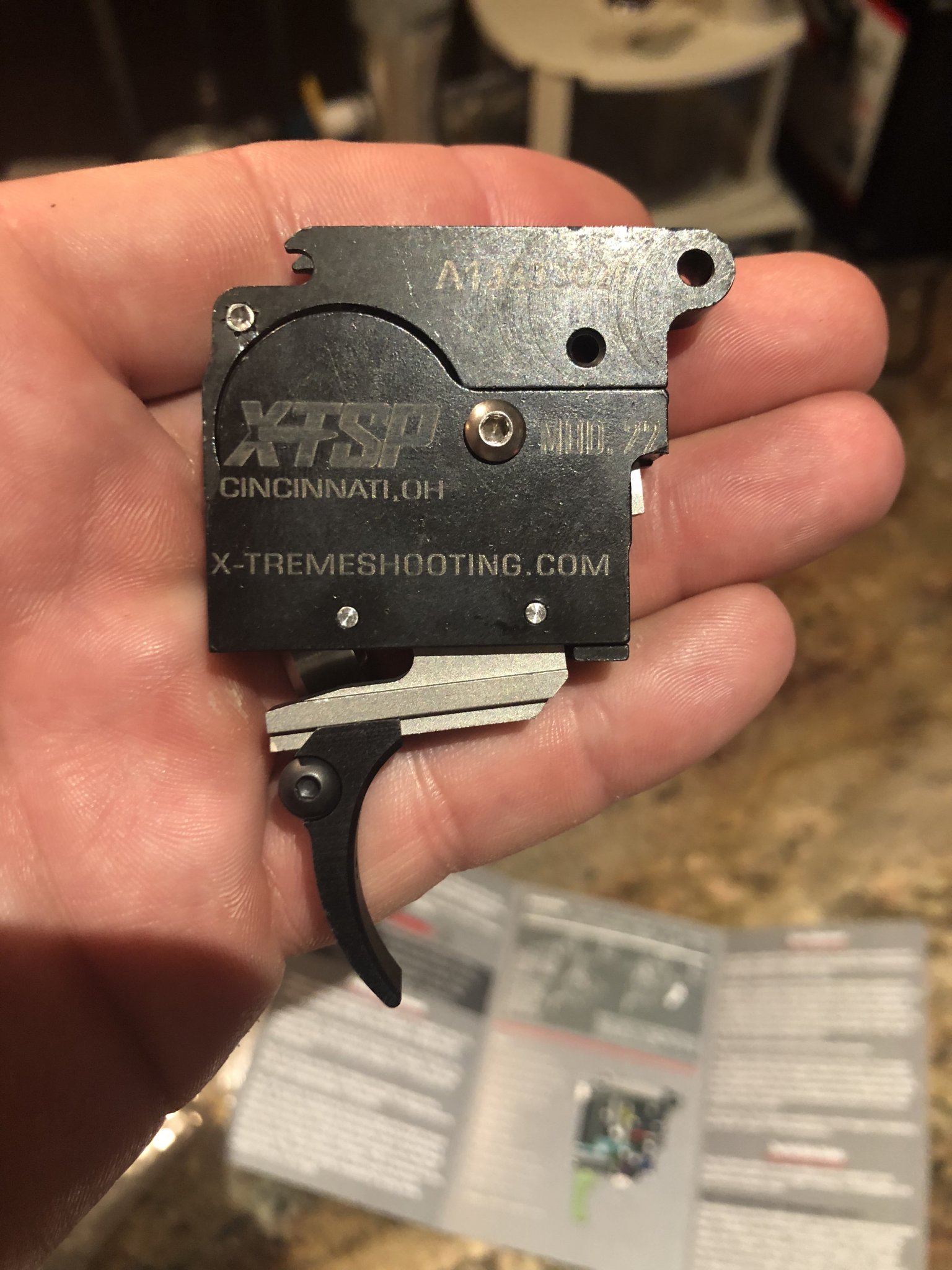

    Interesting info. I have the older version with the round bar which I like because the trigger can obviously move fore and aft and also cant.
    Reactions: 021411
    I wonder what drove that design. The trigger with the round shoe hanger allows adjustability in two degrees of freedom.
    I’d assume their relationship with Accuracy International. AIs have always had an adjustable dovetail so my guess would be they wanted the same when they contracted XTSP to produce their comp trigger.
    Frankly, it’s why I bought their trigger. They are phenomenal triggers and being that I shoot an AI for competition, I wanted the same trigger in my trainers.
