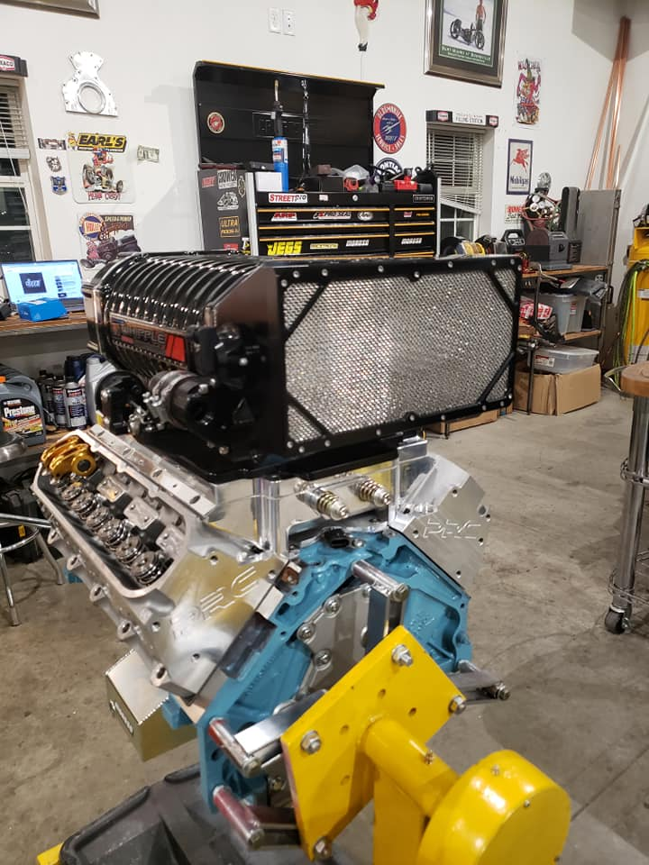

2 years drawing to a close; The "Hoodrat blown 5.3L" project.
LRI
Lance Criminal
  • Mar 14, 2010
    6,346
    7,710
    53
    Sturgis, S. Dakota
    www.longriflesinc.com
    332 cubes of...
    Concreted Iron 5.3L block
    Decent heads
    Killer head studs (CA625's)
    K-1 crank
    Molnar rods
    Weisco slugs
    Whipple 8.3L blower
    15gpm/90psi fuel pump
    Crankcase evac pump
    700lb/hr Billet Atomizer Injectors
    Holley Dominator EFI management
    Methanol fuel.
    Holley Smart Coils
    Athena O ringed head gaskets
    All the boost...lol.

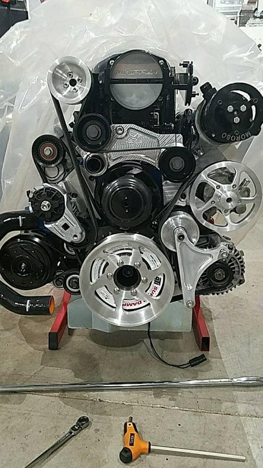

    My 421 LSX I did 2.5 years ago for my street car. A 2004 GTO. Never dyno'd but it puts a 4400lb car into the 6.40's. -Guessing somewhere around 1050 wheel.
    My wife's G8 that we just got done with (3 year project). Brought back from the dead. Salvage title car. Now its an LSA setup making 575/580 to the tire.

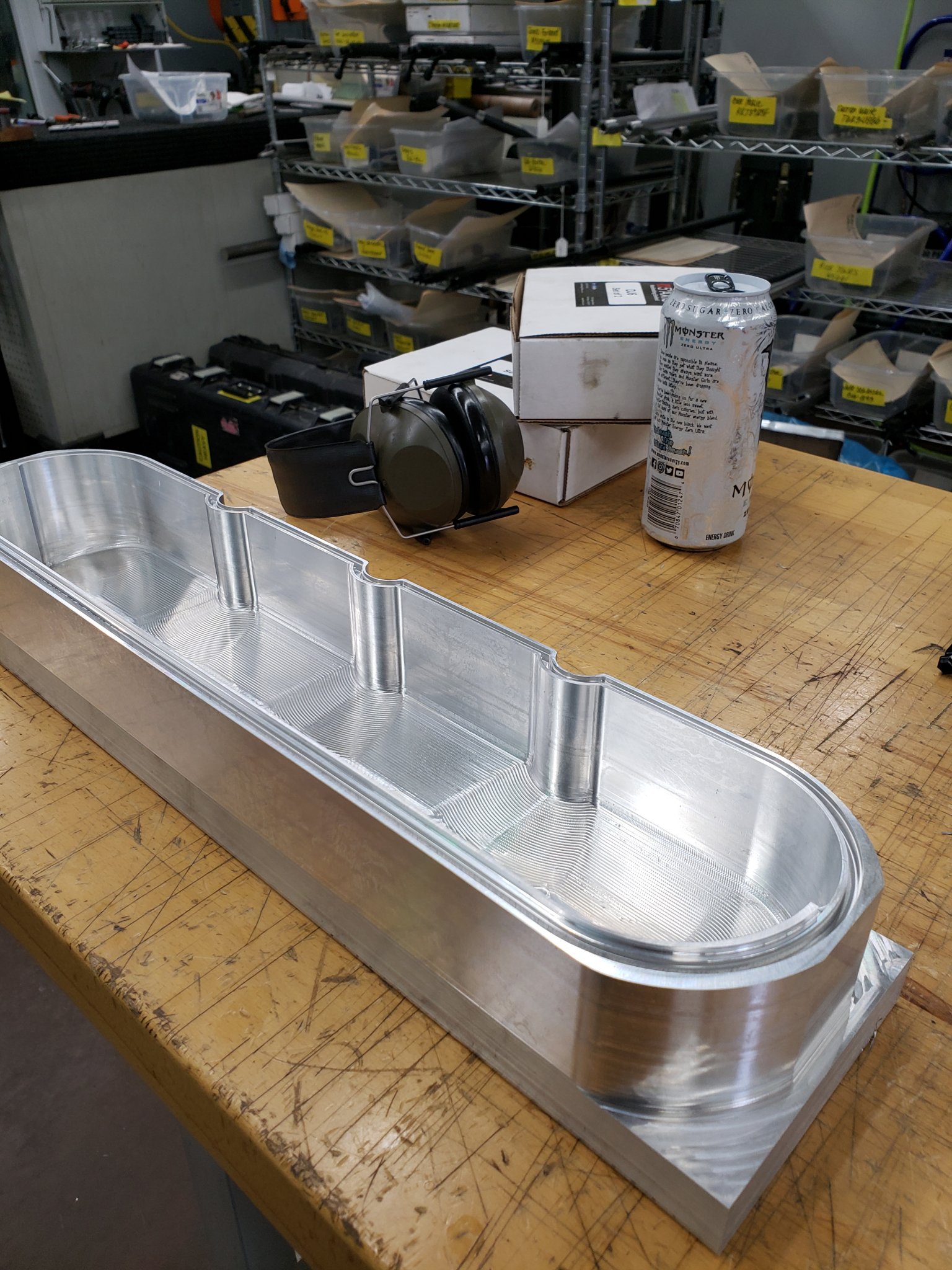

    Getting acclimated to the new mill with a set of valve covers for the drag car.
    Long cycle time which is why I'm loitering here today. -About like watching paint dry.

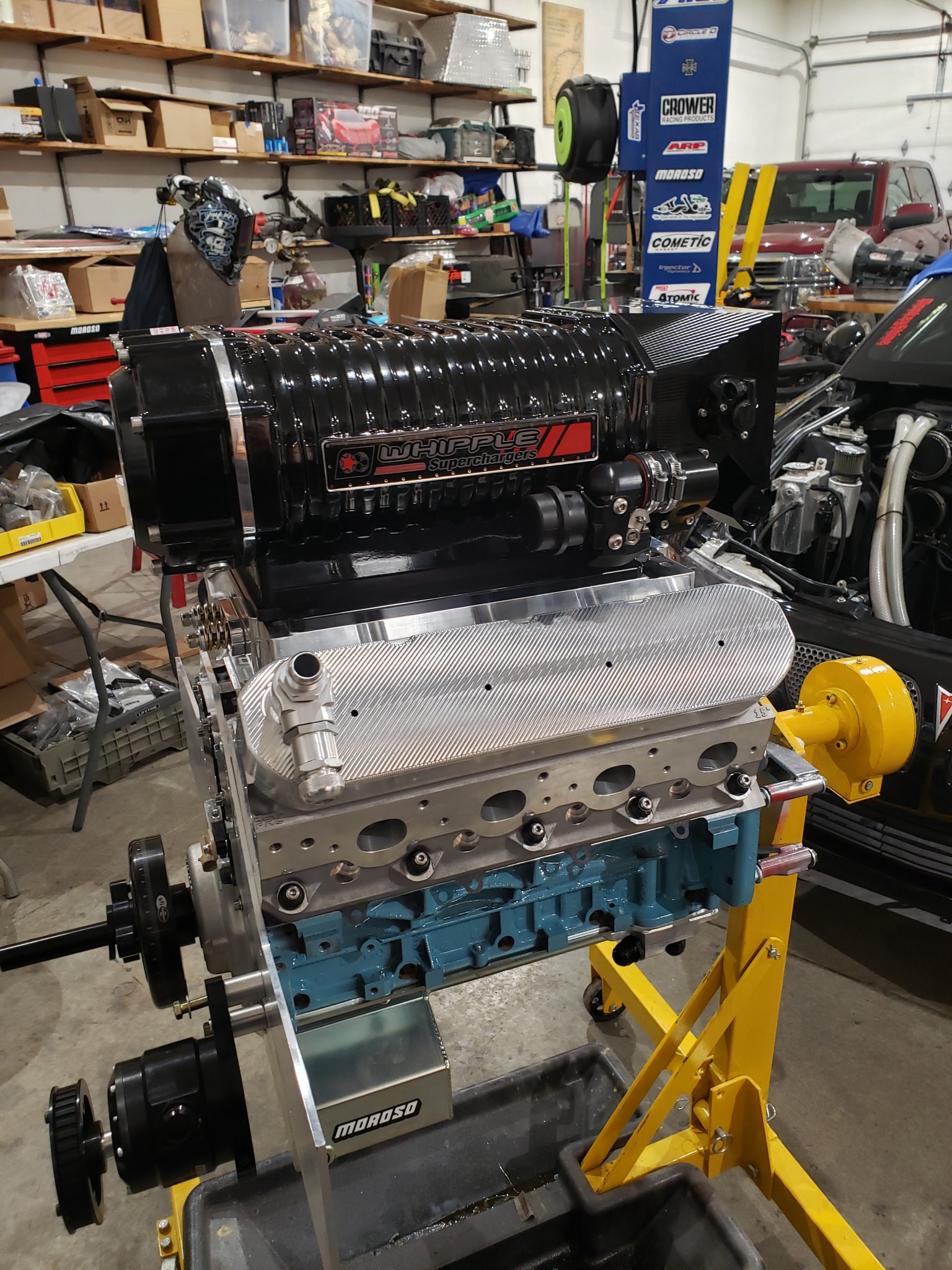

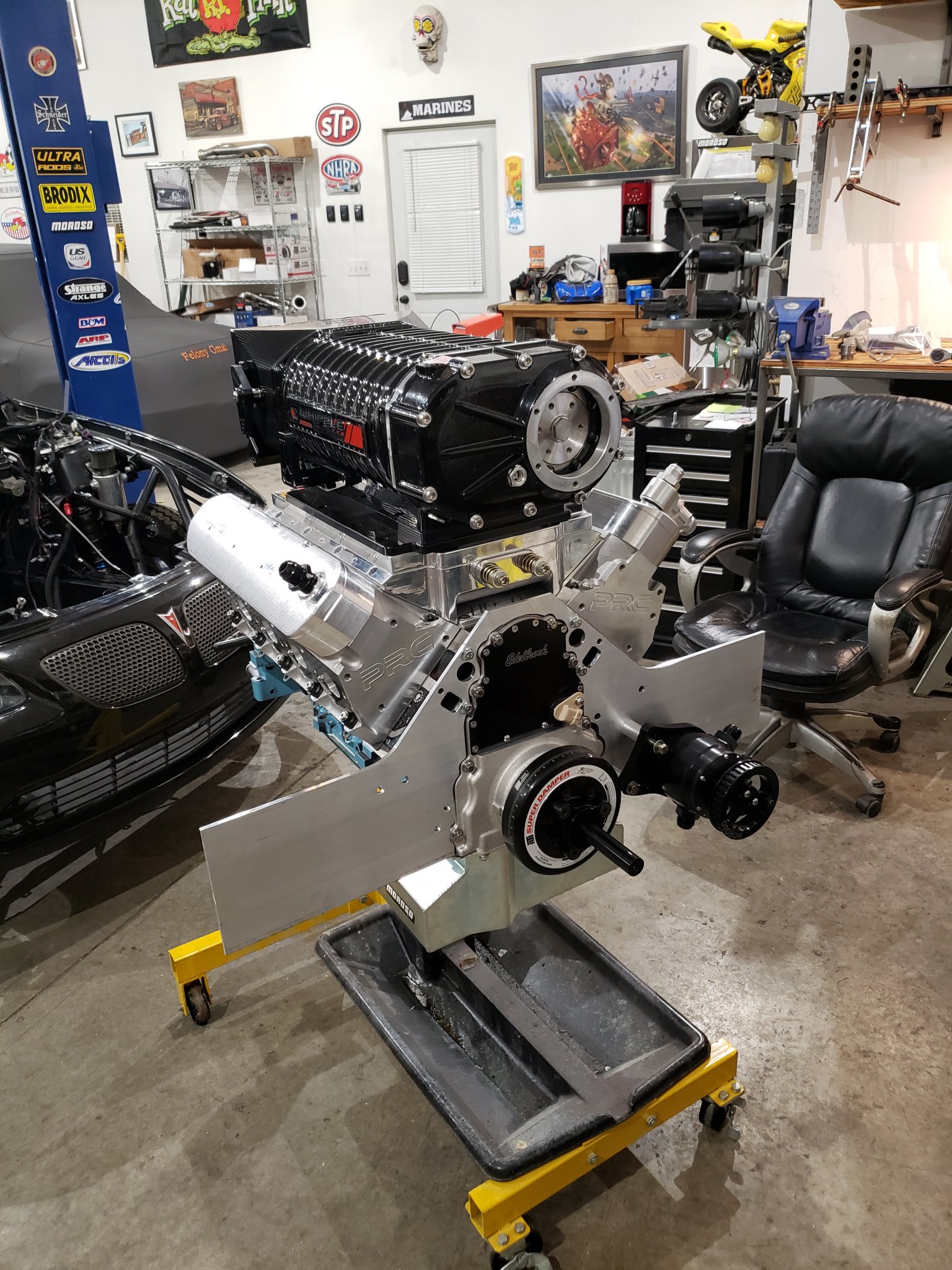

    Man, I love some LSx power. Excellent platform for some serious horsepower and sounds. Beautiful job on that engine! How many pounds of boost you going to be running? 15-20?
    All of it. When it breaks, we went too far, lol. This is "the little motor".

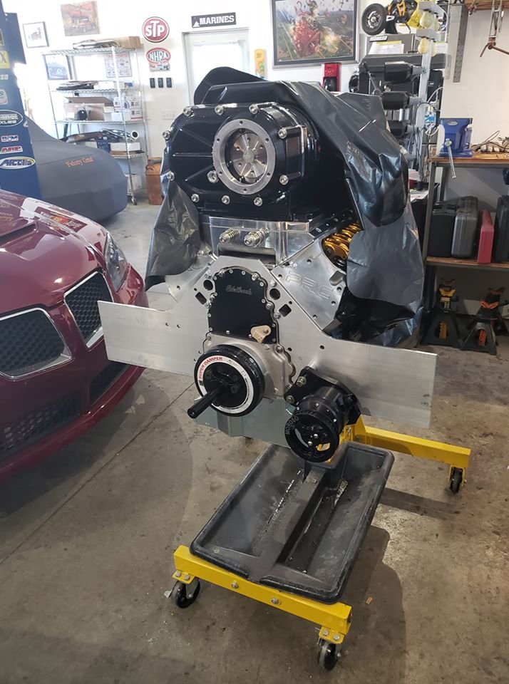

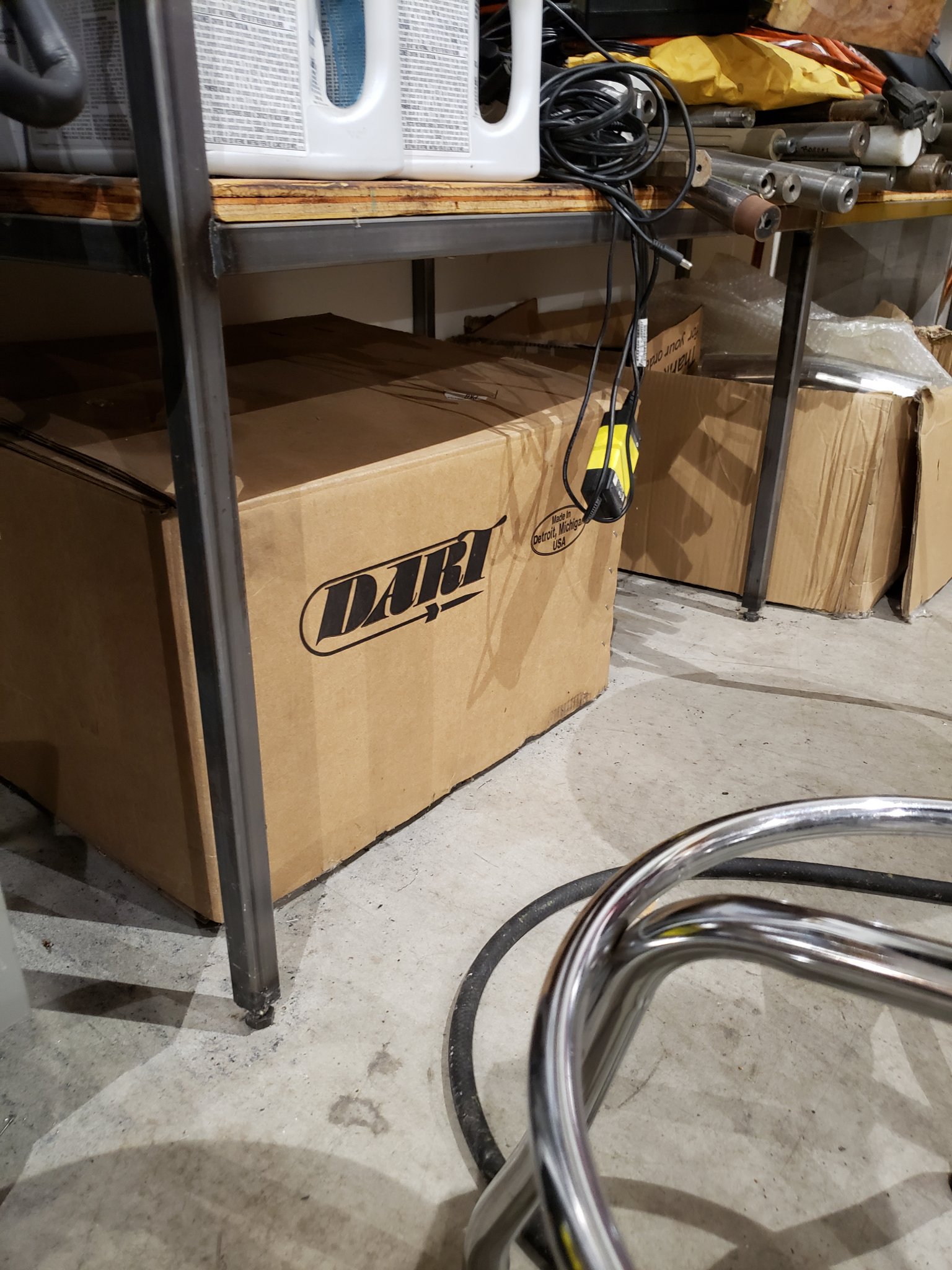

    There's a Dart LS Next tall deck block and billet center weight crankshaft in those boxes for the 2.0 version.

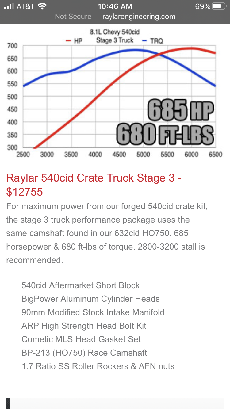

    Please for the love of any sort of awesome power, do a forged Raylar gen III big block! I think they are up to 9.0 now? Even the “little” 8.1 can be made into a beast!
    an. 8.1 will fit where the LS block does.

    I have a Dart LS Next tall deck and billet, center counterweight crankshaft for the next motor. I moved away from SBC and BBC stuff a long time ago. LS packages so much easier in tight quarter cars and the good old school parts are getting tough to find.
