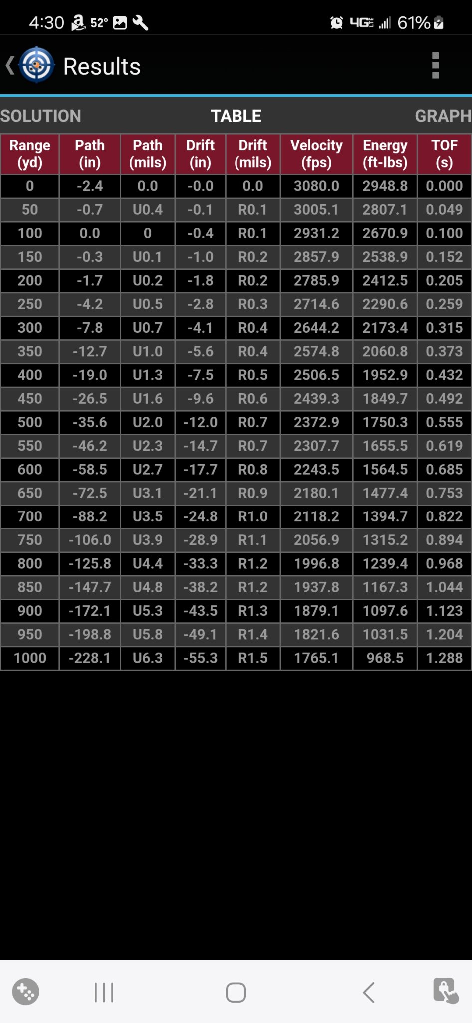

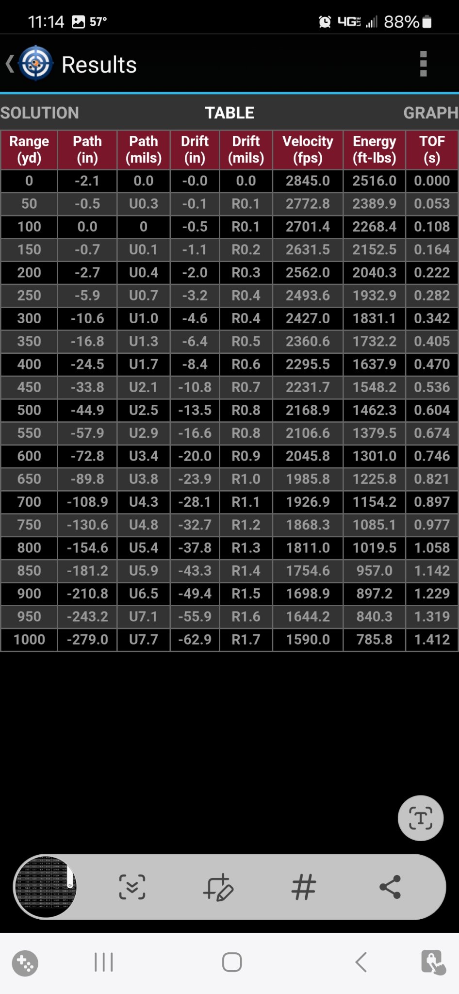

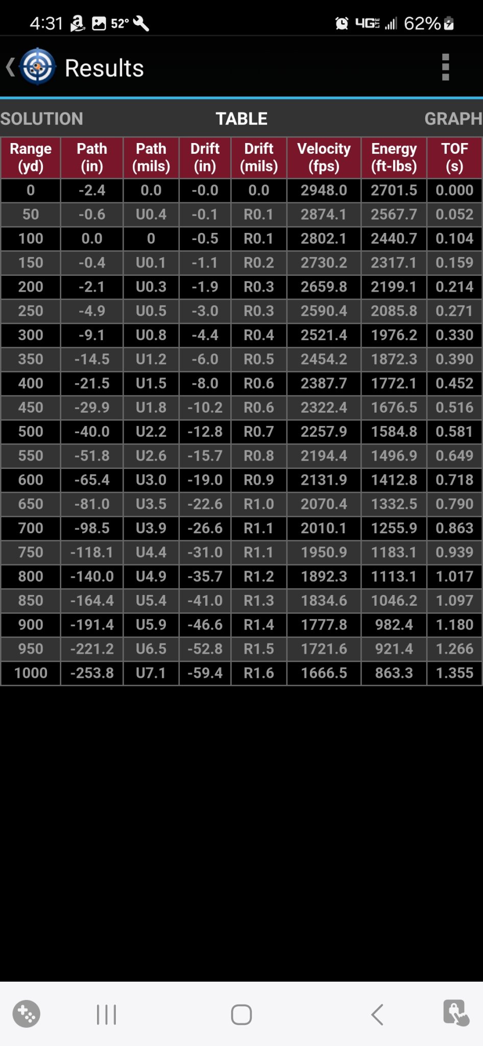

I think comparing untuned Quickload estimates without truing data for real measured velocities is mostly for suckers, but this ^ is a hilariously cherry-picked comparison.
Here is what Quickload shows for the top velocity powders in a 20" PRC vs a 24" Creed at SAAMI max pressure.

Ive got solid numbers, real world not cherry picked or QL, the barrel lengths are not same as op but same difference. All the barrels are bart 8tw, all loads are with lapua or adg brass with 140eldm(i have 3400+ of these so use them in my prc). 26" 6.5creed is running 2845 with rl16 and 140eldm. 25" 6.5prc is running 3075fps with h1000 and 140eldm. 22" 6.5prc is running 2950 with h1000 and 140eldm. I'm loading these all the same, as fast as they'll run and maintain bughole groups. In a 1" shorter barrel, the prc has 230fps over the creed. In a 4" shorter barrel, the 6.5prc has a 105fps advantage over the creed.
Thanks for posting your numbers with your reloads. Looks like with a min expansion velocity of 1800fps for the eldm your looking at the approx distances of
6.5 Cm 805 yds
22" prc 875 yds
25" prc 975 yds
One still gets 805 yds with the cm where most shouldn't be taking shots at animals anyways.Is the extra 170 yards worth a third more recoil? For me no way
If expansion distance and recoil were metrics used for picking suitable hunting cartridges there wouldn't be enough magnum rifles sold per year to make them profitably viable for production. Frankly, 6.5CM or 308Win is unnecessary for average hunting distances. Lastly, PRC doesn't make any sense if you're just going to use fast powder and the same bullets found in run of the mill 6.5CM cartridge.
Like I said above, 6.5PRC has a significantly higher case capacity than 6.5CM. 4" of barrel length doesn't equalize them. The difference is meaningless though if you use the PRC where even the 6.5CM is overkill. 338LM isn't superior to 223Rem either if you're just shooting deer at 100 yards or less.
With all that said, when you start stretching the distance things don't always go as planned. More velocity gives you more margin of error for expansion, lethality, wind, and drop. Perhaps your marginal wind call with the slower cartridge means wounding instead of killing. Maybe the .2 mil difference of wind call is a belly shot instead of lung/shoulder from a quartering animal or breeze you didn't see. An advantage is an advantage and you can take that to the field where conditions aren't always ideal.
