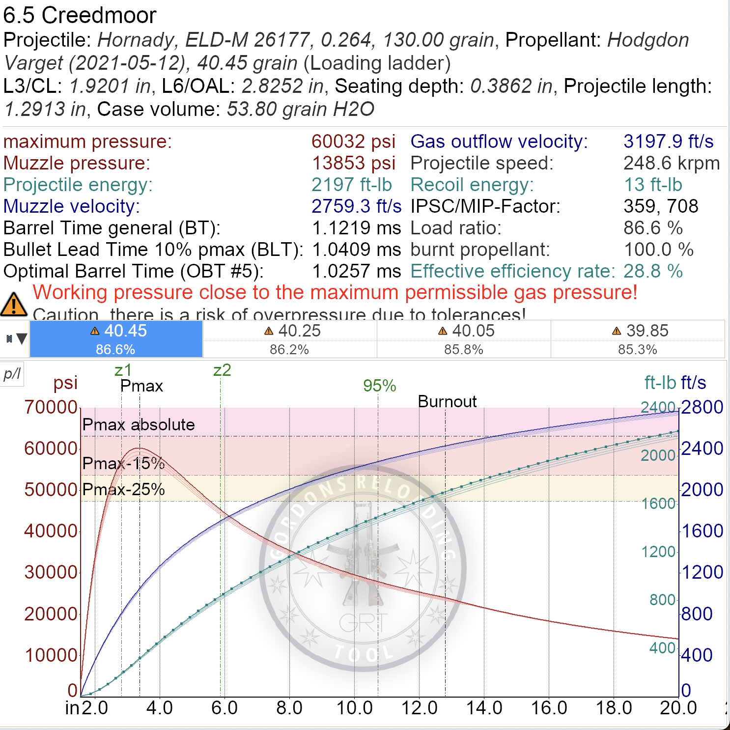

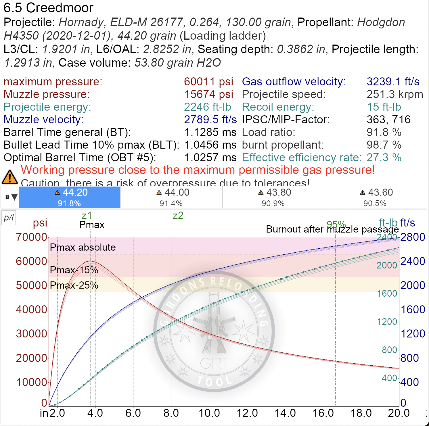

I ran two simulations in GRT with the 130 ELD-M. I chose to run the loads to 60KSI. It's interesting to see that in this case the H4350 almost burns out before leaving the muzzle and the velocities are close. What does happen is the recoil energy is significantly different.
In this example there is over a 1000psi difference in pressure at the muzzle.
