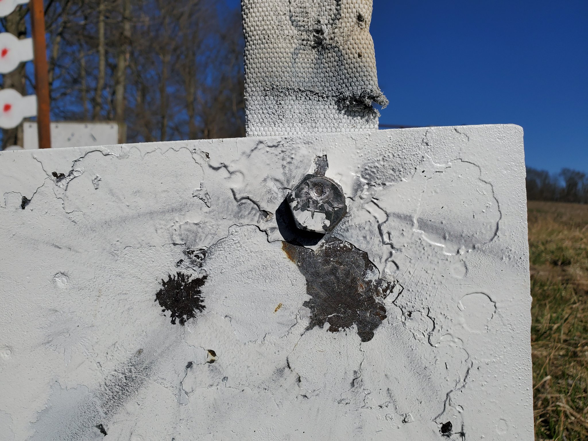

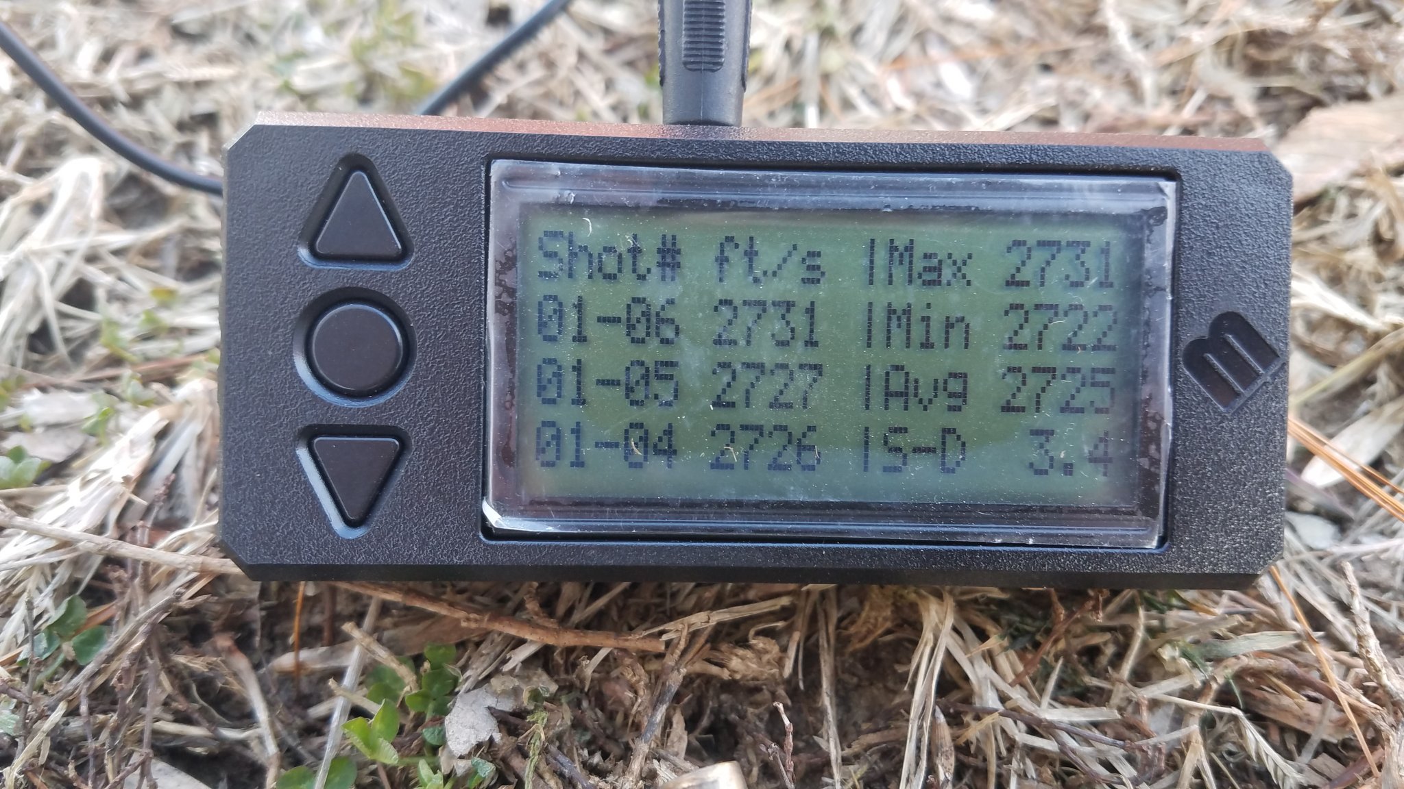

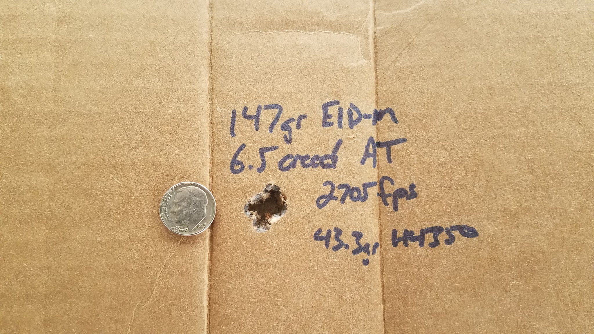

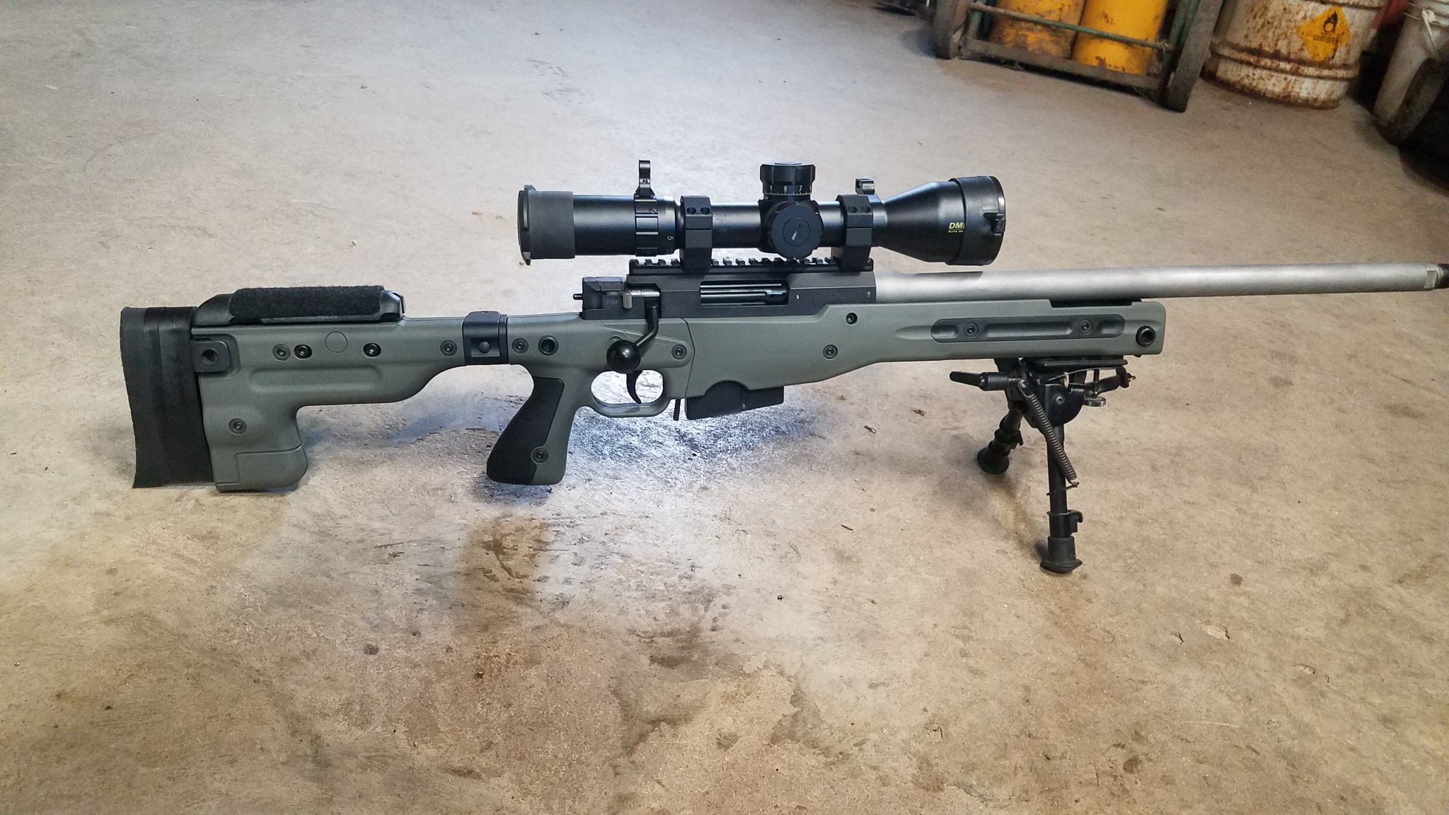

I've got a 20" stainless proof 6.5creed barrel on my at, along with 24" bartlien 243win. I can get 147eldm to 2725fps with 43.3gr h4350, br4, and lapua brass. 8rds on cardboard target, 3 rds on steel at 800yds. It hit higher than expected, after reconfirming 100yd zero, barrel had sped up to 2725( only 120rds on it)
