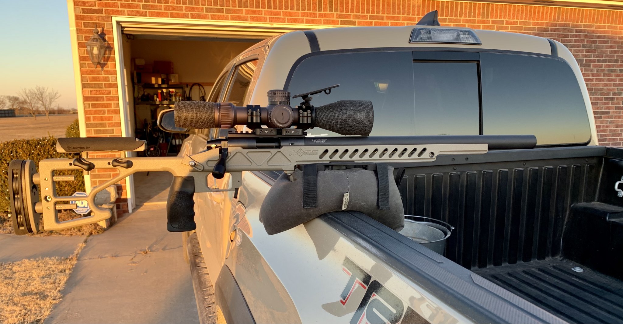

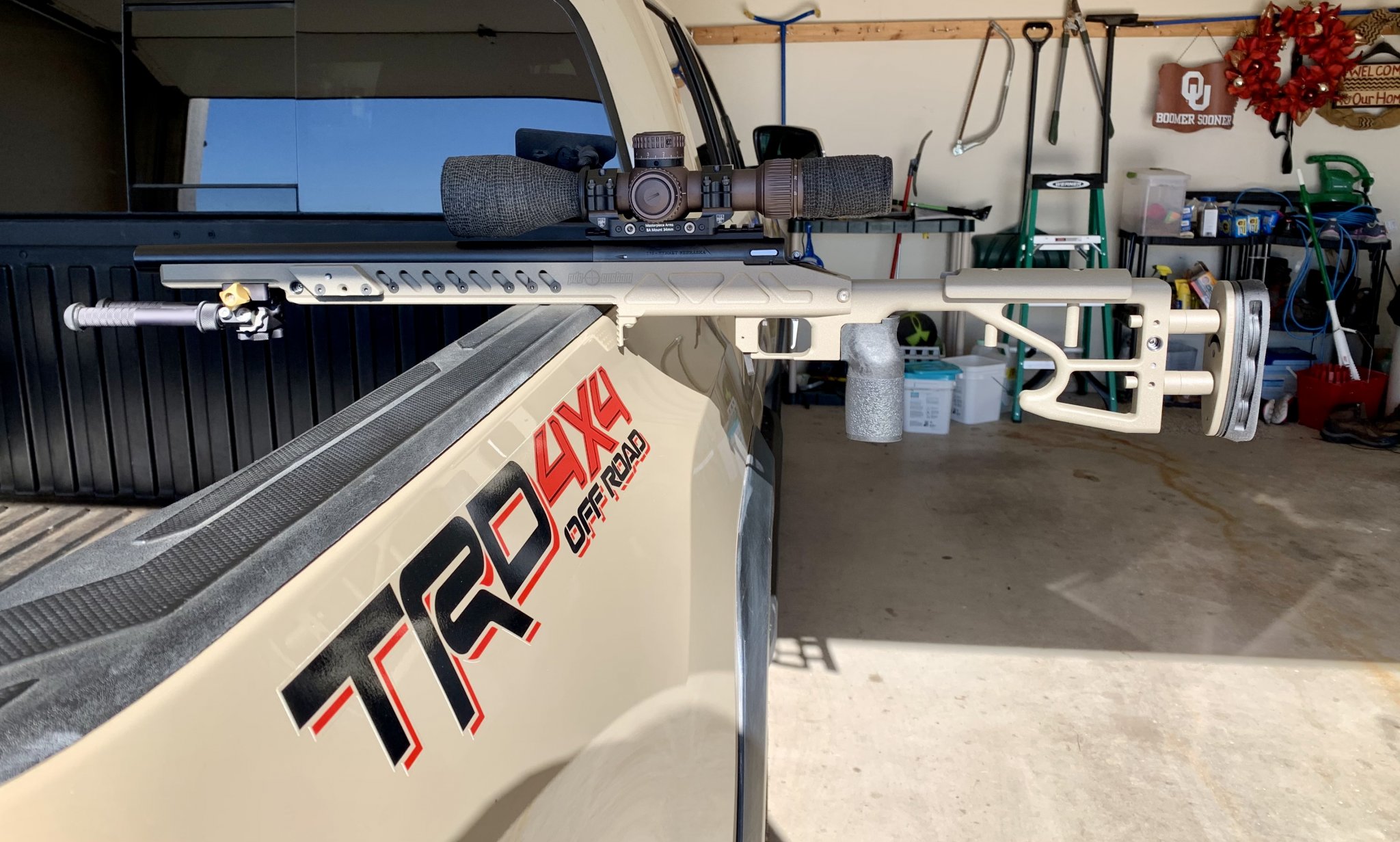

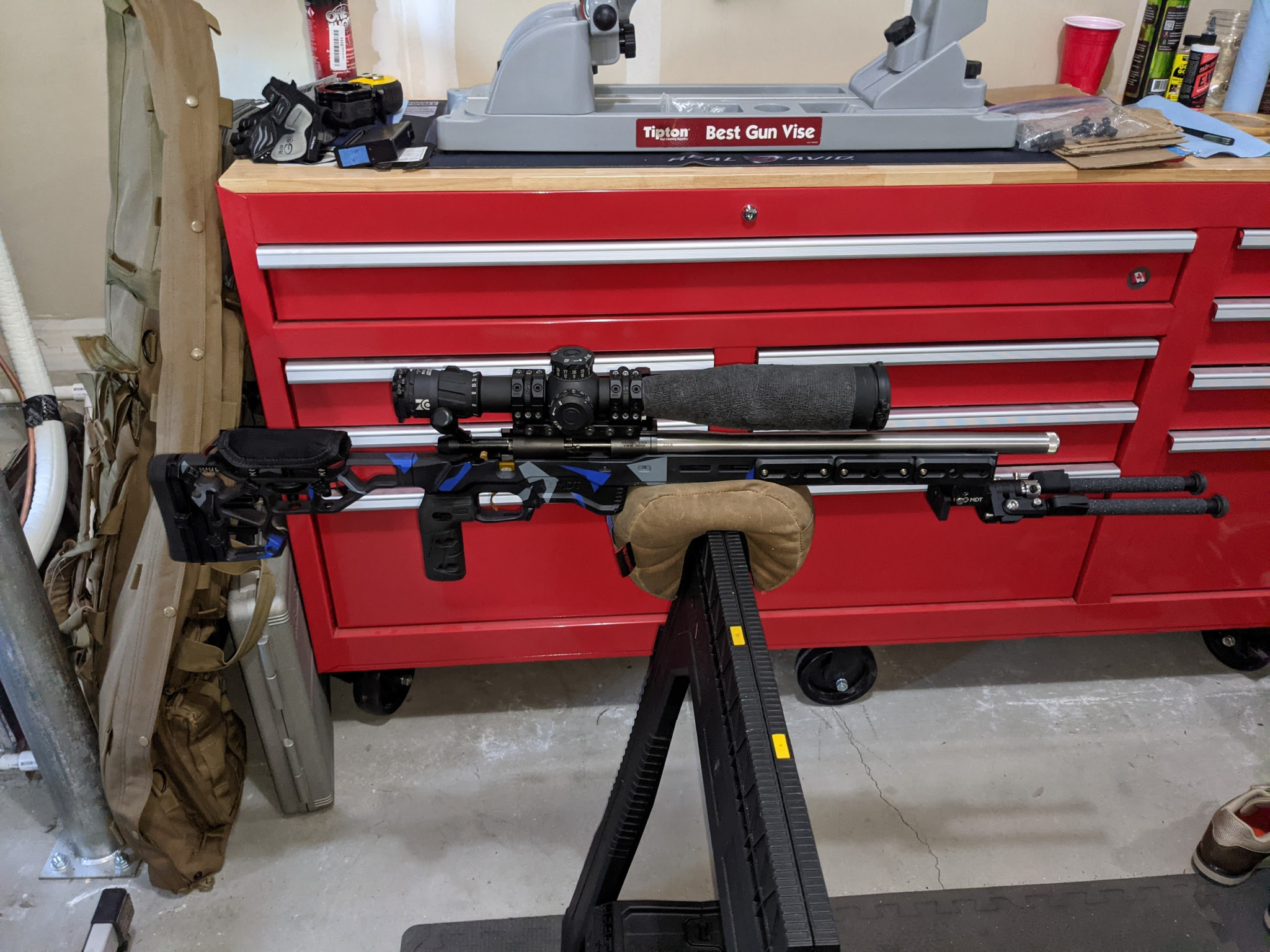

RimX
Green Mountain M24 at 18” with all the internal weights and two external weights and the bipod on the rail. Total weight was 16.6lbs with the balance point just forward of the barricade stop. In this picture it just barely balances on the pickup bed.
Green Mountain 1.2 straight at 21.5”. No internal or external weights and no bipod. Total weight of 15.4lbs. Balance point several inches in front of the barricade stop. To me the balance is just right when shooting off of barricades, rocks,tires and so fourth. If shooting off the top of a barrel using a rear bag and bipod with it all the way back for both to fit on top of the barrel it is a bit front heavy.
I’m really liking this new setup with this barrel for overall NRL22/PRS22 matches. Shooting the same lot of Center X in both with the temps in the low 40’s I’m getting 1091 FPS out of the 18” and 1073 FPS out of the 21.5”. So it just all comes down to what feels best to you. Wish i would of went with the longer heavier barrel the first time.

RimX
Yep... that's the balance I want to get... can't wait to switch to a 22" MTU and drop a lot of these weights.
Reactions: drglock
