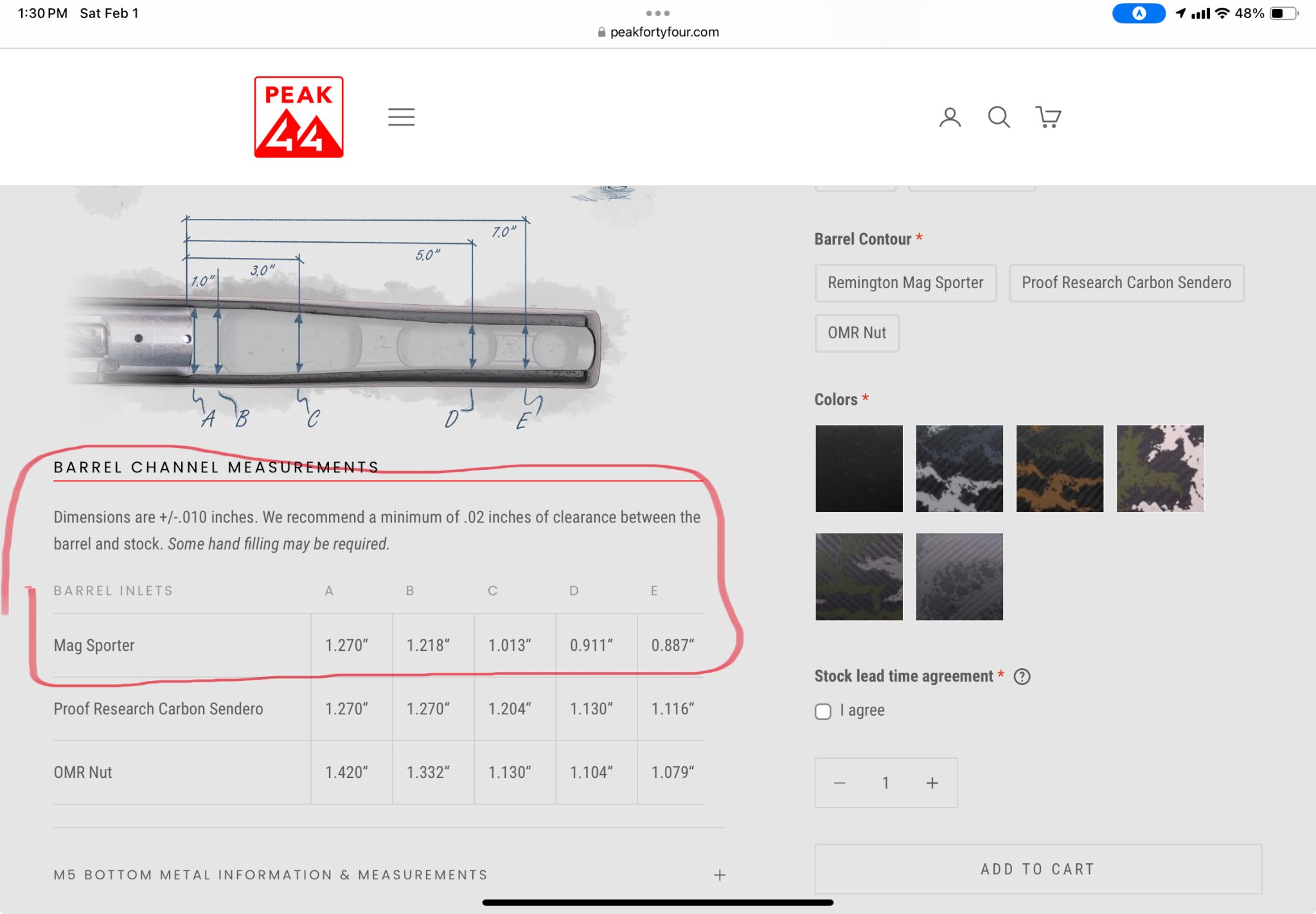

    I have a Origin short action and a Peak44 Bastion stock that’s channeled for Remington Mag Sporter profile barrels which will not fit carbon barrels. So overall my goal is a 20” 300WSM steel barrel threaded to 5/8x24 that’s as light as possible that still makes a good suppressor host, and fits in my Peak44 stock. I’m hoping for 2.5# or less in barrel weight, so I may have to flute it, and or have the barrel profiled back out at the muzzle to be able to thread it 5/8x24. This is going to be a hunting rifle, not a range toy.

    Here’s what I’m working with stock clearance wise:

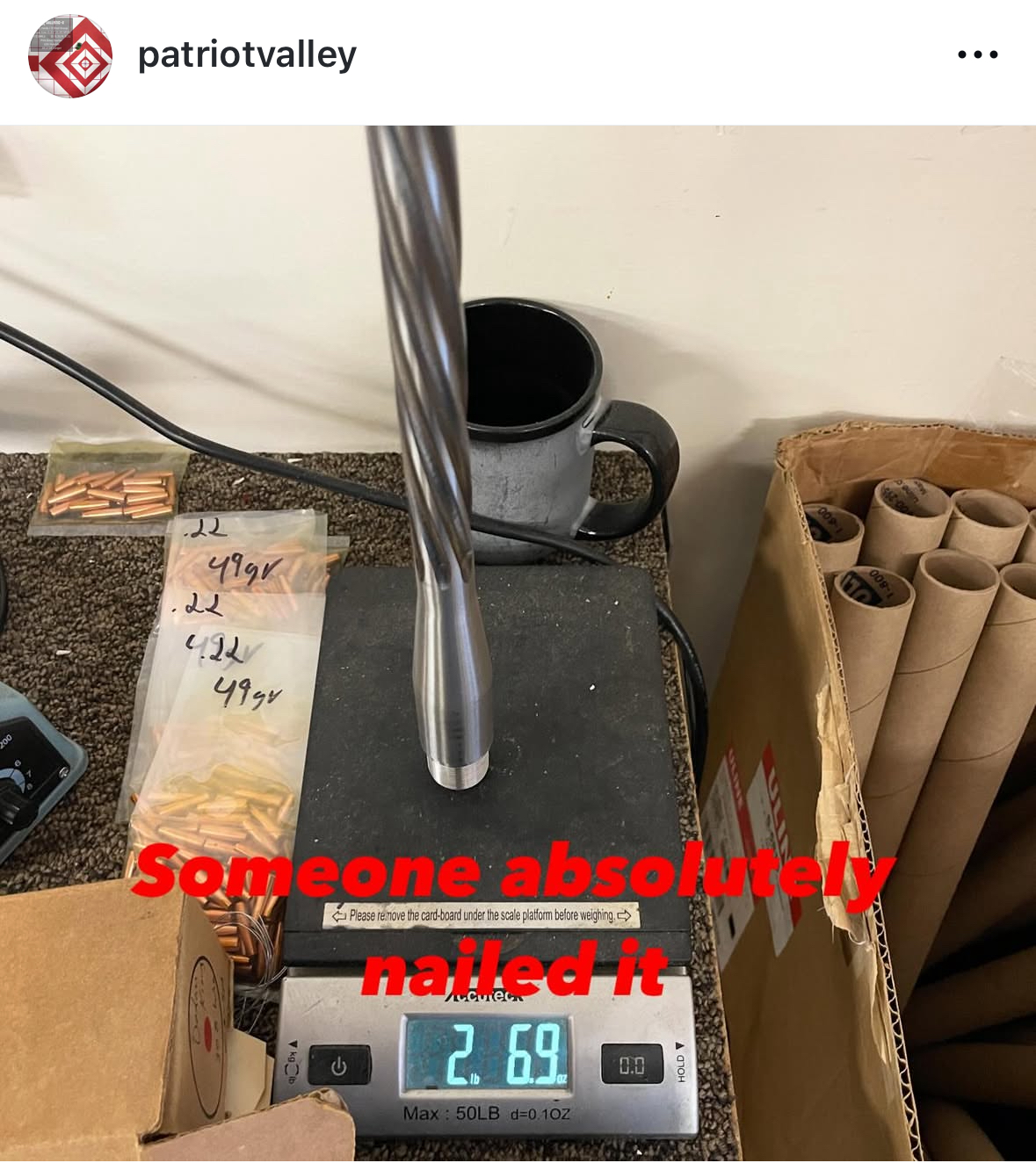

    The preferred barrel blanks .750 taper less contour is probably the lightest you can go and still thread it 5/8-24. It should be a little under 3lbs fluted. I don’t think the 8oz extra barrel weight would matter though. Especially shooting a wsm and trying to spot your own impacts

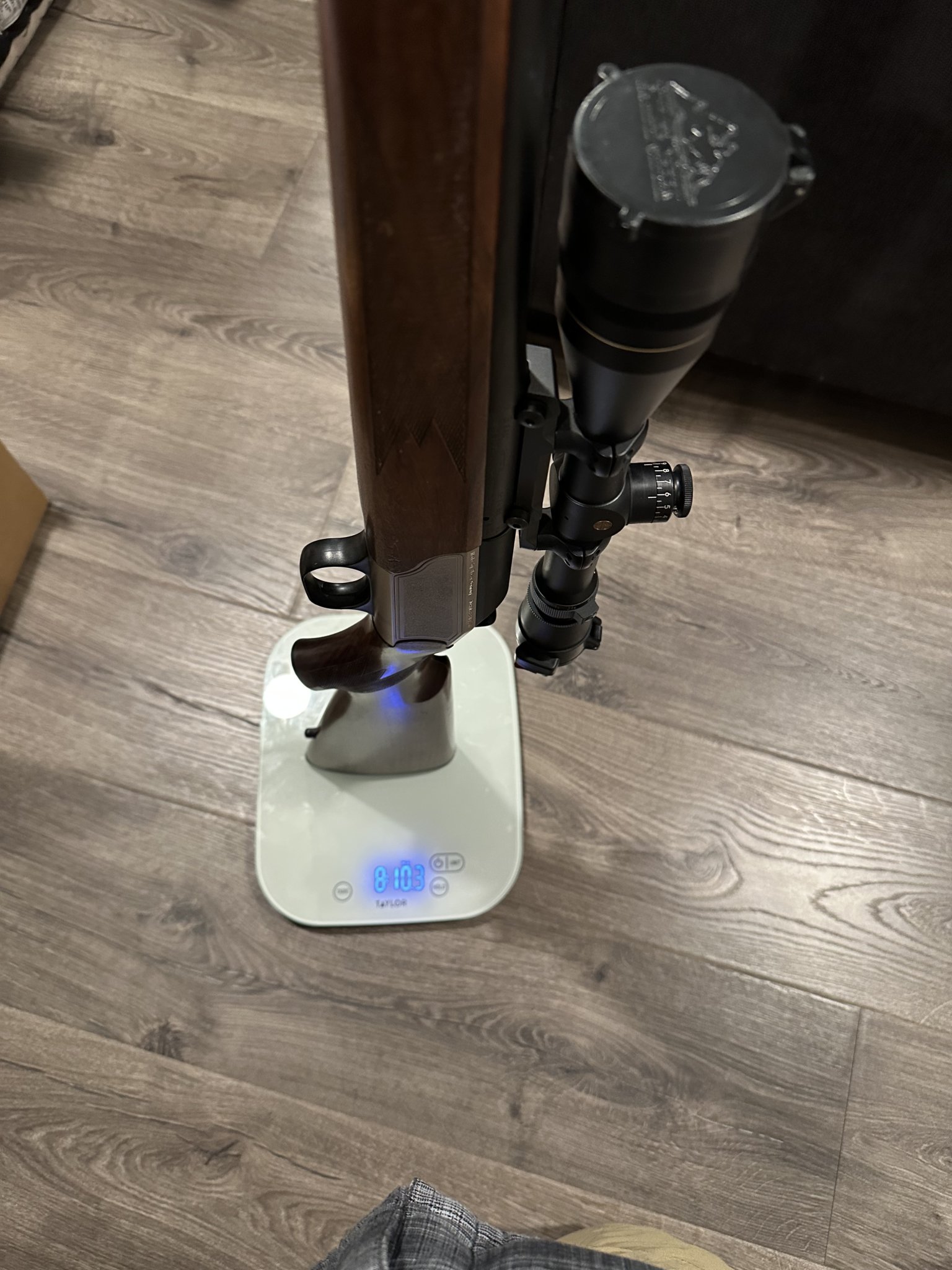

    Current set up:
    3b fluted isn't off much from what you are looking for, #3 may be able to be threaded at 20".

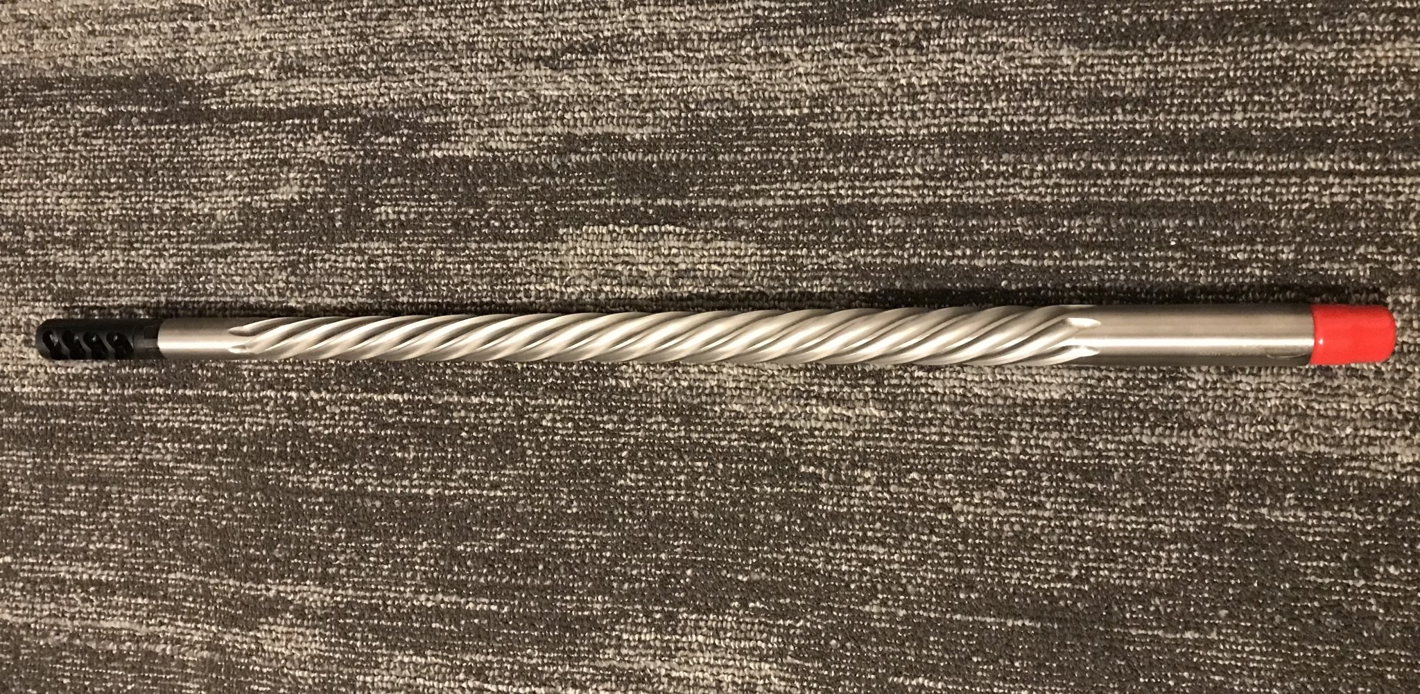

    My 6mm ARC barrel has spiral flutes as I got it right when they were starting to get offered. It’s done really nice. Pic below. It’s a Proof Comp contour barrel.

    The barrel ended up weighing 2# 6 oz. With the Peak 44 stock and a NF 2.5-10x42 on the rail it weighs in at 7# 9 oz. I plan to remove the picatinny rail from the Origin and use lightweight rings attached to the action which should save a few oz. With my Nomad Ti XC and 4 rounds it should be around 8.25# which should be handy for hunting although it’s a bit nose heavy. Here’s a couple pictures.
