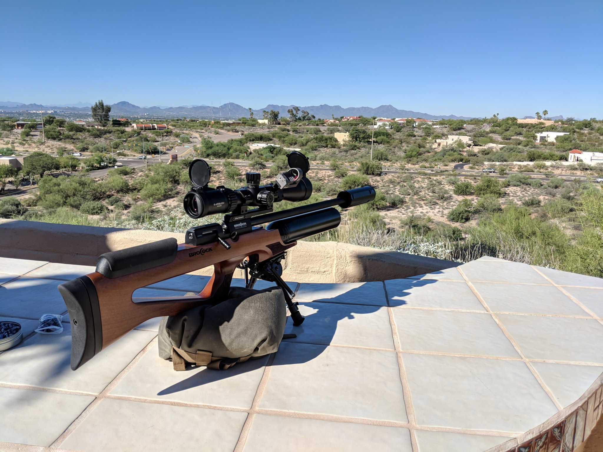

I'm looking for a 20 or 30 MOA Dovetail Base for my PCP airgun. I would also consider a solution such as Burris XTR rings (which have different elevation inserts) if such a thing exists for 30mm tubes for dovetail.
