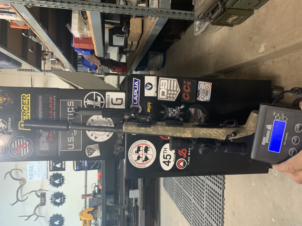

    I just built one on an XM defiance for hunting.....20" proof 1:8 that weighs in Just under12# with the can, scope and double pull bipod. I previously had a 24" proof and was getting 3,100 fps with 143's. First outing with some of that previous ammo nets just under 2,900 fps in this new 20" and it's much more compact and easier to carry in my backpack.
    I plan to do some more load work once the barrels sped up but so far I'm happy with the results.
