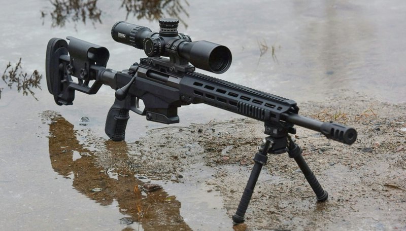

Thinking of running a suppressed 20 inch Tikka T3X in 6.5 Creedmoor for hunting out to 250 max and target out to 1000y. Is the 20 incher going to reduce my velocity enough to open my groups at 1k with target loads ?
All information is greatly appreciated.
TP...
