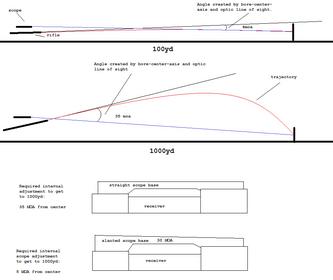

If my scope is level with my barrel (0 MOA base) and I sighted in at 100 yards, now I'm about to shoot at 200, I'd expect my point of impact to be 4.4" below where I had sighted in my rifle. Solution here would be to shoot 4.4" above my target or simply adjust the dials on my scope to bring the ridicule down 4.4" or 2.1 MOA.
All of this makes sense to me since my scope is level with my barrel.
What doesn't make sense to me is that if the scope is mounted at a slight slant in comparison to the barrel, and now I sight in at 100 yards. Anything I look at through my scope that isn't at 100 yards, for example 200 yards, my scope is already pointing slightly lower on that target then if I would have had a flat base.
So my point of confusion is if I sight in at 100 yards with a 20 MOA base in one rifle and a flat base in another. Now go out to 200 yards, is the 2.1 MOA adjustment the same on both rigs to hit the target?
I'm not sure why this isn't making sense to me I'm sure I'm way over thinking this to my disadvantage.

Your scope doesn't know it isn't mounted parallel to your bore
Once you zero it at 100 with the 20moa base it's business as usual.
But you will now be able to dial out to distances you couldn't with the flat base.
You would be 20" high at 100 if you didn't zero the scope. You are forgetting that you now have to dial the optic down to zero at 100. This now gives you 20MOA more up adjustment from your optic that would have been otherwise wasted. Just zero at 100 and drive on.
The reason we use a 20 moa base is to get better use of the internal adjustment in the scope. If from top of adjustment to bottom you have say 26 mils of adjustment in your scope, if you use a 0 moa base in theory you should be near the center of the mechanical adjustment in the scope when your rifle I zeroed. Which would leave you with the ability to use only 13 mils to dial a shot before you bottom out. By using a 20 moa base you gain yourself some adjustment by tilting the scope and zeroing off center in the adjustment range of the scope, which will add about 5.8 mils at 100 yards gaining you almost 50% more adjustment with that scope. Set it and forget it, zero is zero. You never have to factor in the 20 moa again.
Don't forget that if you would change from a 0 MOA base to a 20 MOA base you would have to crank the scope 20 MOA down to reestablish zero (assuming that the base is exactly machined and would not change the windage). After reestablishing zero, the 20 MOA base will not influence anything anymore. All it did was to shift the mechanical center of your scope by 20 MOA.
You are not seeing, that even with the 20 MOA base, when you zero at 100 yards, the OPTICAL axis of the scope is now closely aligned with the bore.
Therefore, your line of sight is aligned, so when you move out to 200 yards or further, you still adjust the OPTICAL alignment of the scope to be a higher point of aim.
Ignore the scope tube.
I could have this all wrong since I never used a base with a tilt. However, maybe you can look at it this way.
When you are complete with the zeroing process your elevation knob will be in a different position with respect to center when using a 20 mil base versus a 0 mil base. That is why a base with a cant allows you to shoot at longer ranges.
Hope I am right :)
