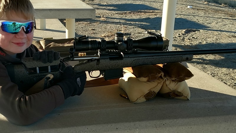

Tracking is close enough to perfect I can't see any error in any of mine. When I put a Burris base on my son's Bergara B14 HMR to mount a XTRII 3-15, it took me several rounds to figure out what was wrong. The Burris base was a 25 MOA rail, not 20. My Bad. :)

What height rings did you use? I’m trying to figure out what height for the 4-20. Do you have any pics of the space left between the bell and the barrel? Midway told me .3” but that doesn’t sound remotely correct.
Sent from my iPhone using Tapatalk
There's is no single correct answer to that. It depends on the type of rifle, stock or chassis, etc. If you are talking a basic bolt gun in a traditional stock with an exposed barrel on top, then a 1" to 1.2" ring will most likely suffice. The .3 distance given to you by Midway as a gap measurement between the top of your barrel and the bottom of your objective bell housing is a fair one. I wouldn't want more than that though personally. A .125 to .25" is sufficient.

I should’ve been more specific. It’s going on a Bergara HMR. I wasn’t aware the .3 was referring to the gap. Learn something new everyday. I hadn’t heard anyone reference that before when talking about ring height. I’ll start at the 1” and work from there. Thanks!!!
He got some AMR low rings. Plenty of space on this set-up.
