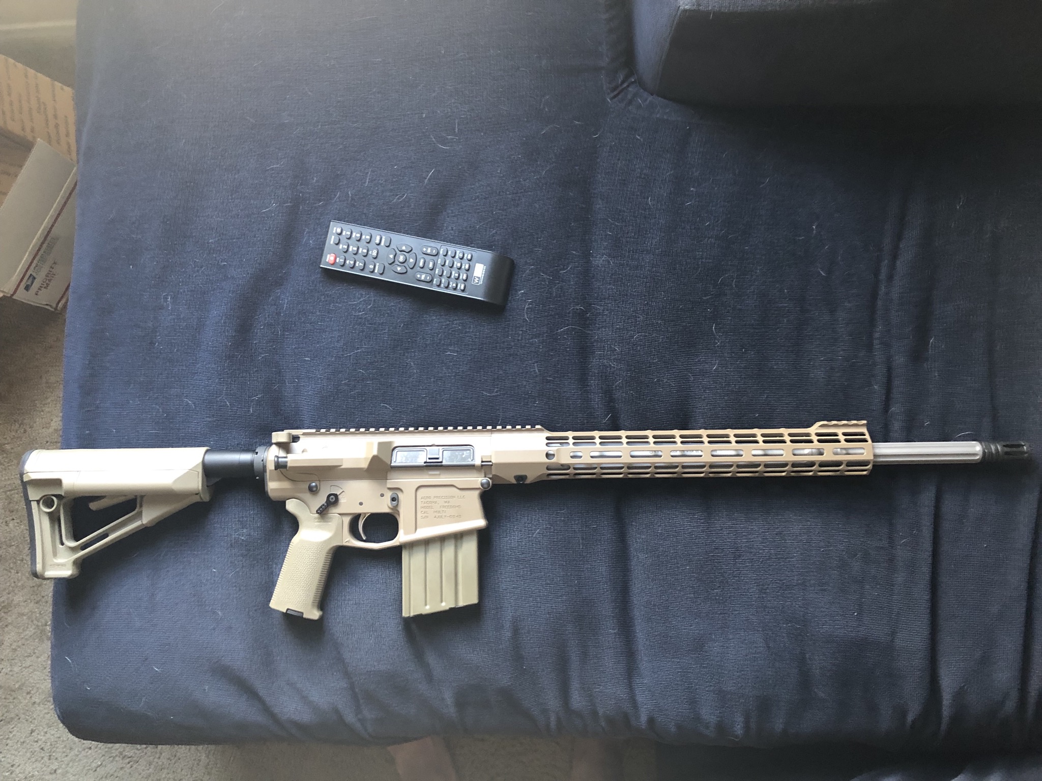

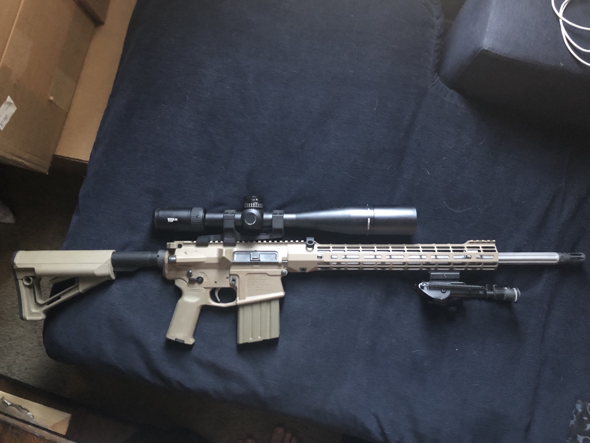

I recently built my first AR10 and the only thing I lack now is a scope and scope mount. So I was wondering if I should get a 20 Moa scope mount or not. The gun has a 20 inch Ballistic Advantage 6.5 creedmoor Barrel. I’m planning on picking up a Vortex viper pst 2 5-25x50.

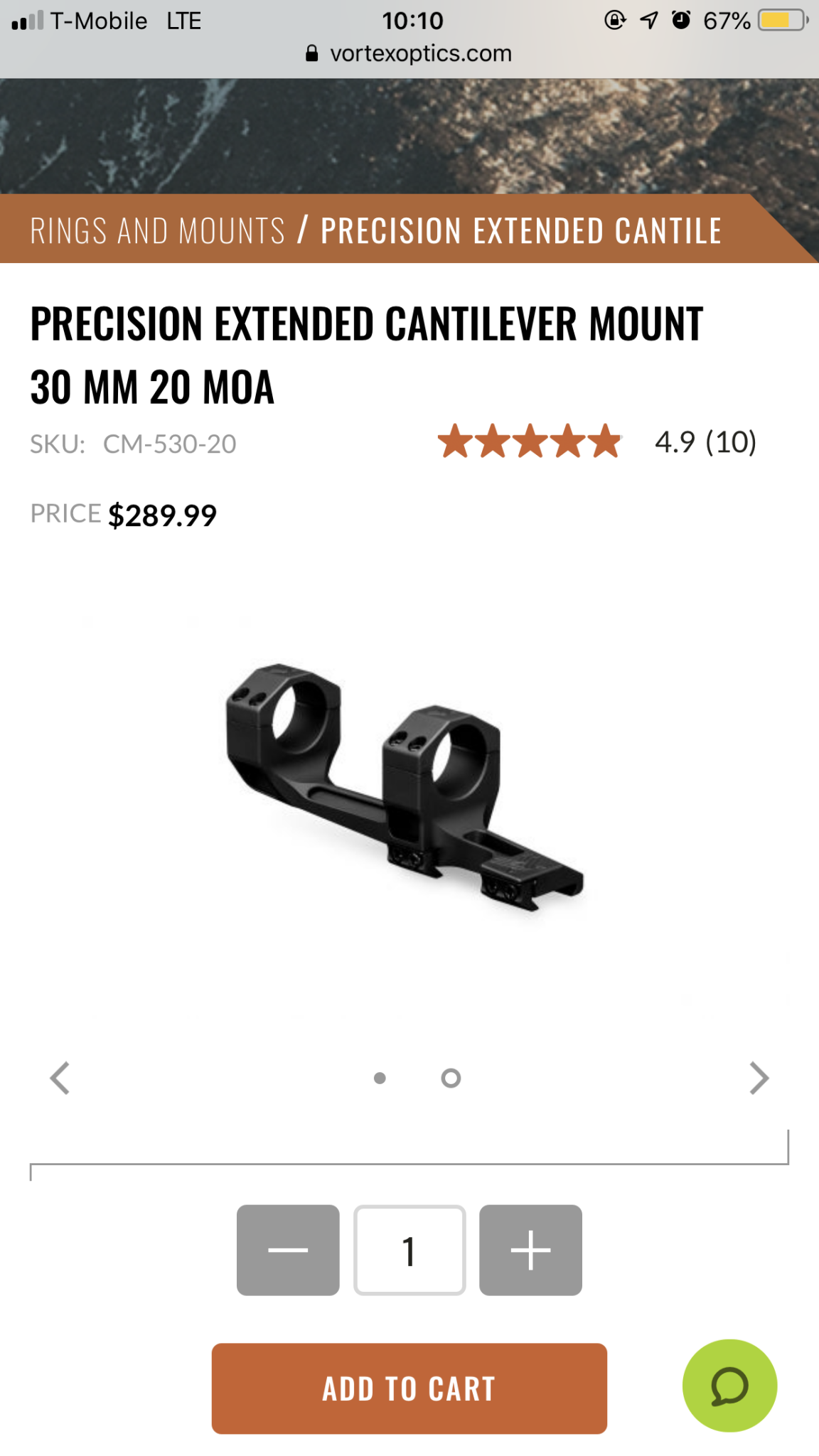

Yea I was looking at the precision ones like this.

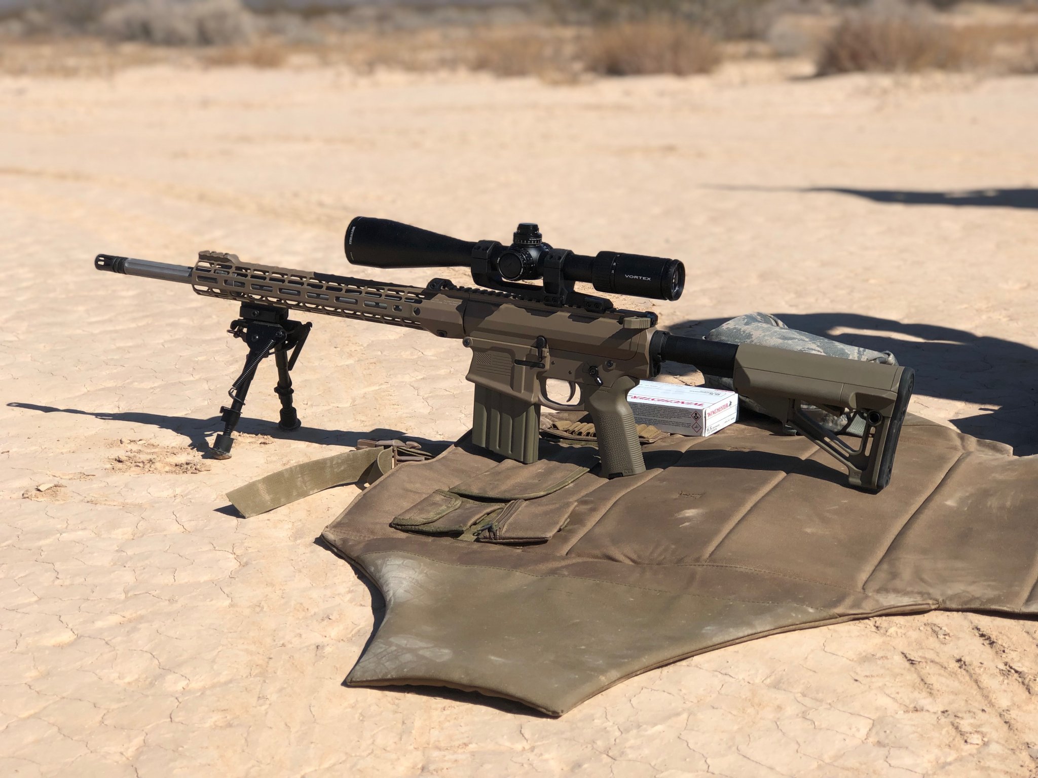

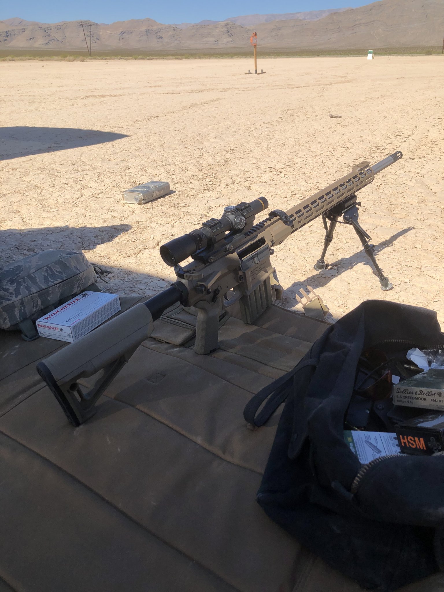

I shot this rifle the other day with a loaner scope and cheap ammo. I forgot the Allen key to adjust the gas block so it’s pretty over gassed but I’m decently happy with it so far. My big scope and mount should be here Friday. I can’t wait to finally have this rifle done!

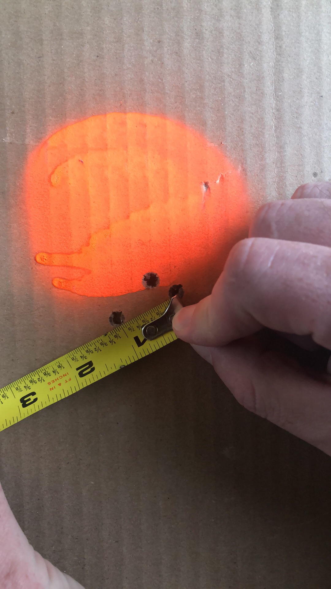

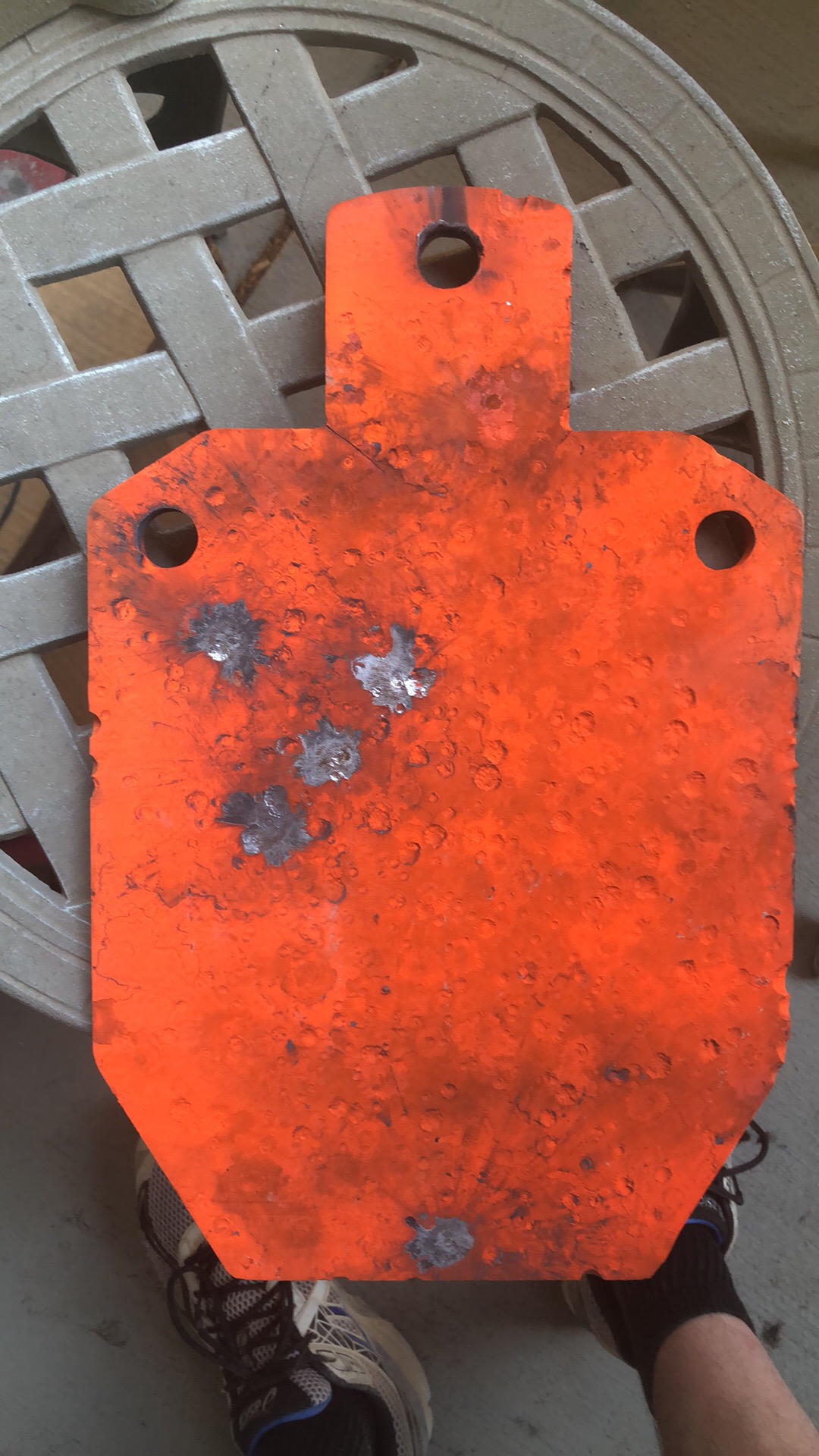

Took it out to the desert today to sight it in and tune the gas block. Pretty impressed!! The spray paint group is with either Winchester white box 125 grain or S&B 140 grain cheap ammo. In fact I dialed up for 500 and hit the gong first shot with the S&B. Very pleased. I can’t wait to stretch it out further. Thanks everyone for the advice!!
