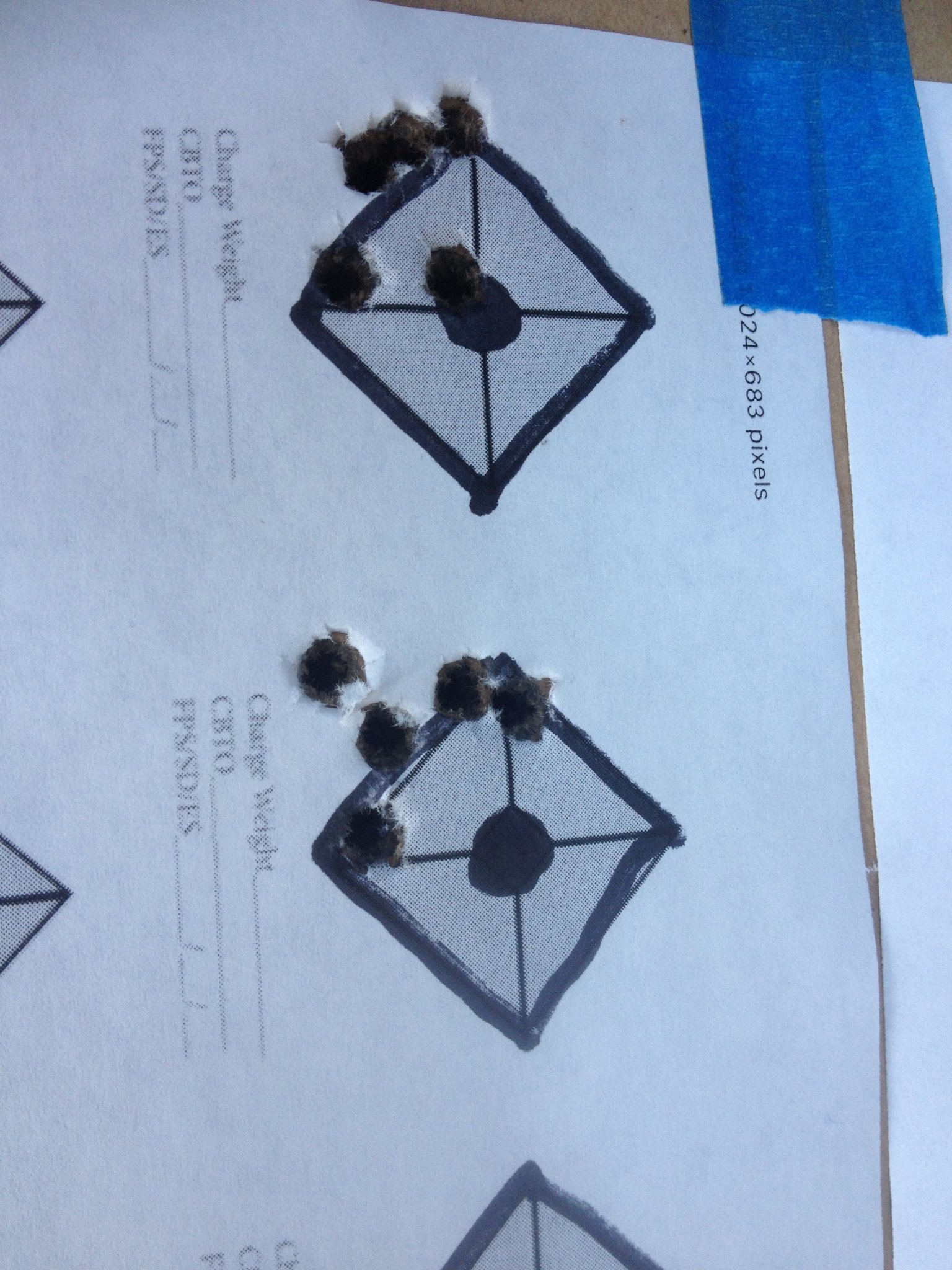

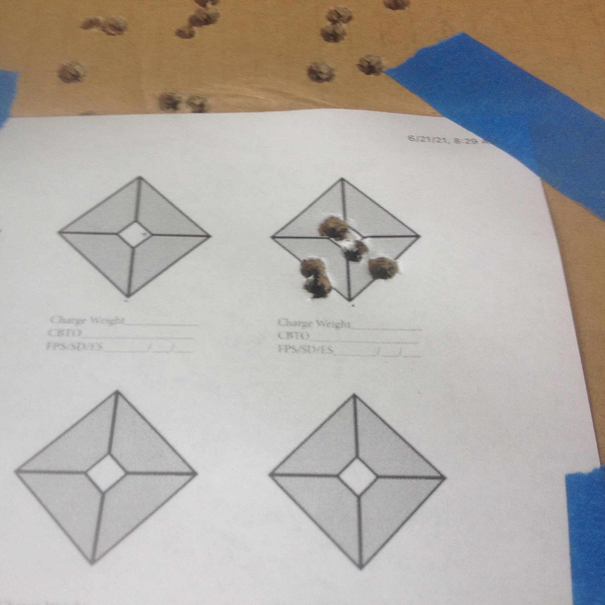

Just how much Lever we talkin'? I'm running Ramshot Tac in a 26" 8-twist .204 Ruger bolt gun, and seeing 4000-4100, but if you're seeing 39xx out of a 23.5" gas gun, that may be worth a look.
I went out yesterday and worked from 26.5-27.5, 26.5 was about 3700, 27 was about 3830 and 27.5 was about 3925. The groups didn't look very good yesterday but the wind was blowing pretty hard and I wondered if it was moving around my target frame. I also wondered if my big bag of Winchester brass I had dug out off the bin and sized annealed was the culprit, or if I had sized all that Win brass with the bigger bushing I have that didn't give me enough neck tension and didn't shoot well. Here is a five shot with brass ran through the die again, and a 5 shot with brass out of the bag @ 27.5g of WC844 with the 32g Noslers, out of my 18" barrel.
First group made me think I need to move my zero .1 mil right, second group confirmed it. The load I was shooting the other day was 25 or 26g at about 3650. I put some thicker lines on the outside of the targets and dot in the middle to make it easier to see, with my Weaver Tactical
2-10x36.
Sorry didn't want to go back and edit the picture on my computer to get the correct orientation. Just turn your computer on its side, blue tape is top left corner. :ROFLMAO: :ROFLMAO: :ROFLMAO:
