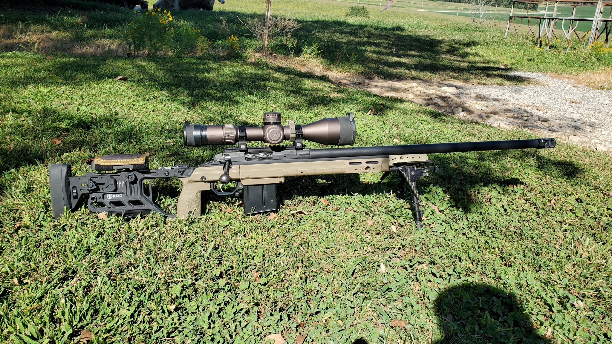

I've got a 26" 8 tw shilen, 140 and 147 eldms do 3030 comfortably and in the .2s-.3s with h1000. .3-.4 grs more and I'd see slight ejector swipes and lost some accuracy. I really like the prc, so I snagged a 22", longest possible, 6.5prc savage prefit in pva 6.5 labor day barrel sale. Not for sure how soon I actually put it on, shilen barrel is at 150rds so far.
Gratuitous rifle pic

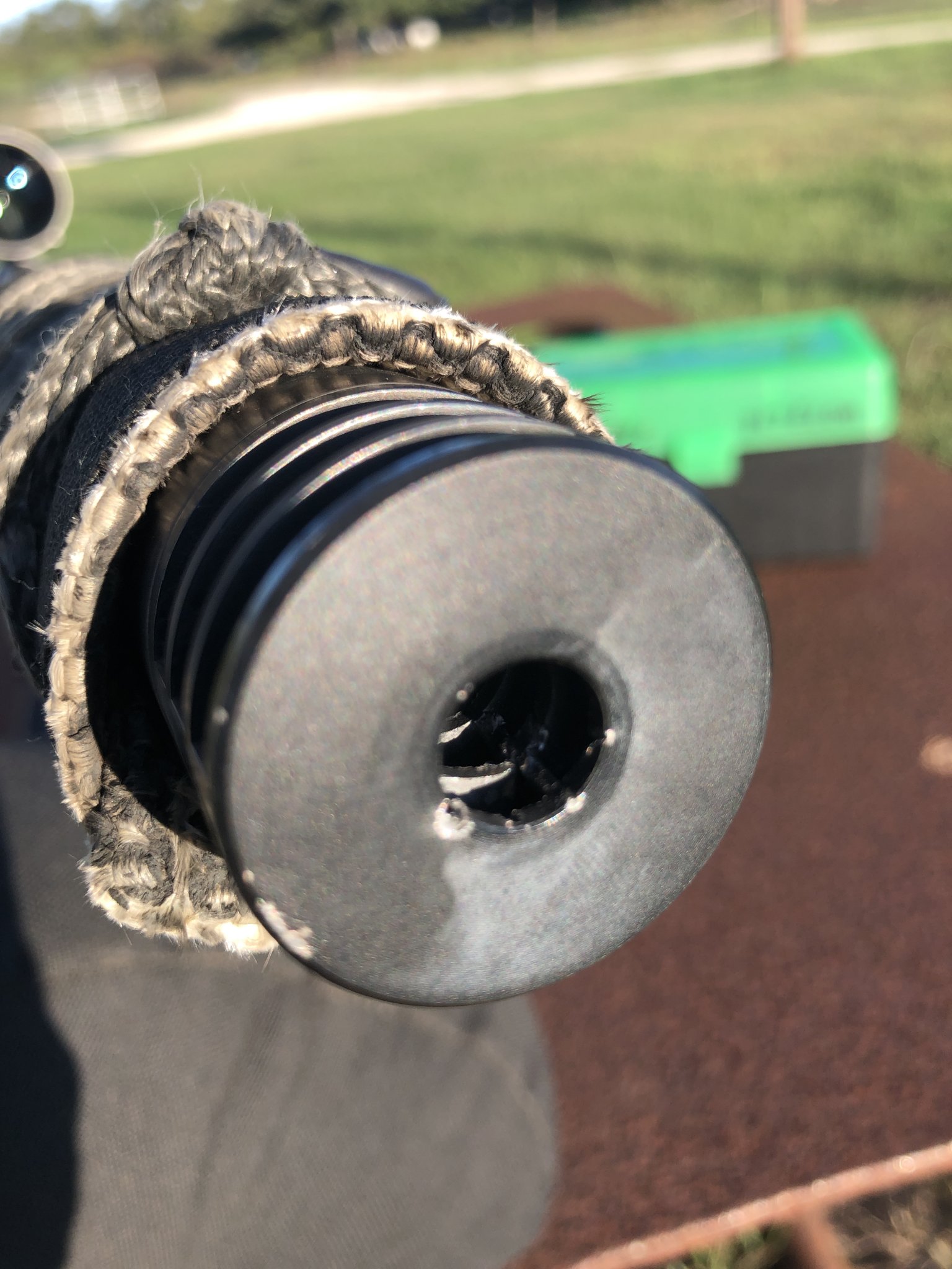

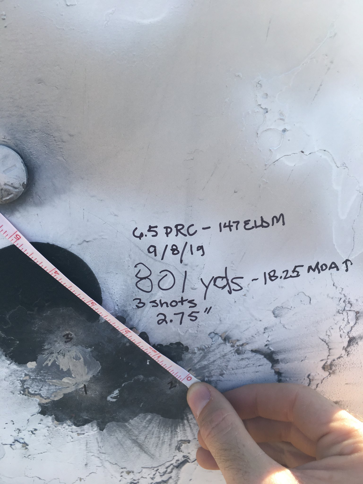

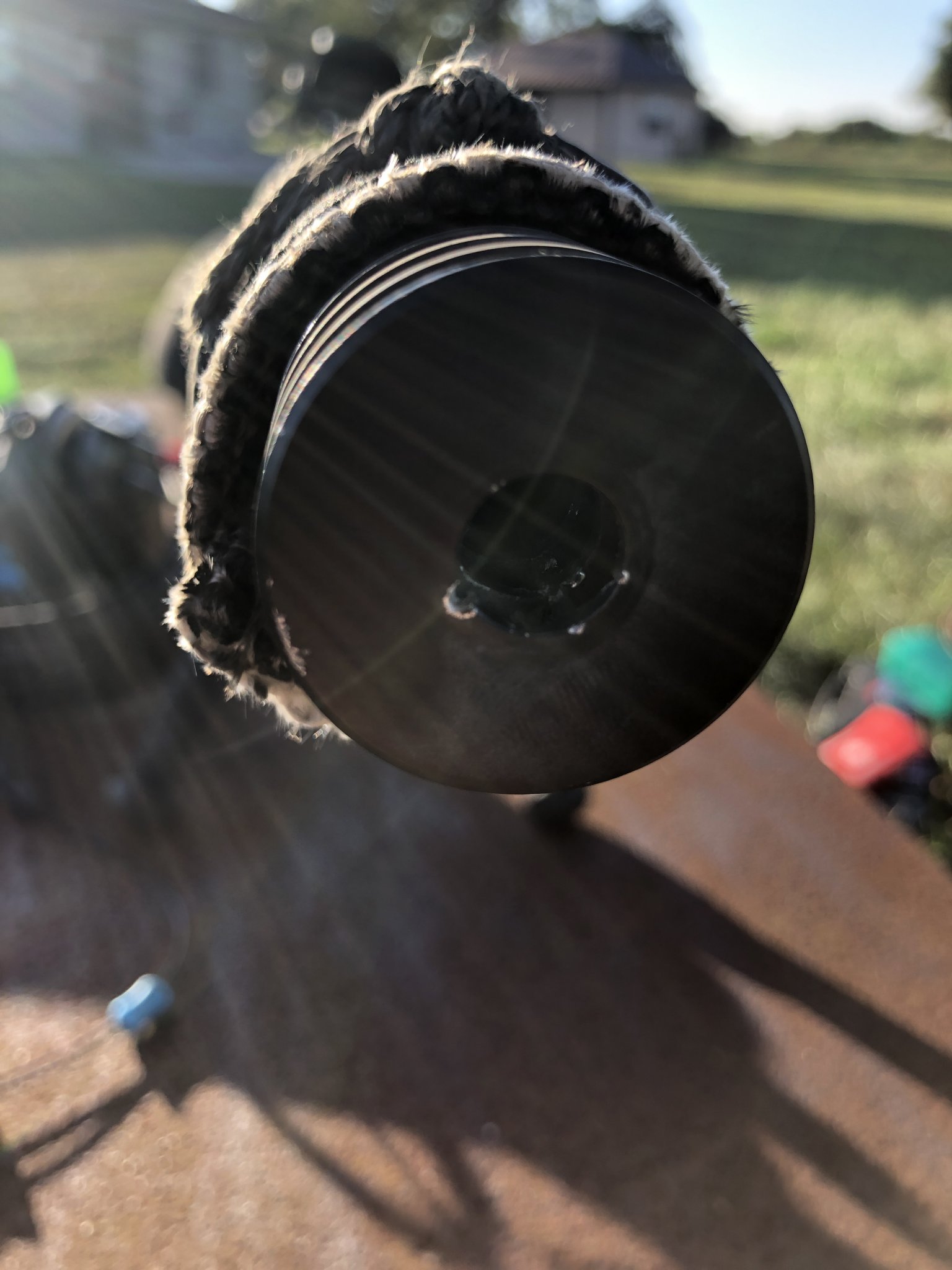

3rd shot zeroing didn’t sound right and I caught a little smoke in the face like a pierced primer. Knew that would be bullshit and when I couldn’t see a 3rd bullet hole in the target the light bulb came on.....
Took suppressor off and watched the next 2 POOF 20-30 yards out of the muzzle.
I got nothing... What twist is your barrel? What free bore was your reamer? Maybe has something to do with the 147 ELDs jamming at normal COLs in lots of PRC chambers?

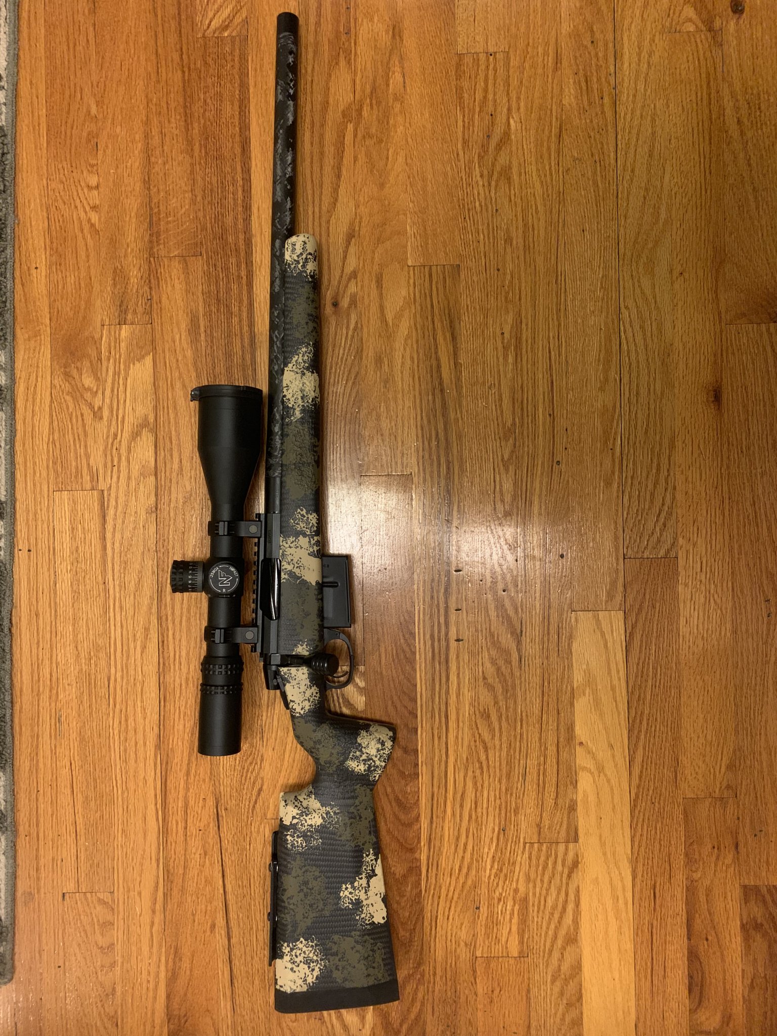

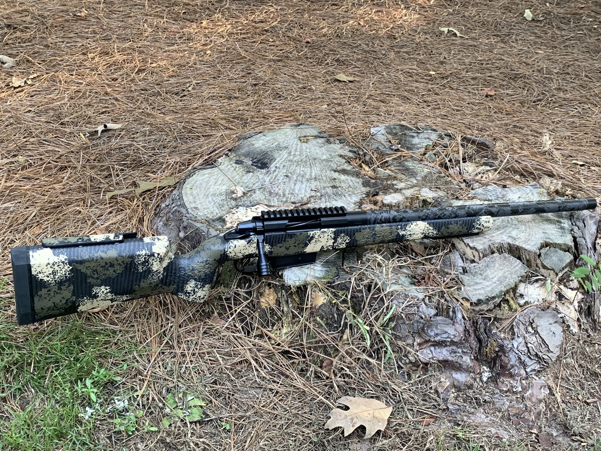

-22” proof 8 twist, Straightjacket Armory Origin Shoudered Prefit
-.154” freebore
-Deadair Sandman Ti
-147 eld m .015” off lands
-57.9 gr H100
-Fed 210 Match
-Hornady 2x fired brass
-2.945” COAL, 2.303” CBTO
-2,883 fps, SD 2.59 ES 6 via magnetospeed

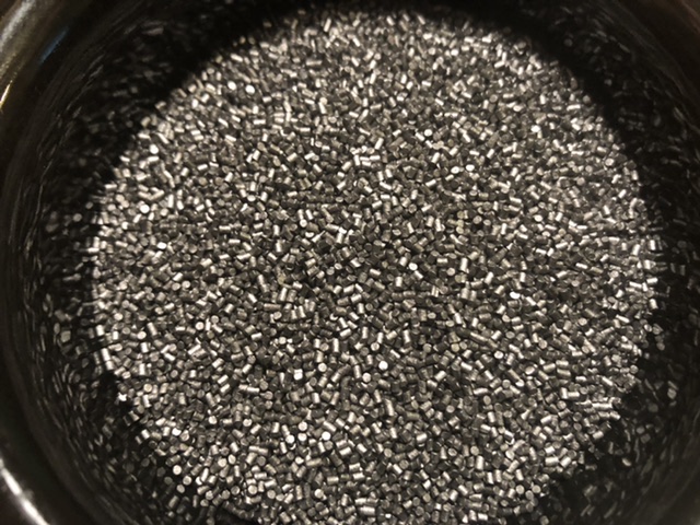

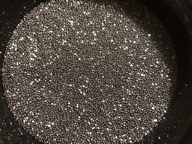

Factory 6.5 PRC Precision hunter ammunition is a crap shoot. Here are two photos I posted last week in another thread showing the powder from two different lots. There was a two grain difference between the two as well. The stick powder is capable of much more velocity.

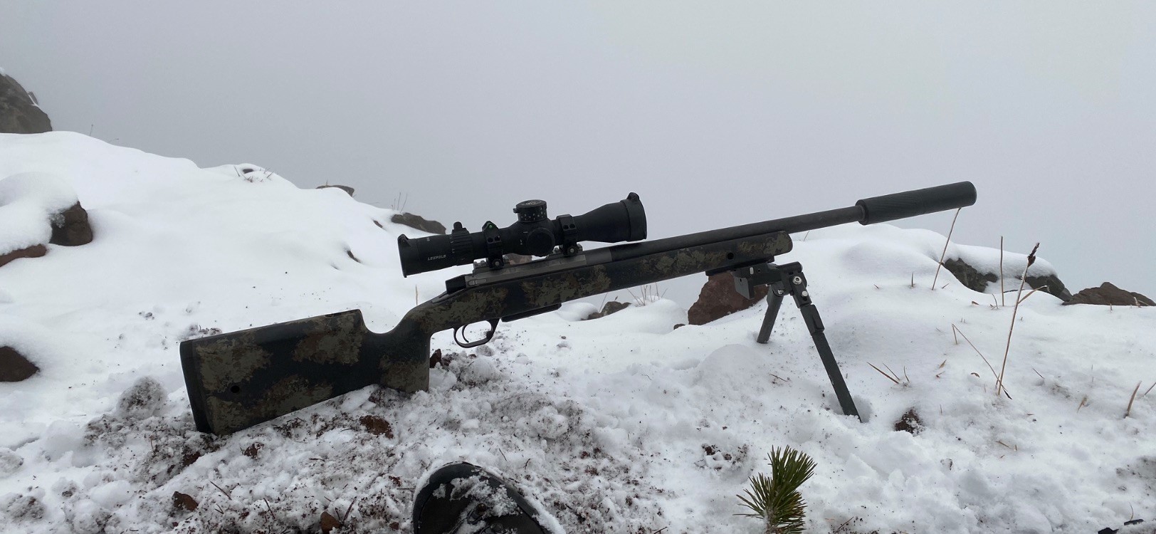

124 Hammer Hunters at 3000 fps (Using 4831 sc)
It's my new favorite hunting gun. Light, but not too light. Good shooting. Can spot hits or misses IF I am squared up firmly behind the gun. I think it is around 8-9lbs with ammo and all decked out. About a lb lighter without bipod, but I always roll with a bipod.
