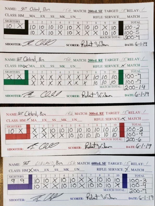

    Their new barrel maker and gunsmith is retired USAMU Staff Sergeant Ben Cleland.
    Ben fired the first-ever perfect score of 800 with a service rifle at the 2019 Charlie Smart Memorial Regional in Oak Ridge, Tennessee on 1 June 2019.
    The 800-point course is 20 shots standing in 20 minutes at 200 yards; two 10-shot rapid fire strings sitting at 200 yards in 60 seconds each; two 10-shot rapid fire strings prone at 300 yards in 70 seconds each; and 20 shots in 20 minutes prone at 600 yards.
