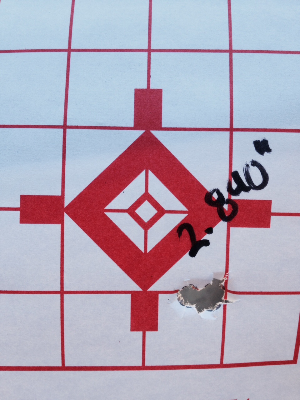

Well, dang! I had to go pick up a pound to try out with the last 185's I have. Loaded up 45.5, 46, 46.5 and 47 at 2.840, wanted them in the mag as well. I punched in some data at JBM, comparing drop and mainly wind against the 175SMK@2650 and it's well worth it if they work out accuracy wise. I only picked the 175SMK at 2650 since it's my current load. (IMR4064/43/2.80)
