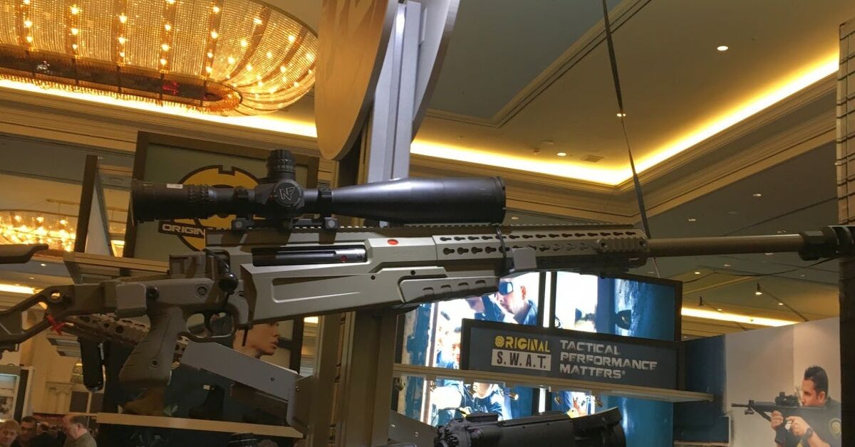

1. Accuracy International/AI - had data sheets on the upcoming (read late 2020) "AX50 ELR" multi-caliber rifle (.375 and .408 CT and .50 BMG) - no hardware in the booth. The print size is so small I'm unable to get a clear image - I'll try again from home. the look is substantially different from any of the current designs. Single-cartridge MSRP is expected to be approximately $12K.

Been waiting awhile for the new revision of the ax50, is it similar in design to the one they showed at shot a couple of years ago, or a clean slate design?
Please provide a photo of the "couple years ago" sample and I can compare, else wait for my pic of the spec sheet on Saturday. Best I can do for now.
TFB did an article in 2017:
That photo is of the current AX50, same as on their website.
The photo'd AX50 seem to have 3 big differences. It has the barrel change system shown by the additional Allen key hole like the AXMC; directly under the serial number on the action. The buttstock is a different design from current production AIs. They implemented a 3 position safety bolt shroud and eliminated the F/S switch safety that was positioned above the trigger.
But hey if it's completely redesigned Im all for seeing the final production version and will wait patiently for this weekend!
