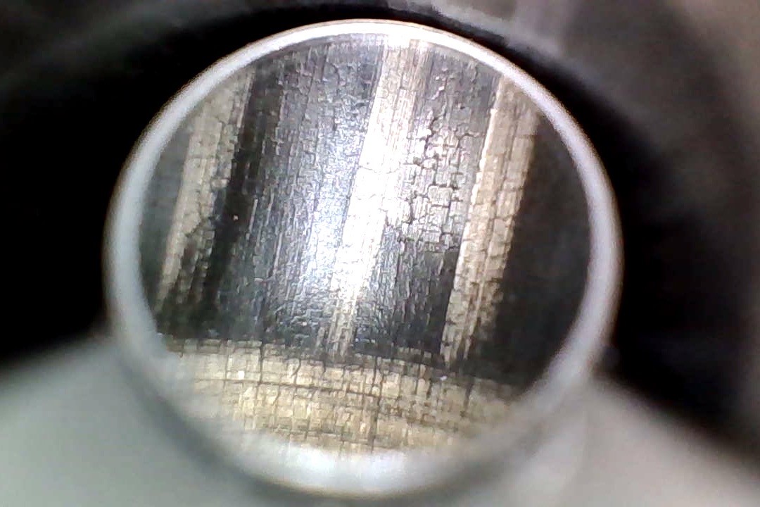

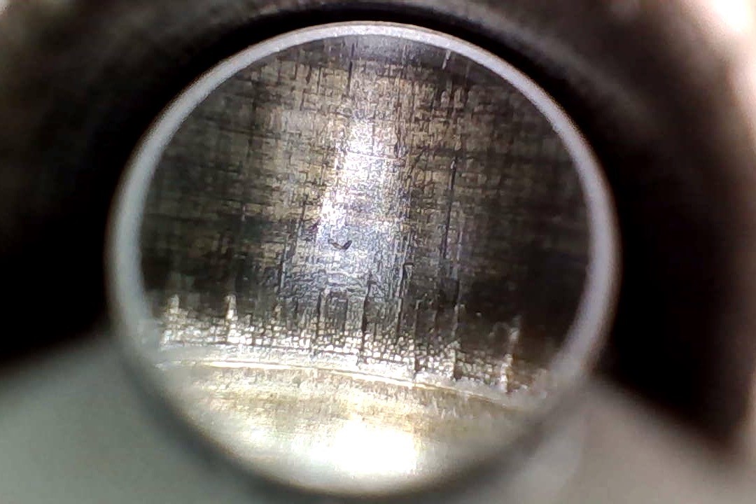

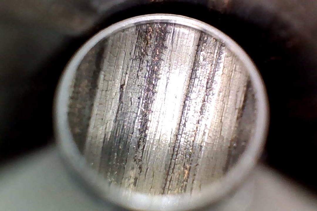

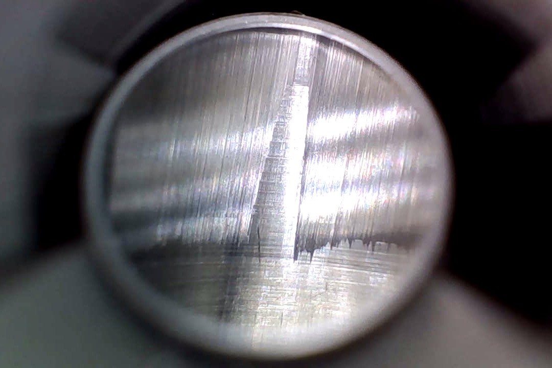

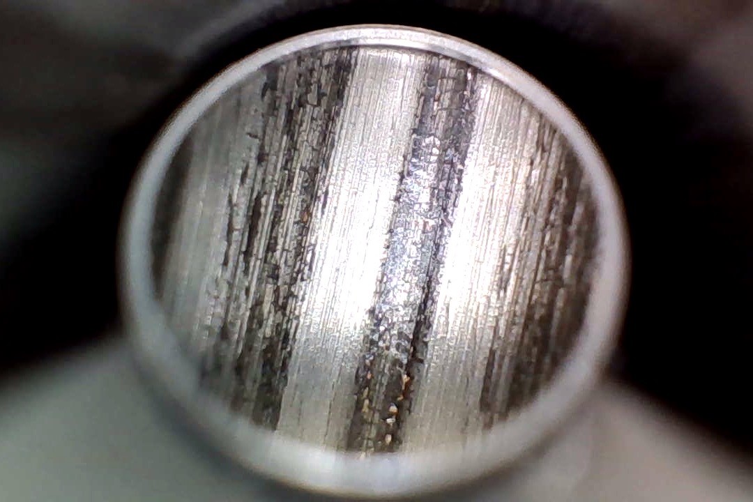

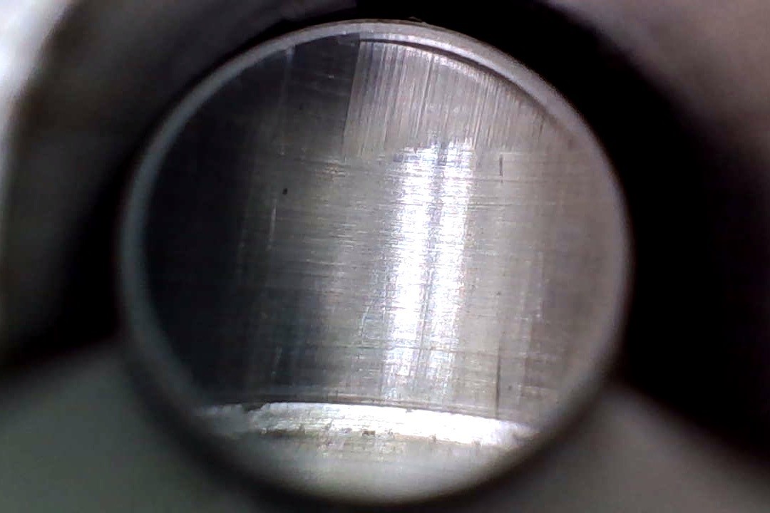

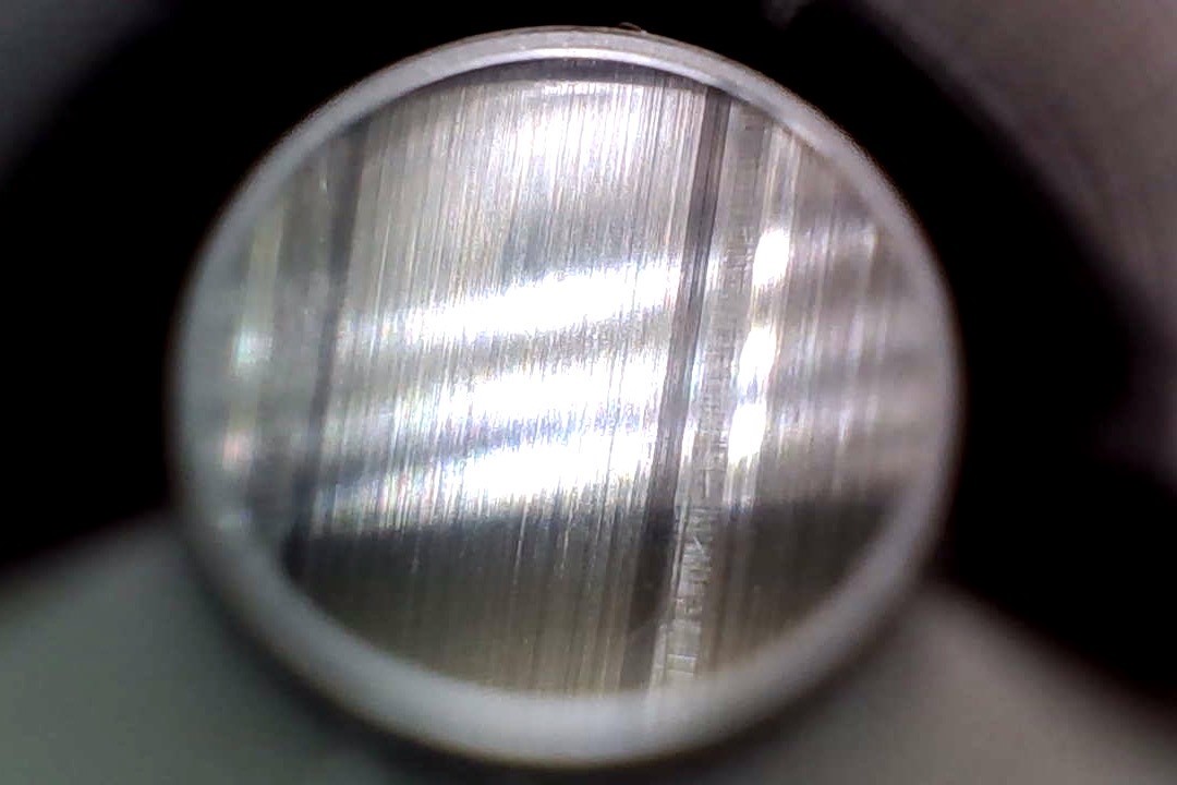

Well, I cleaned the barrel on my rifle and took some pics with the bore scope. I also took some pics of the same area of the brand new barrel for comparison. I think that old barrel is toast. The pics are mainly in the throat area and just forward of it. Anyone think the old barrel has any life left?

Bore scope really doesn't tell you shit unless you are trying to figure out a copper/cleaning issue. Either the barrel shoots or it doesn't. Those people saying they get 2k from a 6cm pushing over 3100 are smoking something good. A 6gt running 3k will burn the barrel out around 2k, maybe sooner. A br/dasher/gt running about 28-2850 should last almost 3k. Most of the people running piss hot 6cm or xc are looking at 900-1200 rounds before barrel takes a dump.

Well, I don't know about other people, but I've been keeping track of the rounds down the barrel since I installed it and I don't smoke. In my case, the bore scope gives me a look at the relative condition of the bore. If I can't get it to group anymore, and see those conditions, it's done. I'll get it back out this weekend and shoot some groups and get some velocity since I'm curious. Another friend suggested that I increase the charge weight a little to bring it back in the velodity node, but I'm thinking I don't want to waste the time anymore. The first 6-7 hundred rounds from this barrel were not at match pace, so that may have helped. I don't know...

There is no such thing as nodes ( really) and upping the charge weight is not going to make it shoot better. Your throat is cooked, there is a reason guys pull barrels early instead of too late. Your barrel has most likely been done a while.
