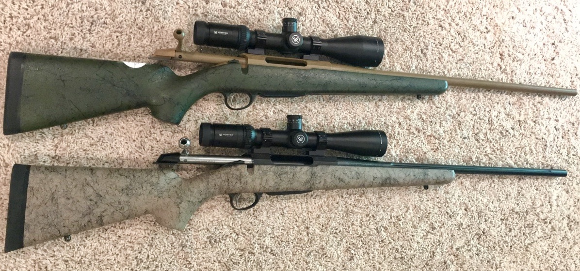

I've done 2 of these. Now the 270(bottom) has a spiral fluted bolt cerakoted to match and a Razor LH. Current pictures are in the Tikka form. The 300 has seen WI, CO, WY, and AK. The bottom has hunted TX, WY, and WI. They both have a bunch of critters on them. I love it for a hunting set up. I also have a CTR 260 that will see most of the practice reps. All will have LH or LHT Razors with the same reticle.
