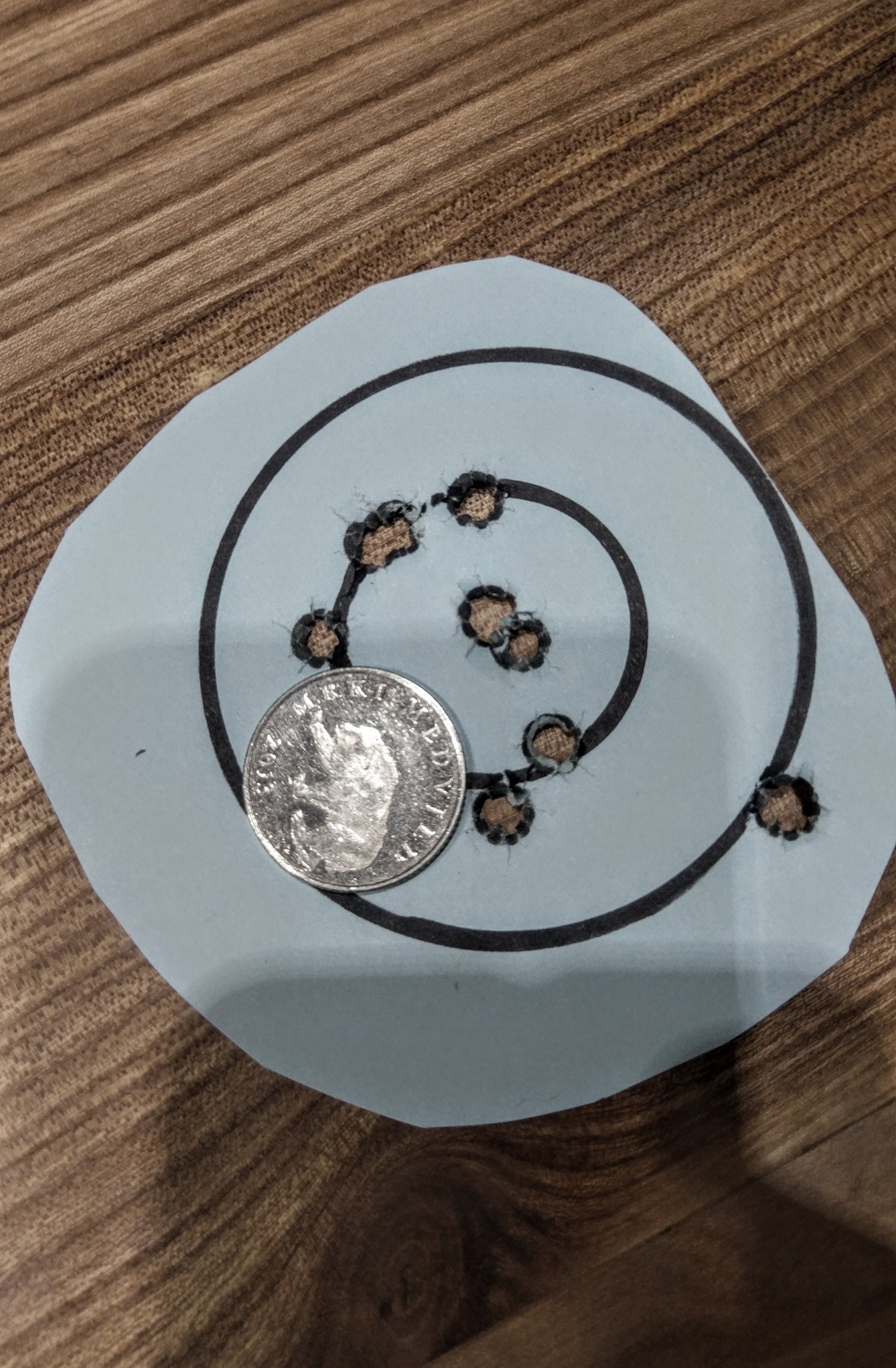

I know, .001" tension, after springback, maybe .0015, thats what I was looking for, we will se on paper whats going on with all that at 600 meters
Image below is 320 meters( 350yards +-)

That's what I thought ;)
So looks to me like it's shooting pretty well if that's 350 yds, that is about a 1" group...like 0.35ish MOA.
What do your MVs look like (SD and ES)?
