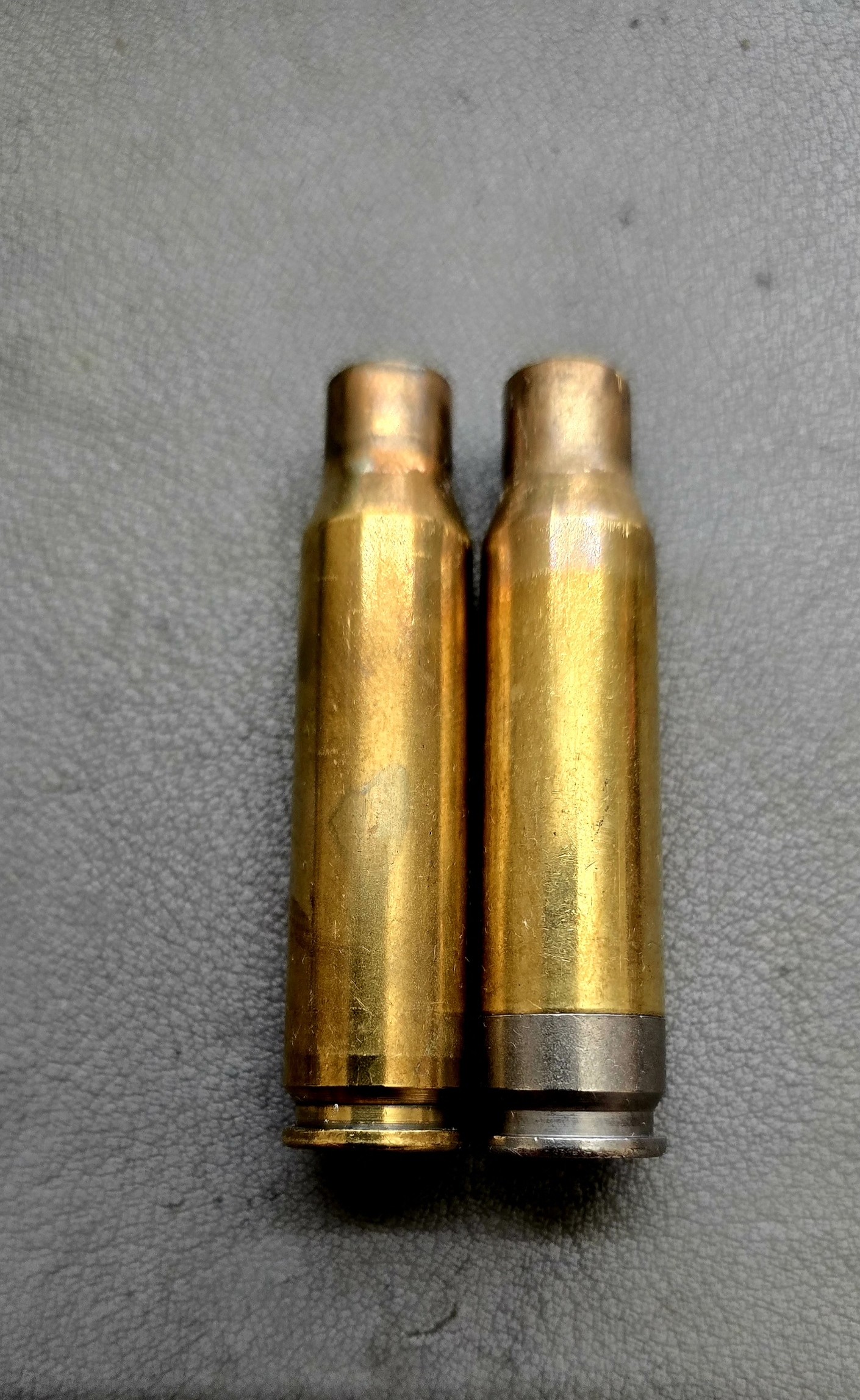

Is anyone else loading these in the hybrid cases? Read about them here and they sound like absolute hammers in a lightweight hunting rifle.
@45-90 have you tried any of the hybrid cases with this bullet in .308?
Been shooting hybrid cases in various 308 bases cases since they first came out.
308, 358, 6.5 CM, 8.6 blackout.
I don't shoot as many game bullets these days, but alot of match bullets...depending on caliber.

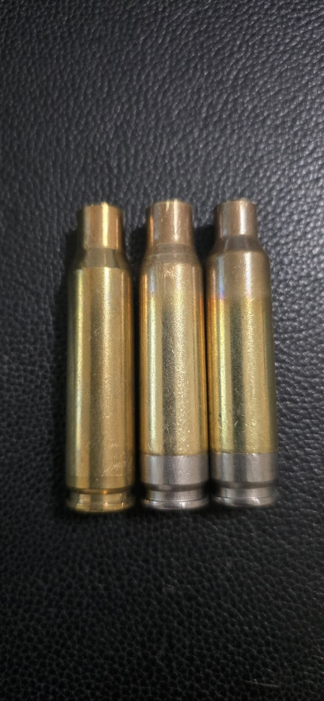

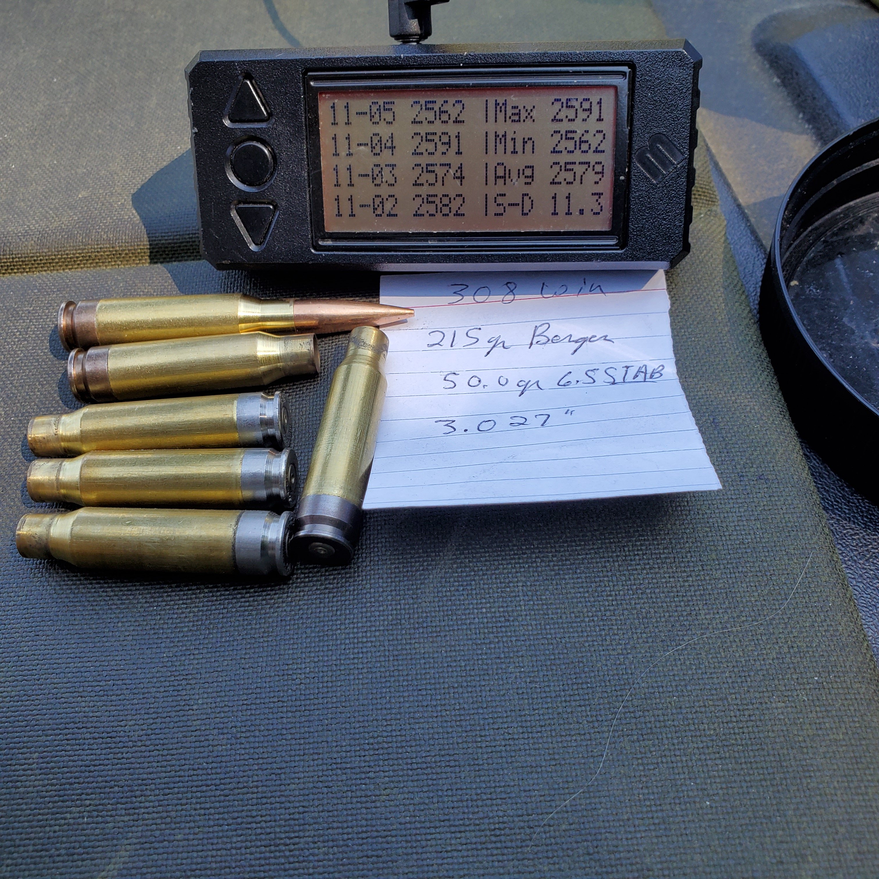

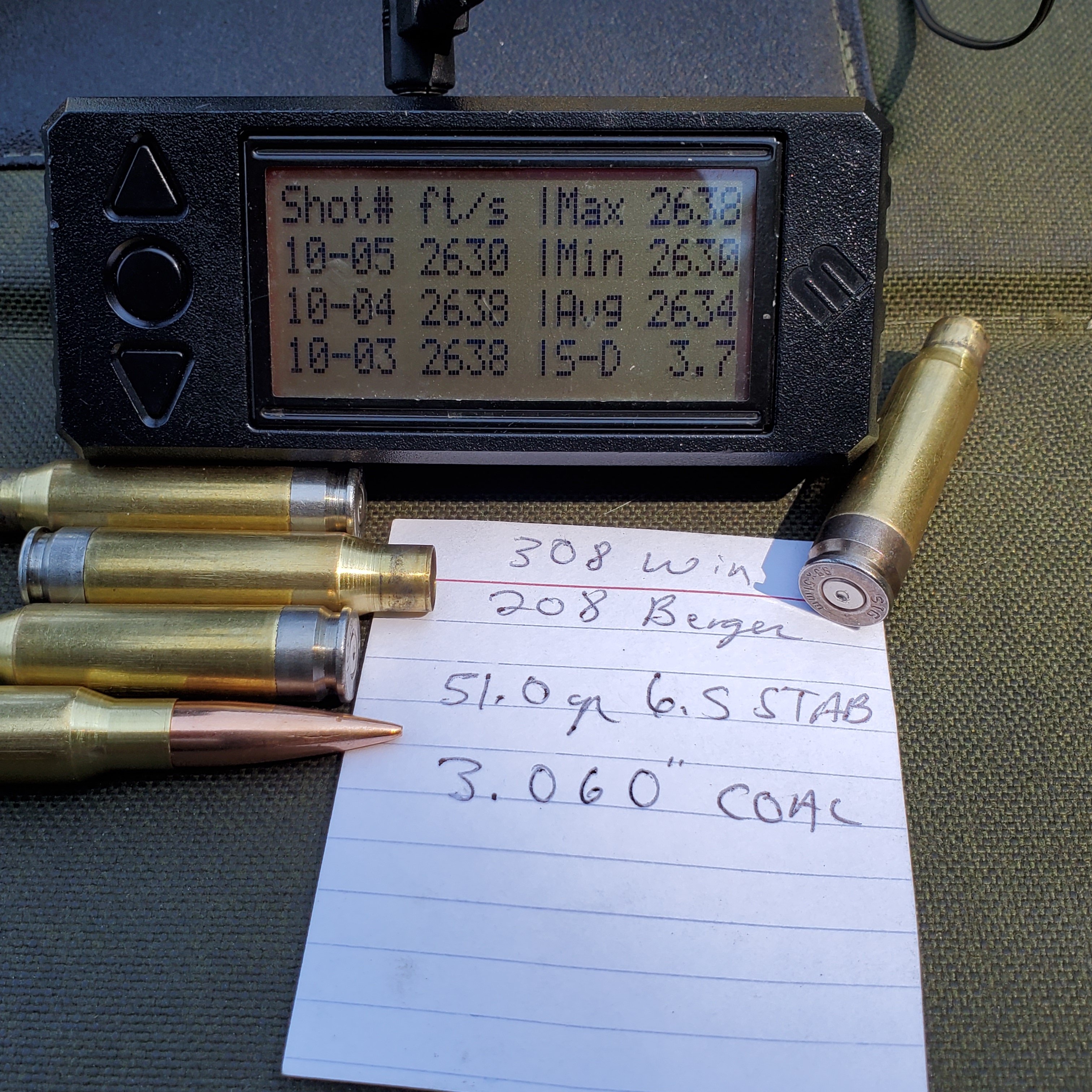

I recently fired some hybrid cases with 308 in a 22" barrel 9 twist barrel.
These were Berger 208 gr and Berger 215 gr. With 6.5 Staball, notice the 208 Berger hybrid have a high BC and low S/ D and better accuracy in my rifle.
If you shorten the overall length take out a few grains of powder and work up.

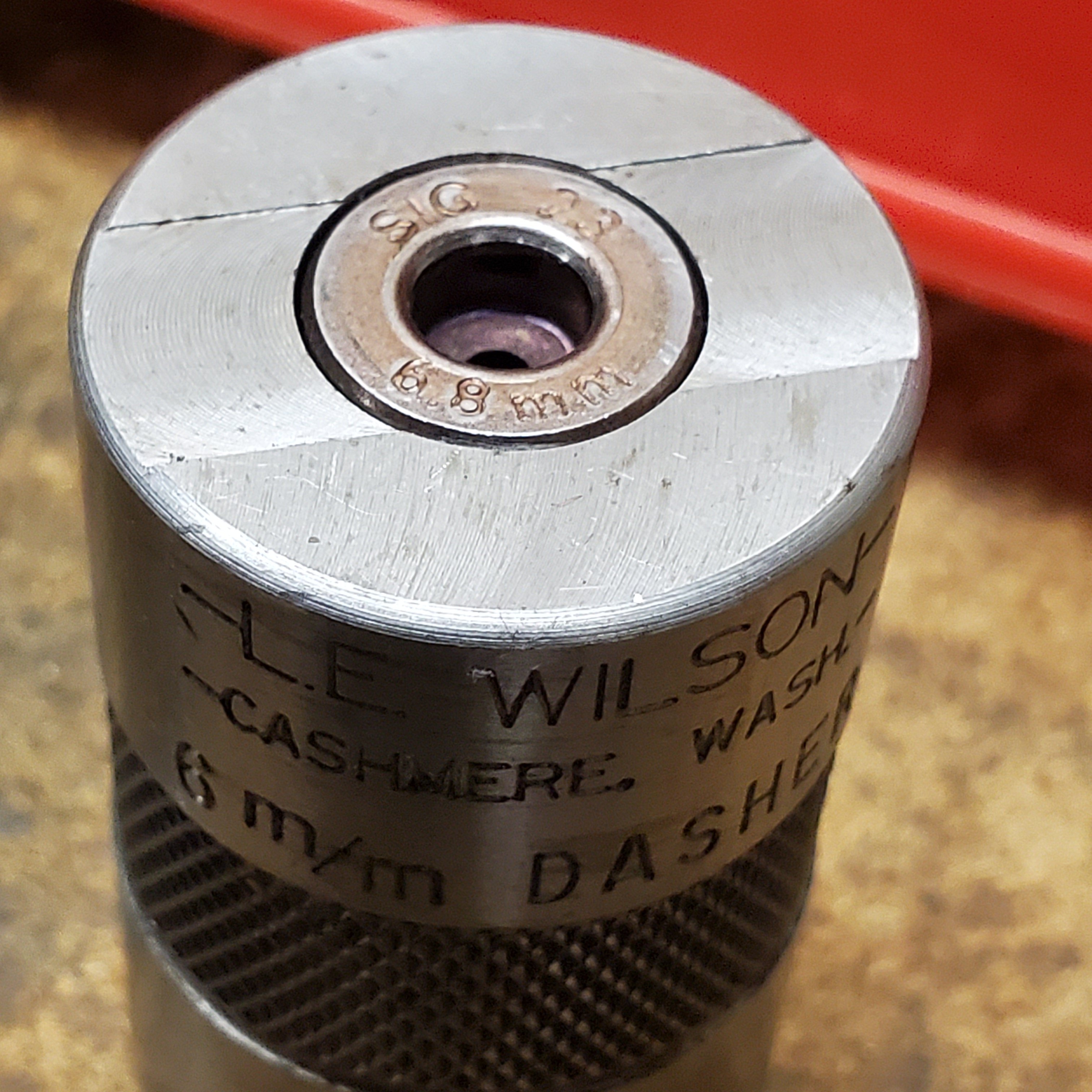

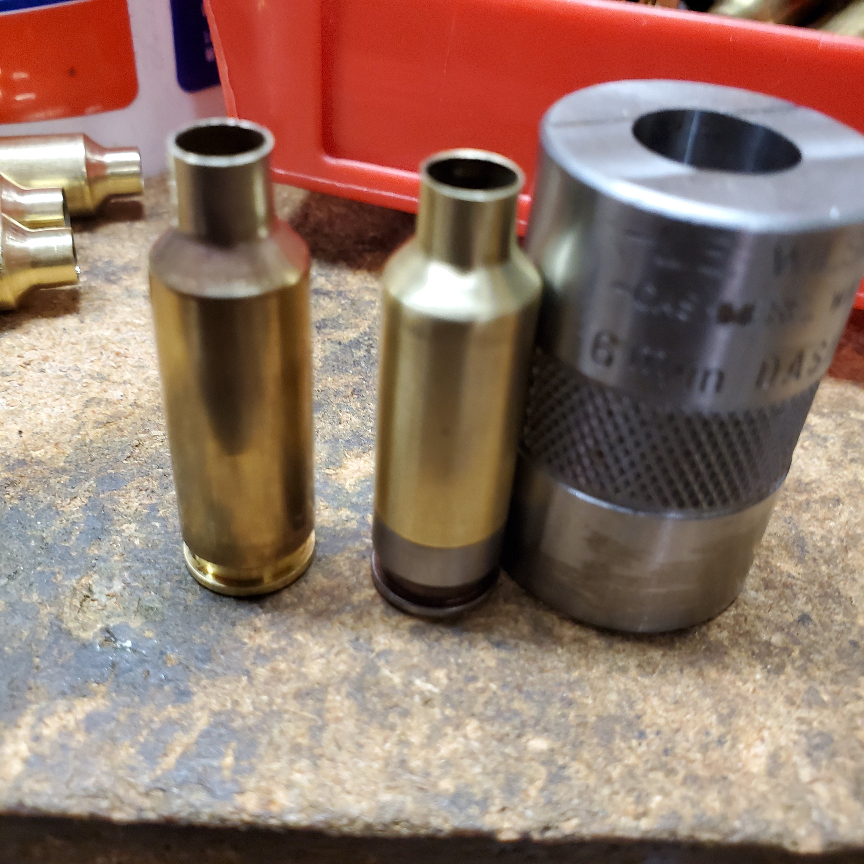

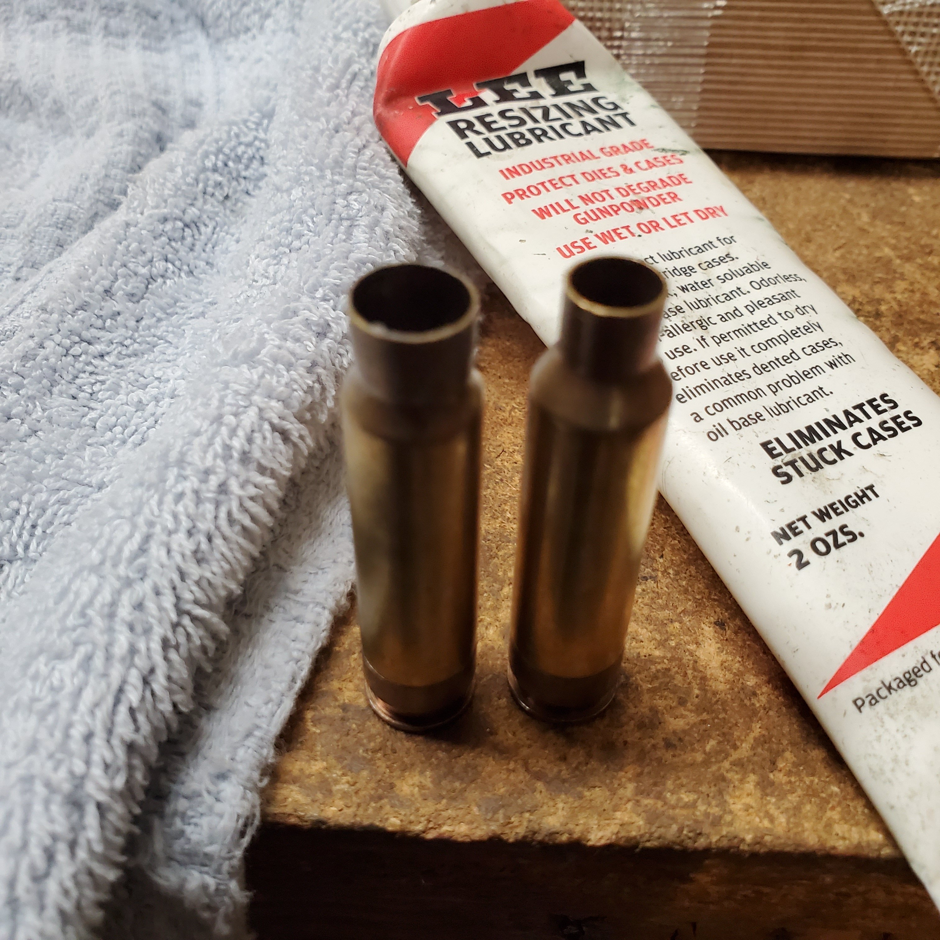

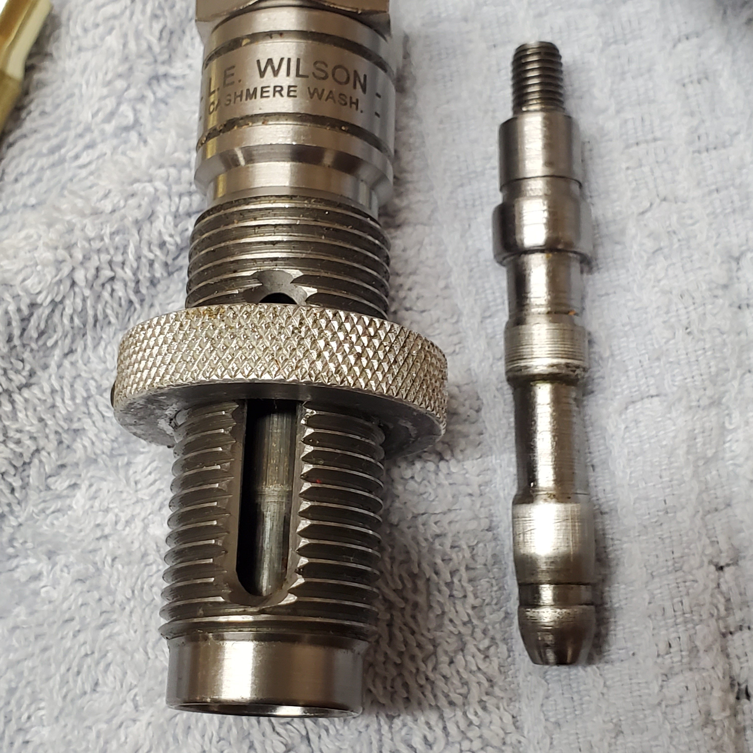

I manderal up to 30 cal and run through a 308 FL die anneal, and neck turn as shown in the lathe with a ground carbide tool that has a sharper radius in the neck shoulder junction and slightly cuts the 20° angle.
No donuts for pinch points at high pressure and little spring back. It all can be done with hand tools just takes longer.
As always be careful work up slowly, they safe in my rifle, but every barrel and chamber is different. ...For Bolt Gun Only.
I have 8 308s for various purposes bolts and autos, long action and short.
The long action 30" 8 twist has some fantastic velocities for a 308 case, like 225 eldm at 2700 fps, or 168 gr at 3255 fps, 200 SMK at 2952.
But if ya want short barrels you'll lose alot of velocity.
If you shoot short barrels stay with heavy bullets, the velocity difference will be considerably less.
The 308 of today doesn't have to be the 308 of 50 yrs ago.

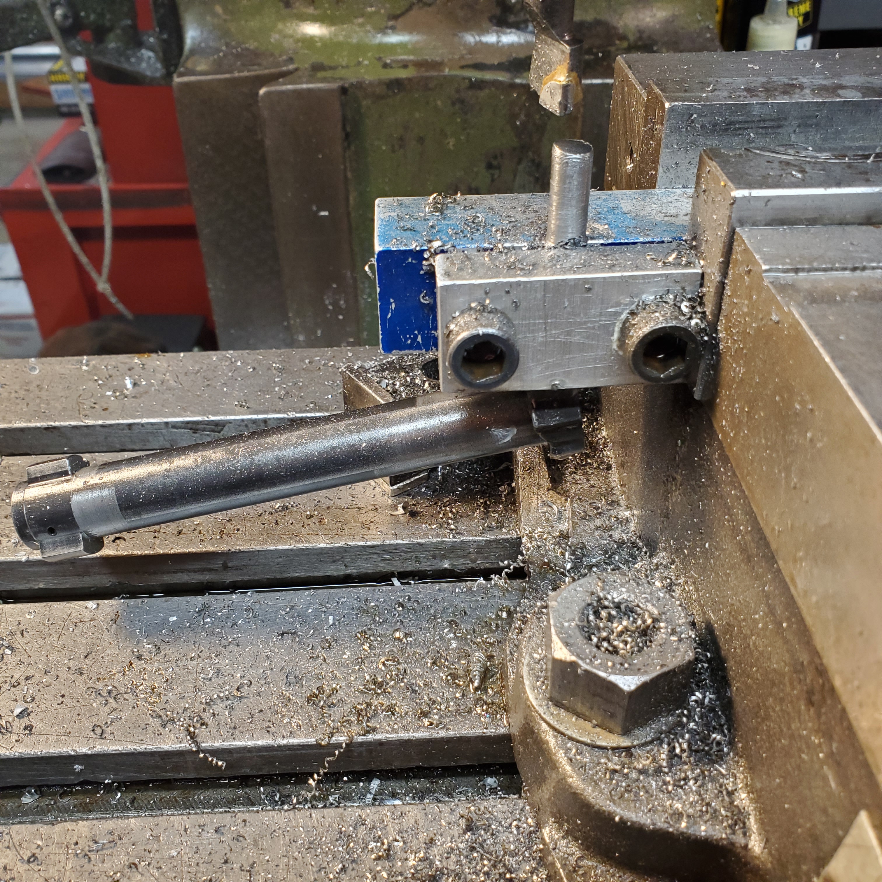

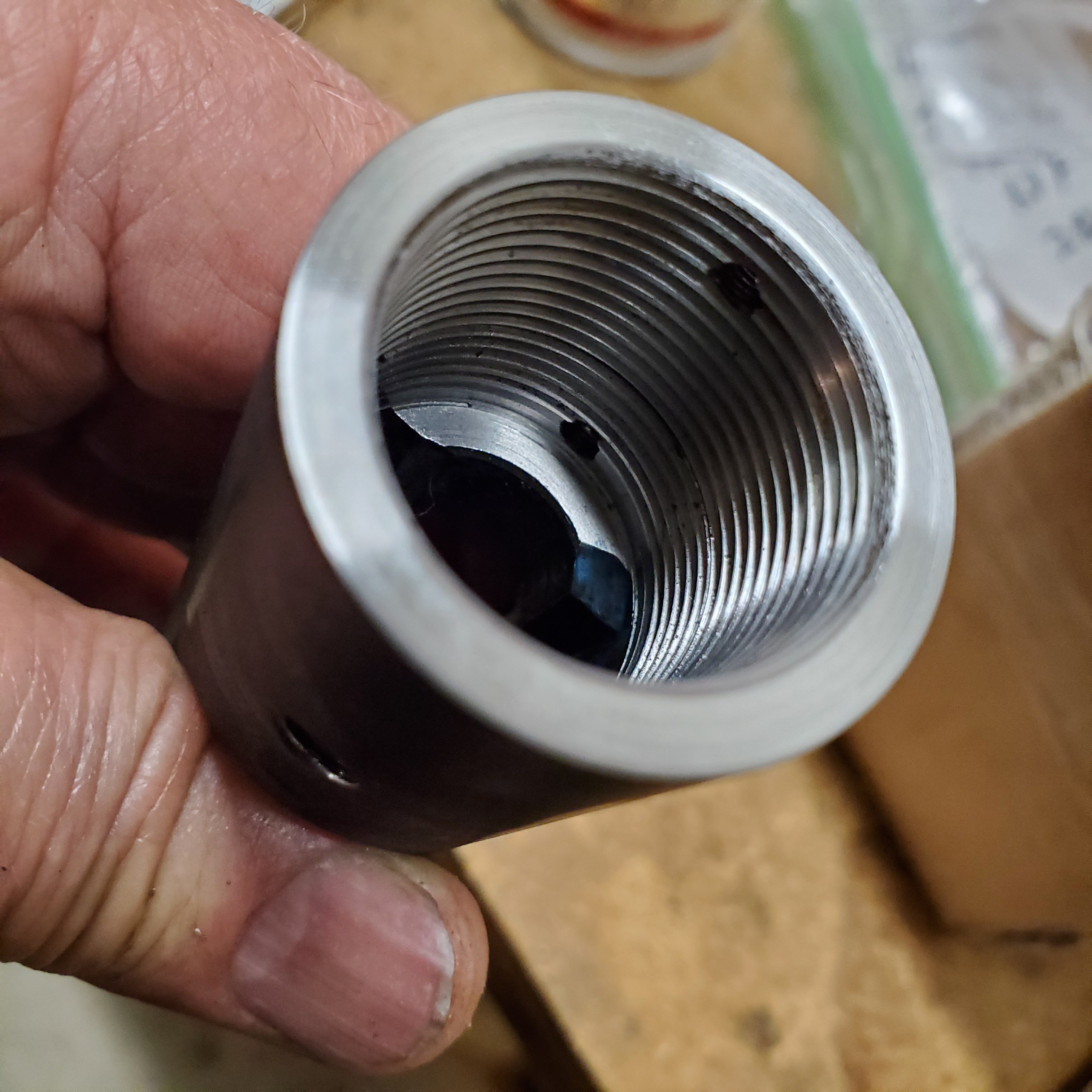

But you have to machine a barrel complete from a barrel blank. And cut the brass case heads down to 308, and cut a new extractor groove, a 450 bushmaster bolt, and alter the 450 BM mag, 450 bushmaster barrel extension.
Just like the 30 RAR I built from scratch, if ya want one gotta make it yourself.
These wild out of the box projects take time and money, from practical reloading experiments... and its all just a hobby.

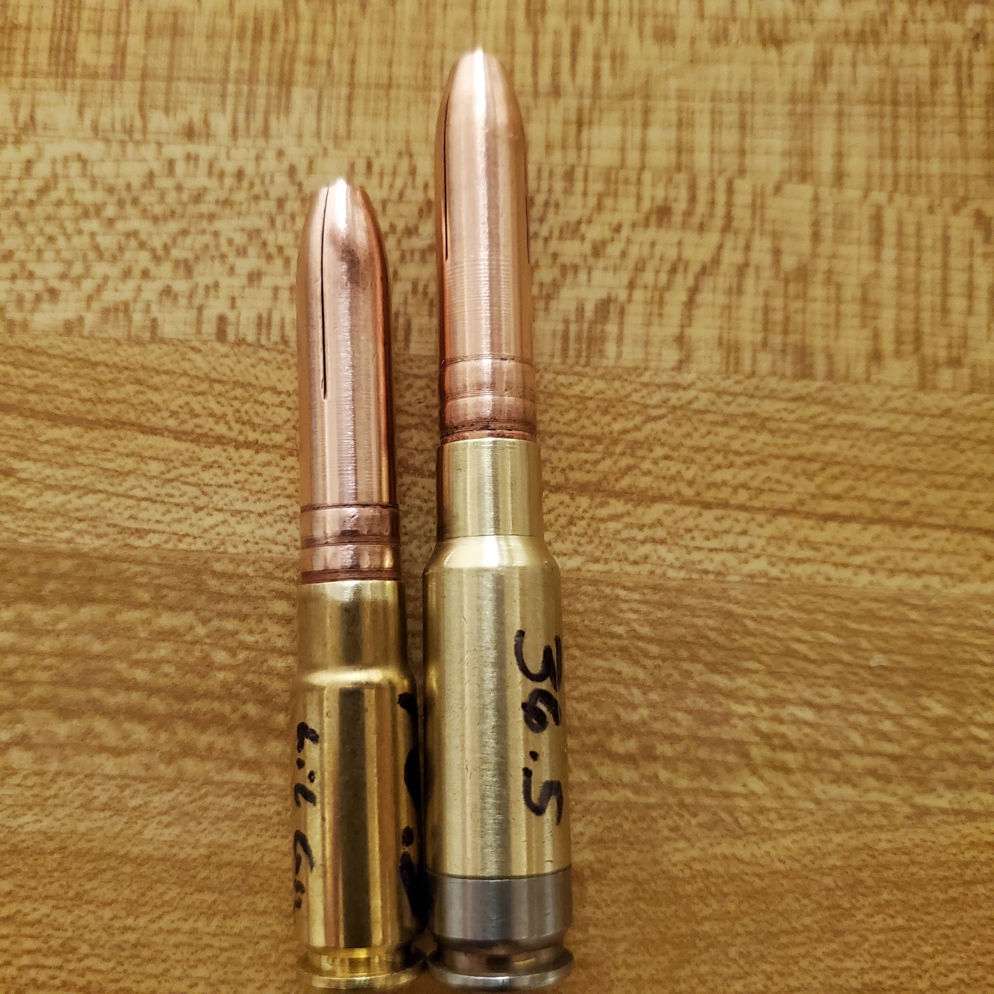

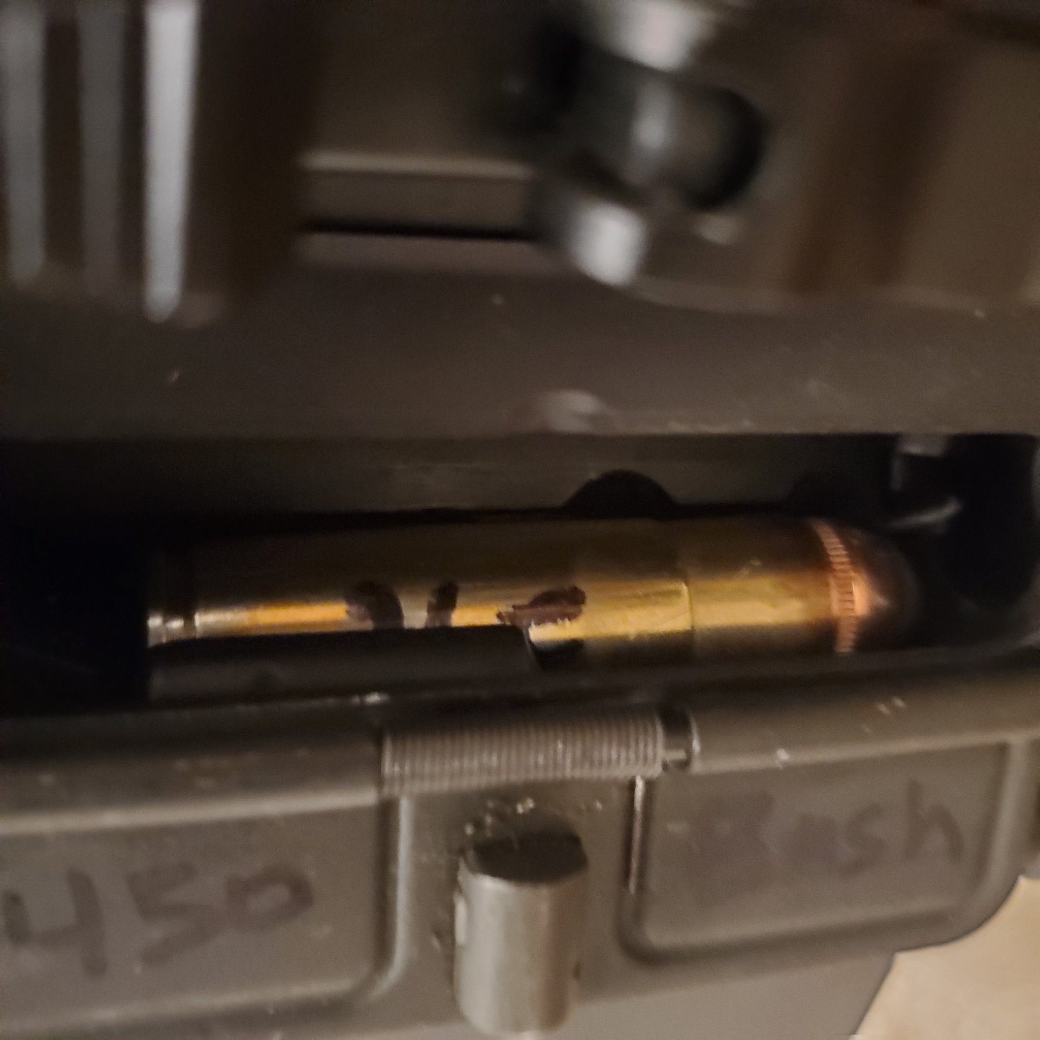

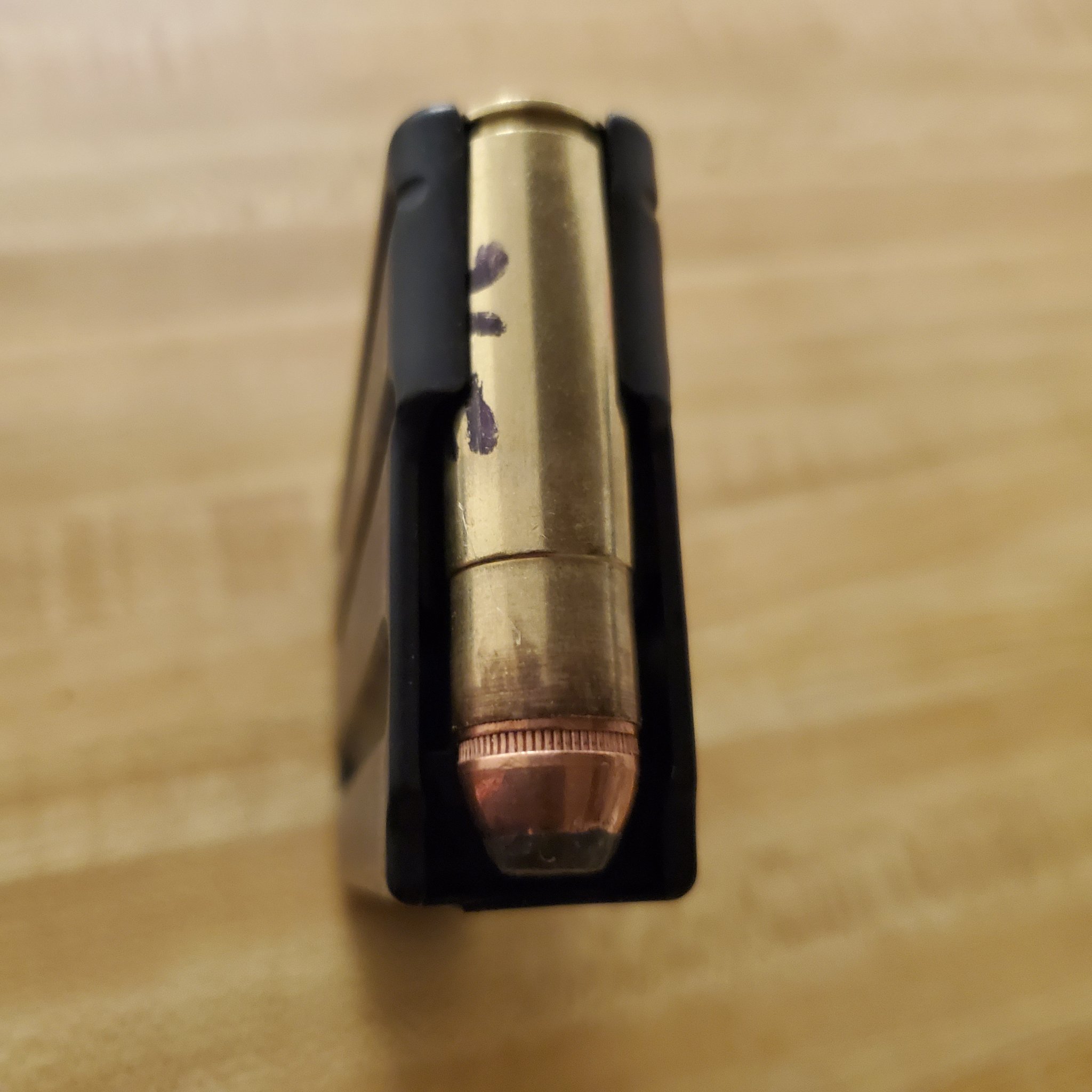

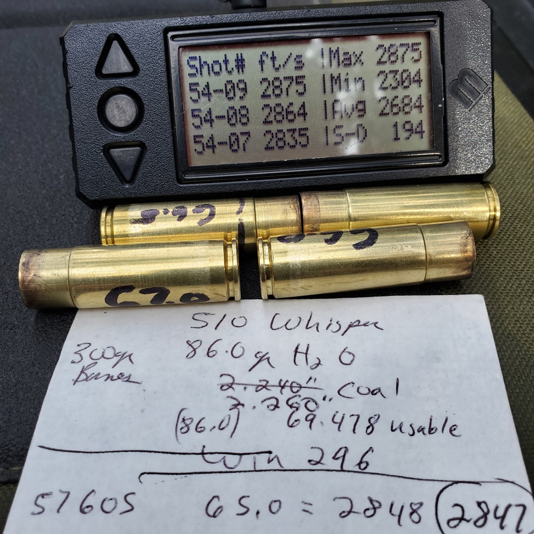

Here is the .510 Whisper cal in bushmaster mag, needs machining. And here it is in the 450 bushmaster AR 15.
Notice the back of 2nd from left has a home machined rebated head & new extractor groove to fit an AR 10...the AR 15 even more drastic.
So I've been contemplating this idea. The subs will be 560 gr homemade for this particular endevor, already machined the sub bullet, in AR 15 mag...AR 10 has more room, and more pressure available.
Tons of experiments like 350 gr Makers at 1806 fps instead of the 1000 fps limit in the 6.5 twist instead of the 3 twist, with the bore rider concept emoyed...plus the tiny 338 Spectre with a 350 gr Maker achieving 1100 fps.

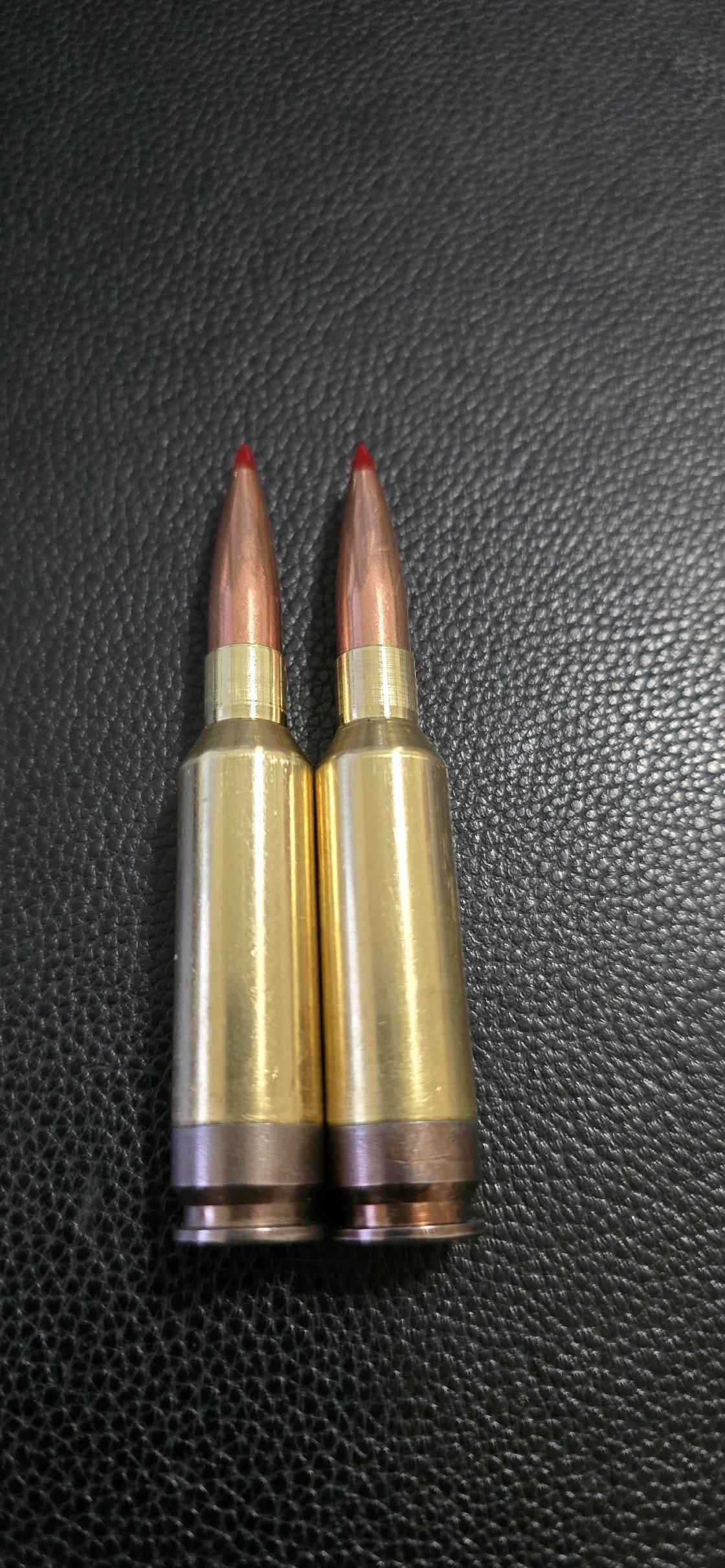

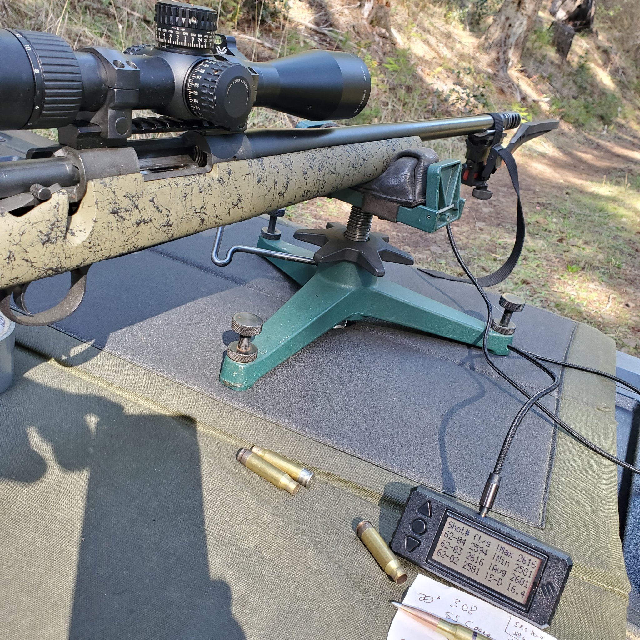

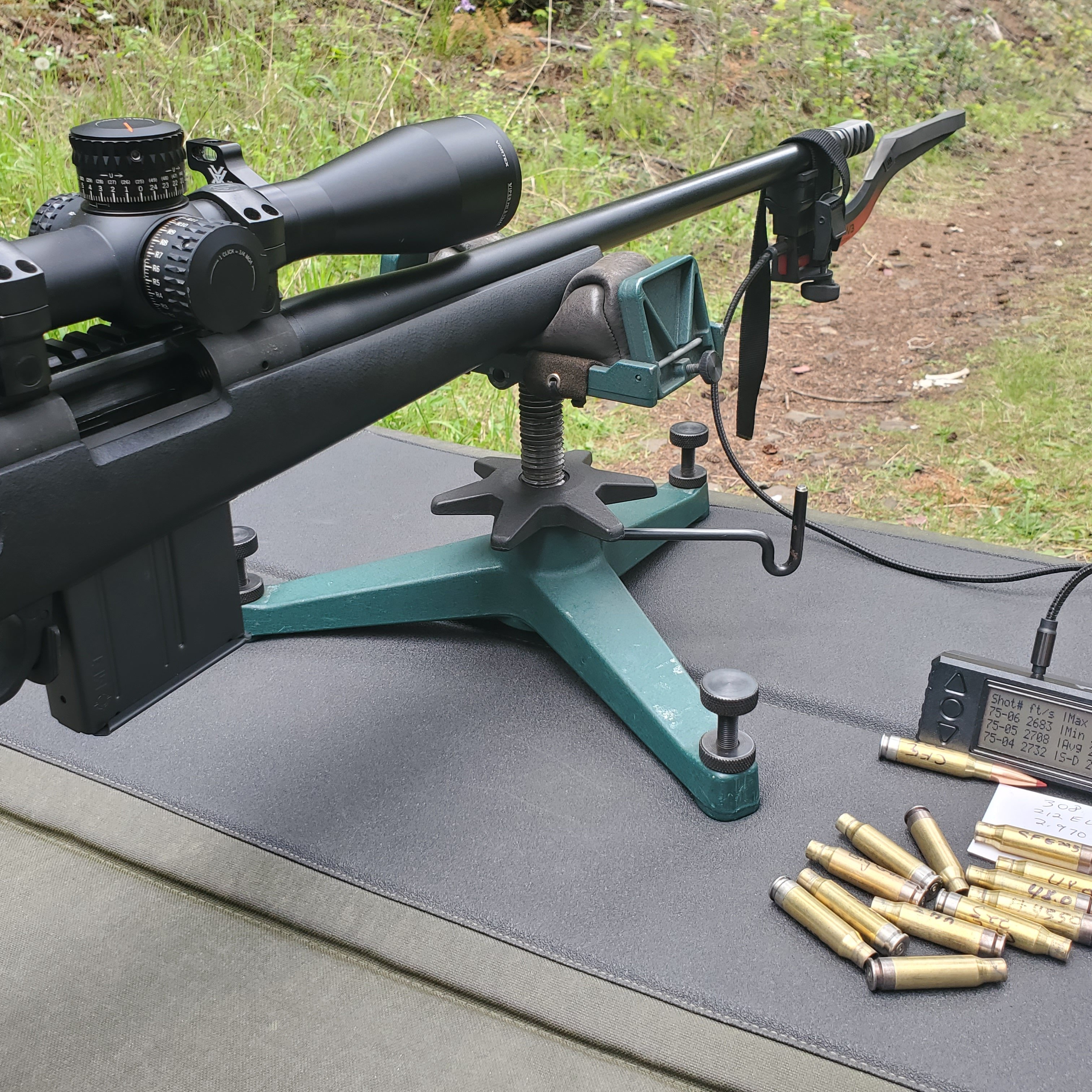

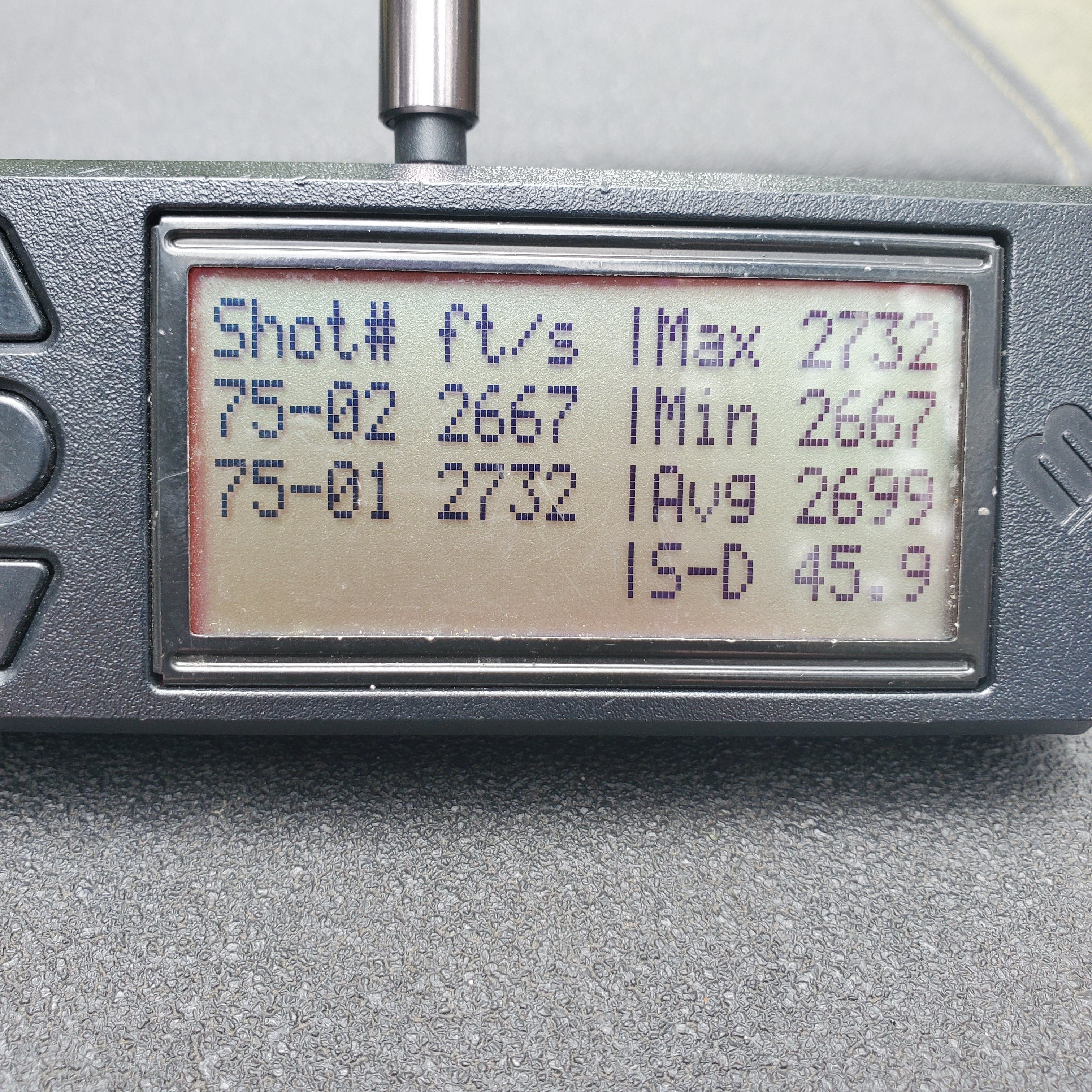

I was asked but the 175 gr SMK and 177 gr SMK so I did a test yesterday with two rifles a 22" 9 twist and a 30" 8 twist...and two powders.
I seated the 177 SMK out a bit longer and the 175 at 2.830" to fit most magazines.
The longer barrel for the 177 gr was 3126 fps with a .545 g1 BC not too bad, and 3049 fps in the 22" barrel. Over 3800 ft/ lbs of muzzle energy from the 177gr in the long barrel

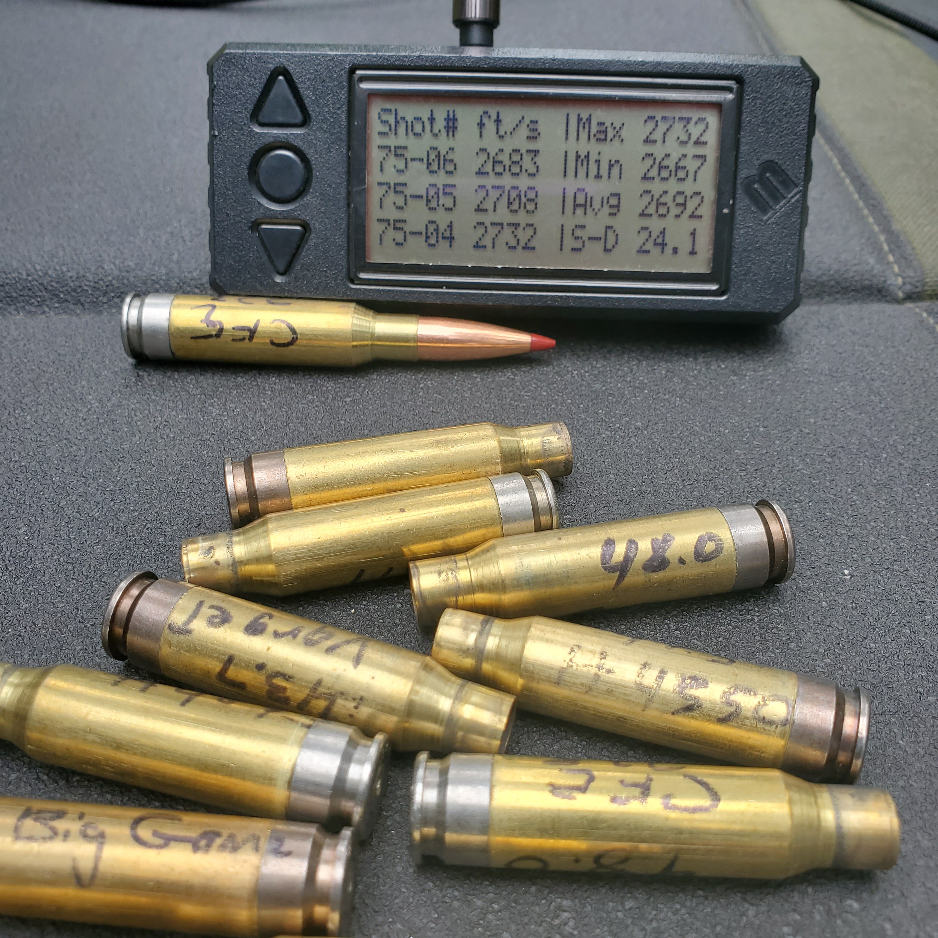

Others might be interested in the heavy bullets the 230 gr Atips and the 250 Atip.
The 230 Atip was 2708 fps on the long 8 twist and accurate, especially in the 2680 fps area.
And right at 2601 average for the 22" 9 twist.
The 250 gr Atip was 2515 fps for this test.
Without changing the seating with a throating reamer to around 3.4" as this is a long action max effort 308, 2600 fps could be possible...but that would require shorter bullets to jump alot. But with a 250 gr bullet the 308 runs out of powder capacity.
Plus the 230 gr Atip at 2708 fps area is no slouch.
Also ran the Barnes copper tipped 110 gr bullets to 3530 fps, but thought it was quite a bit slower than predicted...almost no recoil was noticed. In the 8 twist it was accurate and over 316,000 rpm.
The 230 Atip at 2700 fps on the long action 308 will be supersonic to 1900 yds...at 1500 ft and 70°....alot farther as altitude increases...here you can go from 200 ft to 10,000 ft elevation in 60 miles.
Not interested in that one can still make a short barrel faster than normal with hybrid cases in a bolt gun.

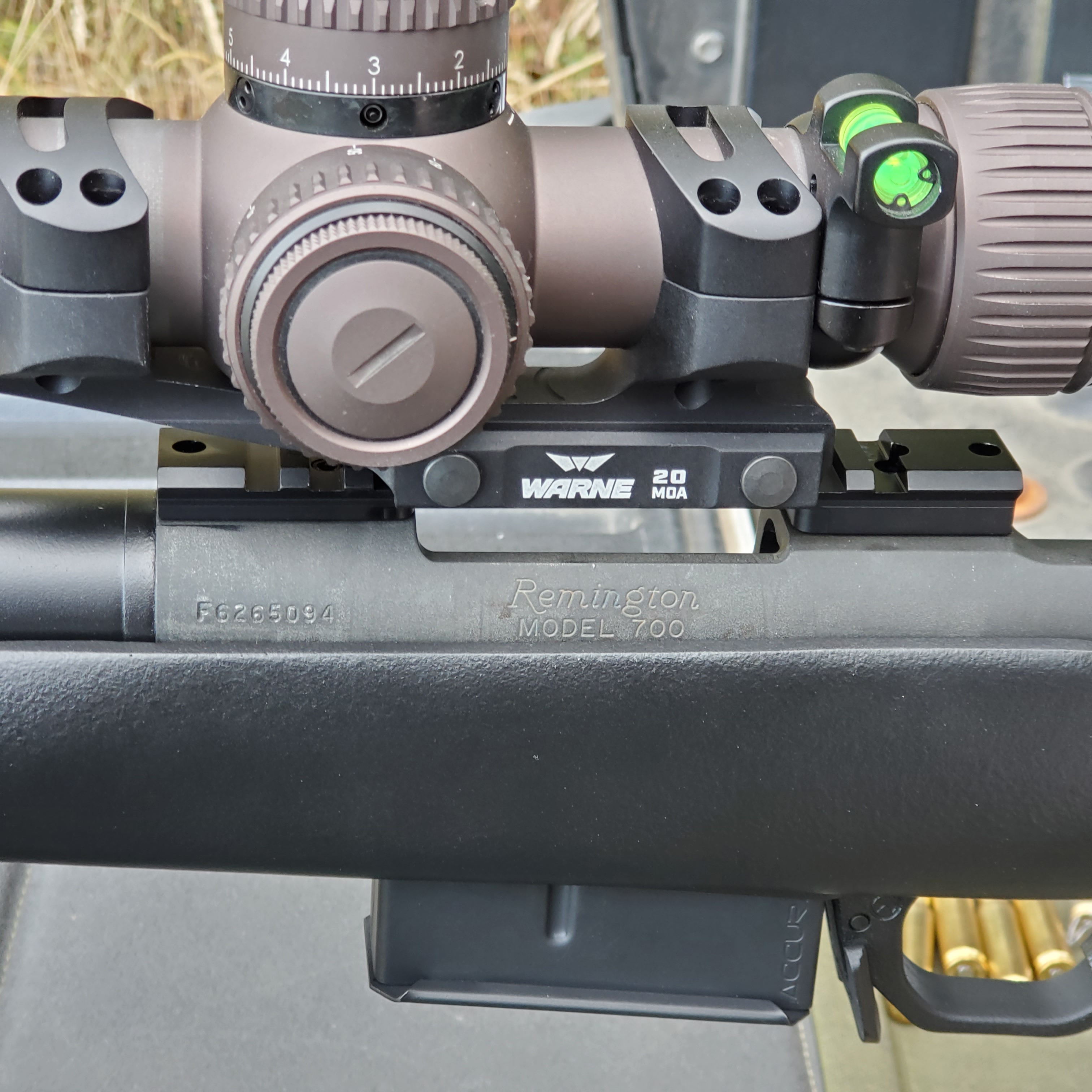

A picture of a standard Rem 700 with a Bartlein 9 twist running 230 Atips to 2601 fps. Single load ...but just buy a used 30-06 action, add an 8 or 9 twist Bartlein and an aluminum chassis with 3.4" mags and have a 308 monster.
My Bartlein 8 twist is more accurate than the 9 twist with most bullets from 130 gr to 250 gr, but it liked the longer copper Barnes 110 gr tipped bullets...but that could be it's a much higher dollar rifle and scope with a much more adjustable aluminum chassis.

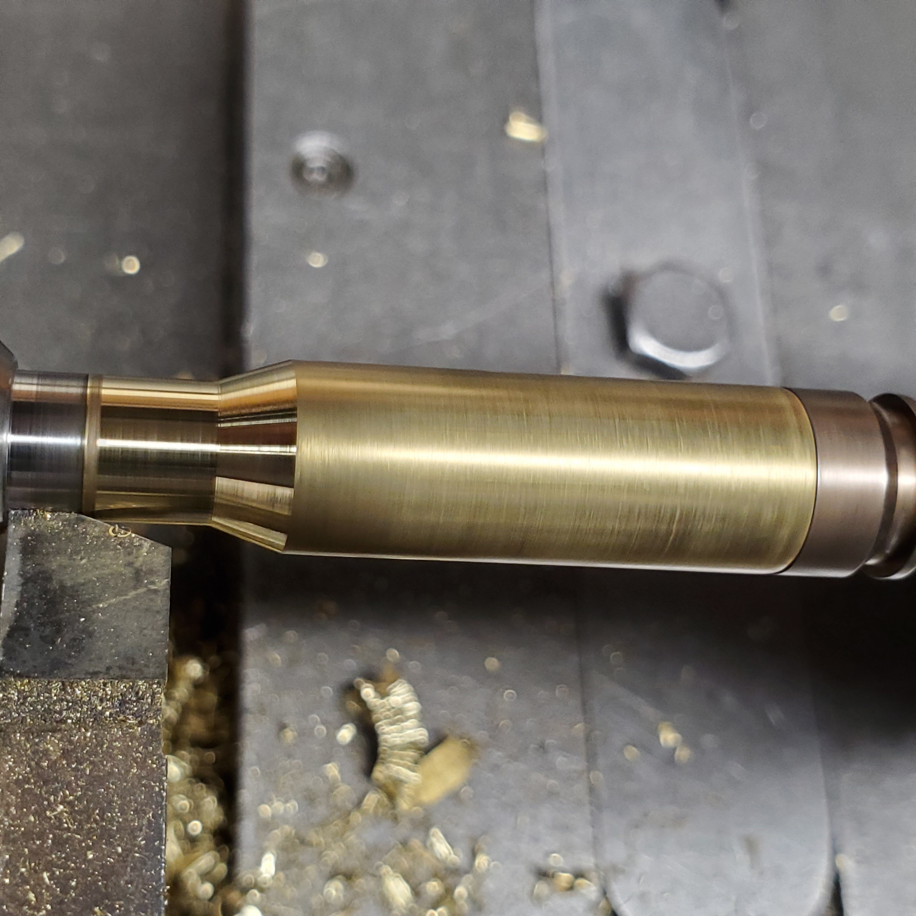

I do not do round count on my rifles ...anymore. Quit doing that around 22 yrs ago.
When I was doing round counts, on LR shooting with the 308 I ran them 8000 rds and kept good track, then do a barrel change. One Rem 700 action has over 20,000 heavy match rounds on it.
On the hybrid cases I checked for lug set back on several rifles and there was none.
The barrel wear will likely be accelerated, but I haven't checked lately. When accurate falls off, I start looking.
I've reloaded some of the hybrid cases 5 times no change in primer pockets.
The ones yesterday were newly formed cases.
I am in a unique position as I do all the gunsmithing to these rifles and have my own reamers snd gauges.
So a barrel change is just a online trip to Bugholes or SPR for a new usually Bartlein 5 R barrel these days. Its only $420 but the price is going up to change out barrels...about the price of am 8 lb jug of powder, no big deal... so my concern about barrel life isn't like most, so I stopped round count many years ago.
I run all kinds of brass through the 308 these LC primed and ready to load thousand rounds have already been fired,

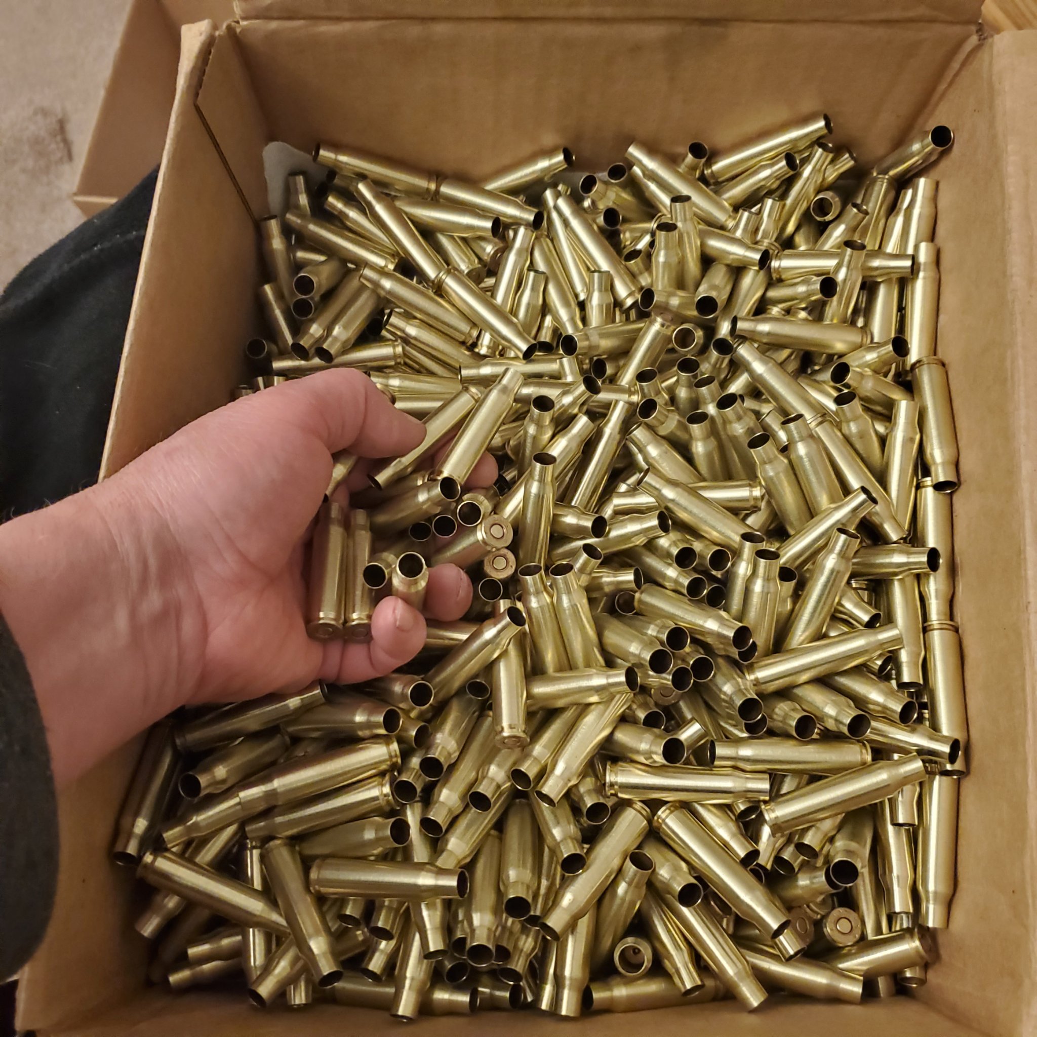

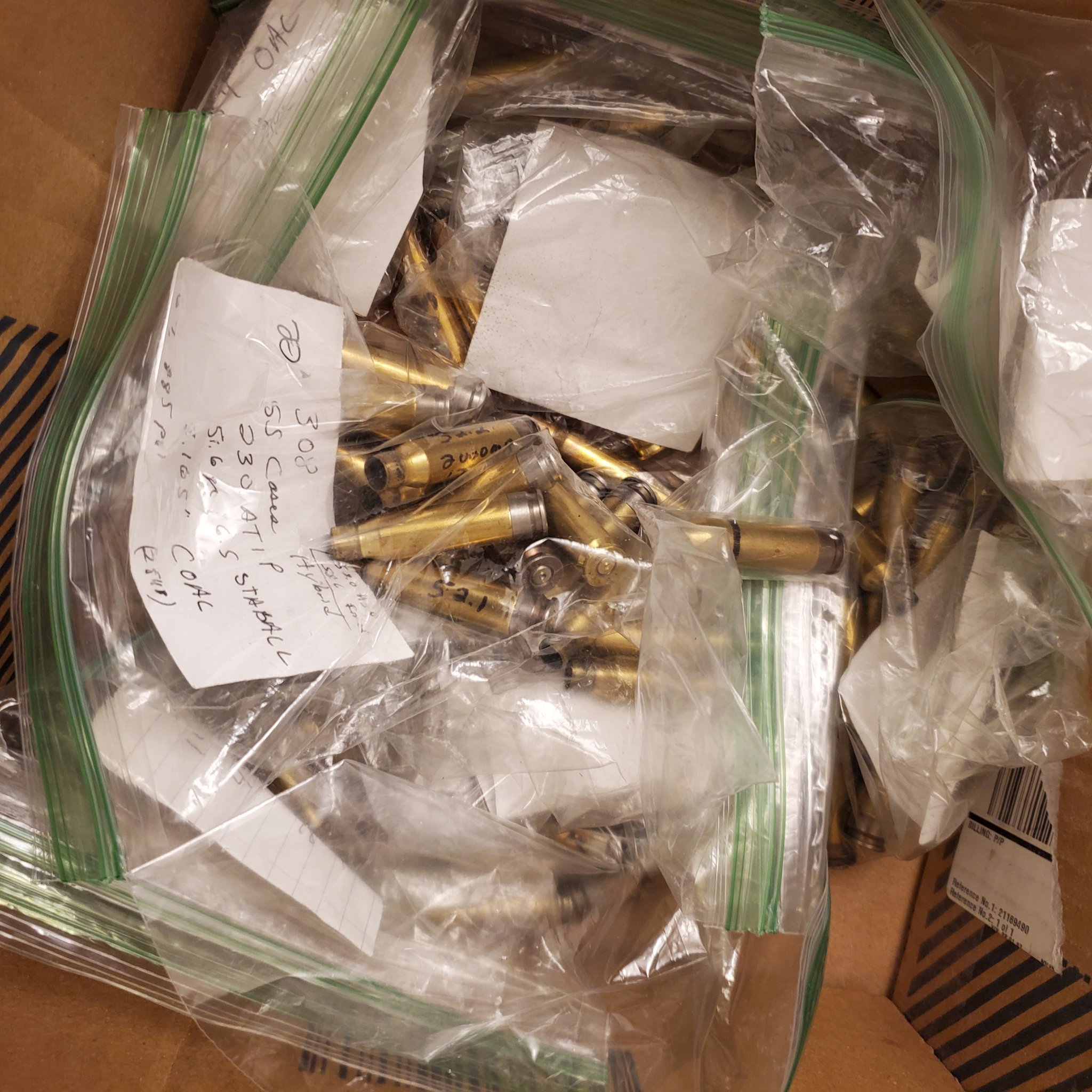

These are the newly formed hybrid cases, fired for the above testing about 100 cases.
I have around 1500 hybrid cases.

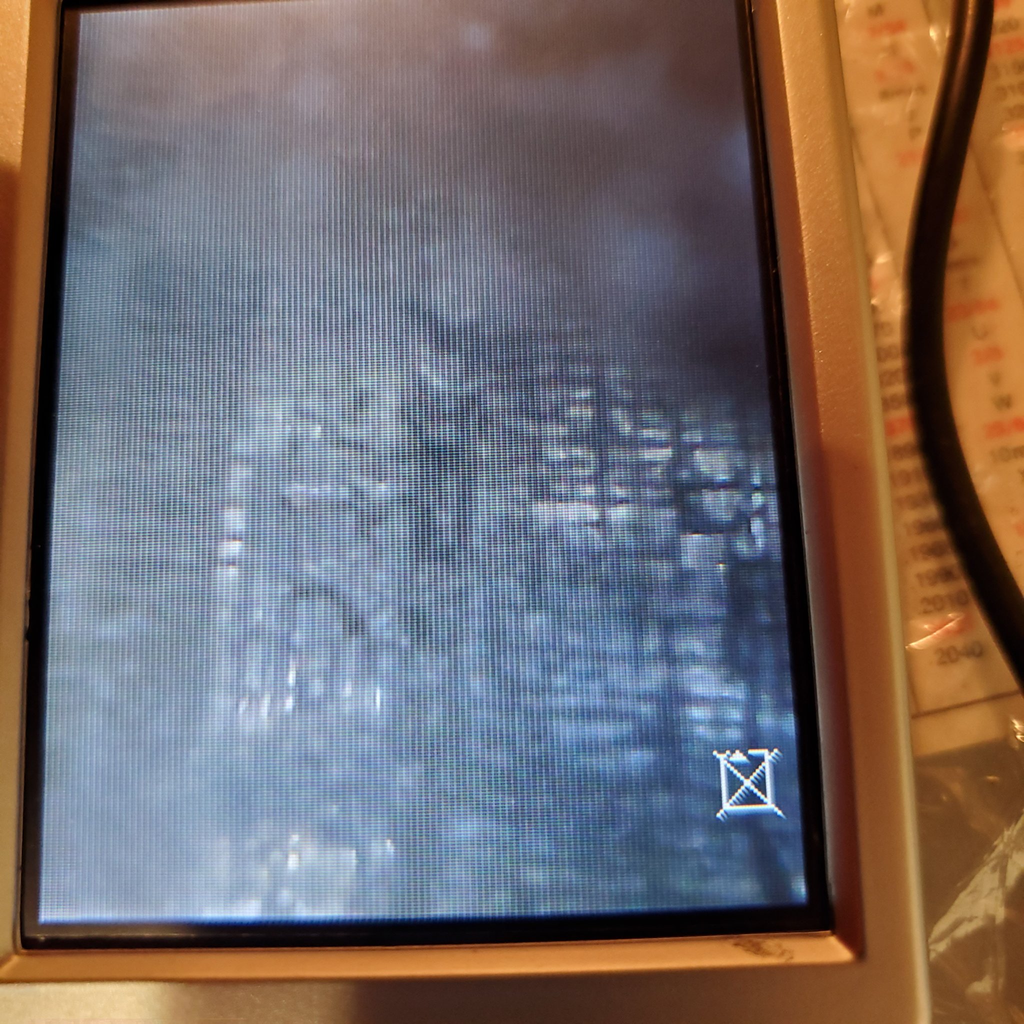

What a 308 barrel looks like after 8000 rds, in the throat area and down the barrel a ways ...still shot pretty good.
So I cut out most of the bad area and made an AR 15 barrel out of the 308 bolt barrel, it's now a 30 RAR.
The information on hybrid cases is there for those who want to try it..carefully, and work up. You do not have to go full throttle to have an advantage and sometimes ya just want plinking ammo, and LC brass is fine ...or even subsonic loads, and hybrid cases are not used.

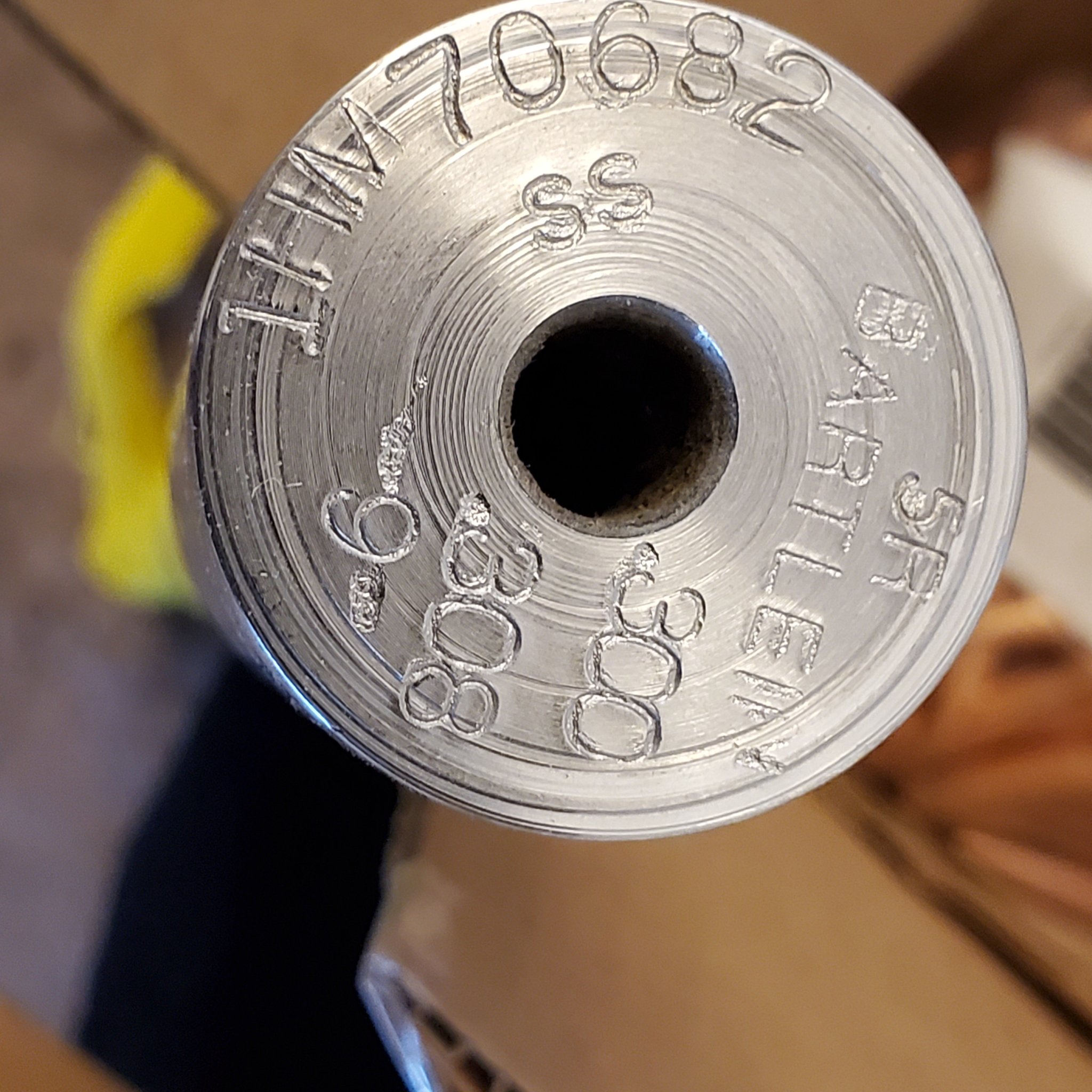

I like the 9 & 8 twist 308 barrels for the heavy bullets.

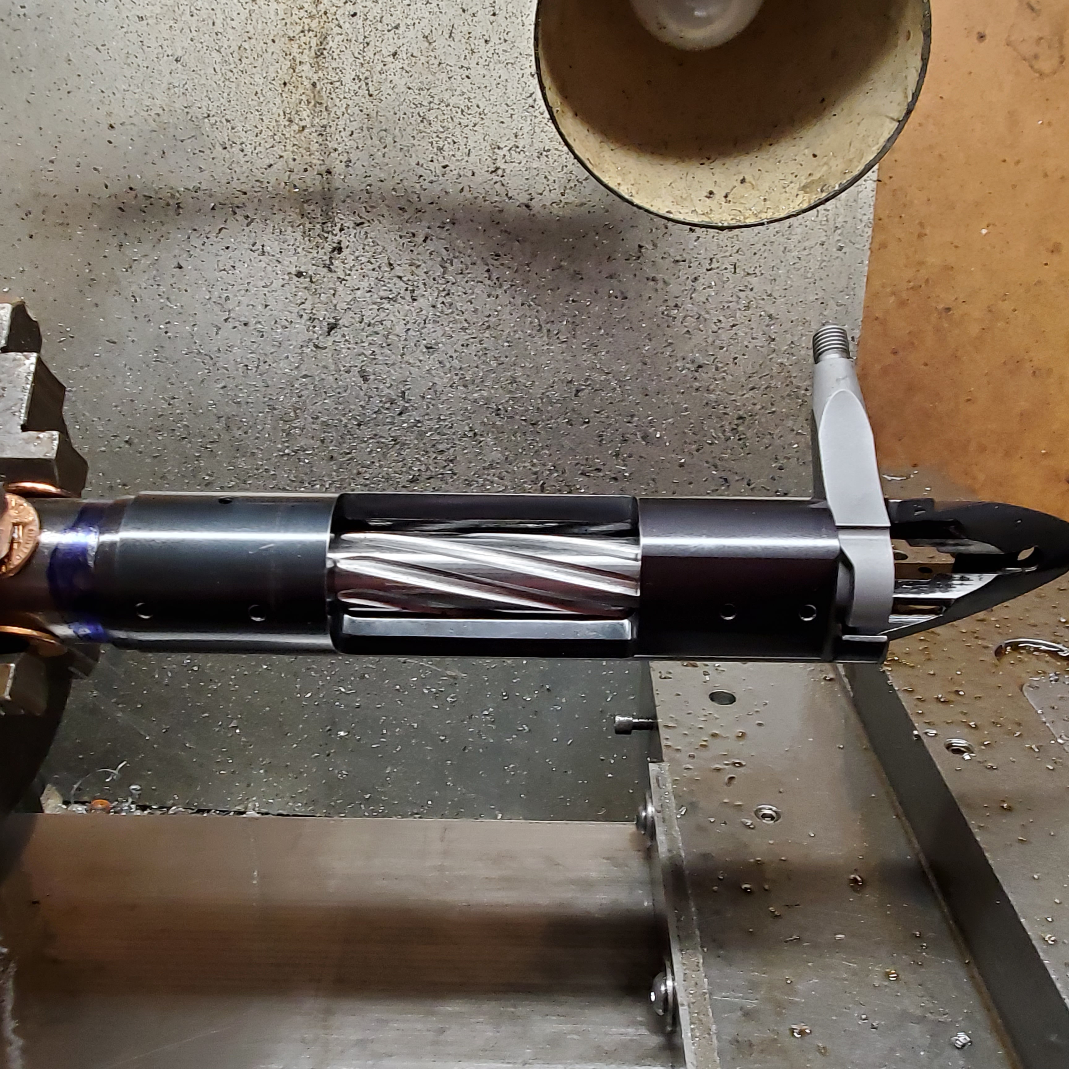

Some background I am a retired machinist with machine tools. So I do all my own rifle building along with what some would term outrageous projects.
So I do not spend all my time on hybrid cases but employ them in any caliber I want to improve velocity ...bolt actions only.
The rifles all have "trued: actions, to distribute the pressure forces equally on the locking lugs.
It only takes me a day to build a rifle.
Example Ordered a Bartlein barrel from SPR it arrived in 7 days at noon.
I unpacked the barrel, trued the action, took measurements, chambered and threaded for a muzzle break, threaded the bolt handle, installed the m16 extractor, made a bolt knob, reloaded for it and the next day was shooting my new 6 Dasher.

This is the one day rifle build, plus reloading the ammo to shoot the next dqy.

308 Lapua brass, 6.8x51 Hyrbid, necked and sized, and 6.8x51 out of the box. Have 25 prepped, just going to fireform this weekend with normal 308 loads. Would eventually like to see how well they do with some of the heavies. I have 200.2, 208ELDMs 215s Bergers and 225ELDM. I think the last 3 would not be able to stabilize out of the AI barrel.
Reactions: 45-90 and BJames
Now to the more important subject, hybrid cases in the caliber of your choice...here the 308 Win.
I've been ordering them from American Reloading...a super sale just a few days ago a bunch came in...45 cents ea including shipping and a primer.
Never had them that cheap...but the latest military pull downs have some ball powder in them I use an air compressor nozzle to blast out the powder left in tbe sides of the case.
Deprime the live primer and re use later.
Mandrel up the 277 caliber with a 308 Wilson mandrel die. Use Lee Resizing lube.
Lube with Lee Resizing lube and run through a 308 FL sizing die...a Lee die is fine for forming incase ya don't lube it enough, the average guy will have a serious problem.
Always lube your cases well, and keep the lube off the shoulder area.
I skim neck turn into the case shoulder with a sharper radius to help with donuts.
You do not want pinch points at high pressures.
You can anneal here and spray lube and run through the FL die of your choice, checking with a cartridge gauge that you are settling the shoulder back enough, .001" or. 002" to your desire, so the case chambers easy.
I neck turn in a lathe, cause I have one.
Plus a diamond grinder to get the full 20°
Angel and sharp radius.
But this can be accomplished with simple neck turning tools.
I think this step should be done on all hybrid cases regardless of caliber.
The Wilson die with bump ups to make larger calibers like 338 in one pass.

So here is the important part that everyone wants to know...the load data used.
Here is the load data for the 308 Win Standard SAAMI chamber, my reamer, in a trued 700 action with a 9 twist 5 R Bartlein barrel 22" long.
The 208 gr hybrid in hybrid cases for this rifle is a good load, accurate and low SDs plus a better BC than the 215 gr Berger.
But sometimes I shoot these hybrid loads in the 8 twist long action, (because these are single load here), and get a much different accuracy event.
Or run them out of the MDT center feed without the center support for almost 3" in the rifle shown I believe it's 2.990" or 2.980" will get ya off the ogive. ... it's the same barreled action buy different stock, as I wanted to try the other stock used in this test.
But if you shorten the COAL be sure to drop the power charge about 1.5 grains...or more and work up.
So nothing is predictable here. Sometimes it's what is expected... sometimes not.

The 22" barrel 9 twist Bartlein 5 R does 3049 fps with 177 gr SMK. The 175 SMK was 10 fps slower on average.

Fireformed 25 cases. These were just normal loads, 44gr Varget 178ELDMs. Compared the same load with Lapua brass. Shot about the same size group, but was 25FPS slower. Did check case volume when I got home, 56.8gr vs 57.1gr of water. Didn't have any kinds of issues in the first 5 rounds and started to shoot 500-850 yards at steel to fireform the cases. Next week, I will start to ramp things up with different powders.
Yes hybrid cases have a little more case volume.
So when the exact same powder charge is used in both the pressure and velocity will be slightly lower for the hybrid case.
Messing with hybrid cases and the 6 Dasher.
It's successful, but a bit more involved.
107 SMK 3200 fps? Maybe 3300?
Is it worth it?
Probably not...
Not something you'd shoot a lot of rounds in a day.
Also doing laundry, besides messing with this Dasher project...and we all know how exciting that cam be...
