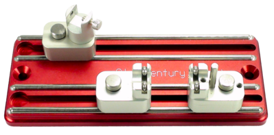

One of the members here has very kindly and graciously given me a 21st concentricity gauge like this one. I want to spend what little money I have on the dial indicator as I believe that will net the best results. I would love to have the wheel for this system but at $65 plus $15 shipping from 21st Century.....$80 for a wheel is a bit too much for my pocketbook right now.
What methods do you guys use to roll the brass without introducing errors?
Does anyone have a DIY build for a wheel or similar?
I would get a little piece of wood, 6” long and maybe half an inche wide, stretch a rubber band around it long ways and you now have a messed up violin bow... or a lovely little wand to roll the cases with in one smooth board instead of your lumpy fingers.
