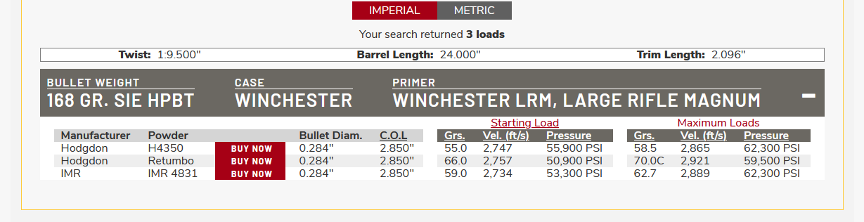

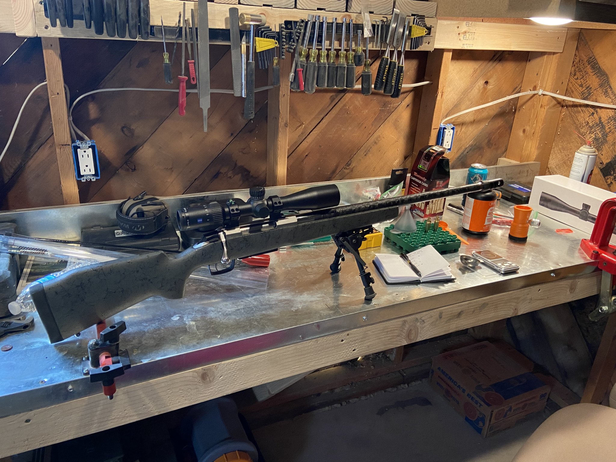

I could use some info please. I’ve got a tikka with a 22” carbonsix prefit. Running a short barrel wsm cuz i got a good deal. I’ve got retumbo, imr4831, h4350. Shooting 168 Berger vld hunting. Does anybody have experience with any of these powders and where I should save my time with load development...just shot up to 54gr IMR 4831 with no pressure signs. Velocity was 2625 FPS. Seating Berger’s touching lands to help relieve the large amount of brass stretch of hornady brass.
Sounds like at or just above 7-08 speed.
Hogdon manual shows 2921fps with 168 Sierras and Retumbo out of a 24” tube, so I’d look for 2850 or so over the chrony.
