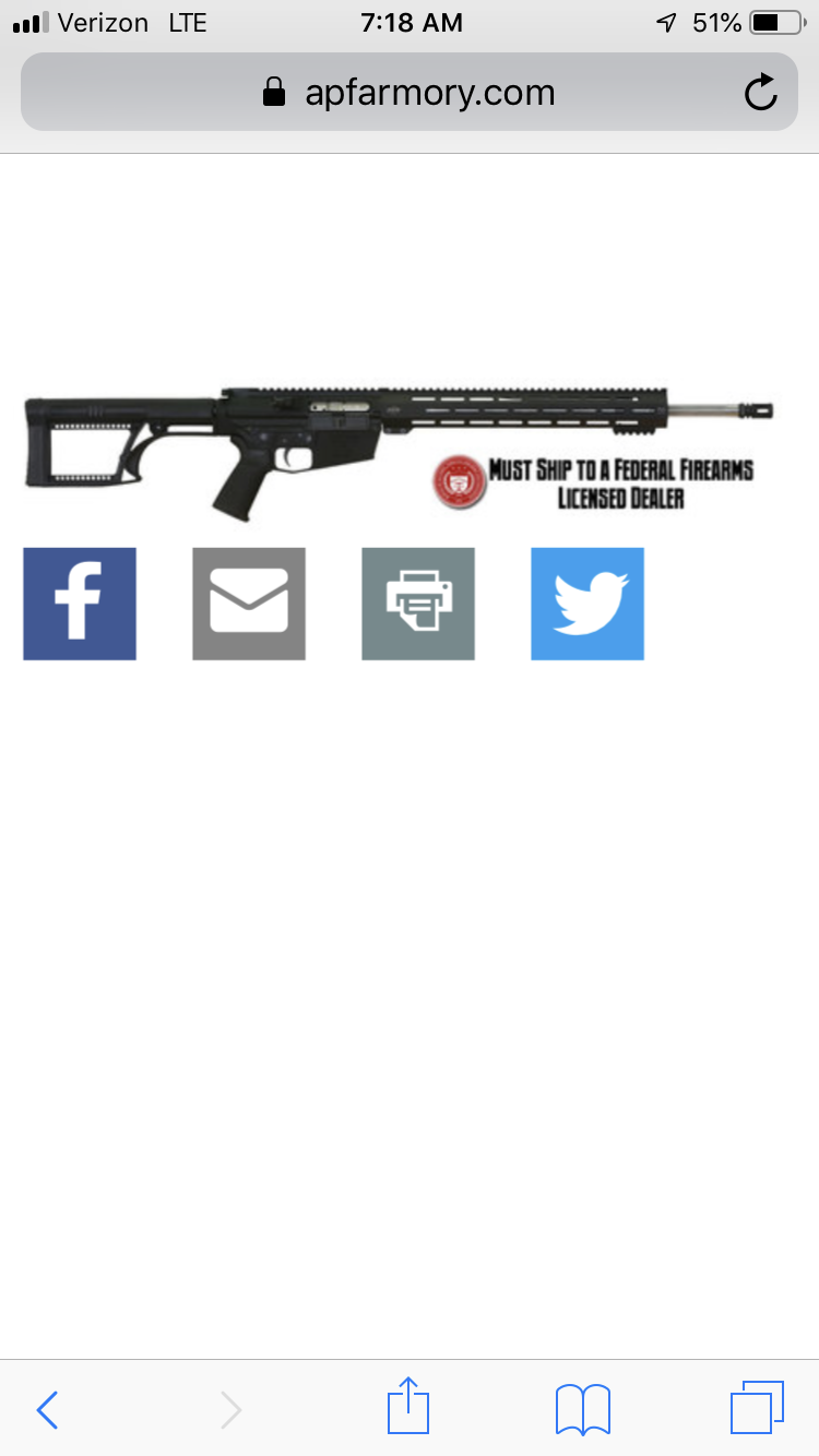

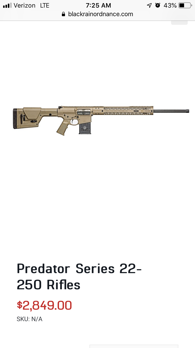

I am looking to build another upper for my AR-10 and want it in .22-250 if possible for varmint and hog hunting. Does anyone know of a company that makes barrels and/or uppers for a build like this? I want a 20-22" stainless steel barrel with adjustable gas block and lightweight mlok freefloat handguard.
