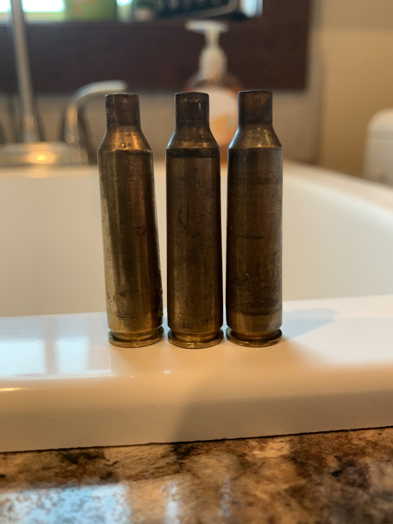

I just finished my first AR build in 22-250rem. 1-7.7” 24” barrel, rifle length gas system, rifle length buffer, rubber city titanium bcg, and adjustable gas block (clamp on). My issue is that I can’t get the rifle to cycle and lock the bolt correctly unless I’m shooting 80-90gr bullets. My goal is to shoot the heavies but I feel like I should be able to run 55-77gr bullets as well. I’ve checked alignment on my gas block several times and made sure it was set to allow as much gas as possible but that doesn’t seem to improve Its operation. Also, I’m getting inconsistent gas signs on my brass from neck to the base of the base as though it’s not sealing in the chamber well(See picture)? Any advice would be appreciated.

- I then loaded up 50 90gr SMK over 33gr (.5gr over original test) H4350 and it cycled correctly and grouped well. With this load I had enough gas that I had to start turning down my gas block. This is when I started getting odd gas signs on my spent brass. Maybe my bolt is unlocking to soon because I pulled that weight from my buffer? Dirty chamber so the case won’t seal in the chamber?
