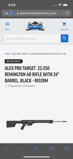

I don’t know anything about the builder, but this came up on a really quick google search…
I acctually looked on thread site and somehow missed this.
Out of stock, and I don’t know when or if they will come back in stock. As mentioned, the 22 cm is the better mouse trap for a large frame ar. And, there should be match quality factory ammo available (along with real match barrels) so no real need to hand load...
