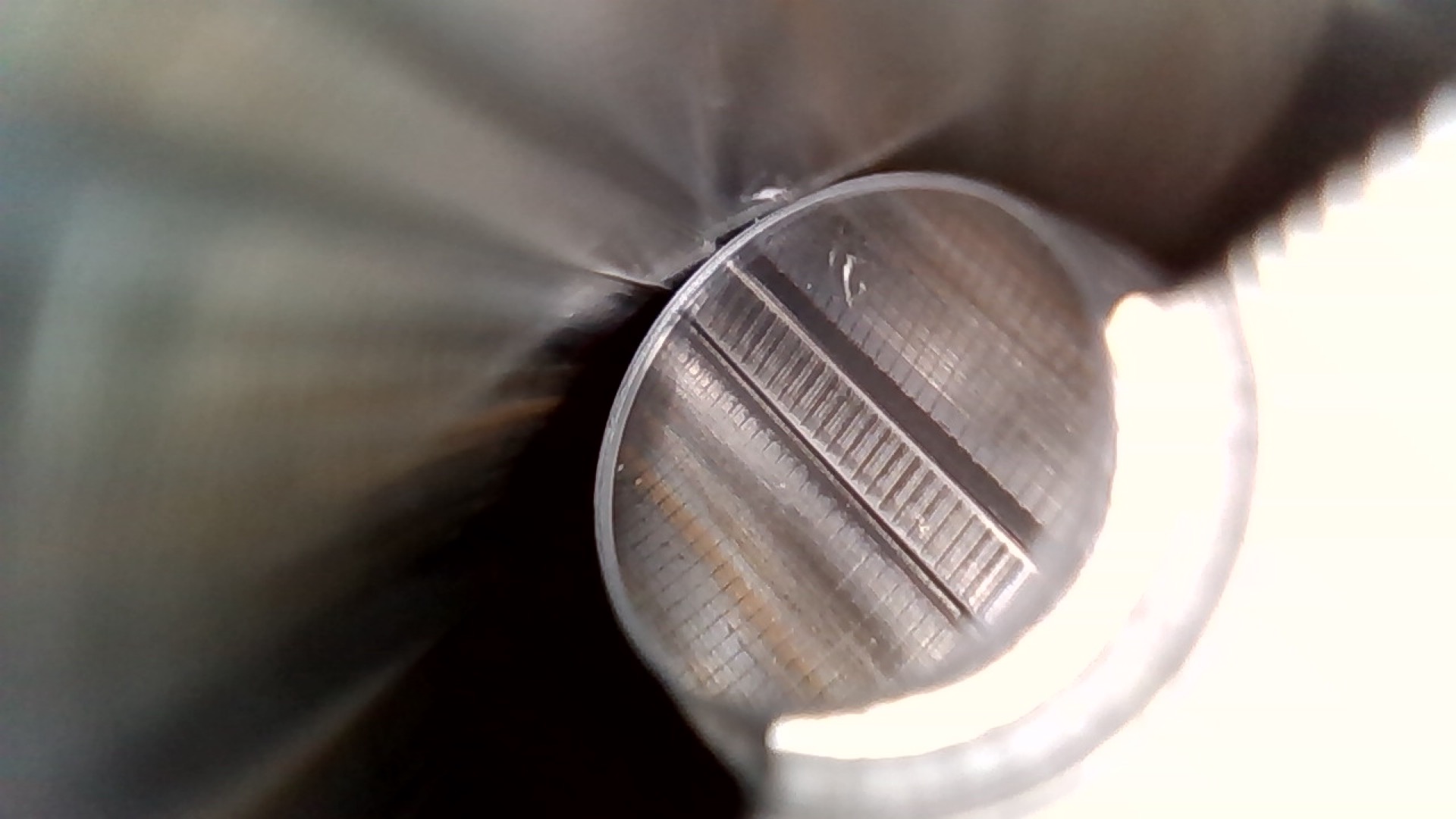

    After firing approximately hundred plus rounds after a couple days to the range
    From 55 bks’s and 55 Vmax
    Big game and h380 powders
    H380 and 38.6 gra. 3669fps av.
    Big game 38.6-3670fps +averagw… chronograph didn’t pick it up yesterday

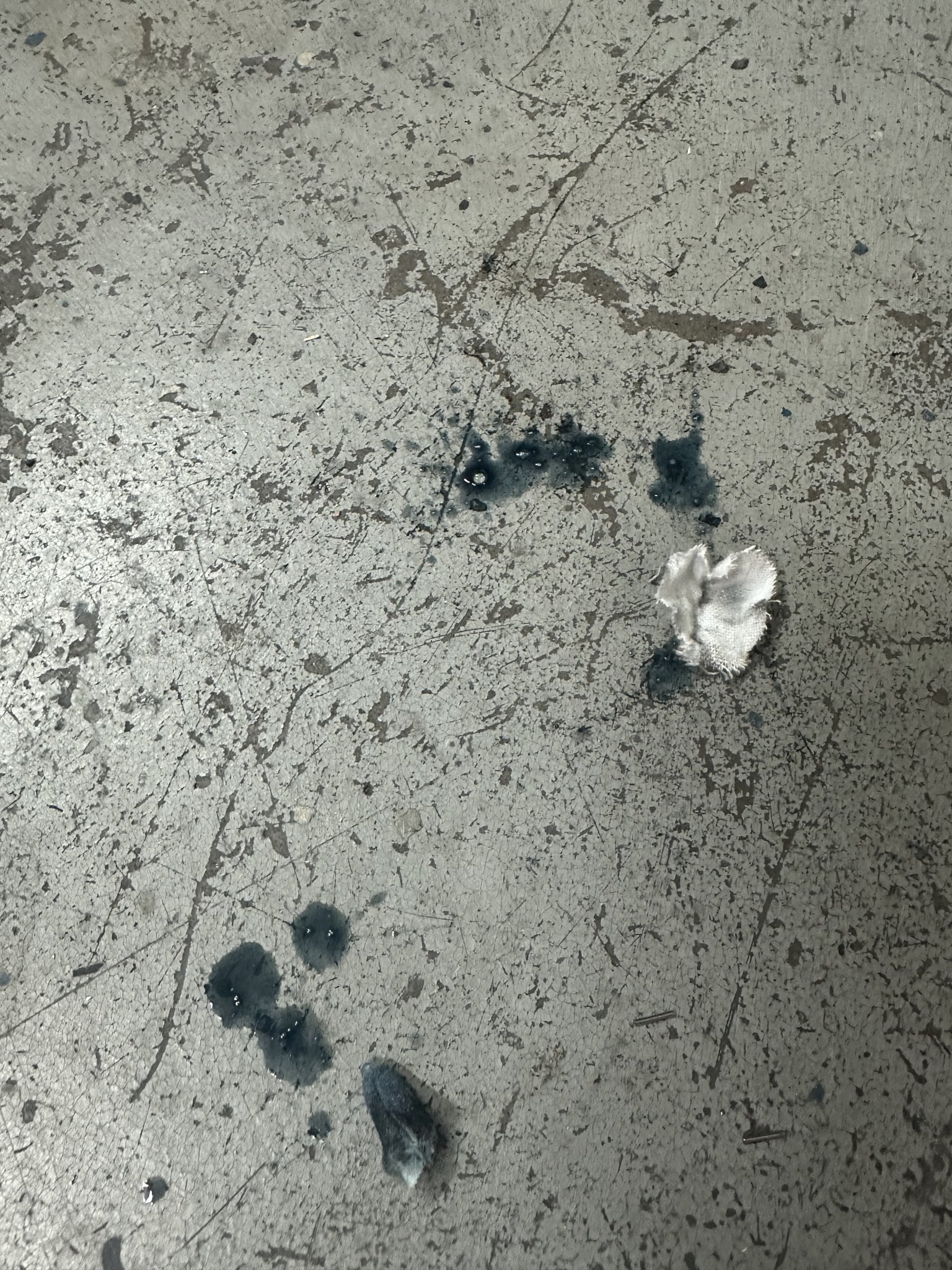

    absolute blue burp of nastiness came out of the end of the barrel ( bore cleaner )
    after seeing massive copper fowling especially towards the end of the last 7 inches of bore.
    When viewed with a barrel/bore cam
    Saw some fire cracking, which is to be seen, but nothing that’s massive, would not think to cause bullet deformation.
    I’ll have to measure, but I think it shoots half three-quarter moa.
    I’ll try slowing it down and see if that makes a difference it’s a 1/ 12 twist.
    The big game powder definitely smashes the primer a little bit, but the Hodgeson h380 seems to be a more comfortable pressure..
    I’ll slow them both down no need to run it that fast… 24 inch bull barrel
    Bad barrel or running them too fast??
    I’m guessing has about 300 rounds maybe 400 tops
    Perhaps these are just savage barrels and that’s what they do?
    The rifling has got the KILLDOZZER tracks down the entire barrel just like rock Creek barrels … so nothing to worry about there
    I didn’t see anything that was glaringly awful about the rifling… I will have to look again after it’s clean
    This is not the first time the barrel has done this. I just figured it was due to high round count and not getting the barrel sparkly clean.
    and that I was finally using the right bore cleaner.?
    But the barrel was sparkly clean prior to these hundred plus rounds.
    i’ve never seen this much coppering in any of the barrels I own.
    This purchase was quite a few years ago at Cabela’s it was the savage 110 with Accu trigger and the really cheap stock…
    The other one came with a 6.5 Creedmoor I shot about 100 through it… stuck a different tube on the action so I don’t remember exactly how it shot. I don’t remember it shooting teeny tiny groups.
    However, I never remember seeing any sort of coppering like this

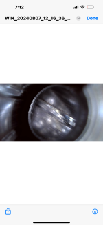

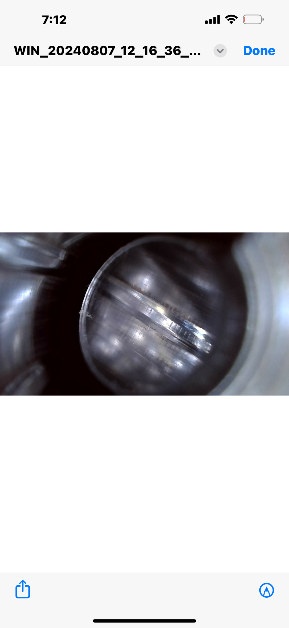

    Looks just like my Savage 308Hog. Is yours short chambered too? Mine is a tad short.

    The difference I’ve seen in this barrel versus a rock Creek was a rock creek look really good. The lands are nice and crisp no chatter or odd marks …much better barrel than the savage barrels as far as visually no chatter or odd marks down the bore.
    some say they got a barrel that looks like absolute hell and shoots really well, but I don’t think if a barrel looks like hell is ever going to shoot tiny little groups
    It’s not real hard to find any number of folks that will tell you that one thing you never do is look at a Savage barrel with a bore scope and just pay attention to what happens down range. They are famous (infamous?) for having barrels that look like corrugated drain pipes inside but that shoot lights out. One of the true incongruities in rifle shooting!
    Reactions: Kocher
    Savage bores can be pretty rough looking, foul more than a finish lapped custom barrel and still be pretty accurate. On the other hand I would expect most 22-250s to foul with 100 rounds and no cleaning.
    It will likely take a few hundred rounds to smooth out the bore or you can load up some 80 grain bullets treated with Tubbs Final Finish or similar treated bullets to fire polish the bore a bit. Don't expect to hit anything with those loads though, won't come close to stabilizing.

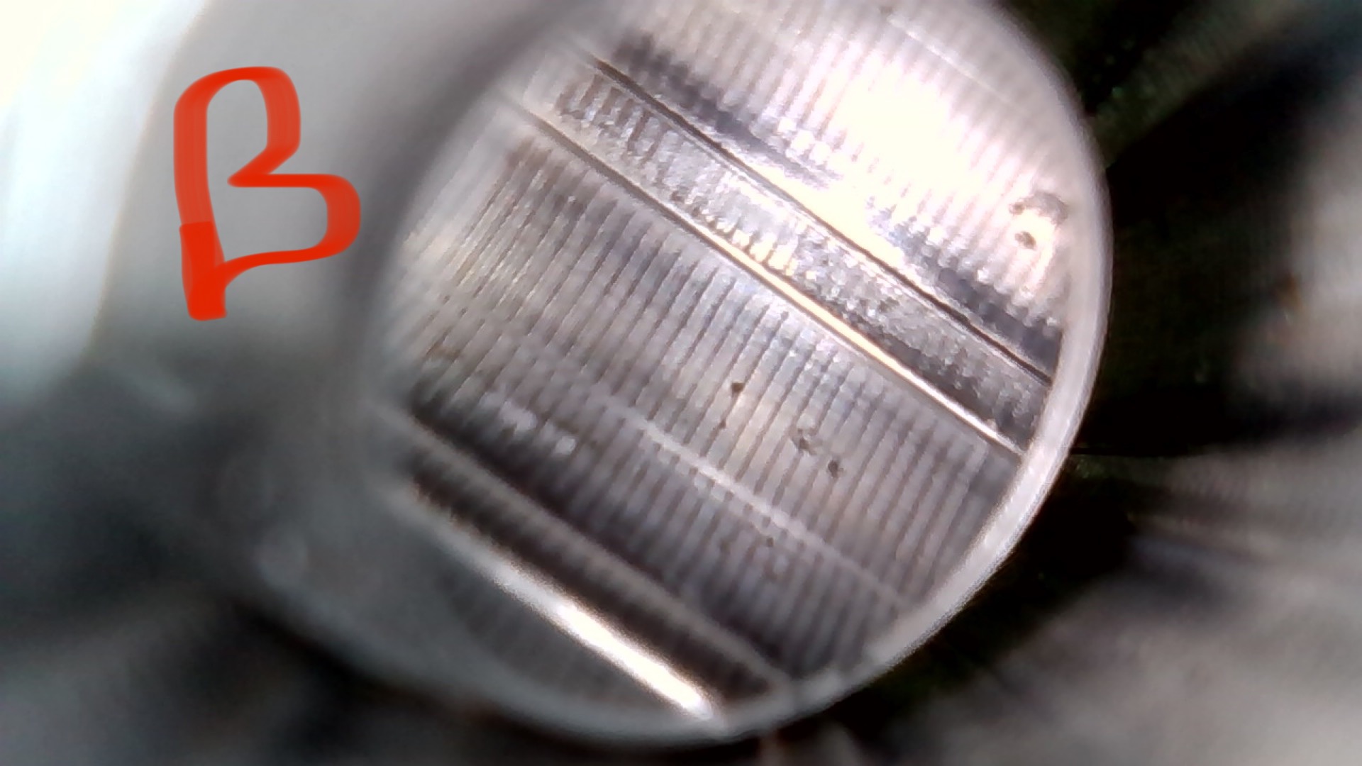

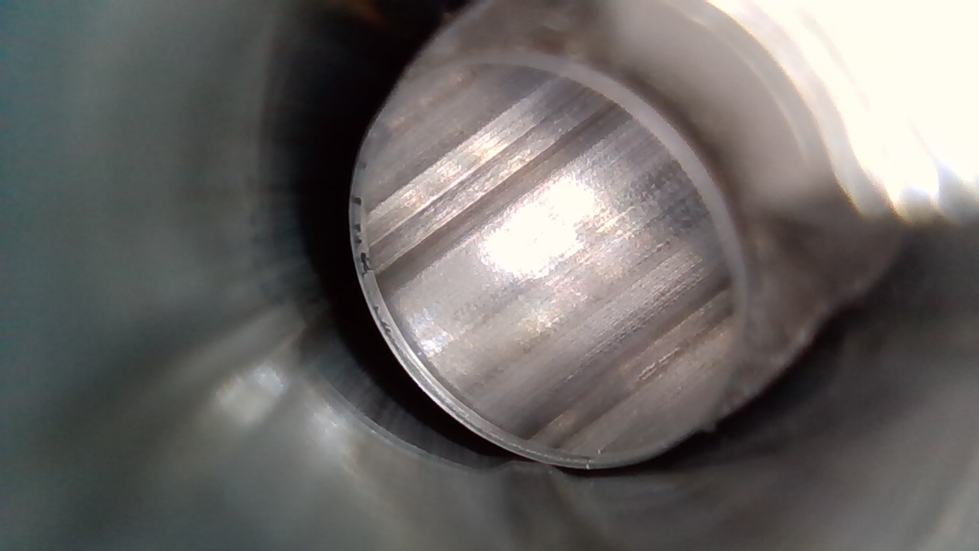

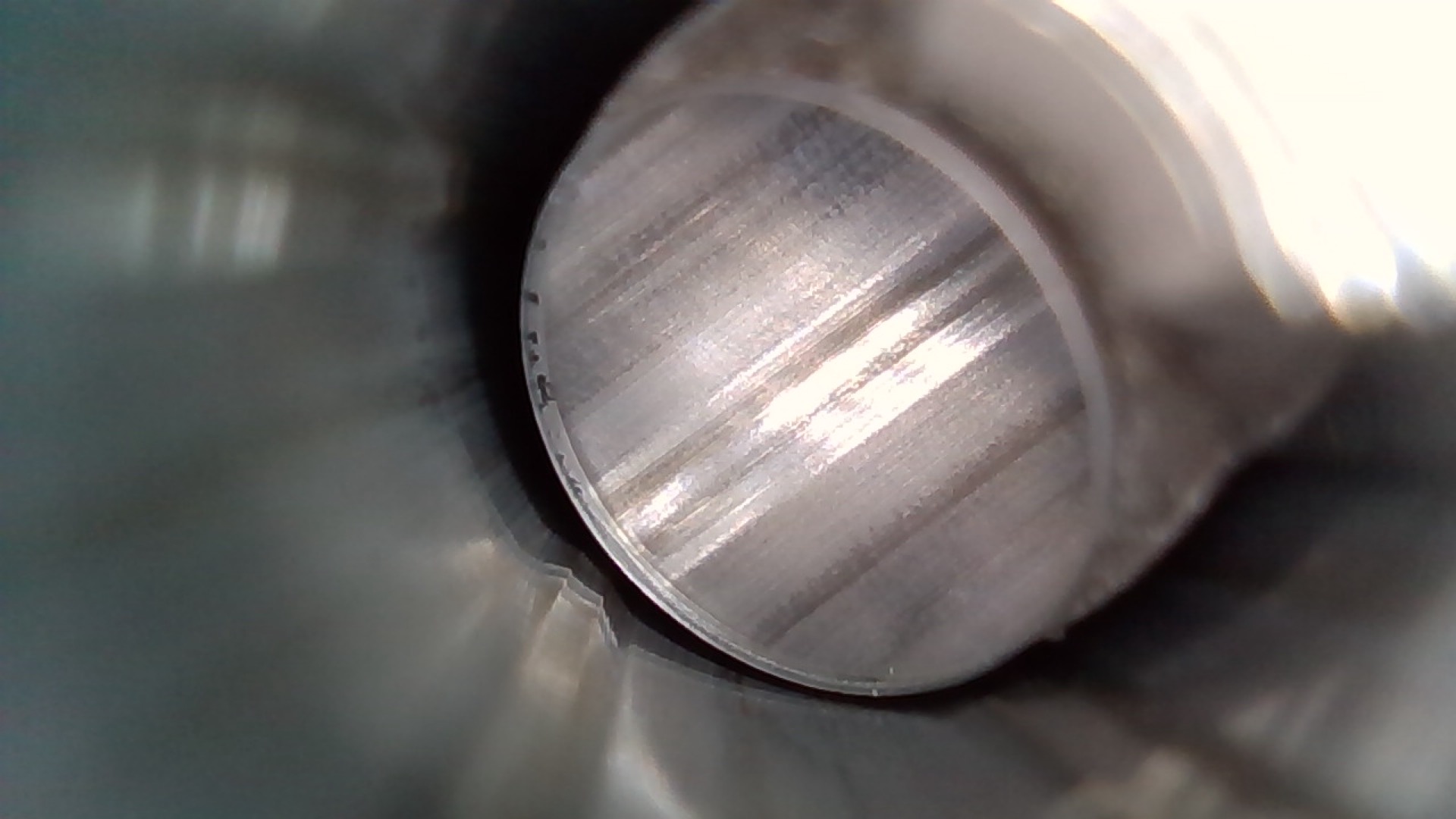

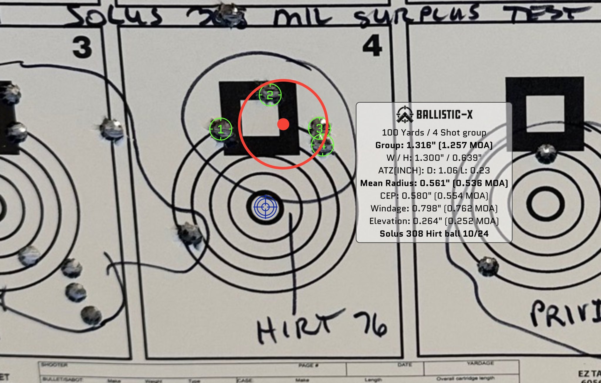

    Here’s a Wilson 308 blank that was barreled by PVA. Same treatment, only cleaned with C4. This is after I ran about 50 rounds of different Mil-Surplus through it. It seemed to like Hirtenberger ‘76 the best.
    Ballistic-X-Export-2024-10-24 15:12:48.520770.jpg
    This was a rock Creek barrel .
    Or at least advertised as one… shot like crap no matter what I did and had an excessive headspace. (Ar15 6arc ). We will see what the replacement looks like, but I was told that all rock Creek barrels look like this… from a well known barrel spinner.
    But the picture you posted looks nothing like the one that I posted .. as far as barrel finish

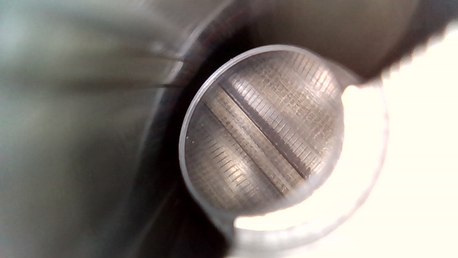

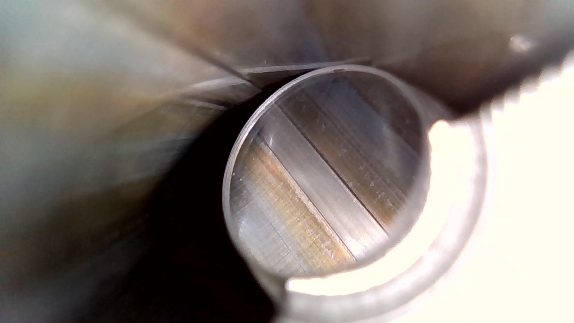

    Yeah that’s very different. Mine is a M24 profile 26” stainless from PVA that’s on my Origin. I don’t think Josh would ever sell a barrel looking like yours. I don’t have any experience with their AR barrels, but one would not think there would be a difference.
    At least it’s not as bad as my Savage. I bet Tubbs FF would smooth it up nicely.
