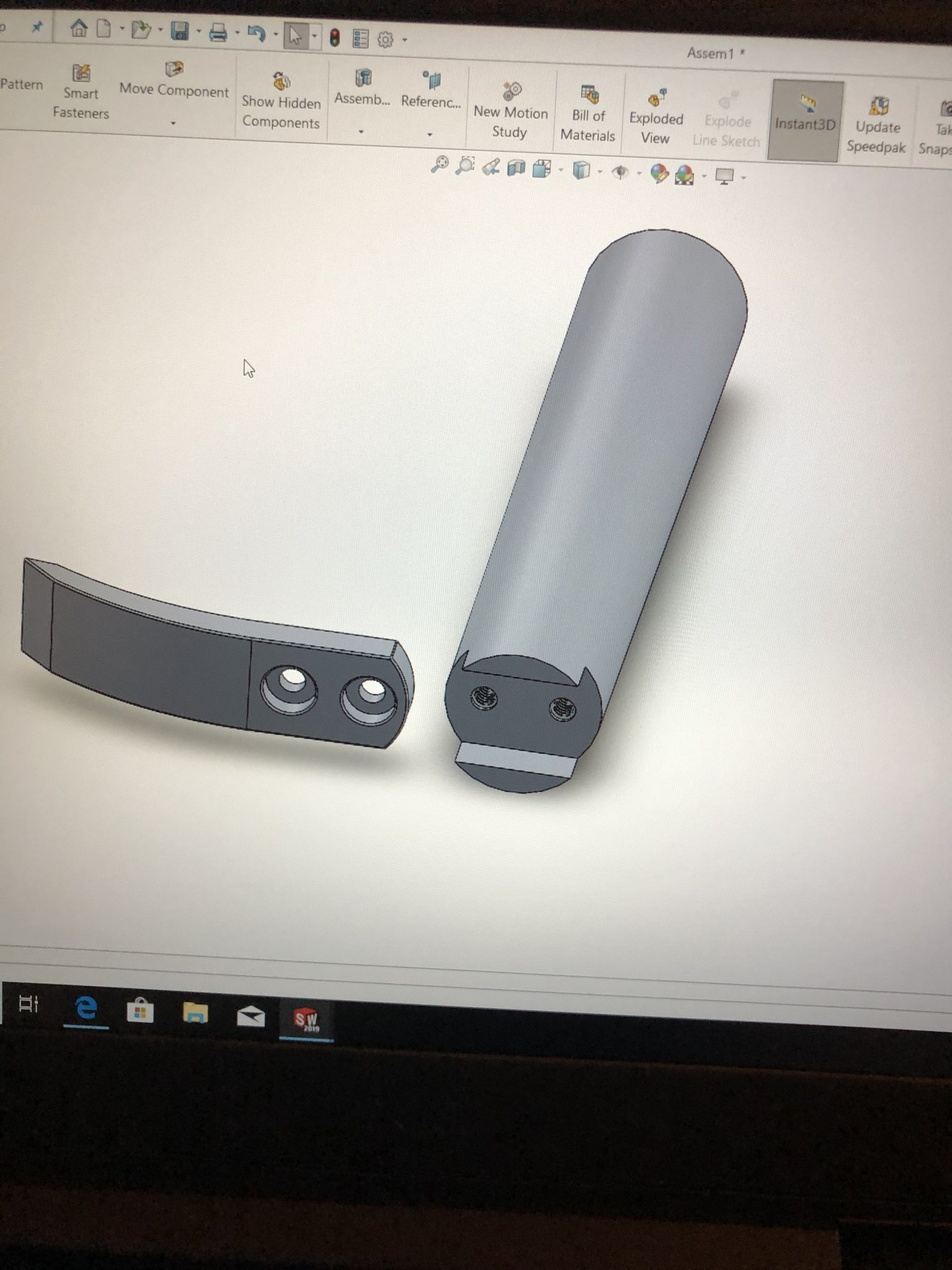

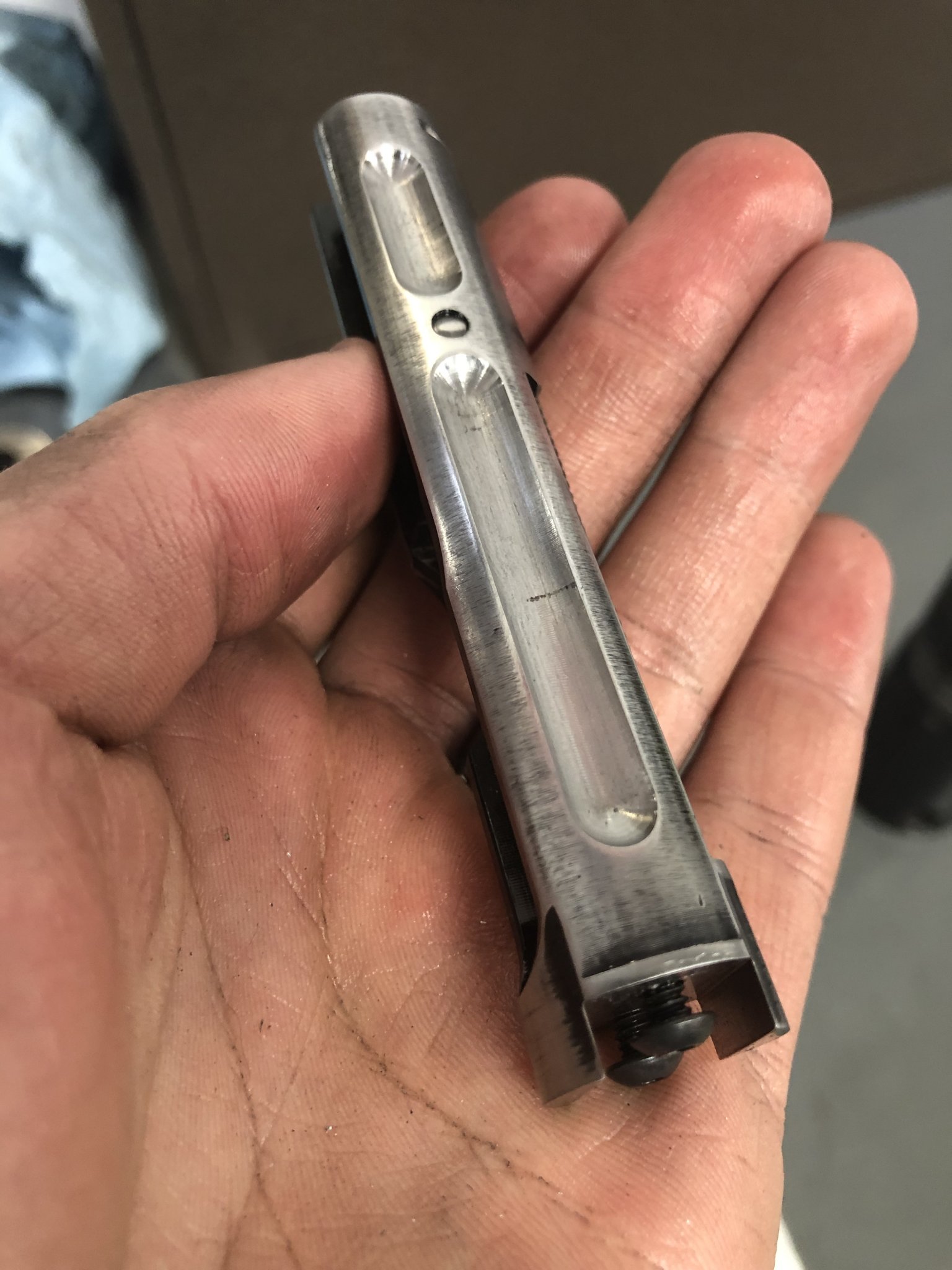

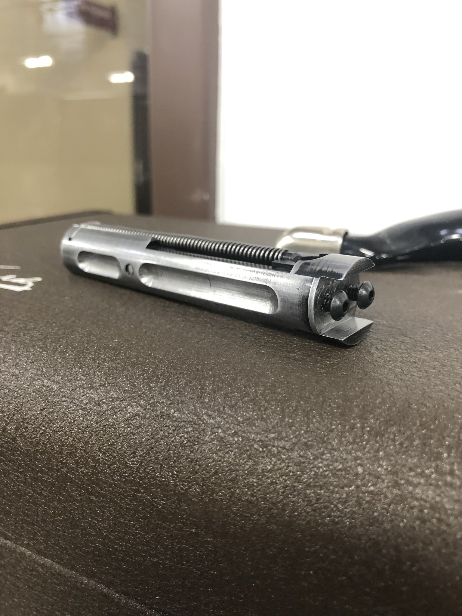

Greetings all, I’ve been Trying to come up with a solution to the horrible bolt serration/ fins on my 22/45. I haven’t seen any that I really like without spending a bunch on a whole new bolt, so this is what I got so far. First I turned the fins down to match the bolt’s OD. Then I cut a half inch slot 200 thou deep on the rear face and put two 6-40 threaded holes evenly spaced from center. This will hopefully accept the charging handle I am working on in the solid model below. I decided that it would look cool and hopefully increase bolt speed and reliability when dirty so I put some straight flutes on the bolt body where I could fit them. Has anybody tried to lighten up a mark bolt? I’m curious to see if it will help the problems I’m having. Thank for looking??

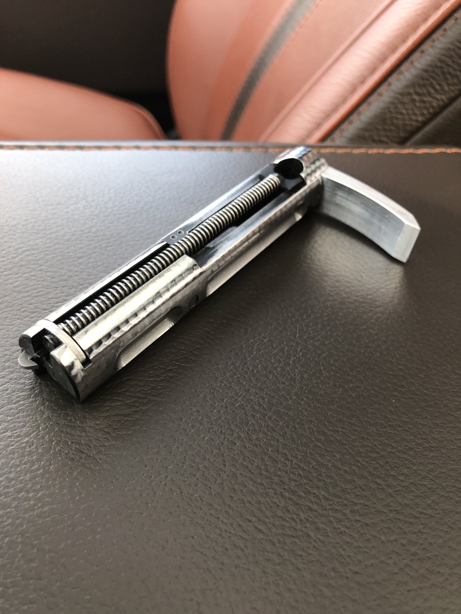

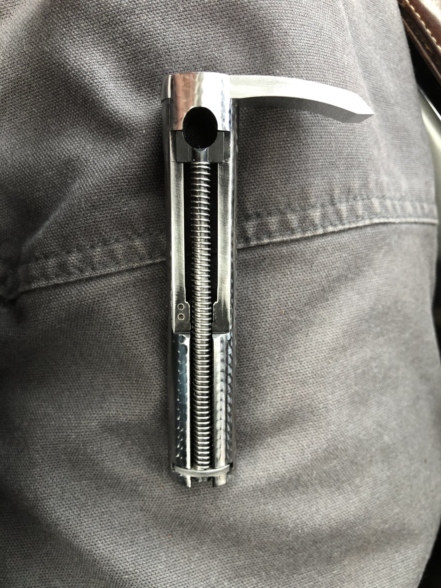

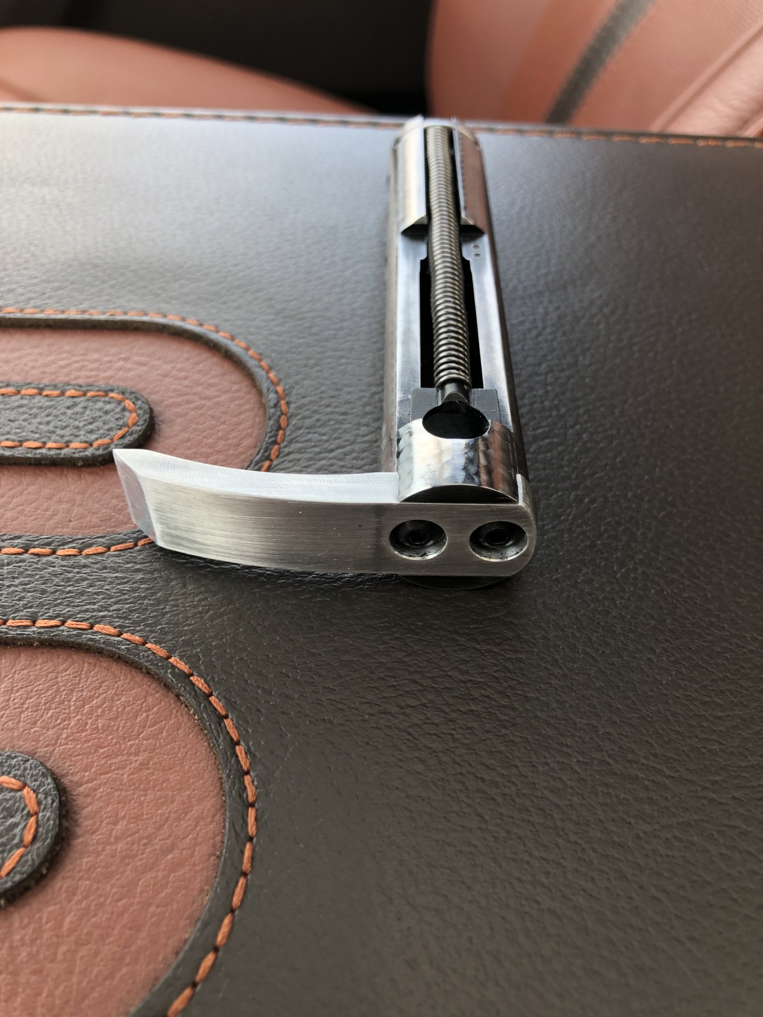

This is what I got so far, want to get the handle anodized or coated. I decided attempt jewling for the first time and it turned out pretty good imo, very hard to get a good picture with the lighting right now though. I function tested and it ran great
Reactions: duramaxed
Reactions: MlimA
